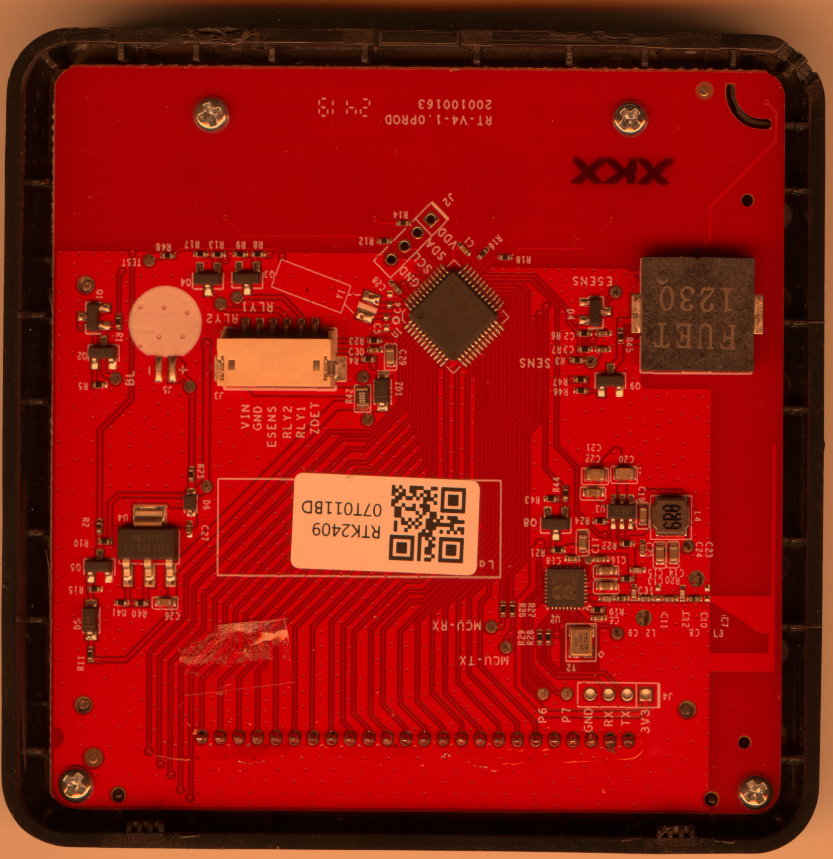

    Hello again . Gotten in the past a tuya BK7231N based Thermostat . So now i attempted to flash the the openbk firmware . Flashed the chip successfully but i cant see logs of the TUyaMCU driver . Below i attach my autoexec bat . Tried both the 9600 and 115200 baud rate . I recall seeing in the past the picture in the board in one post , but i cant seem to find it again .

    ah yes. this was that odd baud one - 38400. I wonder if @hard3d got a fully working device in the end

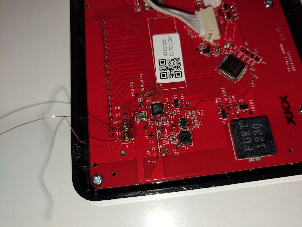

    >>21861808 i dont think he didi. Retraced all his steps , desoldered resistors and bridged mccu rx and tx but never managed to get mcu logs. Either i didn't get something right either it never worked ?

    hmm. this might be a tough one. Looks to be an Rti-Tek device. string
    Rti-Tek@2020
    can be seen in the decrypted app partition. I don't see evidence the protocol is known anywhere.
    Datasheet for the CA51F452L2 MCU attached.
