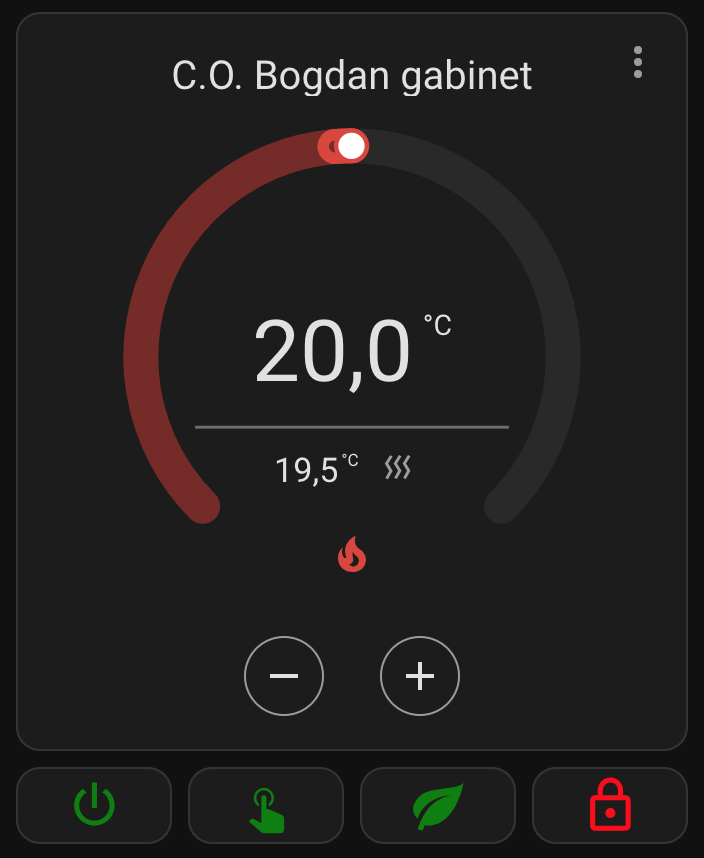

    Po paru tygodniach testów mogę stwierdzić że OpenBK współpracuje bardzo stabilnie z Home Assistant, do tej pory nie było kłopotów w komunikacji, żadnych zwiech lub innych zdarzeń komplikujących działanie.
    W związku z tym chcę podzielić się moją konfiguracją dla innych szukających rozwiązania.
    Na początek widok końcowy integracji termostatu w Home Assistant, użyłem integracji Better Termostat i przycisków dodatkowych oraz paru innych trików.
    Wygląda to tak.:
    Screen of a thermostat with the temperature set to 20°C.

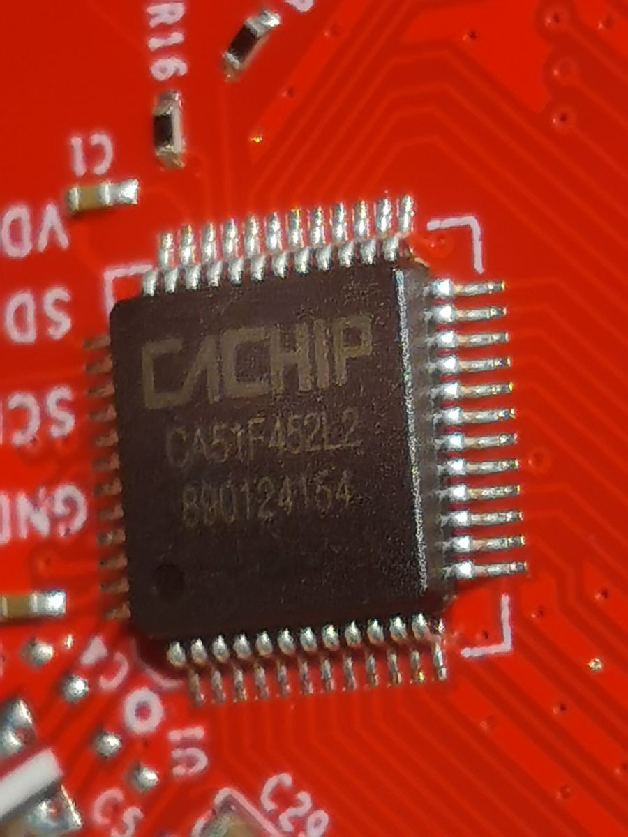

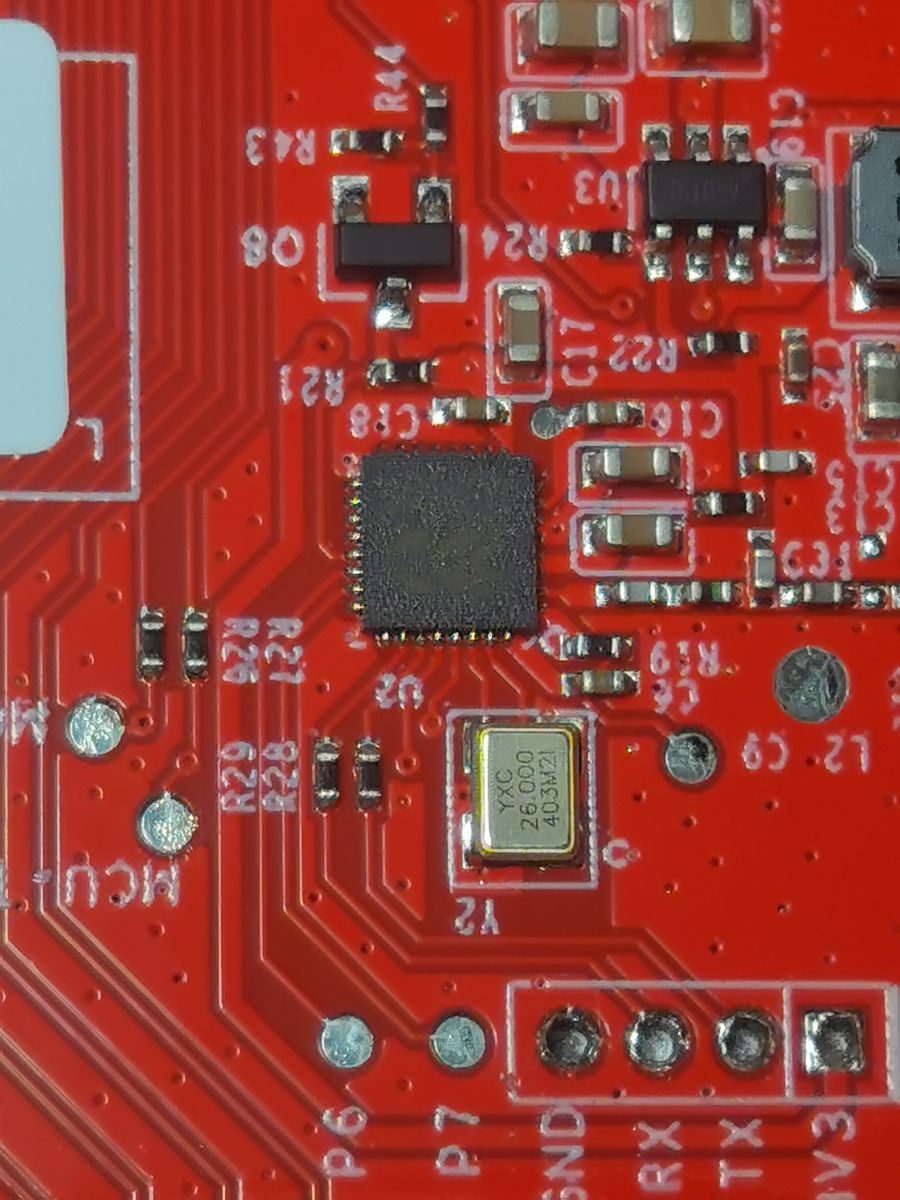

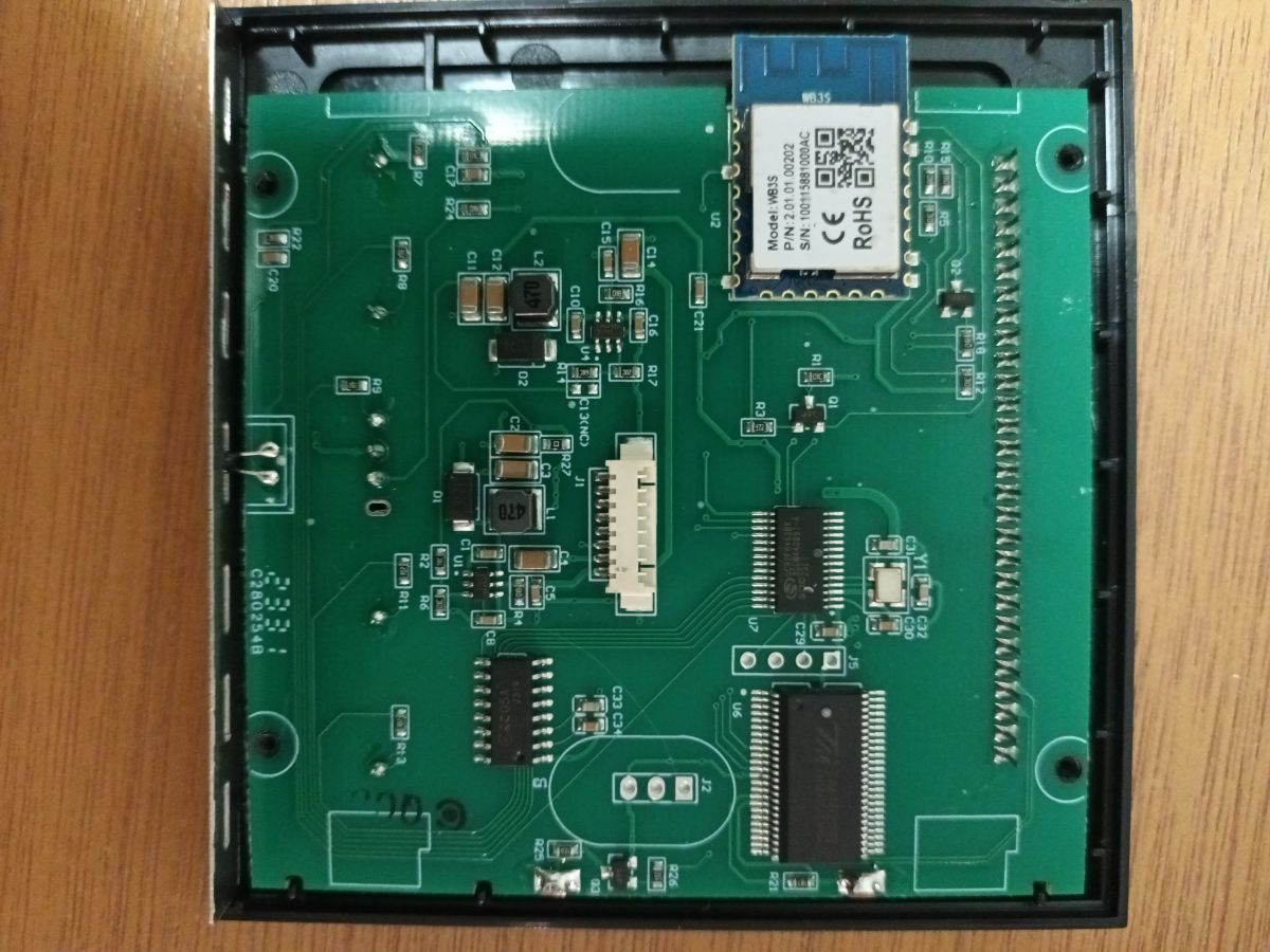

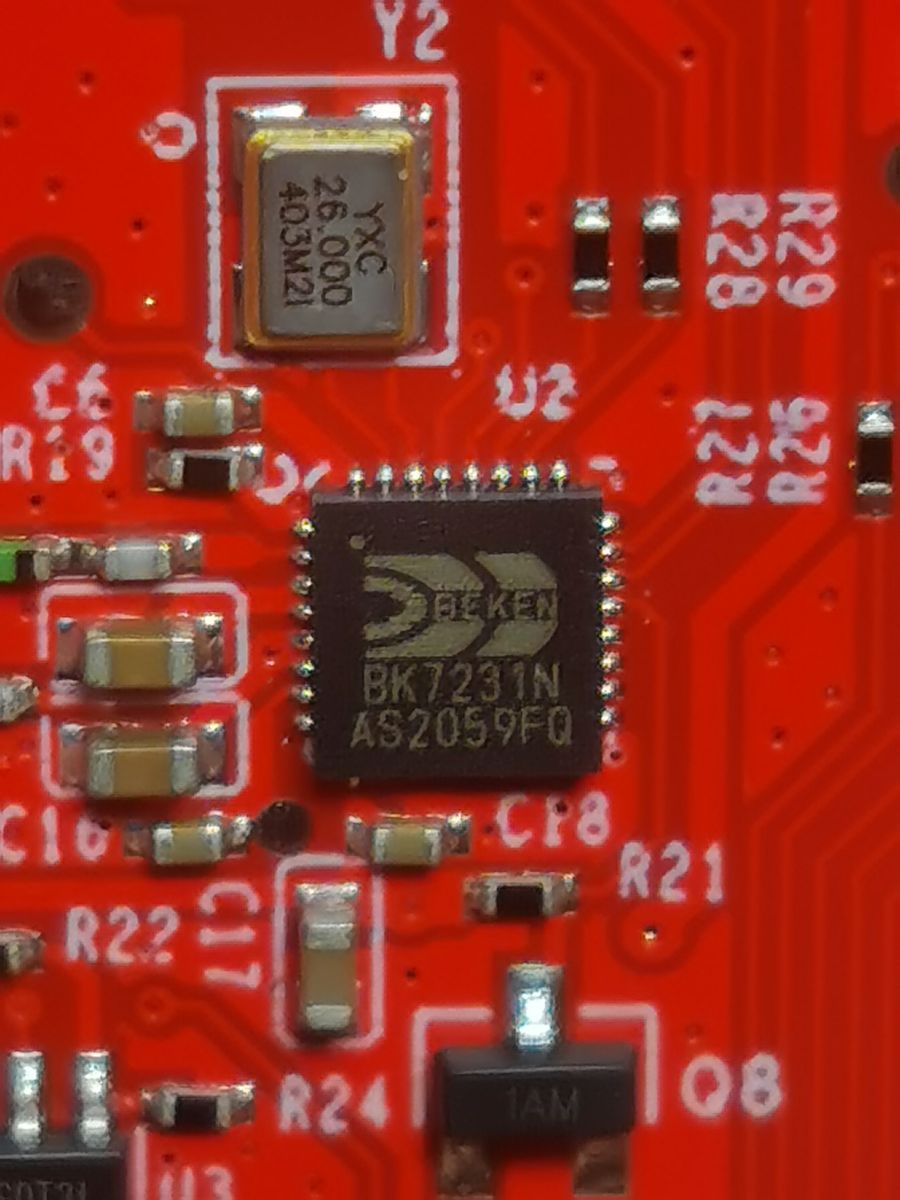

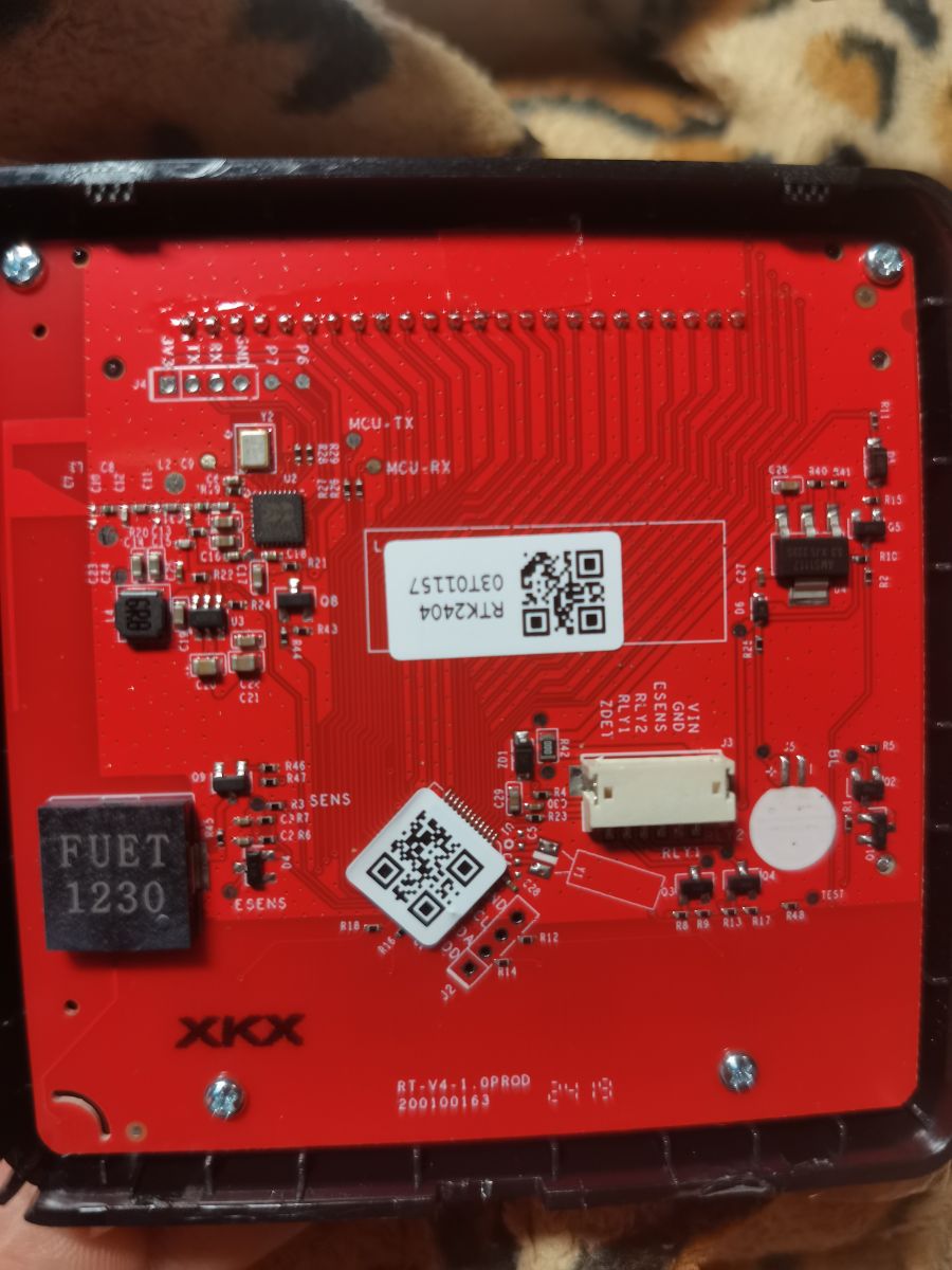

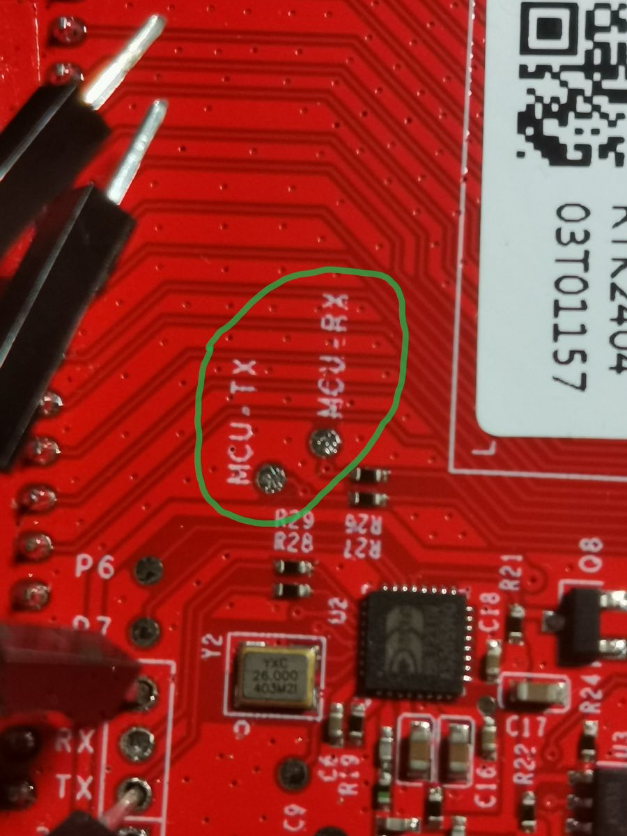

  • Asking about Q1/Q2 transistors and autoexec.bat setup
    #62 20923463
    rbobey1989
    Hello, I have read this thread several times. I ordered a MOES BHT-002-GCLW thermostat, and to my surprise, it includes a TUYA WB3S wifi module which should not be a problem according to the OpenBeken documentation. This microcontroller is supported. Now I need some help with this device because the PCB is not exactly the same as the one shown by tomik67. I have attached some photos of the PCB. Near the WB3S microcontroller, I have 2 transistors Q1 and Q2 which in the tomik67 model have been desoldered and bridged. On this PCB, they are still close to the WB3S but in the same place on the PCB. Who can give me a little information about these transistors? Thank you in advance. Also, if someone can tell me about the configuration of the autoexec.bat file, I will also be grateful.
    Tomik67, if you can take a photo of the jumper you made from the relay contacts to PWM1, it would be of great help.
    PCB of MOES BHT-002-GCLW thermostat with WB3S Wi-Fi module.
  • #63 20953953
    tomik67
    Posts: 111
    Rate: 11
    Hi.
    Your heating controller is an earlier version where 5V was used for communication between WB3S and the MCU, not 3.3V as in newer controllers.
    Therefore, in your case, it will be necessary to use a voltage divider described in this thread:
    Link

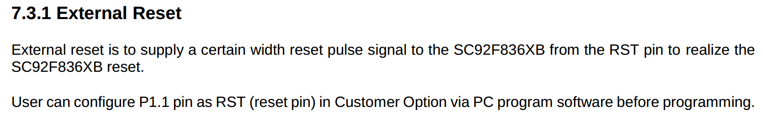

  • #68 21043559
    tomik67
    Posts: 111
    Rate: 11
    The MCU in this model is SOC SC92F8463BX, specifications attached.
    It shows that the MCU has pin 6 RST and four reset modes, PDF page 31, including Watchdog (WDT) reset.
    • SC92F8363B_8362B_8361Ben.pdf (2.18 MB) You must be logged in to download this attachment.
  • #69 21044782
    Posts: 14797
    Rate: 12954
    You could connect the BK7231 output and script RESET, so that it would be triggered, for example, by a timer or an HA command (and the command - alias - would set the channel to 1 and after a while with addRepeatingEvent to 0), but as I wrote, try with queue for now.

    Then we need to try to do a reset of the MCU. First, find a free GPIO, set it to the Rel role, assign some unused channel and connect it to the RESET pin. Then see if operating on that channel resets the MCU.
  • #72 21053299
    tomik67
    Posts: 111
    Rate: 11
    Of course I will, but the worrying thing is that applying ground to this pin with the MCU still frozen did nothing, there was no reset.
    I wonder if this pin doesn't function somehow differently.:
    Excerpt from documentation describing external reset for SC92F836XB. [/img][/quote]
    I soldered pin 6 of the MCU to pin 20 of the CB3S and split channel 10 of the MCUReset
    There seems to be no response.
  • #73 21053507
    Posts: 14797
    Rate: 12954
    Certain width reset pulse? So precise timing is needed?
  • #74 21053524
    tomik67
    Posts: 111
    Rate: 11
    It is more the latter that concerns me.:
    the user can configure pin 1.1 as RST at the client option using computer software before programming
    I don't know if the RST pin is programmed, there are a couple of options for this pin.
  • #75 21059543
    Posts: 14797
    Rate: 12954
    You could try plugging a transistor into the MCU power supply and unplugging it momentarily to force a RESET.

  • Requesting OpenBK flashing and display setup steps

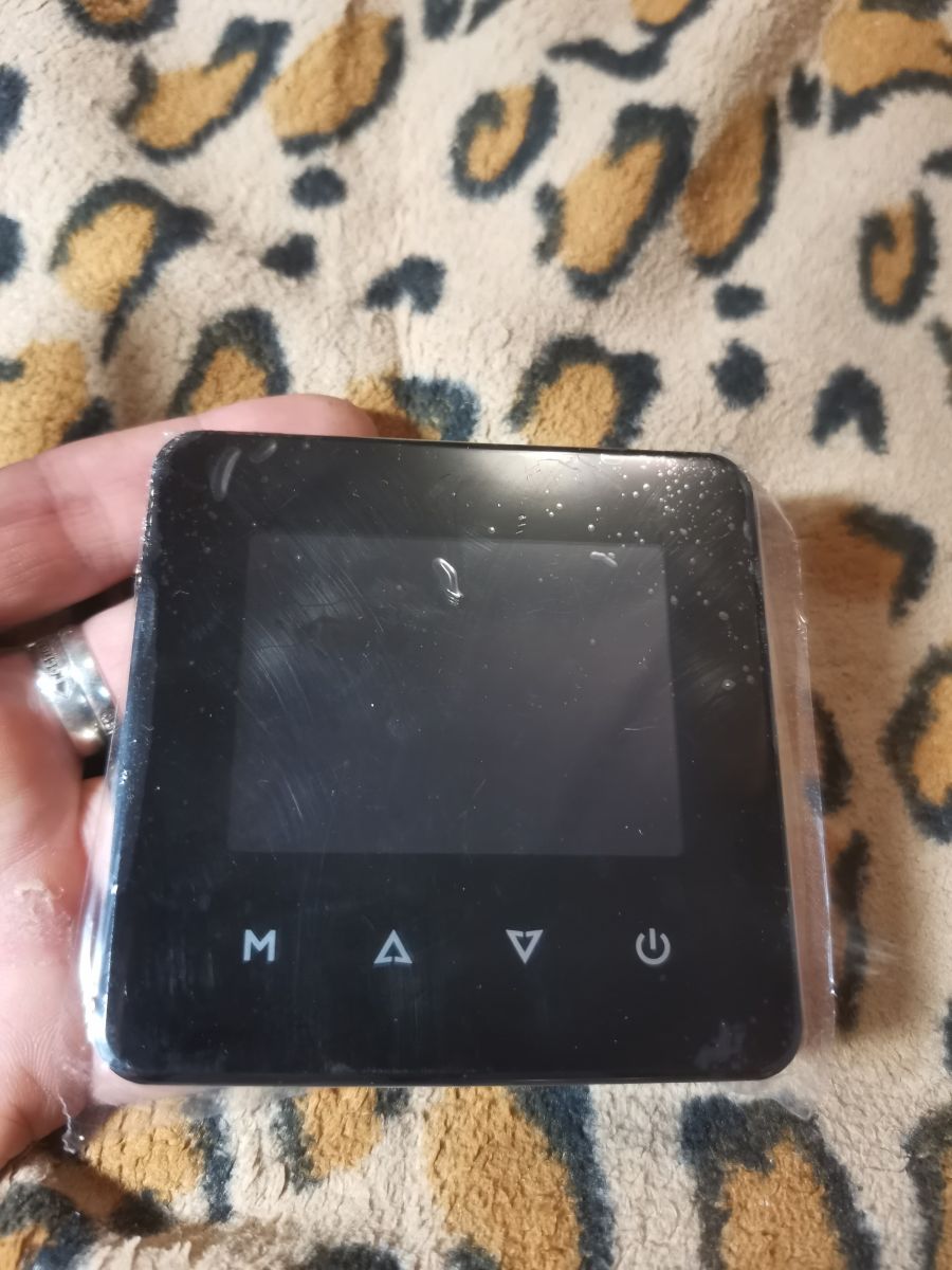

    #82 21141019
    hard3d
    Posts: 19
    Hello! I bought a thermostat as shown in the photo below. I want to flash it to Open BK. What are my actions before and after the firmware. How to configure what else the display would show the same as the original firmware.
    Black thermostat with a display, held in hand, against a patterned fabric background. Red printed circuit board of a thermostat with visible electronic components and QR codes.
    Close-up of a CACHiP chip on a red circuit board. Close-up of BK7231N microcontroller on a red PCB.
  • #83 21142479
    hard3d
    Posts: 19
    Good afternoon. I made a backup of the original firmware and installed the OBK firmware. The chip only works when it is in pairing mode. It is necessary to somehow make the chip work all the time. As I understand it, you need to return the original firmware and try to intercept MCU packets.
  • #84 21142546
    Posts: 14797

    You have posted UART2 (TX2) output, which is a debug log. TuyaMCU uses UART1 for the communication.
  • #88 21144404
    hard3d
    Posts: 19
    There are such conclusions. but there are no such messages there either.
    Close-up of a circuit board with marked UART points.
    Added after 53 [minutes]:
    I have UART1 for debugging messages and firmware. UART2 for MCU
    Close-up of a red printed circuit board with electronic components such as an integrated circuit and a crystal oscillator.
  • UART swap and TuyaMCU autoexec settings not working
