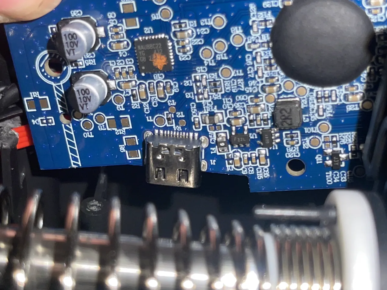

    Hey everyone, fairly new to hardware hacking but I've been going deep on this project and could use some expert eyes.
    **Background:**
    I have a Turtle Beach VelocityOne Flight yoke (flight simulator controller) that shipped from factory with firmware version 0.0.0 — basically a test/blank firmware. It worked fine for basic use but the moment someone tried to update it via the official Xbox app, the update process corrupted the firmware and now:
    - Device powers on and boots into a menu ✅
    - Can navigate the on-device settings ✅
    - Neither Xbox, PC or Mac detects it over USB at all ❌
    - No "device not recognized" — complete silence from every OS ❌
    - Tried original and multiple other cables, multiple ports ❌
    - Once connected briefly by miracle, managed to flash latest firmware, but it immediately reverted to 0.0.0 and connection dropped permanently ❌
    So the device is alive but USB is dead — almost certainly because the corrupted firmware never initializes the USB stack on boot.
    **What I've done so far:**
    I extracted the official firmware bin file by digging through the official Turtle Beach recovery tool (a .msixbundle package — firmware files were disguised as .png files inside). Ran entropy analysis on the bin — 3.71/8.0, confirmed not encrypted, confirmed SPI flash image format (38.8% actual data, 61.2% zeros, sparse layout typical of flash dumps). File is ~1.1MB which fits perfectly in a W25Q16FW (2MB chip).

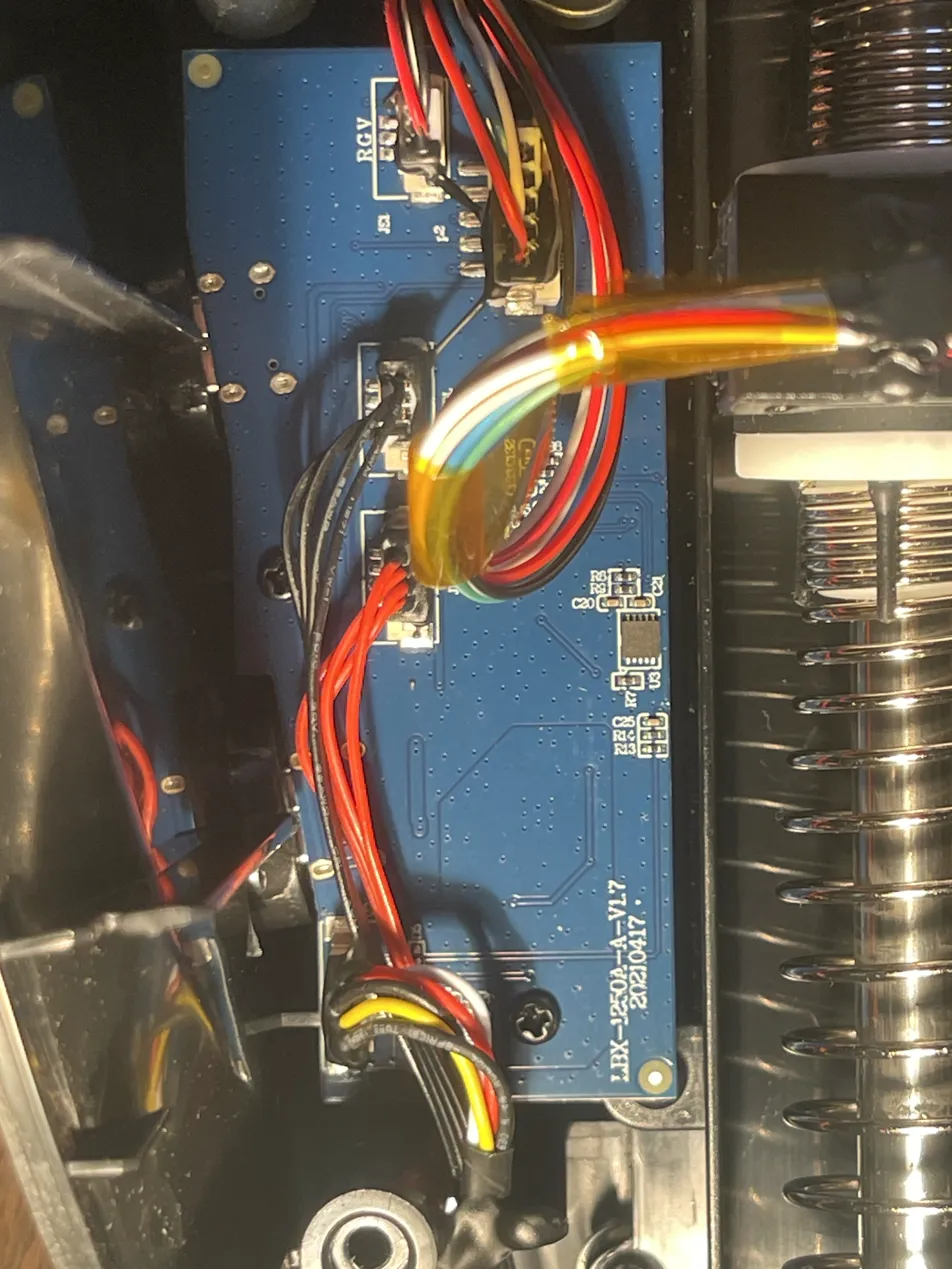

    I've opened the device and identified the PCB: **LBX-1250A-A-V1.7 (dated 20210417)**
    Chips I've confirmed so far:
    - **U2 = NAU88C22YG** — Nuvoton 24-bit stereo audio codec ✅
    - **U5 = covered under epoxy blob** — almost certainly main CPU ✅
    - **Mystery chip with marking 74203** — appears to be Microsoft Xbox GIP authentication chip (same family found in Xbox One controllers) ✅
    - **18.432MHz crystal** — right next to the epoxy blob, i think UART baud rate crystal
    - **U3, U4** — not yet identified, markings F32L and GU4Y
    NOTE: I IDENTIFIED THIS WITH AI HELP A BIT.
    **Why I think it's W25Q16FW:**
    A Russian guy on a forum mentioned specifically that this device uses a **W25Q16FW SPI flash** and **Nuvoton M482KIDAE ARM MCU**, and that the fix requires direct chip flashing. I can't 100% verify this — it's one source — but the firmware analysis strongly supports an external SPI flash chip existing somewhere on this board.

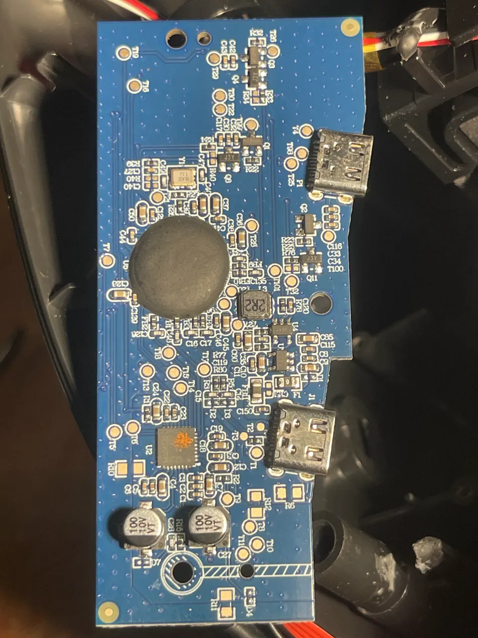

    **The problem:**
    I cannot find the flash chip visually. The board has been examined thoroughly and I believe it's **hiding under the epoxy blob** that covers U5. The blob is roughly 20-25mm diameter and could easily fit both the main CPU and a small flash chip together underneath.
    **My questions:**
    If the chip is under epoxy with no accessible legs, what are my options for connecting to it? Is there any way to reach it without removing epoxy?
    Could the SPI flash signals be accessible via test points on the PCB? There are several unpopulated test points around the blob area (T10, T15, T16, T19, T28, T29, T30 visible). Could SPI CLK/MOSI/MISO/CS be routed there?
    There's also a 4-pin header near the blob — could this be SWD debug port for the ARM CPU?
    Does anyone recognize the LBX-1250A board layout or have seen similar Nuvoton + NAU88C22 + Xbox GIP chip combinations before?

    AI: Can you post clear, high-res photos of both sides of the PCB — especially the epoxy blob area, the 4-pin header, and the labeled test points (T10/T15/T16/T19/T28/T29/T30)?
    Yes
    AI: Have you done any basic probing on that 4-pin header/test pads yet — e.g. pin voltages to GND when powered, continuity to ground/VBUS, or scope/logic-probe activity during boot?
    NOT YET

    michaeljamesromt
    Posts: 19
    Given the symptoms, it likely failed during USB stack init in the main firmware, while the bootloader still runs. Since you still have menu access, the MCU may allow ISP/SWD recovery or SPI flash reprogramming on the W25Q16FW. I would try Nuvoton ISP tools or an external programmer before assuming a hardware failure issue.
