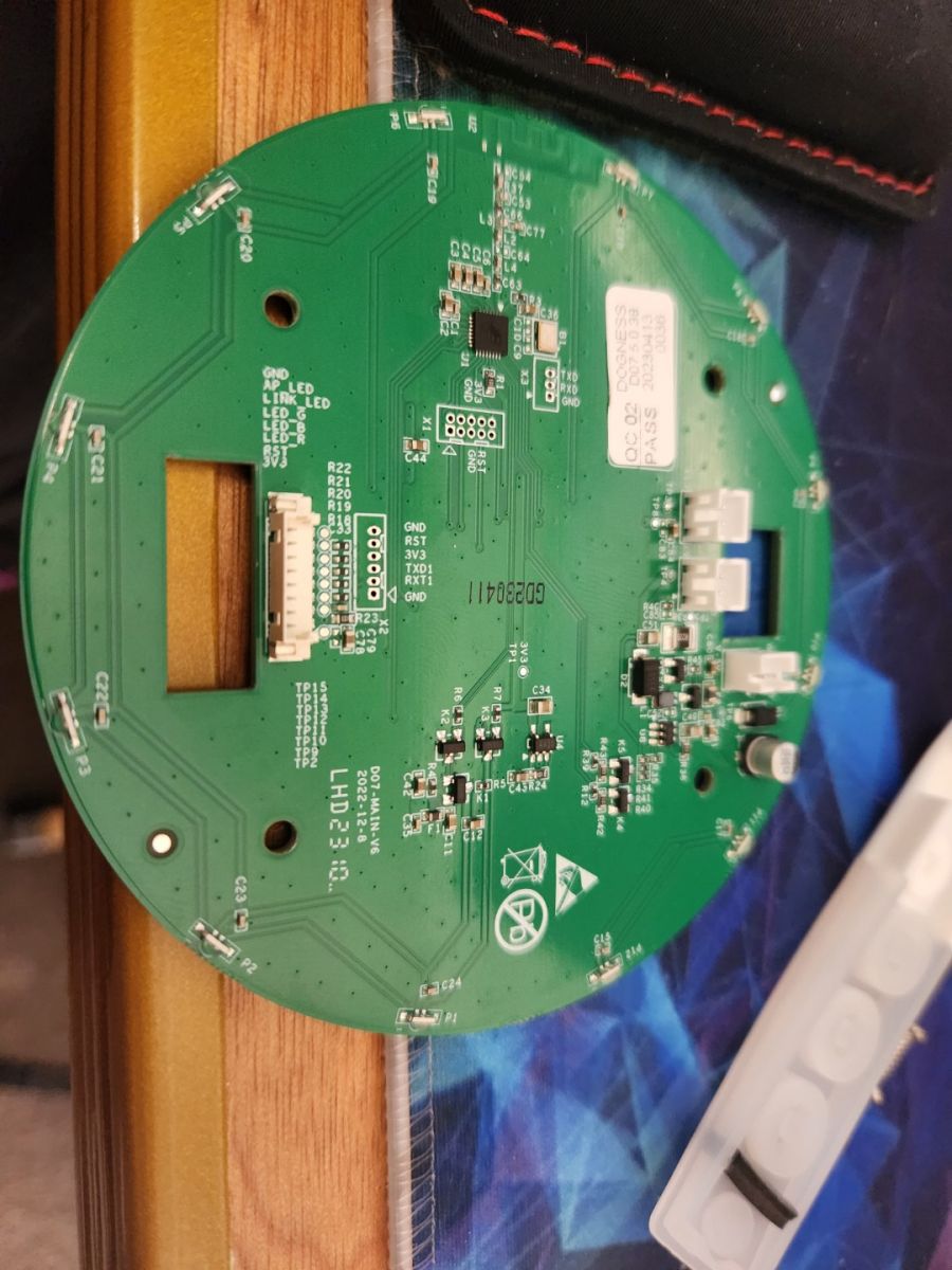

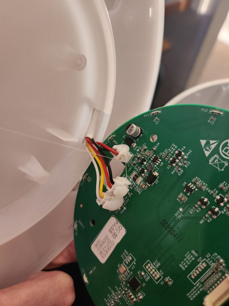

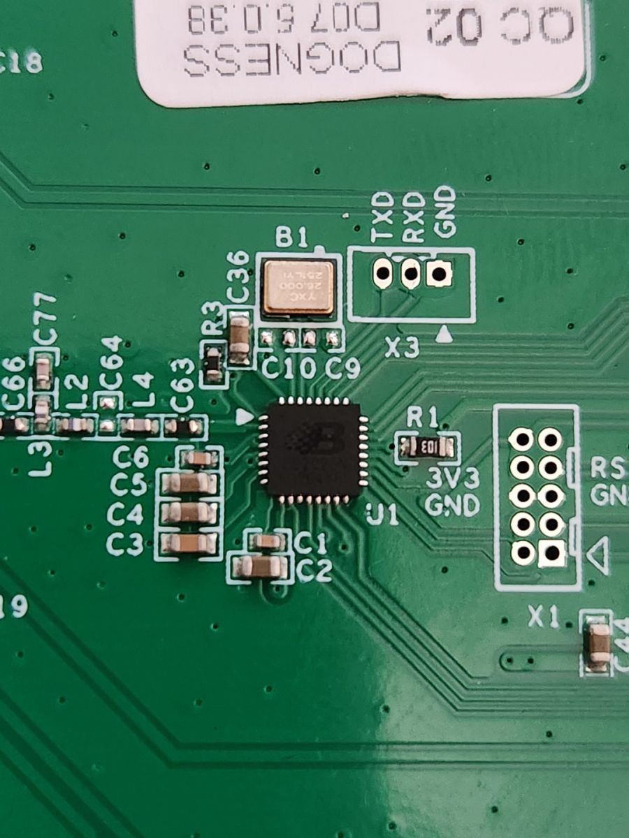

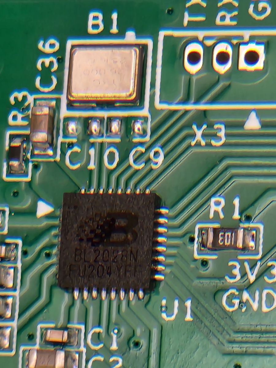

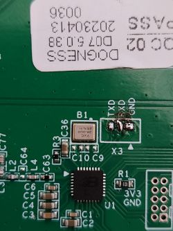

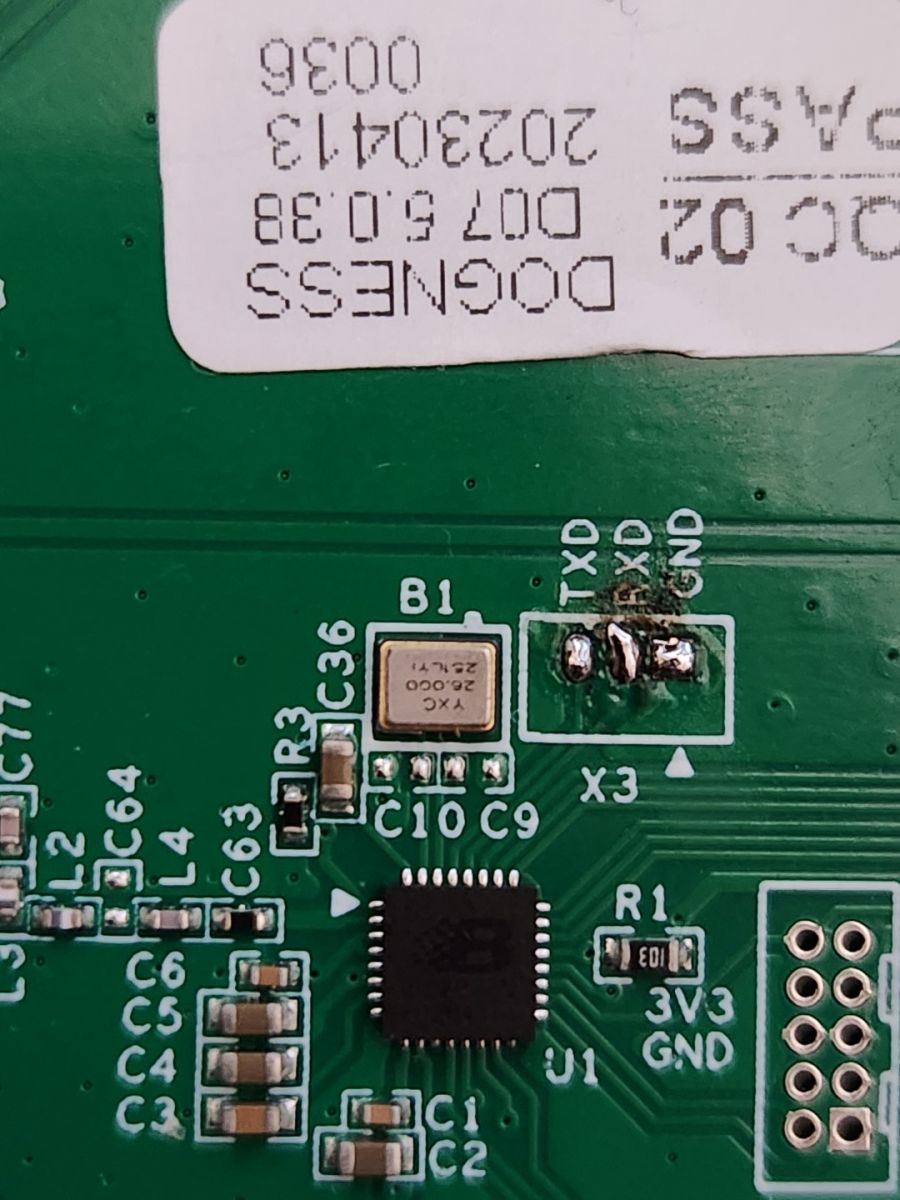

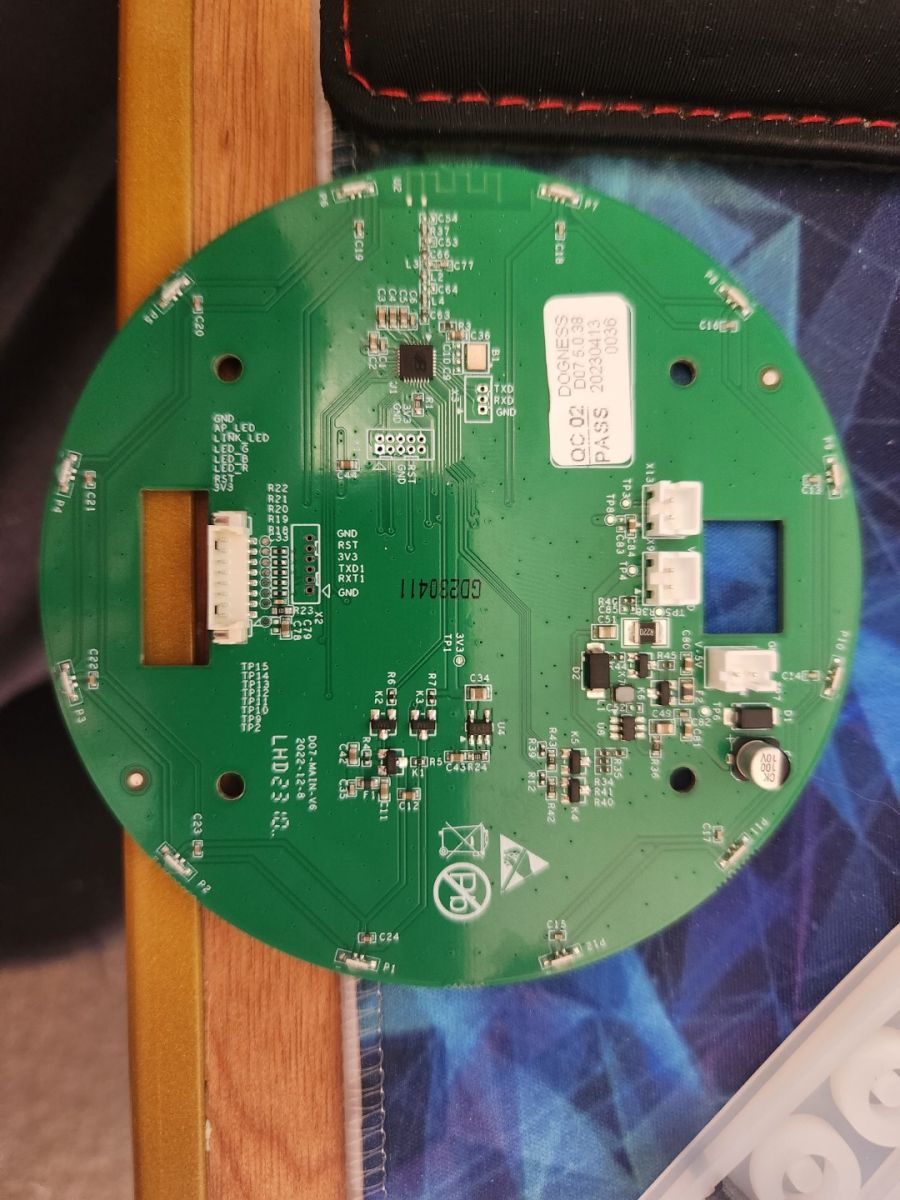

    Hi Everyone,
    I have a curly one, and I have spent a lot of time on this with little success so far but have a bunch of information as a result of my tinkering, I get the feeling the issue I'm having is its not a Tuya device so the partitions are in the wrong please, I have tried taking a look at the binary dump in Ghidra but I'm no firmware reverse engineer. Any help would be appreciated! Even if its to tell me its not possible so I know to stop :P
    I have uploaded the firmware dump in the attached zip.
    Flashing results in it not booting from what I can tell, both tx\rx lines display only "□" each time i perform a reset
    Have Tried the following
    * Flashing several versions of openbeken for BK7231N
    * Flashing a Tuya backup from another basic device, then flashing OpenBeken firmware.
    * Have been able to flash back to original firmware each time and it seems to be happy again.
    Flash information: mid: 1560EB, icName: TH25Q_16HB, manufacturer: TH, szMem: 1000000, szSR: 2, cwUnp: 0, cwEnp: 7, cwMsk: 407C, sb: 2, lb: 5, cwdRd: 05-35-FF-FF, cwdWr: 01-FF-FF-FF

    Some of the serial output from alt set of tx\rx pins when dogness firmware loads.

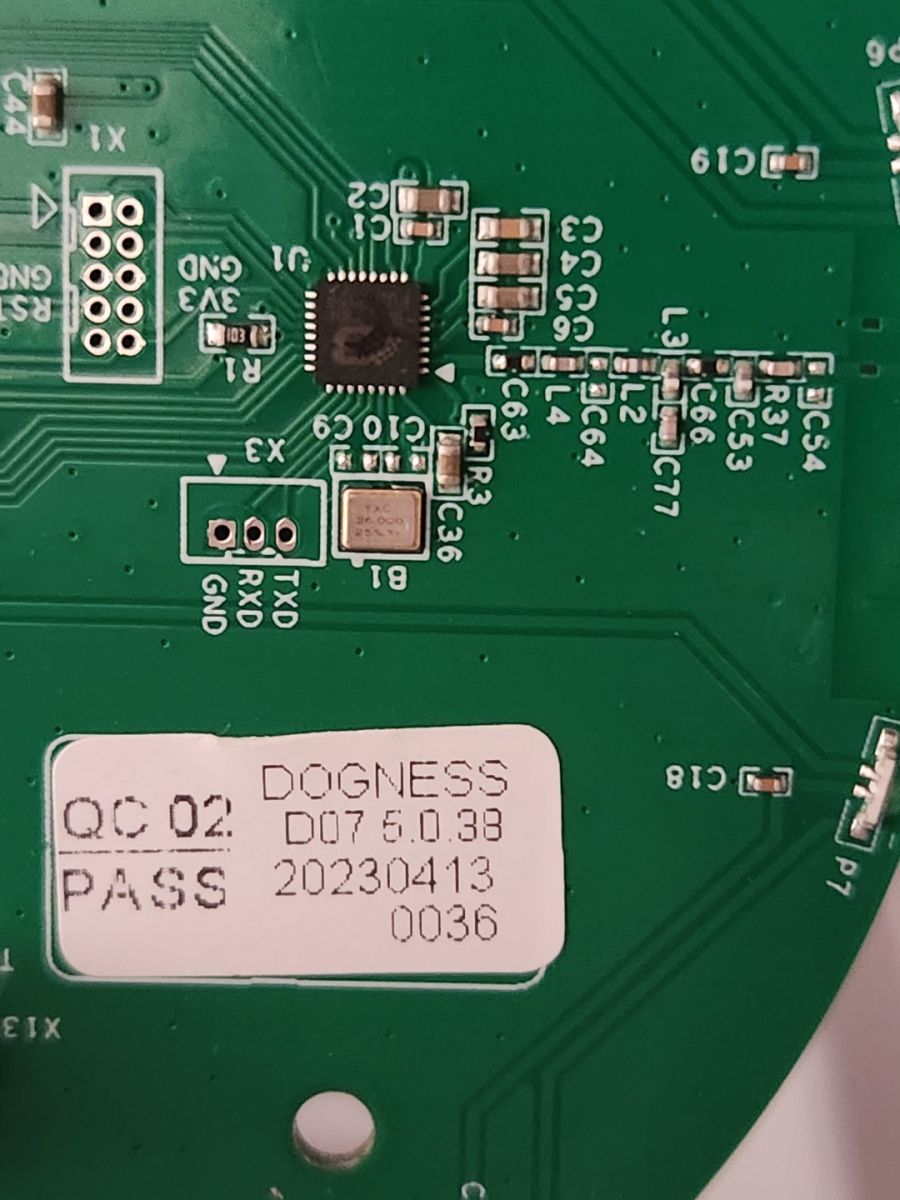

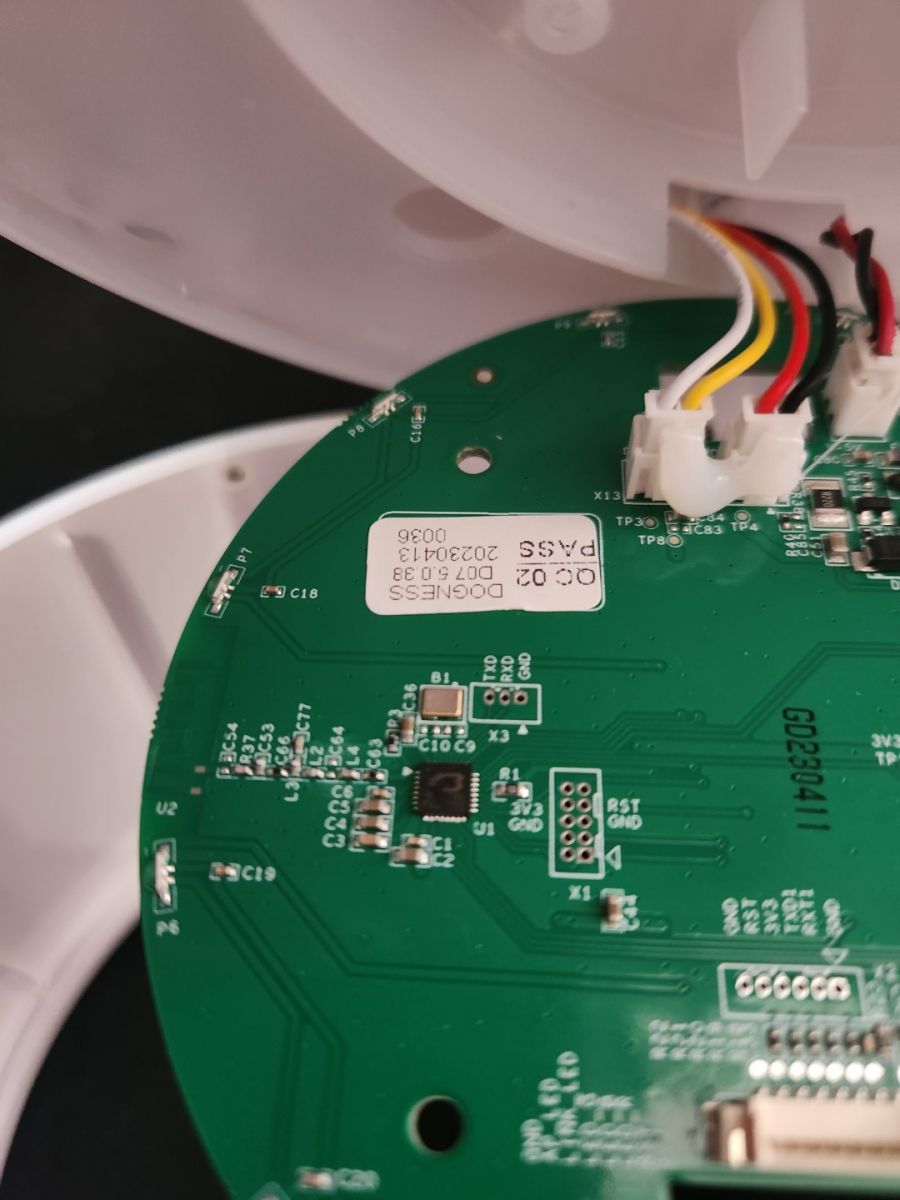

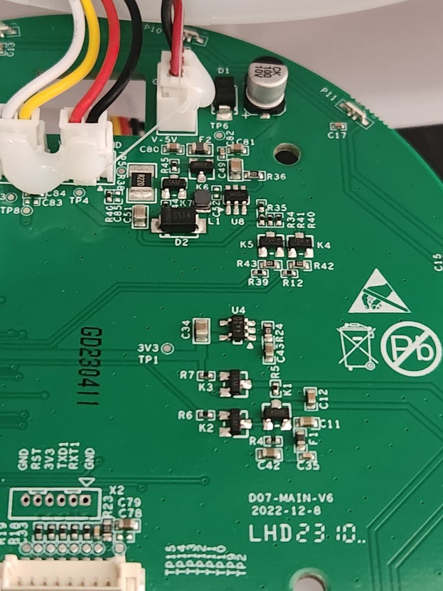

    Device purchased here, for specs etc
    https://www.pbtech.co.nz/product/PETDON0003/D...ss-D07-Smart-18L-Fountain-Smart-Pet-Water-Dis
    Also found a copy of the Belon Writer V1.55 if anyone wants it, it seems to only have write not read, does have compare though

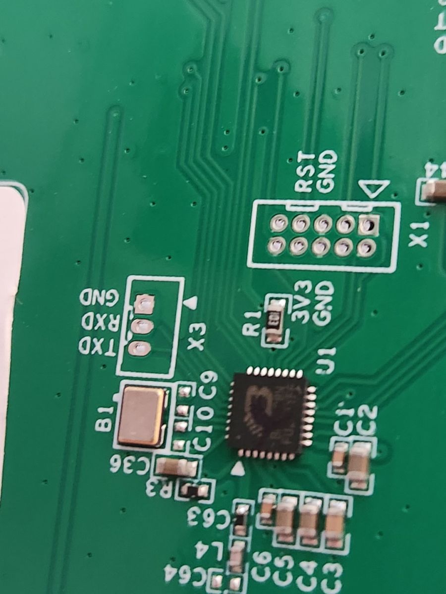

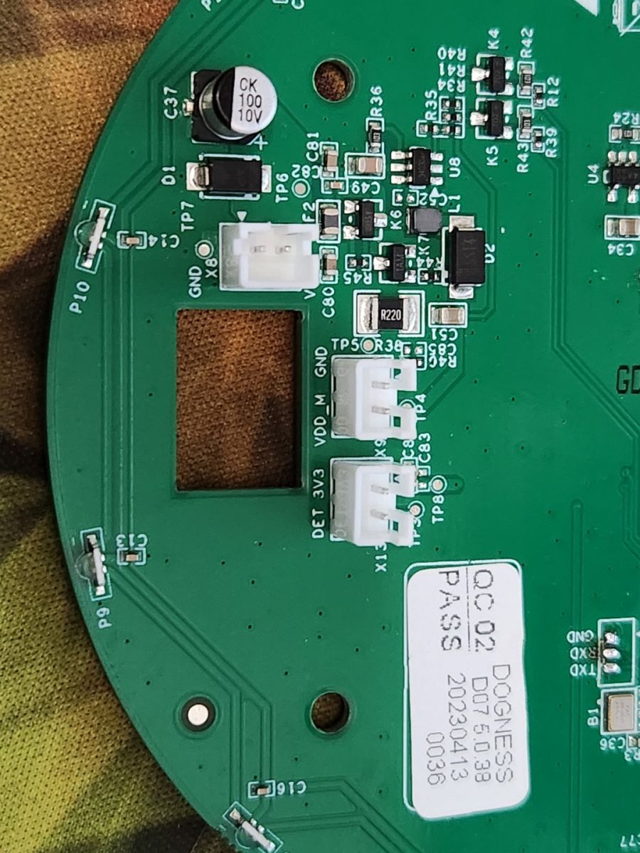

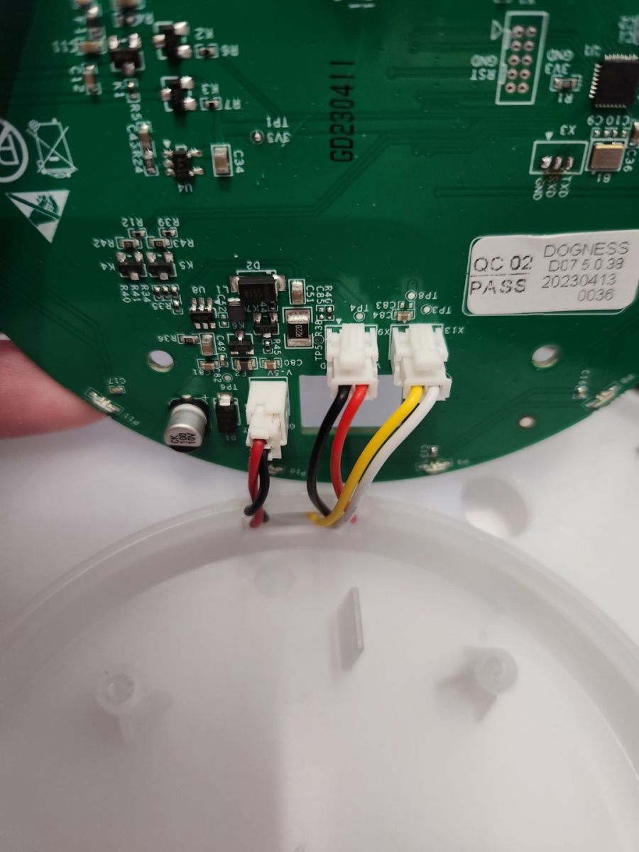

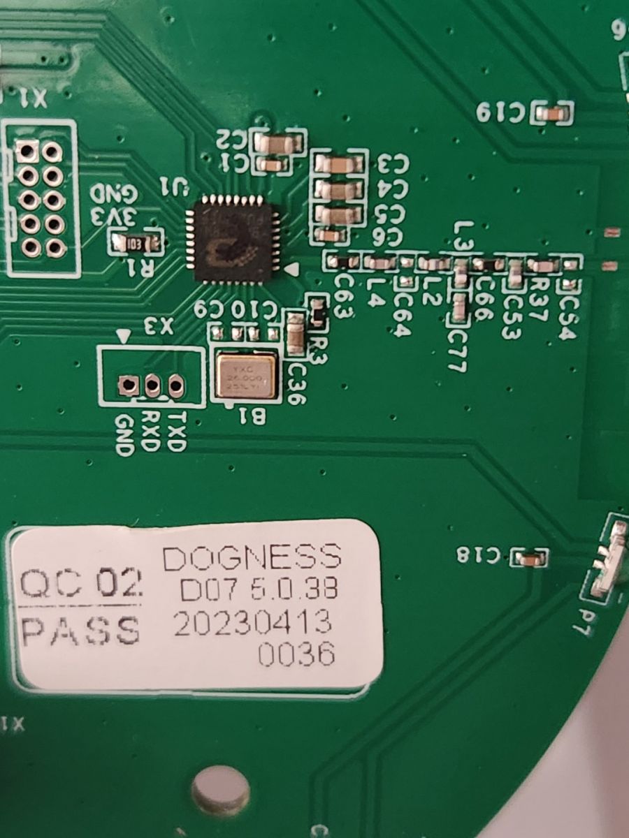

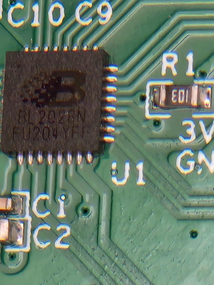

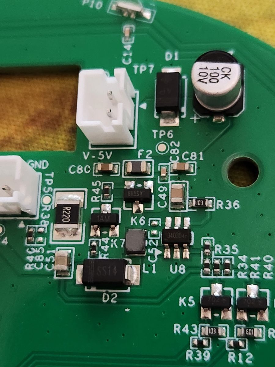

    All the images I have taken, would be keen to know if anyone has a good place to get a cheap bdm frame or similar, I like the look of PCBite probe kit but its too expensive for my use cases.

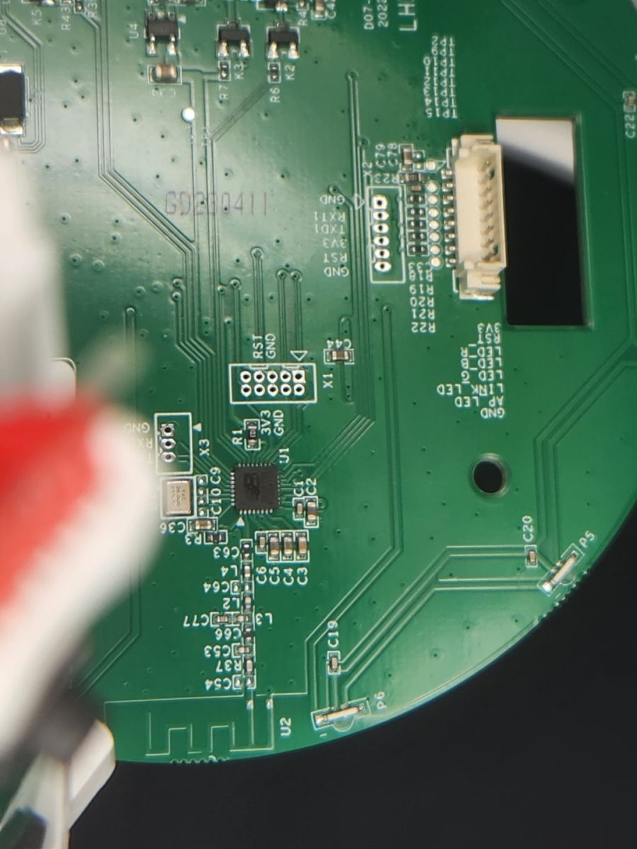

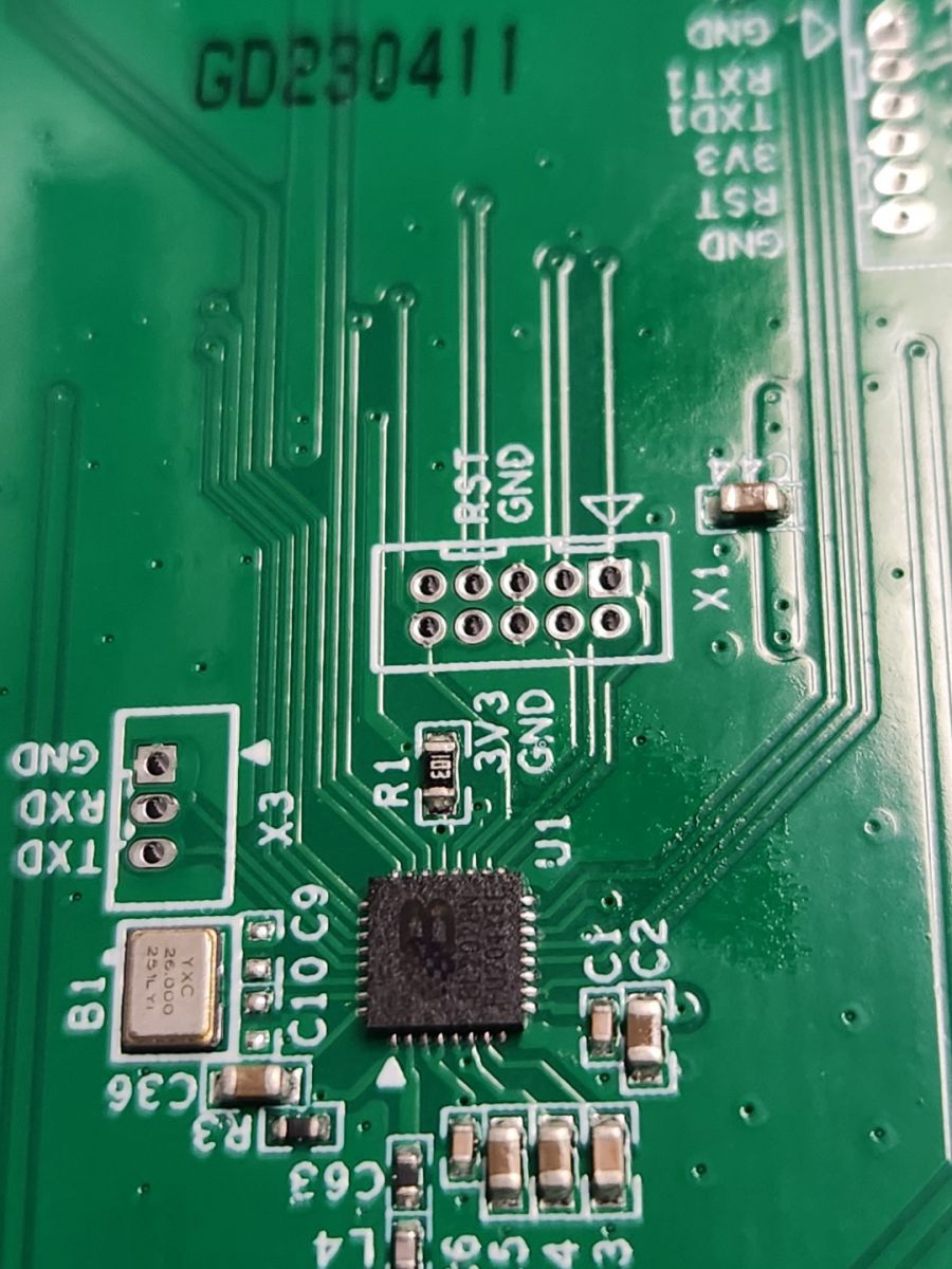

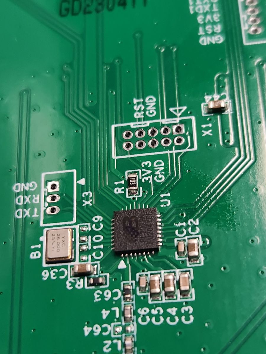

    Printed circuit board with connected wires Close-up of a Dogness device circuit board showing TXD and RXD pins with various electronic components. Close-up of a circuit board with multi-colored wires. Image of a circuit board with a microchip and a sticker with information. Circuit board with markings DO7 6.0.3B and 20230413. Mainboard of an electronic device with visible components and connected cables. Close-up of a circuit board with visible soldering points and an integrated circuit. Close-up of a circuit board with various electronic components. Close-up of a green circuit board with a semiconductor and soldering points visible. Close-up of a circuit board with electronic components, including a chip and connectors. Close-up of a circuit board with a BL2023N chip and surrounding electronic components. Close-up of BL2023N integrated circuit on a circuit board. Inside a smart device showing a PCB and connected wires. Photo of a PCB board of an electronic device with visible components and labels. Round PCB with markings, components, and connectors. Integrated circuit on a green printed circuit board with DOGNESS D07 5038 label and pin markings. Dogness device printed circuit board with visible electronic components and wires. Printed circuit board with electronics and connectors. Close-up of a circuit board with various electronic components.
    • readResult_BK7231N_QIO_dogness_clean_2024-25-5-20-20-44.zip (635.39 KB) You must be logged in to download this attachment.

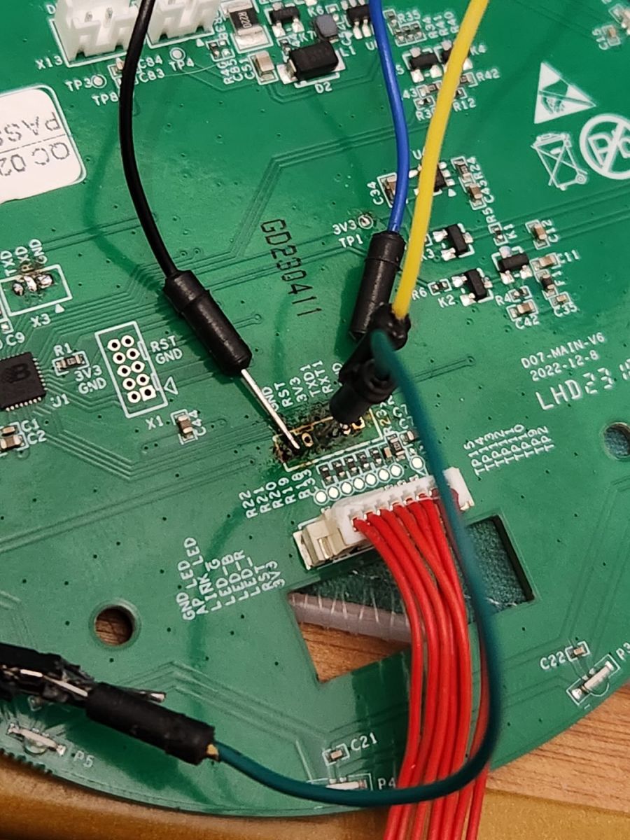

    Usual problem is power.
    How do you power device after flashing? Serial adapter probably doesn't have enough current capability. You need to power it from an external regulator or from the original source.
    Also log in Beken firmware on BK7231T comes from TX2/RX2 uart. That's different from the one used for flashing. Which one are you trying to use?

    >>21096055This is good suggestion, I did think of this though, apologies I forgot to add this to the post, it was actually one of the last things I tried before posting this, powered it off the normal power supply.
    It also posts while attached to the serial adapter with its stock firmware which is how I got the logs from the other serial pins.

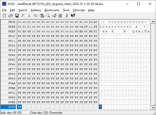

    Try flashing 2MB binary full of 0x00 bytes and you will see that RT thread message persists. Bootloader is... somewhere outside on N.

    Oh that's a shame, I imagine this is something that's already been investigated? As at this point I'm up for more risky options and flashing a new bootloader seems like fun 😊
    Is there anything I can check allow me to create a custom binary?
    I also considering that I could transplant bk7231n from another device, I have a bunch of rf blind controller I picked up on clearance that either have an N or T, haven't checked which as yet will be one or the other though.
    The other item is I know from ghidra that the firmware layout is quite different from tuya devices, this isn't likely to affect anything? Was kinda thinking given I flashed another devices tuya stock firmware this likely would rule that out though as I tried flashing openbeken after that which resulted in the same boot issue.

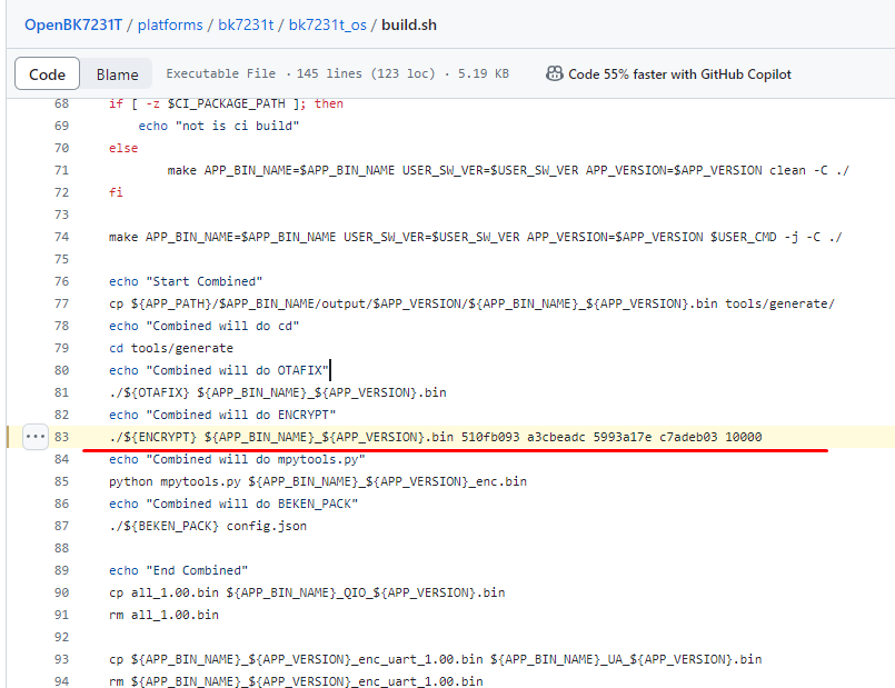

    #9 21103288
    Posts: 14796
    Rate: 12953

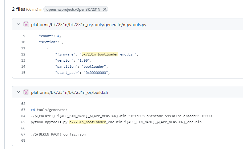

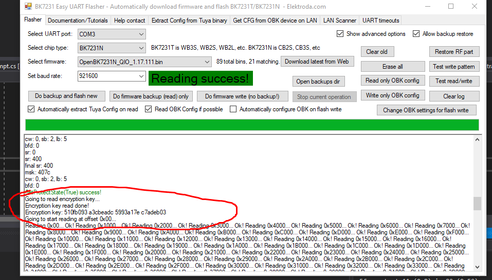

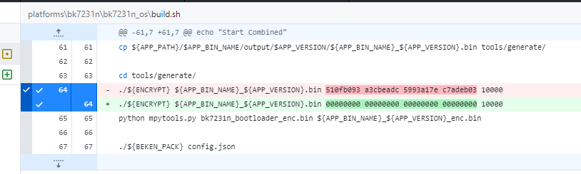

    So they just use 0000 as encryption key? Well that certainly wouldn't be hard to guess.
    So I need to change key here:
    Screenshot of a text editor showing a highlighted build script line related to encryption.
    @terryb8s are you willing to help me testing that so we can add those binaries to OBK builds?

    Posts: 14796
    Rate: 12953

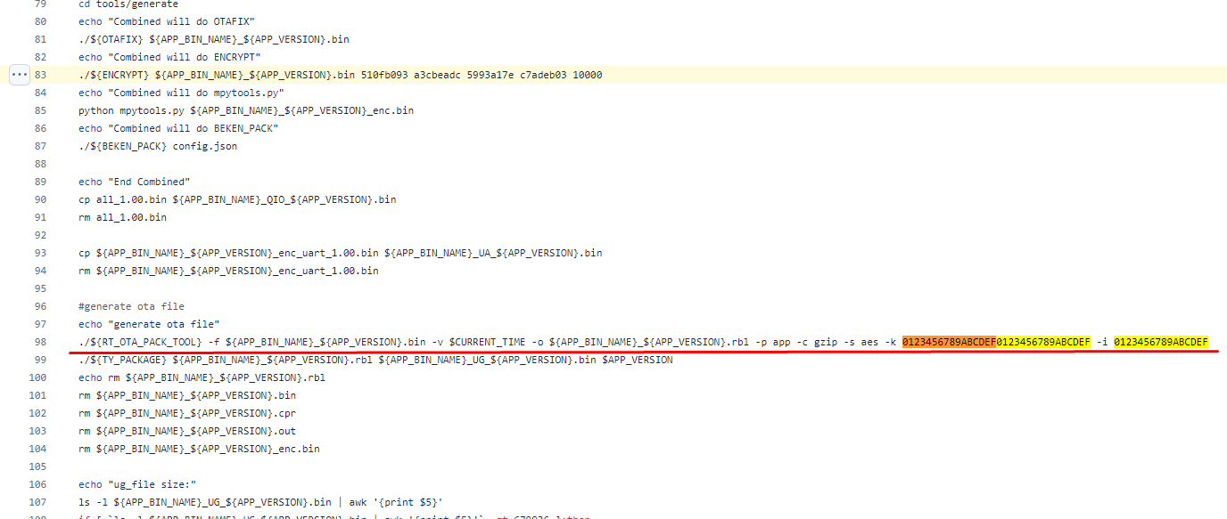

    AES keys seems unchanged so I need to investigate more:
    Screenshot of a code snippet featuring commands related to encryption and file generation.

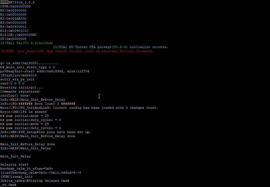

    Got it working this morning :)
    Performed full erase.
    Flashed 0x0 to 0x10000 from factory goodness backup
    Flashed starting 0x10000 the OpenBK7231N_QIO_1.0.0.bin provided
    Had to do RF restore to get AP working.
    Not sure if the image is cut down in any way pwn seemed to not work on P7 which was working previously.
    I also see an error before it starts the OS about OTA
    Terminal screen view with boot logs for BK7231n device showing errors and success messages.

    I see, so in order to add support of that to our builds, I need construct a binary from 0x0 to 0x10000 your bootloader, then with OBK data?
    Why was restore RF required? Or maybe... maybe it makes sense, if this has totally different firmware, then RF partition was not present at all?
    Did you do restore RF on your first OBK attempt?
    I need to compare original 2MB dump with our RF patition to know what's there.

    I don't know what kind of mystery is going on in that RF partition, but I was aware that in some rare cases doing my "restore RF" fixes broken WiFi. That being said, I had some devices with broken RF (MAC ending with 00 00 00) and they still had WiFi working, except for the MAC duplicate issue (with cleared MAC, both devices had the same MAC, ending with 00 00 00).
    Anyway, it's again late night in my country, so (hopefully) tomorrow morning I will try to replicate what you said in the build script and add binaries to main releases...
    I can see that there is our bootloader here:
    https://github.com/openshwprojects/OpenBK7231...r/platforms/bk7231n/bk7231n_os/tools/generate
    So I will have to paste dogness boot here and adjust script to support both versions...
    https://github.com/search?q=repo%3Aopenshwpro...%2FOpenBK7231N%20bk7231n_bootloader&type=code
    Script snippet from the OpenBK7231N project showing bootloader configuration.
    So I guess, for now, I need to take that into a conditional statement:
    Code: Bash
    and call N SDK build twice from Github workflow yaml

    Ok so I made a 0x10000 file from backup from the first post:
    Screenshot of the XVI32 program showing the editing of a binary file with numerous FF values.
    I've added it here:
    https://github.com/openshwprojects/OpenBK7231...mmit/5f19b009a83056a34c16e84e205547bbad3cddfa
    I also modified scripts to allow extra argument to select build type:
    https://github.com/openshwprojects/OpenBK7231...mmit/2fc6ba04b25c577abe91e5c9edb5adc76d1b6a35
    https://github.com/openshwprojects/OpenBK7231...mmit/0dd12d65a28099184f3166727cda6238bd8c131c
    However, I am now getting some Tuya packager error, so more is to come..
    Start Combined
    Using zero keys mode - for those non-Tuya devices
    /**< @author <jiewu@bekencorp.com> */
    /**< @version v0.3.1 */
     encrypt without crc successfully!
     -file size: 0xc2610
        "count": 4,
        "magic": "RT-Thread",
        "section": [
                "firmware": "bk7231n_bootloader_zero_keys.bin",
                "partition": "bootloader",
                "size": "68K",
                "start_addr": "0x00000000",
                "version": "1.00"
                "firmware": "OpenBK7231N_App_1.0.0_enc.bin",
                "partition": "app",
                "size": "1150832",
                "start_addr": "0x00011000",
                "version": "1.00"
        "version": "0.1"
    beken packager V2.0.0
    Shanghai Real-Thread Electronic Technology Co.,Ltd
    load_config: config.json
    partition    flash_name       phy addr   size       logic addr size       file
    bootloader   beken_onchip_crc 0x00000000 68K        0x00000000 64K        bk7231n_bootloader_zero_keys.bin
    app          beken_onchip_crc 0x00011000 1150832    0x00010000 1083136    OpenBK7231N_App_1.0.0_enc.bin
    [Error]: partition [bootloader] overflow, 65536 ==> 69664 > 69530!
    make: *** [Makefile:6: all] Błąd 127
    Added after 22 [minutes]:

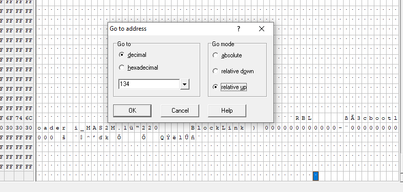

    69664-69530=134 ... 134 bytes too much in my bootloader, did I accidentally cut too much? Where would that lead me?
    Screenshot of a hexadecimal editor showing binary data with navigation set to address 134.
    Those are just 0xFF bytes, I think I can strip them
    Added after 8 [minutes]:
    edit: no, still error:
    [Error]: bk7231n_bootloader_zero_keys.bin please input a file without crc
    I may just manually write that bootloader into generated qio...
    Added after 57 [minutes]:
    hm maybe I can just dd it::
    	dd if="bk7231n_bootloader_zero_keys.bin" bs=1 count=65536 of="$TEMP_FILE"
    	dd if="${APP_BIN_NAME}_QIO_${APP_VERSION}.bin" bs=1 skip=65536 of="$TEMP_FILE" seek=65536
    0x10000 or 0x11000 ?

  • #29 21108294
    terryb8s
    Level 4  
    Posts: 41
    Rate: 8
    Oh i see the WiFi error is gone in the boot.txt I attached, this was captured after a reboot...
    I tried another reboot and it happened again though... weird.
    • Boot2.txt (8.69 KB) You must be logged in to download this attachment.

    #30 21108341
    Posts: 14796
    Rate: 12953
    I added encryption key reading to flasher, can you get latest build:
    https://github.com/openshwprojects/BK7231GUIFlashTool/releases/tag/v1.2
    And do just "Do firmware backup (read) only)" and show me what is there:
    Screenshot of BK7231 Easy UART Flasher tool showing reading success.
    Can you check if it's working for you and what's it showing?
    I used 0x10000, see here:
    https://github.com/openshwprojects/OpenBK7231...mmit/cf30fbec6d8ba48b2a70f5d8d23b5c980a304146
    	mv "$TEMP_FILE" "${APP_BIN_NAME}_QIO_${APP_VERSION}.bin"
    	echo "Successfully overwrote bootloader."
