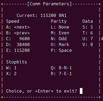

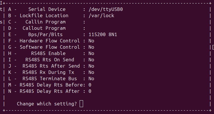

    I don't quite understand what's going on with your log capturing.
    Presumably no AP still?
    Minicom set to 8N1, no flow control?

  • #38 21887972
    mkrum001
    Posts: 41
    With the latest one:
    Code: Bash
    minicom settings
    Tuya XR806 RT-WT501 flashed with OpenXR806 via phoenixMC, no AP or logs?

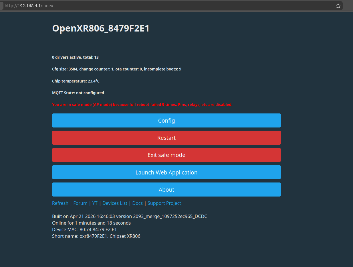

    please try this build
    • OpenBK7231T_App_2093_merge_1097252ec965_OpenXR806_DCDC.zip (1.09 MB) You must be logged in to download this attachment.
  • #40 21888294
    mkrum001
    Posts: 41
    I'm flashing the first device. Dump from the 2nd one is working fine on the first device - I have shared logs from it already.
    And with the last one we have progress!
    Flash chip config mismatch likely caused the boot issue

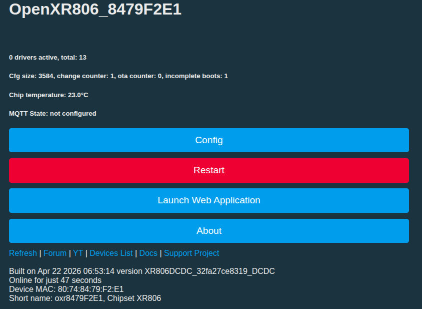

  • #45 21889162
    mkrum001
    Posts: 41
    Both work, but if you need logs I can do this tonight.
    OpenXR806_8479F2E1 status screen with buttons: Config, Restart, Launch Web Application, About
    Screenshot of OpenXR806 status page with Config, Restart, and Launch Web Application buttons.

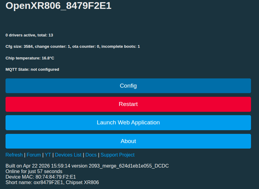

  • #54 21890247
    mkrum001
    Posts: 41
    With
    OpenXR806_2093_merge_624d1eb1e055
    does not start AP and no logs at all.
