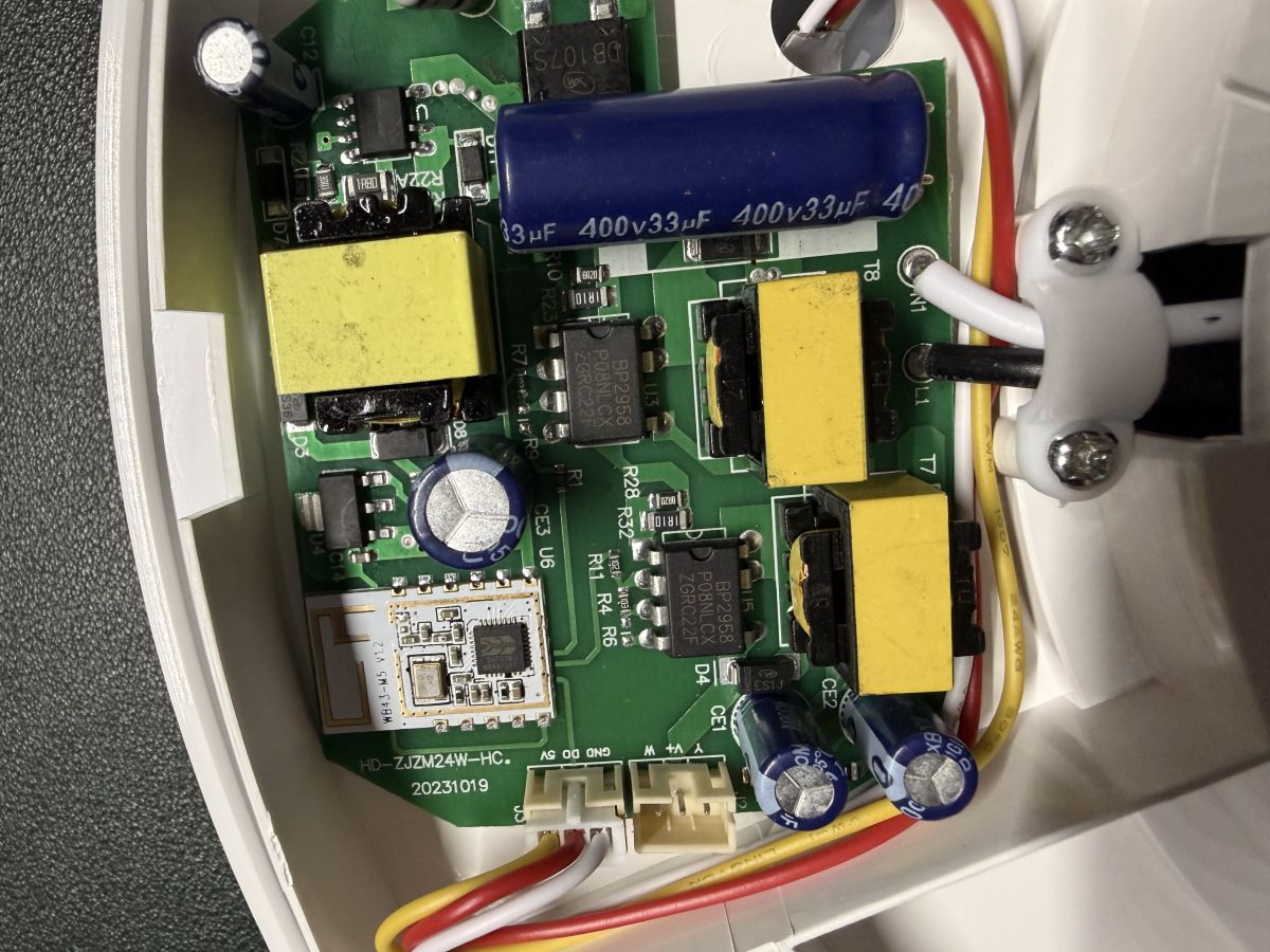

    You can flash it with OpenBK7238, but doing so requires desoldering the module. RX/TX pins are on the back of the module.
    RGB would be easy, since it uses addressable LEDs (DO pin). You would only need to count how many RGB LEDs there are.
    If you decide to go that way, always take backups of the original firmware.

    Yesterday night, I flashed it with OpenBK7238.
    Instead of desoldering the module, I tried the side GPIOs, and it worked great!!
    1. I made a backup of the original firmware (attached file).
    2. Flash with OpenBK7238 old version > boot crashed.
    3. Flash again with your last version of OpenBK7238 merged > all working!! Great job @insmod
    4. Now the challenge is setup the modules of it.
    I will count the LEDs and try to discover more...

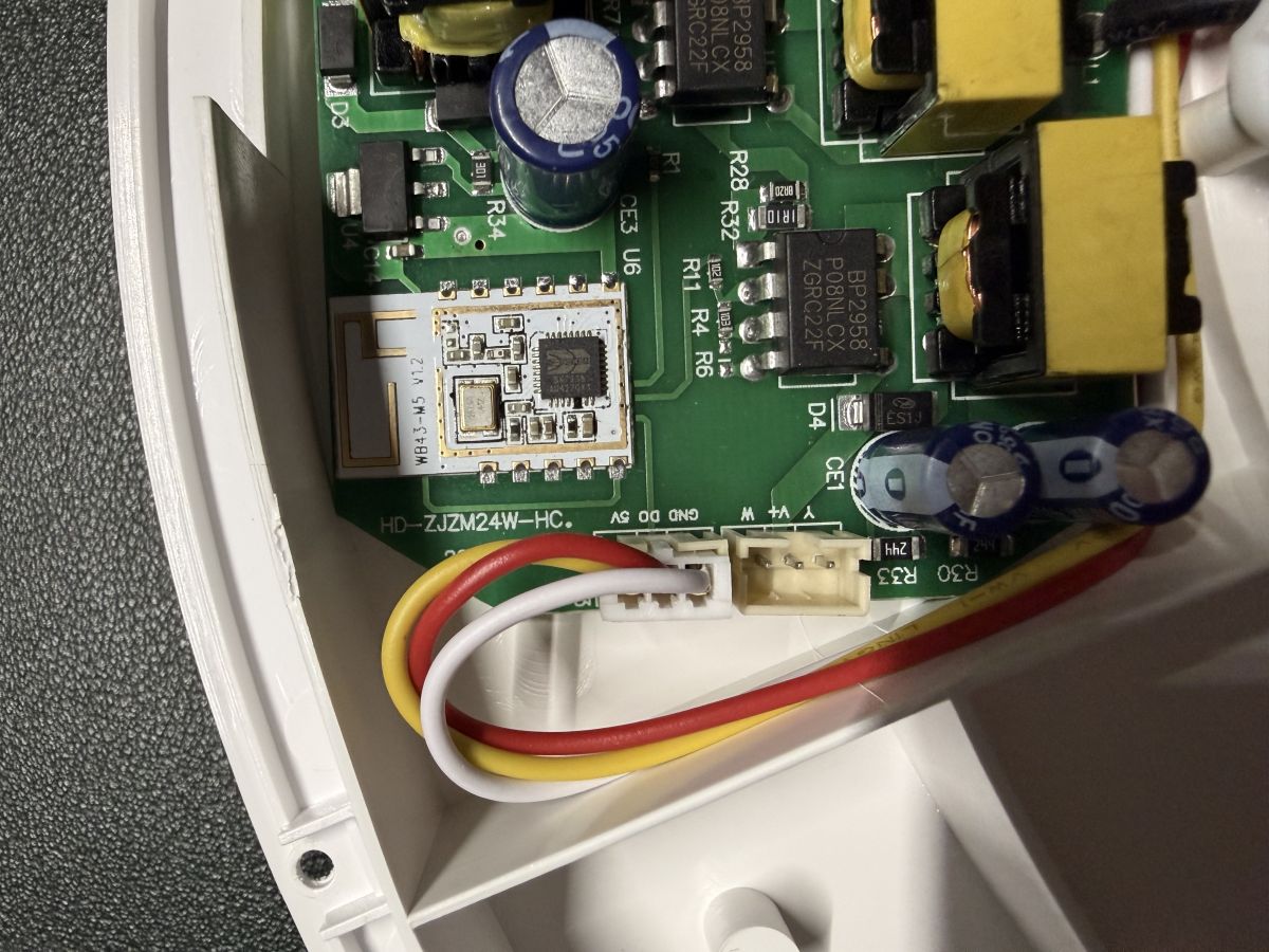

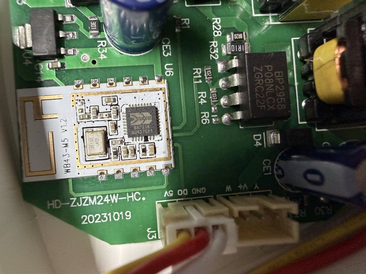

    Hardware details
    • Module: WB43-M5 v1.2
    • Main chip: Beken BK7238
    • PCB: HD-ZJZM24W-HC
    • RGB ring: 38 LEDs (addressable, likely SM16703P or similar)

    #5 21884583
    insmod
    Posts: 1431
    Help: 168
    Rate: 455
    >>21884507
    Update to last OpenBK7238 version, 1.18.287
    Before using SM16703P commands, first use "start driver SM16703P"
  • Firmware merges white and RGB into one light entity

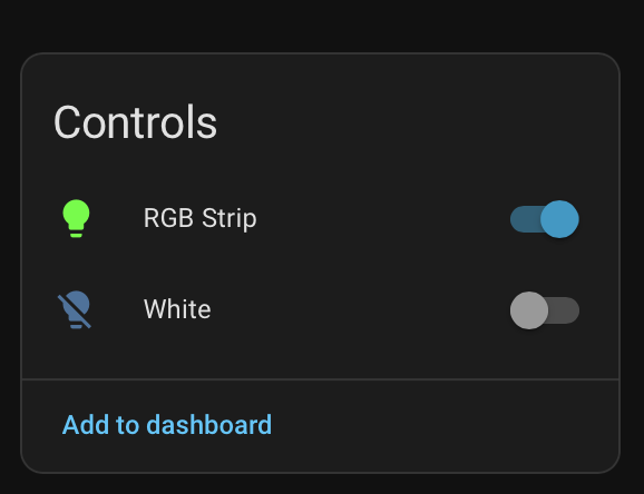

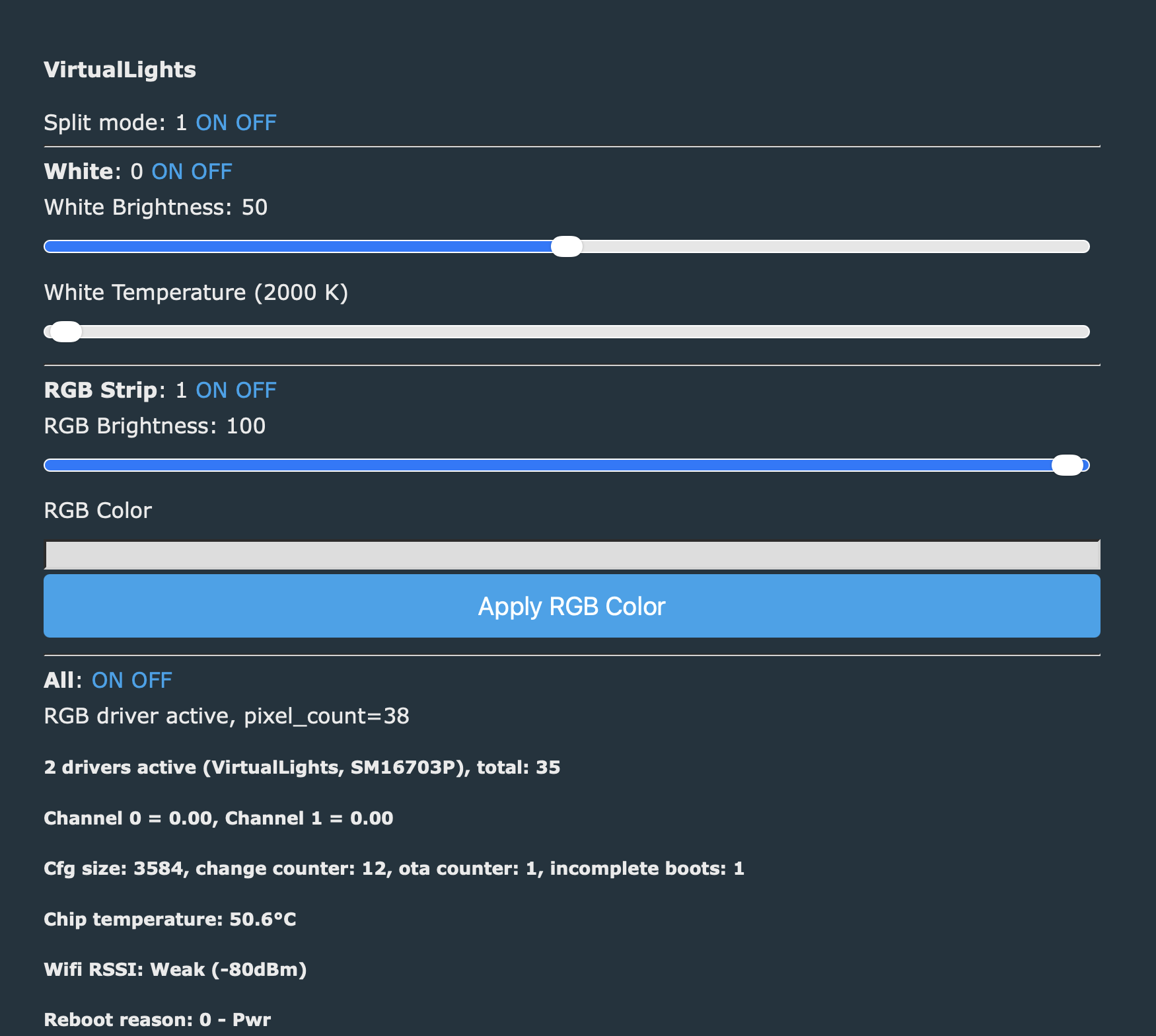

    I’ve been experimenting with the firmware and managed to put together a solution that better reflects how these hybrid RGB + CCT devices are actually wired.
    What I did
    I introduced a new driver concept called virtualLights, which splits the global light control into two independent logical lights.
    Instead of a single combined entity, the device is now exposed as:
    Device
    ├── Light 1: White light
    │ ├── PWM warm white (P6)
    │ └── PWM cold white (P8)
    └── Light 2: RGB light
    └── SM16703P_DIN (P16)
    How it works
    * White (CCT) → standard PWM channels
    * RGB → handled by SM16703P (addressable LEDs over SPI)
    * virtualLights driver → splits control into two independent entities
    Startup configuration
    This is the current startup setup:
    backlog startDriver SM16703P; SM16703P_Init 38 GRB; SM16703P_Start; startDriver VirtualLights; VirtualLights_Enable 1;
    Result
    * Two separate light entities
    * White and RGB fully independent
    * No mode conflicts (e.g. white vs RGB overrides)
    * Better alignment with the actual hardware design
    Design note
    The virtualLights split can be optional.
    The idea is to make it a flag-based feature, so users can choose:
    * VirtualLights_Enable 1 → split into two lights
    * VirtualLights_Enable 0 → fallback to classic single light behavior
    This keeps backward compatibility while enabling a more accurate setup for devices that need it.
    Next steps
    If there’s interest, I can prepare a pull request with the changes (driver + integration).
    Happy to get feedback or adjust the implementation 👍

    “Controls” panel with toggles for “RGB Strip” and “White” plus an “Add to dashboard” link

    oh wow. this looks cool.
    and if you decide not to start VirtualLights driver, does SM16703P behave as it did originally in all ways? I'm just wondering what the impact would be for anyone with a fully-configured device for basic SM16703P operation if they OTA to a release that includes code changes for this if it was merged.

OpenBeken single light Works Works after driver start One merged light entity
OpenBeken + VirtualLights Works Works Two separate logical light entities

  • Hardware confirmed in the thread: WB43-M5 v1.2 module, Beken BK7238 SoC, HD-ZJZM24W-HC PCB, and an addressable RGB ring reported as 38 LEDs by the user’s working setup. [#21884507]
