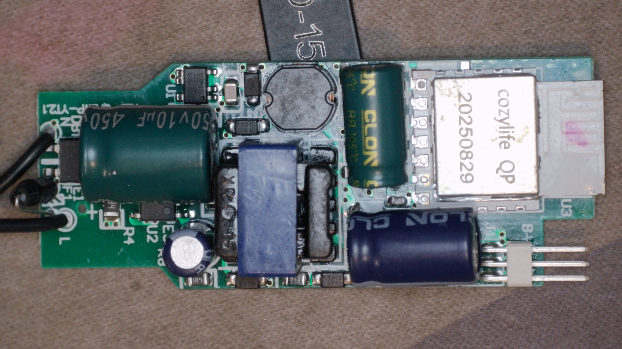

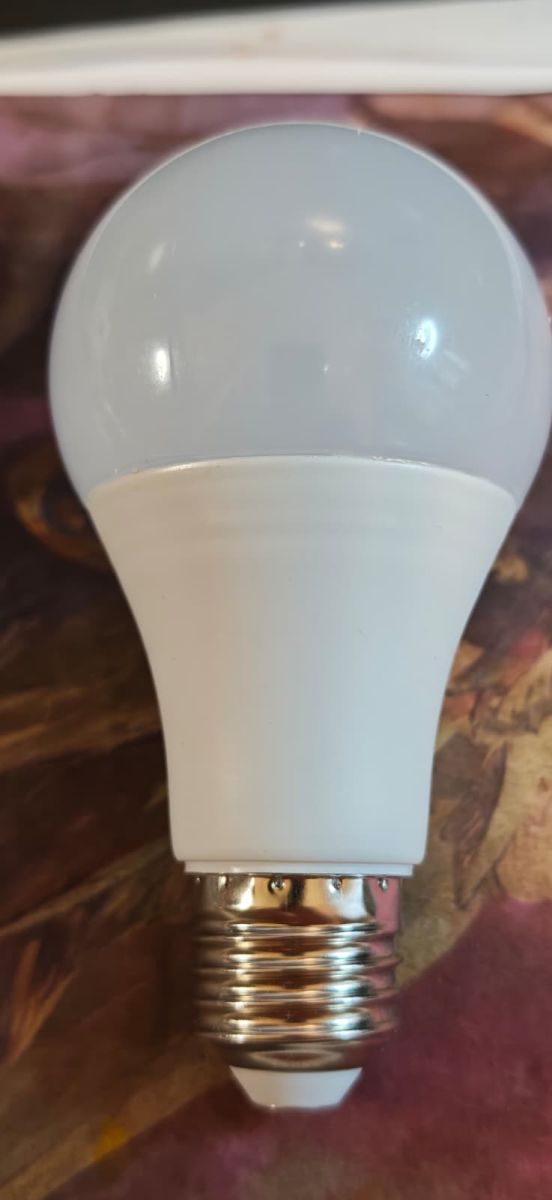

    The Cozylife RGBCW 18W bulbs from China have arrived.
    White LED light bulb with frosted dome and metal screw base on a patterned surface Round RGBCW LED PCB with SMD LEDs and connector, labeled XL W60-RGBCW “Smart Bulb” box with a colorful bulb graphic and labels for RGB and 2700–6500K adjustable white. Back of RGBCW LED bulb package with RGB color bar and 2700–6500 K color temperature scale Label on Wi‑Fi E27 RGBCW 18W bulb box with barcode and 2700–6500K adjustable range
    original:
    Cozylife RGBCW 18W TW-805, W803-E400 - how do I set the pins in OpenW800?

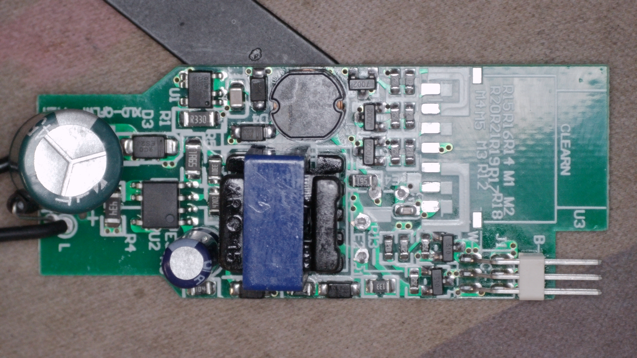

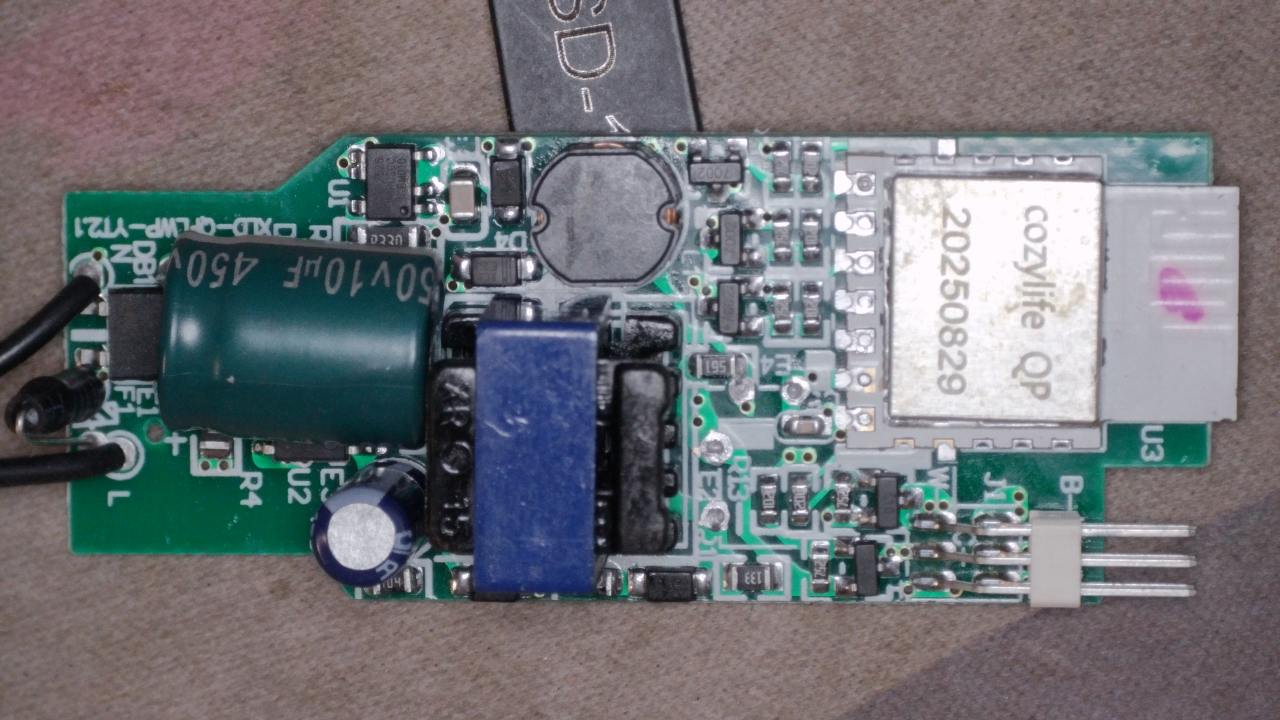

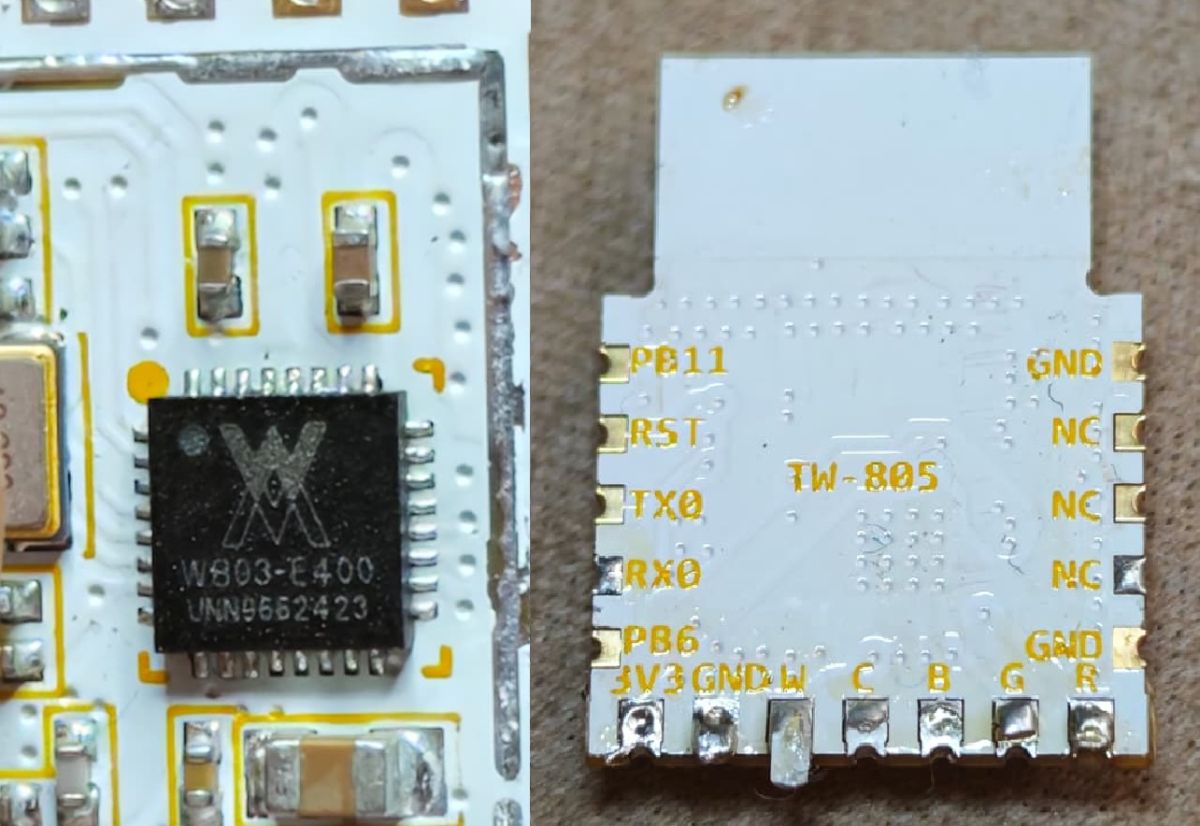

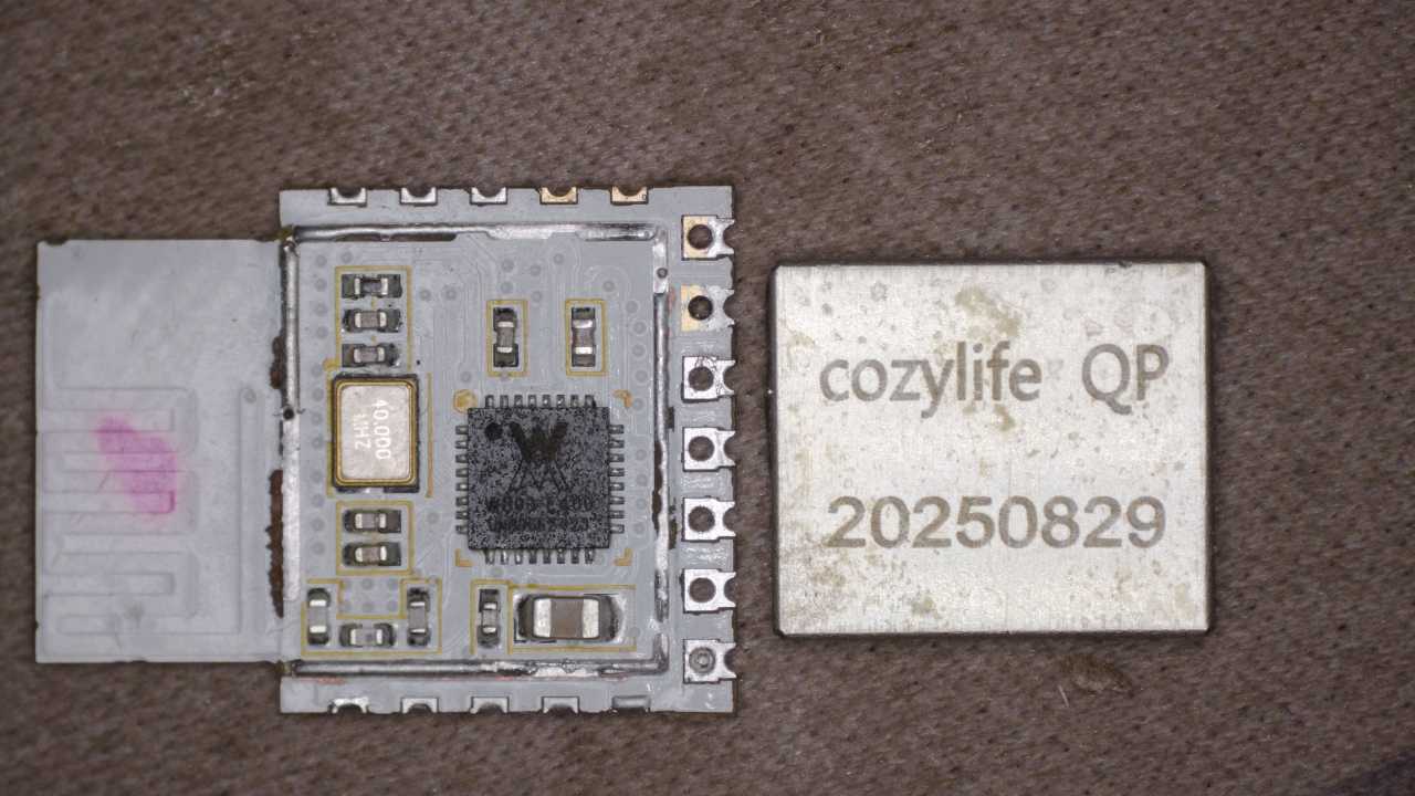

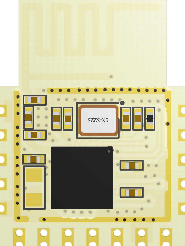

    TW-805 module and W803-E400 chip.

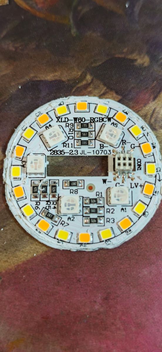

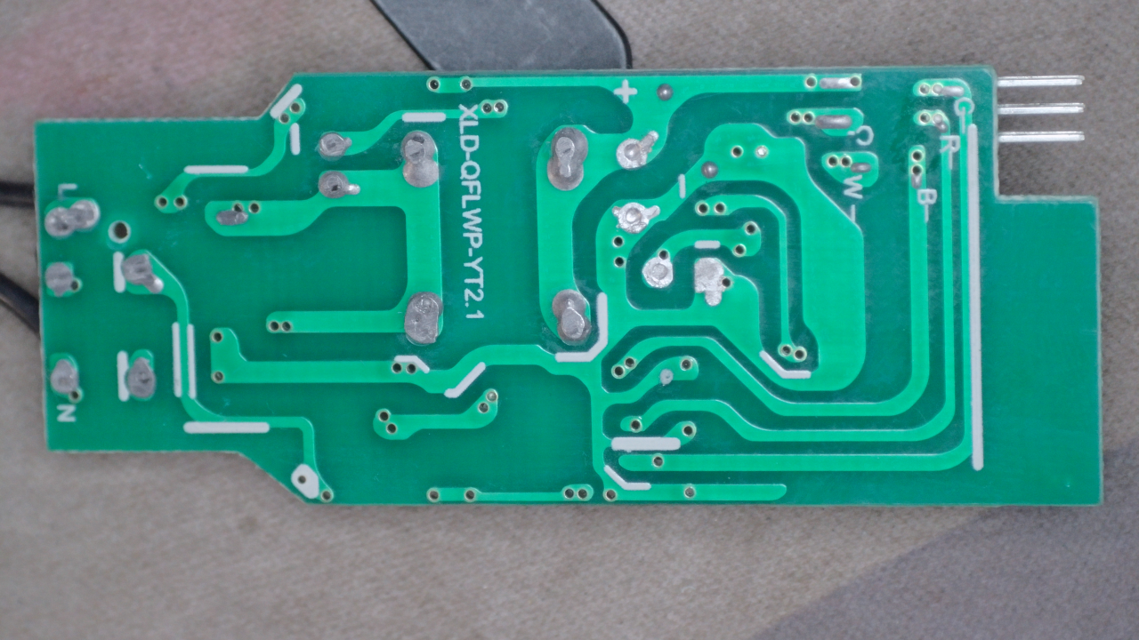

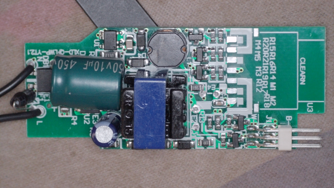

    more photos
    Cozylife RGBCW 18W TW-805, W803-E400 - how do I set the pins in OpenW800? Close-up of a green controller PCB with capacitors, inductor, SMD parts, and a 3-pin connector Close-up of a green PCB with power-supply components and a printed PCB antenna Green PCB underside with traces and solder pads; four-pin header protruding on the right Close-up of a PCB with “cozylife QP 20250829” module and power-supply components Close-up of a power supply PCB with capacitors and a shielded module labeled “cozylife QP” Close-up of a power supply PCB with capacitors and a shielded module labeled “cozylife QP”

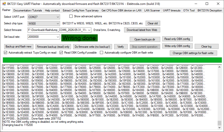

    BK7231GUIFlashTool-build-318 doesn't seem to be able to detect or read the flash properly:
    Sync attempt 32/1000 failed... Sync success! Flash ID: 0xFFxx13 Flash size is 0MB ROM version: 8 Sending stub... Stub uploaded! Sync success!
    i tried manually setting Start Offset: 0x0 Length: 0x200000 :
    Sync attempt 38/1000 failed... Sync success! Flash ID: 0xFFxx13 Flash size is 0MB ROM version: 8 Sending stub... Stub uploaded! Sync success! Changing baud to 115200, will resync... Sync success! Read block at 0x000000...Failed to get response! Retrying... Read block at 0x000000...Failed to get response! Retrying... Read block at 0x000000...Failed to get response! Retrying... Read block at 0x000000...Failed to get response! Retrying... Read block at 0x000000...Failed to get response! Retrying... Read block at 0x000000...Failed to get response! Retrying... Read block at 0x000000...Failed to get response! Retrying... Read block at 0x000000...Failed to get response! Retrying... Read block at 0x000000...Failed to get response! Retrying... Read block at 0x000000...Failed to get response! Retrying... Read block at 0x000000...Failed to get response! Retrying... Read block at 0x000000...Failed to get response! Retrying... Response error count exceeded limit, stopping! Changing baud to 115200, will resync... Sync success! Changing baud to 115200 There was no result to save.
    I haven't tried flashing the BK7231GUIFlashTool yet, maybe on the next one I'll give it a try (lots of problems with boot and sync and upgrade_tools goes just give RST)

    a different W803. that's interesting. definitely get a backup of the next one if you can, it could help with IO mapping (and it'll be a nice addition to the FlashDumps collection), though there is also the GPIO dr in web app:
    https://www.elektroda.com/rtvforum/topic3976371.html
    Added after 5 [minutes]:

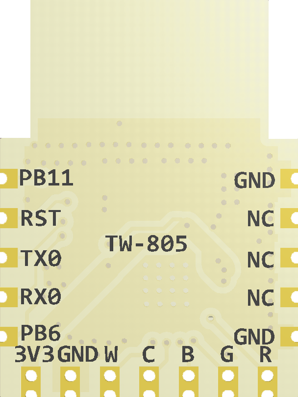

    PWM IOs listed here anyway https://www.cozylife.app/product/zh/hardware/wifi/tw-805.html
    pinsymbolI/O typeFunction
    1GNDPPower reference ground
    2NC/
    3NC/
    4NC/
    5GNDPPower reference ground
    6PA7I/OPWM_4
    7PB0I/OPWM_0, UART3_TX
    8PB1PPWM_1, UART3_RX
    9PB2I/OPWM_2. UART2_TX
    10PB3I/OPWM_3. UART2_RX
    11GNDPPower reference ground
    12VCCPModule power supply pin (3.3V)
    13PB6I/OUART1_TX
    14PB20I/OPWM_1, UART0_RX (Default download port)
    15PB19PPWM_0, UART0_TX (default download port)
    16RST/The module enable pin is active high, indicating that the module has been pulled high. This pin can be externally controlled by the user.
    18PB11I/O
    Close-up of an electronic module with ICs and SMD components on a yellow PCB Close-up of a PCB section with pin labels such as PB11, RST, TX0, RX0, plus GND and NC

    I found the pins in the WEBapp GPIOfinder
    "pins": {
    "7": "PWM;1",
    "16": "PWM;2",
    "17": "PWM;3",
    "18": "PWM;4",
    "19": "PWM;5"
    Even works nicely :)
    I made a second piece because in the first one I must have damaged something along the way, because it gently excites in the dark and doesn't work dimming only full colours at 100% (maybe I'll come back to it again)
    as for reading the flash (I still have a few pieces unmoved) just hint with what, because I am not as proficient as you :) and it looks like BK7231GUIFlashTool is erroneously detecting the flash.

    OK sure. I have W800s/W803 to test to be sure Easy Flasher works OK.

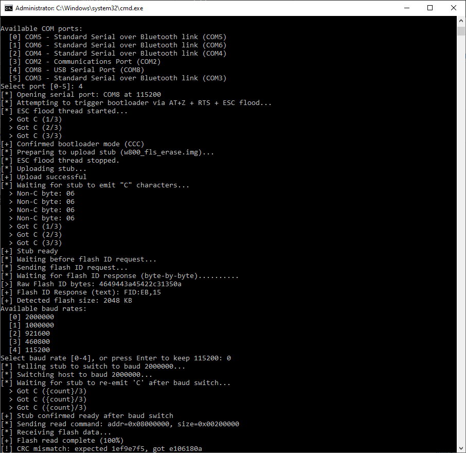

    Are you grounding RST pad briefly just as Easy Flasher flash read operation tries to begin?
    Power-on flasher workaround for TW-803 flash read
    #5 21912418
    Posts: 5220
    Help: 449
    Rate: 918
    I wasn't able to read the flash of the TW-803 module using Easy Flasher and TW-803 does not expose PA0 to strap it into download mode. The script here does however work https://www.elektroda.com/rtvforum/topic4134923.html
    Windows cmd.exe screenshot showing COM port log for flash read, ending with a CRC mismatch error
    I'm trying to see what can be done to make EF behave like the script in the ways that matter.
    Curious though that yours still says sync success and says it's read a flash ID- even though it doesn't look like a valid ID - I'm not getting that
    Added after 2 [hours] 8 [minutes]:
    @prucho please try the attached flasher. it should catch flash read on power-on/RST
    • BK7231GUIFlashTool - 2026-05-30T084709.152.zip (1.18 MB) You must be logged in to download this attachment.

    Super!
    Dump read several times at different baudrates and is identical, so it looks correct.... It would be useful if someone would extract the data of the save procedure and make at least a script to save the whole backup bin file, so you can go back to the original.... I attach the file to the first post.

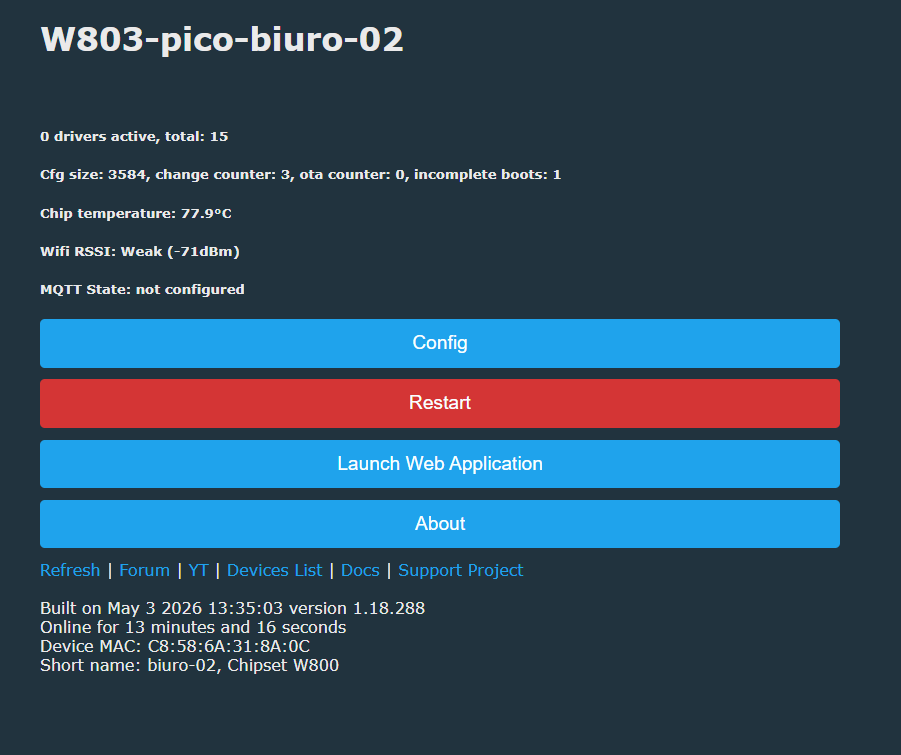

    Suggest reducing LED brightness to prevent overheating
    #7 21912997
    Posts: 14770
    Rate: 12913

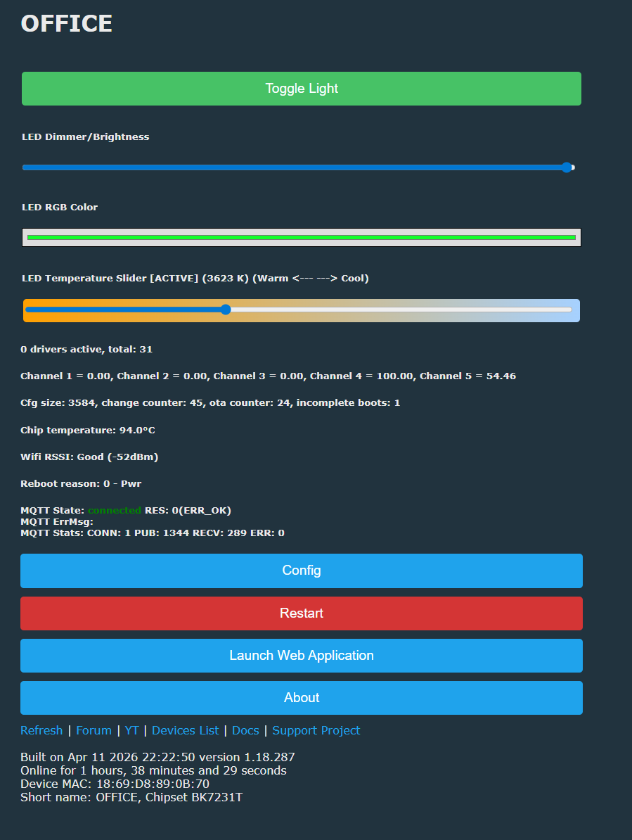

    I haven't seen the W803 yet, thanks for sharing. Have you checked how hard the LEDs heat up after a long run? These Chinese products are not geared for longevity. Might be worth reducing the LED brightness a bit programmatically so this light doesn't overheat. Related material:
    [EN] How much does a Wi-Fi controlled Tuya LED lamp overheat? Changing the firmware and extending the life
    [EN] How hard does a Wi-Fi controlled Tuya LED lamp heat up? Changing the firmware and extending the life

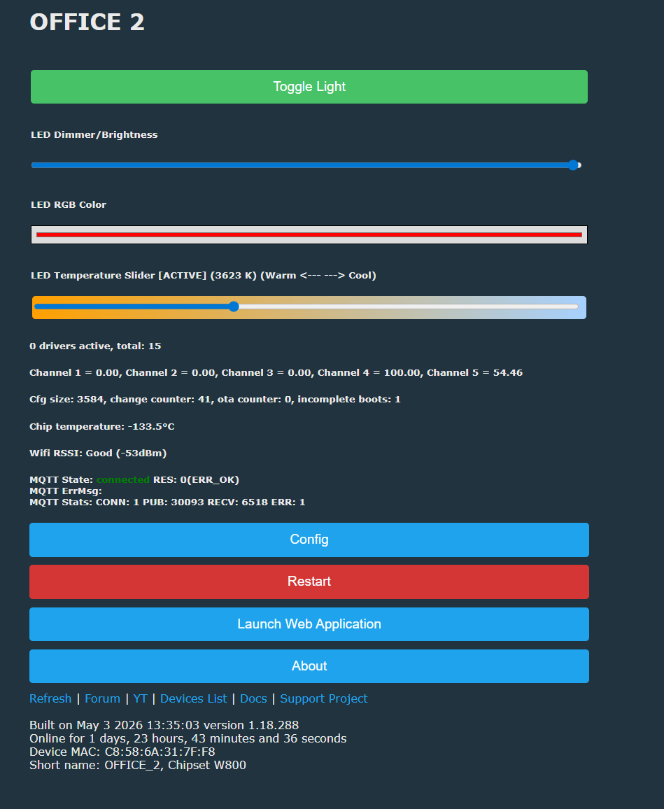

  • W803 reports much higher chip temperatures than BK7231
    #8 21913021
    prucho
    Posts: 13
    >>21912997
    I don't have an IR camera to hand unfortunately, I can only check with a simple laser meter. They actually heat up a lot, this aluminium housing inside under the plastic is supposed to dissipate the heat, only that the electronics are sealed, no air circulation inside.... but surprisingly I have about 7 of these bulbs still Tasmota and BK7231 in daily use for about 4-7 years and not one has died yet....
    Another small observation, could this be a firmware bug or a measurement error in the device itself? I've noticed that the BK7231 shows a chip temperature of around 50 degrees at rest and around 94 degrees at long run at full, while the W803 shows 75 at rest and 133 degrees at long run, 3 pieces of W803 the same. On the other hand, the chassis at long run BK7231 and W803 with laser meter at similar around 70 degrees

    very good. your success was with the build of Easy Flasher GUI that I posted?
    I'm not sure what you mean about the scripting. Easy Flasher supports full flash read and write for W80x.
    I have flashed your backup and it boots
    Screenshot of BK7231 Easy UART Flasher showing “Writing done” and a hex log output.

    I did the read flash with the w800_flash_read_crc_flush_double.py script with no problems, briefly RST to ground and everything worked from the snap.
    What I meant was, is there already a py script like w800_flash_read_crc_flush_double.py, but to upload the whole backup file.
    Easy uart flasher does not respond to RST either read flash or write flash. Those logs I had before, there some horrible combinations I did and after many attempts sometimes this flash misrecognition appeared....
    I'm about to desolder another module from another bulb and test again with easy uart flasher....

    The attachment
    above is a special compilation that should work more like a script. Please test it if possible
  • OpenW800 backup succeeds despite CRC retries
    #12 21913188
    prucho
    Posts: 13
    >>21913170
    oh yes! this version of gui works, lots of crc error but repeats and goes on.

    Read done for 2097152 bytes!

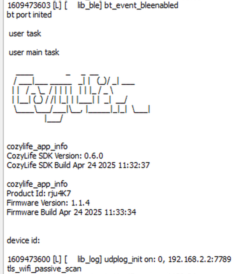

    the write works perfectly, I uploaded this backup from the first post as well as the one read just now and the module gets up correctly
    cozylife_app_info
    CozyLife SDK Version: 0.6.0
    CozyLife SDK Build Apr 24 2025 11:32:37
    cozylife_app_info
    Product Id: rju4K7
    Firmware Version: 1.1.4
    Firmware Build Apr 24 2025 11:33:34
    device id:
    1609473600 [L] [     lib_log] udplog_init on: 0, 192.168.2.2:7789
    BT mac:c8586a302adf
    1609473600 [L] [     lib_ble] ble mac: c8:58:6a:30:2a:df
    1609473600 [L] [     lib_ble] bt_event_bleenabled
    bt port inited
    tls_wifi_passive_scan
    AP01  rssi:-70  channel:1  ssid:Heybroadband-13
    thanks

TL;DR: For Cozylife RGBCW 18W bulbs with a TW-805 and W803-E400, the working OpenW800 setup uses 5 PWM pins, and a 2MB flash backup can be read reliably if you briefly ground RST at sync. One tester confirmed, "this version of gui works." [#21913188]
Why it matters: This FAQ gives W803 bulb owners a repeatable path to map pins, back up the factory firmware, and avoid failed flash reads before installing OpenW800.
Tool / method Result in thread Key detail
BK7231GUIFlashTool build 318 Failed read Detected 0xFFxx13 and 0MB flash
w800_flash_read_crc_flush_double.py Worked Full dump read after brief RST-to-GND
Special Easy Flasher GUI build Worked Read 2MB with CRC retries; write also worked
Key insight: The pin map was solved, but the bigger breakthrough was backup reliability: standard detection failed on W803, while the script and a modified Easy Flasher succeeded when RST was timed correctly.
  • The successful OpenW800 map used 5 PWM outputs: pins 7, 16, 17, 18, and 19 assigned to PWM;1 through PWM;5. [#21912087]
  • The working GUI read identified flash as 0xEBxx15 with a size of 2MB, then completed a full read of 2,097,152 bytes. [#21913188]
  • The TW-805 module power pin is listed as 3.3V VCC, and its exposed pad list includes PWM-capable lines such as PB0, PB19, and PB20. [#21911916]
  • Reported temperatures differed sharply: BK7231 showed about 50°C idle and 94°C under long full-load use, while W803 showed about 75°C idle and 133°C under similar load. [#21913021]
  • Housing temperature measured by a simple laser meter was about 70°C for both BK7231 and W803 bulbs during long operation, despite the higher internal W803 reading. [#21913021]
How do I set the correct OpenW800 pins for a Cozylife RGBCW 18W bulb with a TW-805 module and W803-E400 chip?
Set OpenW800 to five PWM channels and map the bulb outputs to pins 7, 16, 17, 18, and 19. This mapping was found with the web-app GPIO finder and then confirmed to work on the Cozylife RGBCW 18W bulb using the TW-805 module and W803-E400 chip. The user reported that it "works nicely," which makes this the tested starting point for this hardware. [#21912087]
What pin mapping worked in OpenW800 for the Cozylife TW-805 / W803-E400 RGBCW bulb?
The working mapping was:
  1. "7": "PWM;1"
  2. "16": "PWM;2", "17": "PWM;3"
  3. "18": "PWM;4", "19": "PWM;5" This exact five-channel map was tested on the Cozylife TW-805 / W803-E400 RGBCW bulb and produced normal operation. It is the only pin map in the thread confirmed by actual use. [#21911833]
Why does BK7231GUIFlashTool detect the W803 flash as 0xFFxx13 with 0MB size, and how can that be fixed?
It misdetects the W803 flash because the standard tool build does not handle this module’s read sequence correctly. In the failed case, it reported Flash ID: 0xFFxx13 and Flash size is 0MB, then could not read blocks even with a manual 0x0 to 0x200000 range. The fix in the thread was to stop using that build and switch to either the Python read script or a special Easy Flasher GUI build tuned to catch read on power-on or RST. [#21911833]
What is the TW-805 module in Cozylife smart bulbs, and how is it related to the W803-E400 chip?
The TW-805 module is a Wi-Fi module board that carries the W803-E400 chip and exposes its power and I/O pins to the bulb electronics. In this bulb, the poster identified a TW-805 module with a W803-E400 chip on it, and another post linked the TW-805 pin table showing 3.3V VCC, GND, RST, and several PWM-capable pins. [#21911916]
What is the W803-E400, and how does it differ from the BK7231 used in other Wi-Fi bulbs?
"W803-E400 is a Wi‑Fi SoC/module variant that runs in W80x-based smart devices, exposes a different flashing behavior, and needs W800/W803-capable tools rather than BK7231-specific assumptions." In the thread, BK7231GUIFlashTool misread the W803 flash, while W800-targeted tools succeeded. The user also observed different chip temperature readings: BK7231 around 50°C/94°C and W803 around 75°C/133°C. [#21913021]
Which is better for reading and writing W80x flash backups: Easy Flasher GUI or the w800_flash_read_crc_flush_double.py script?
The Python script was the first proven reader, but the special Easy Flasher GUI became the better all-in-one option because it read and wrote full backups. The script read flash "with no problems" after a brief RST-to-ground action. Later, the modified GUI read all 2MB despite CRC retries and also wrote both the original backup and a fresh dump successfully. [#21913188]
How do I read the full original flash from a W803/TW-805 module before installing OpenW800?
Use a W800/W803-capable tool and take the backup before flashing OpenW800.
  1. Connect the module over UART and select W800 mode.
  2. Start a full flash read and briefly ground RST when sync begins.
  3. Save the complete backup and verify it by comparing repeated reads. In the thread, repeated dumps at different baud rates matched, which strongly indicated a correct factory backup. [#21912984]

Where can I find the GPIO or PWM mapping for a Cozylife TW-805 module if OpenW800 pin discovery is unclear?
Use the OpenW800 web-app GPIO finder first, then cross-check the TW-805 hardware page pin table. The user found the working pin map in the web-app GPIO finder, and another reply pointed to the Cozylife TW-805 page listing PWM-capable pins such as PB0, PB19, PB20, and PA7. Those two sources together narrowed the correct five-pin PWM setup. [#21912087]
