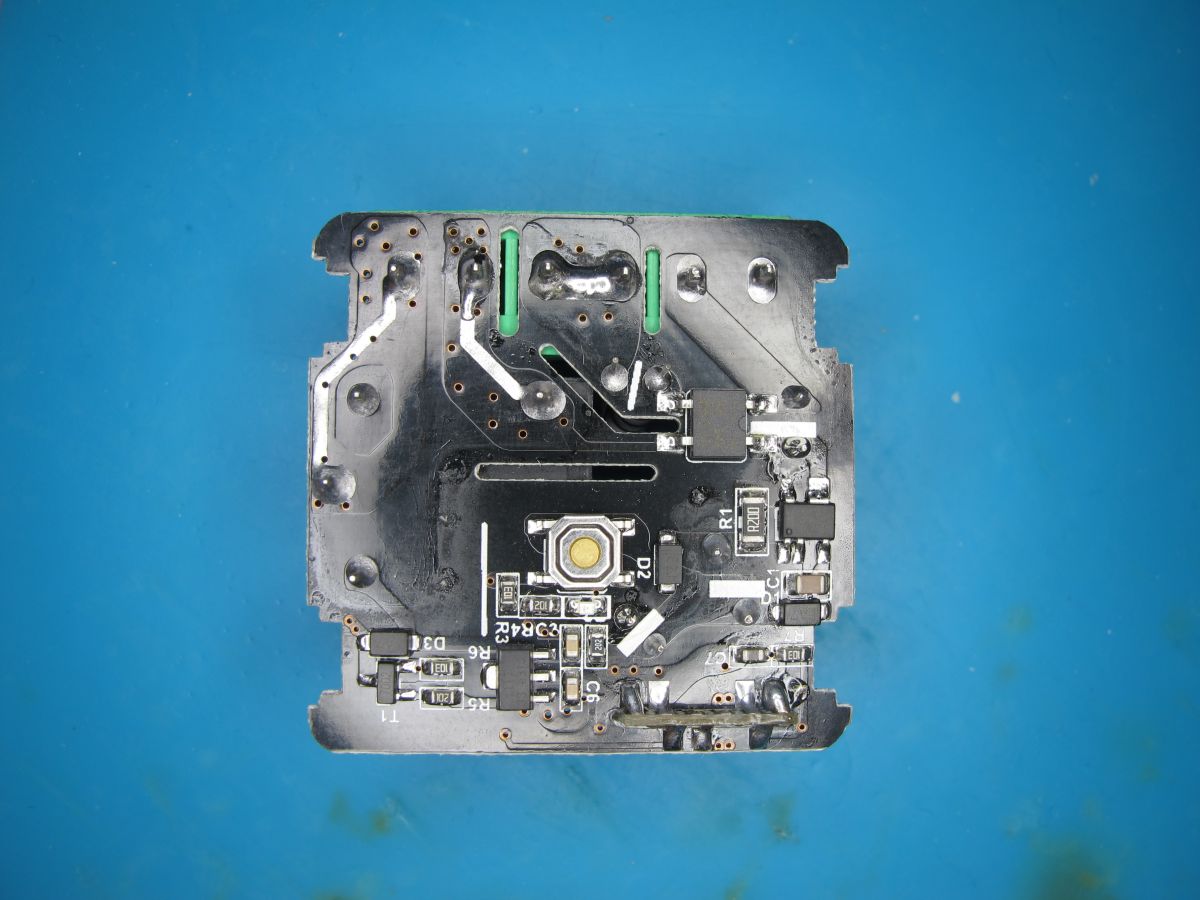

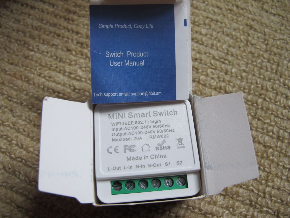

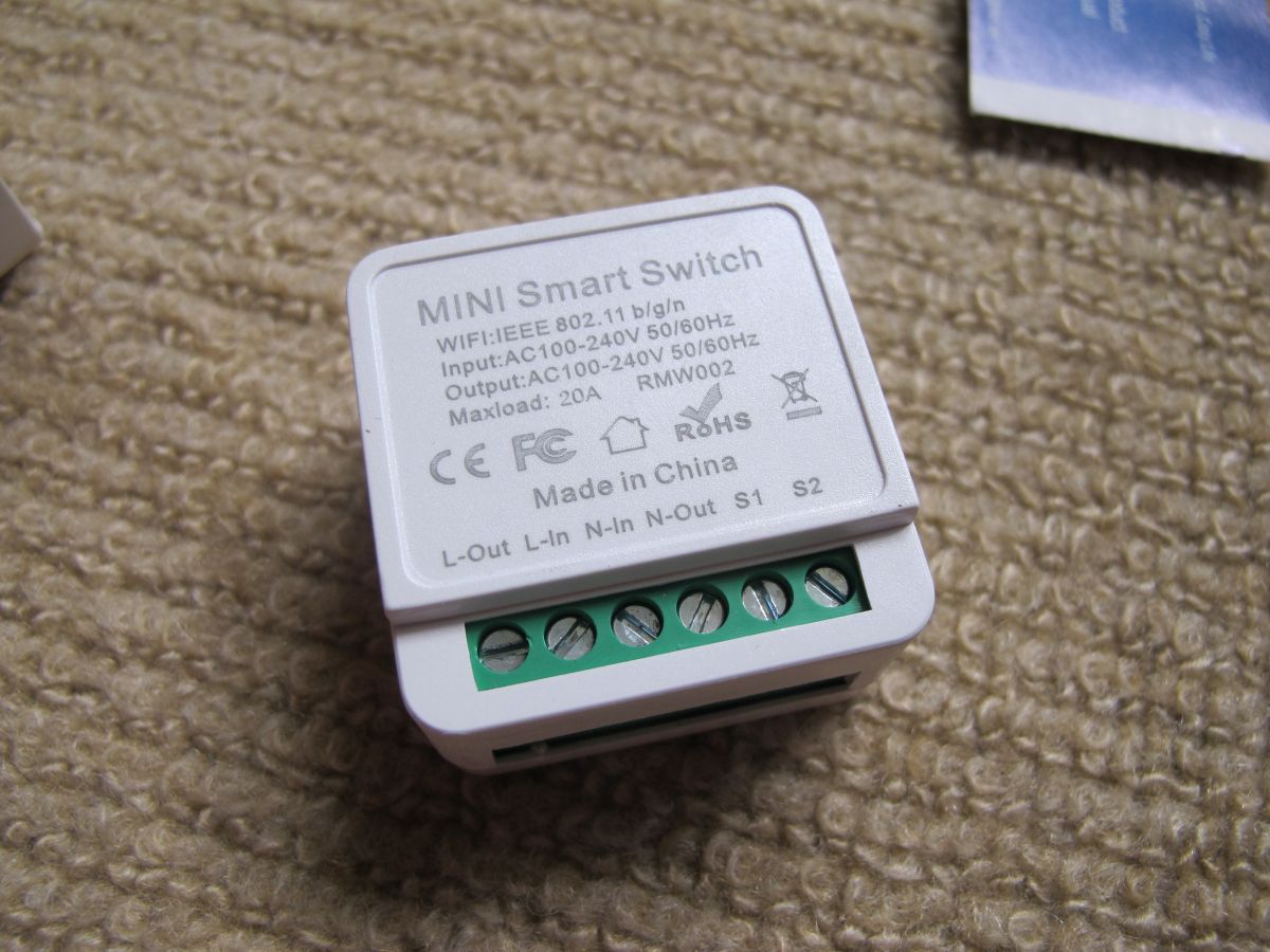

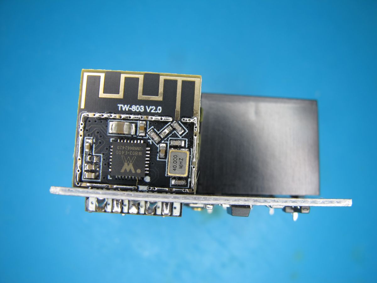

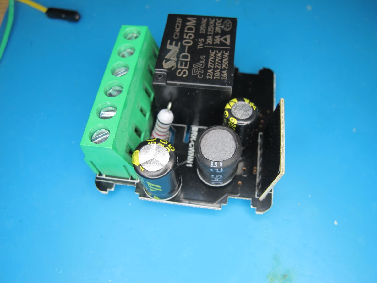

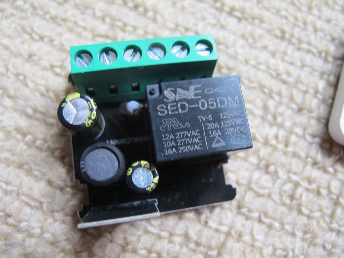

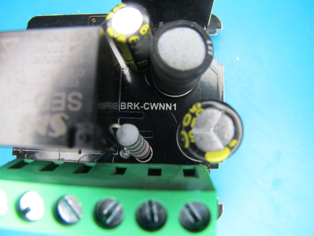

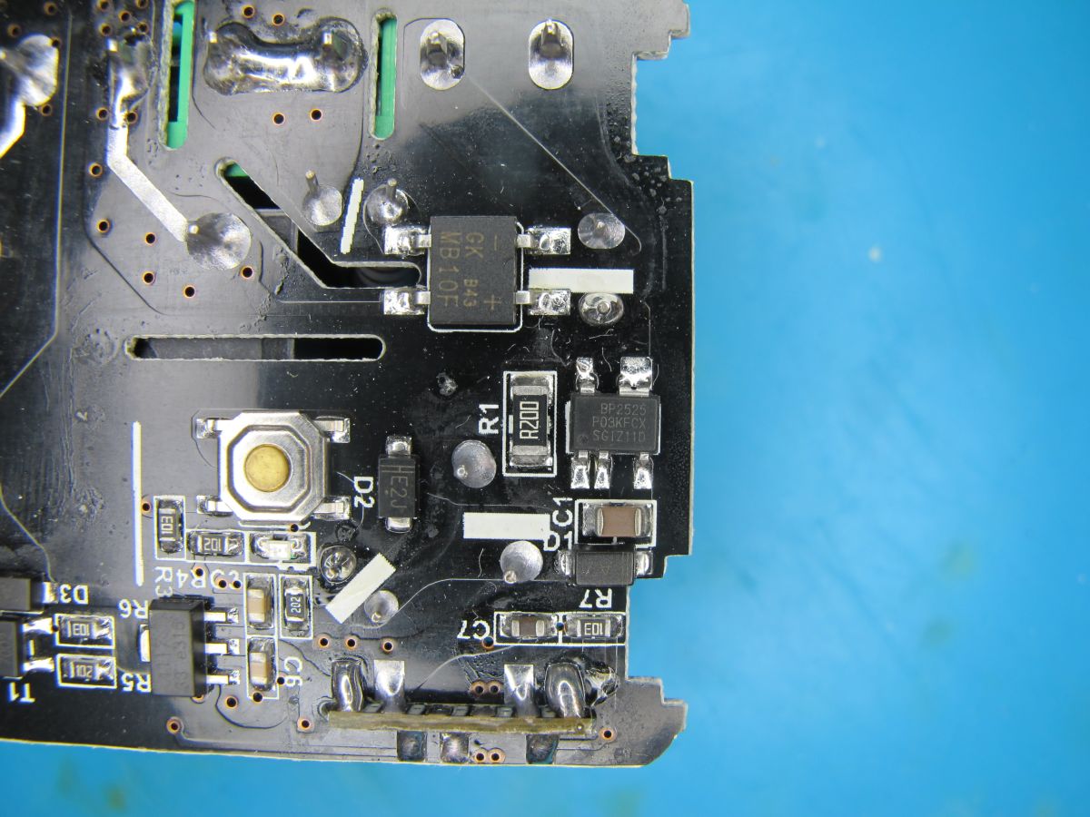

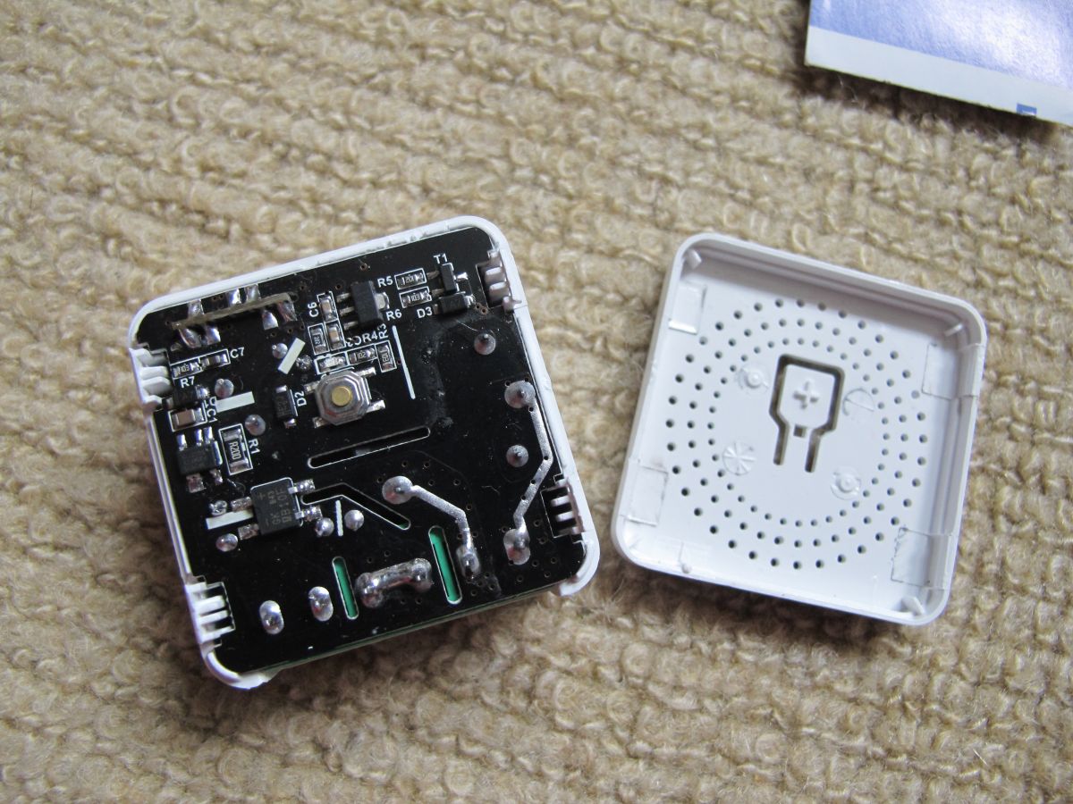

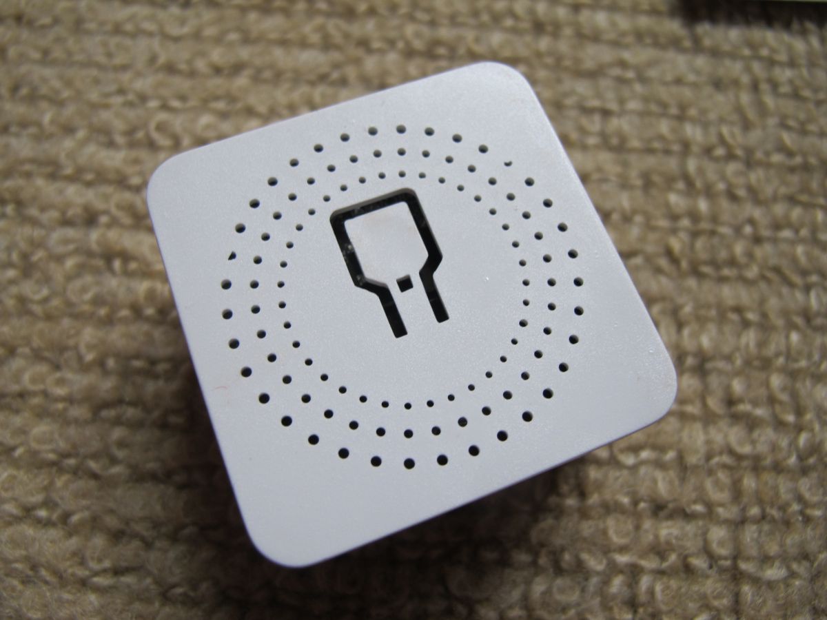

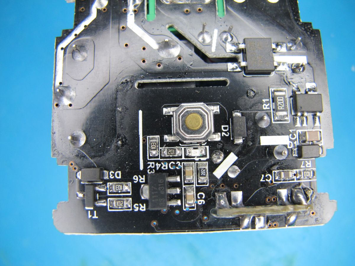

    This device is another one of those 16A "DIY" mini switch/breakers that has been seen with quite a few different MCUs, modules and PCB layouts. Without high expectations it was ordered in the off-chance something new and interesting was inside. This time there was!
    MINI Smart Switch 20A in open box on carpet Mini Wi-Fi switch with technical label and screw terminal ports on white casing White plastic device with ventilation holes and a black logo on top Disassembled electronic switch with black PCB board on carpet background SED-05DM relay module with capacitors and screw terminal block Close-up of PCB labeled BRK-CWNN1 with capacitors and screw terminal block
    TW-803 V2.0 module with W803-E400 chip mounted on a PCB board Relay module with capacitors and screw terminal on blue background Close-up of PCB with push button, transistors, and labeled SMD components Bottom part of black PCB with button, resistors, and connectors. Desoldered PCB with black solder mask, SMD components, and visible copper traces

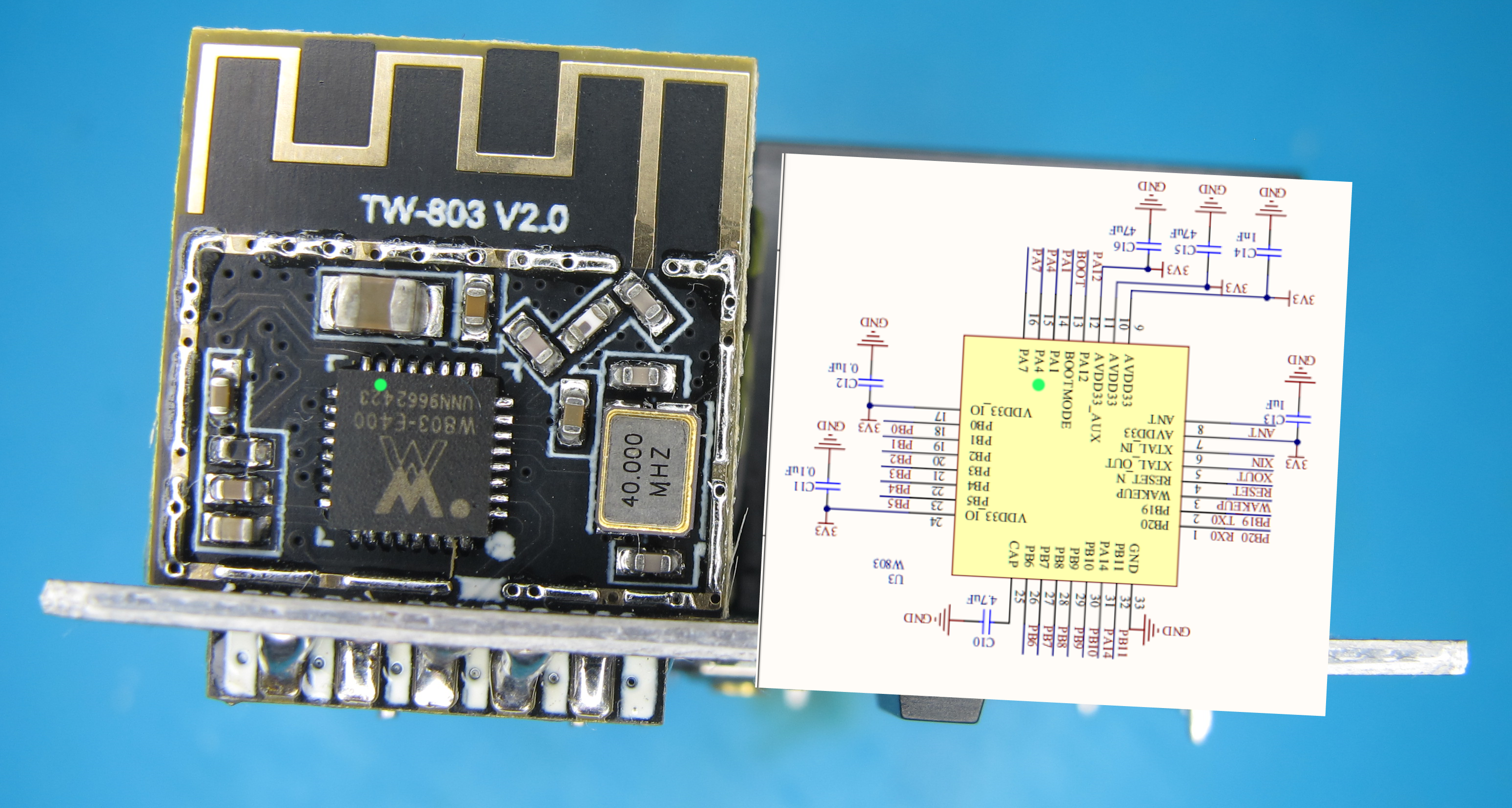

    A Winner Micro W803-E400 chip on a TW-803 module. I've never received a production device with a W80x in. I have W800/W801 dev boards only - the Hi-Link HLK-W800-Kit, HLK-W801-Kit, HLK-W806-Kit and a HLK-B36 module.
    It's the same CSKY/XuanTie XT804/CK804 architecture as the others. This family of chips is sometimes seen referred to as W80X.

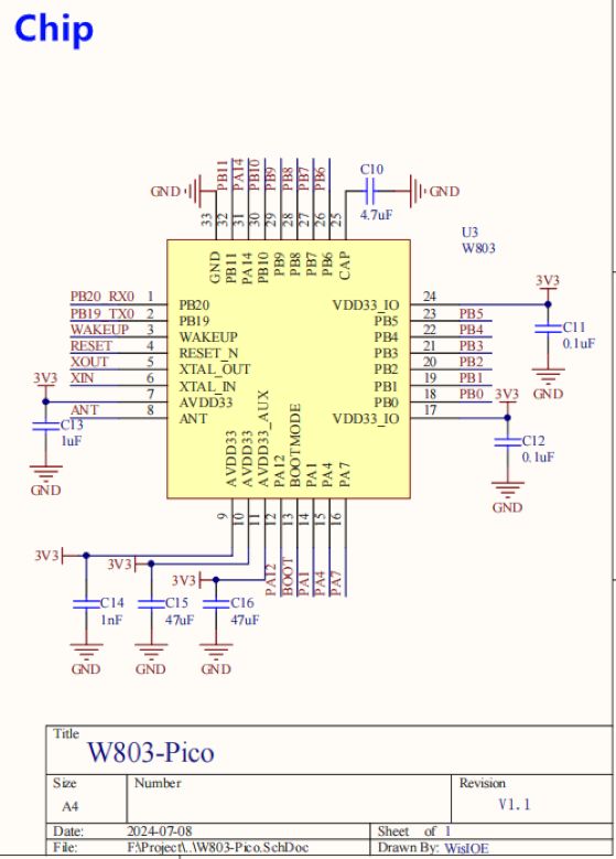

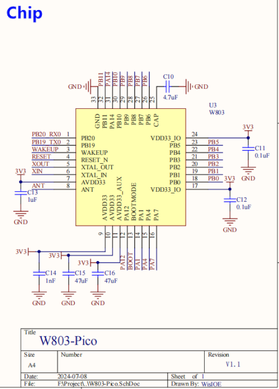

    And it seems there is a W803Pico board https://doc.winnermicro.net/w800/en/latest/get_started/w803_pico.html from which chip pins can be seen
    Pinout diagram for W803-Pico module showing microcontroller W803 wiring

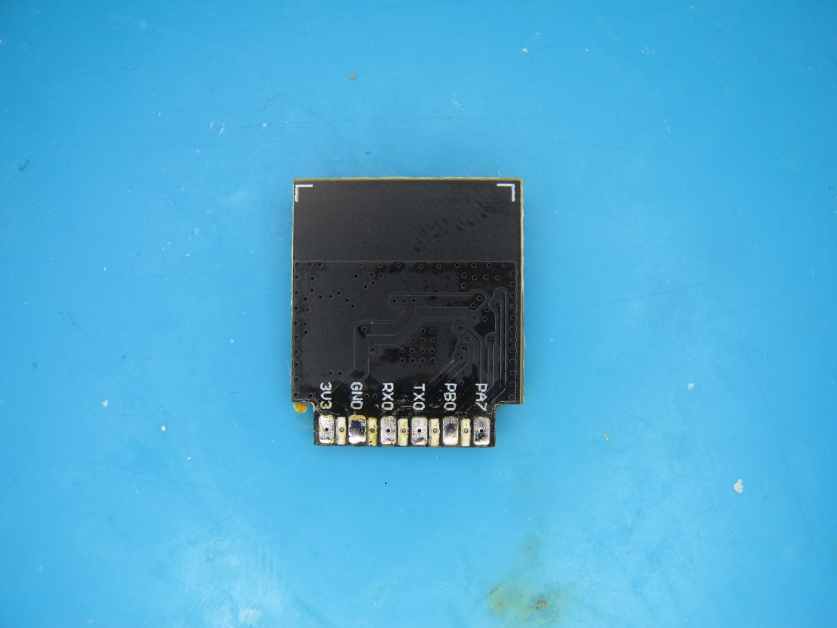

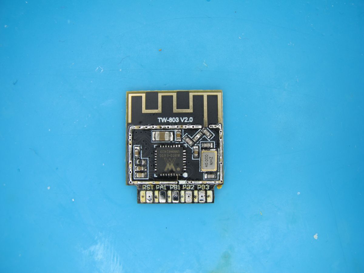

    De-soldered module
    TW-803 V2.0 electronic module with WinnerMicro chip on blue mat TW-803 electronic module with labeled pins, placed on a blue anti-static surface
    and from TX0 (PB19) we get the CozyLife boot log at 115200 baud
    Before I flash OpenW800, erasing the factory firmware, I'd like to give my Python/W80x stub flash reader a go to see if I can take a backup. I've had no success getting a working device flashing these images back, but the read at least looks (mostly) sound.
    The CK-Link method is an option too but only PA1 is routed out to a pad, PA4 would need to be a pogo pin or needle job.
    Using python w800_flash_read_crc_flush_double.py (attached) and with RX0 (PA20) and TX0 (PA19) soldered up and connected to USB-TTL adaptor, I can read flash. Quick RST to ground for the script to catch and upload stub
    2mb flash.
    w800_flash_read.zip contains stub, script and my backup.

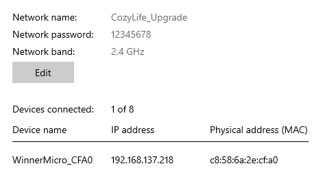

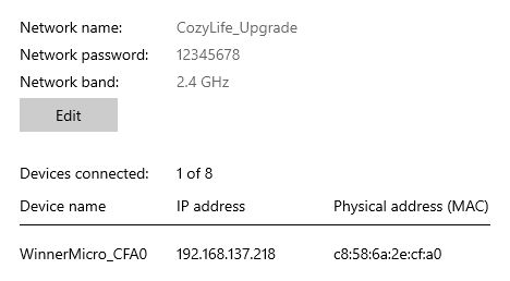

    My initial finding in the backup is that it appears a factory SSID "CozyLife_Upgrade" is searched for and connected to with password "12345678". Interesting, maybe it'll then be open to OTA exploitation.
    With that SSID available, it does indeed connect
    Wi-Fi settings screenshot for CozyLife_Upgrade showing password and MAC address details.
    on TX0 we see it listing SSIDs and stopping at CozyLife_Upgrade

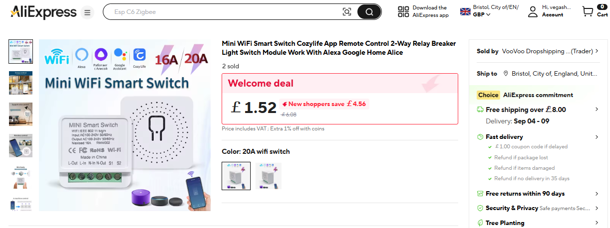

    UPDATE. Device was from Ali Express 20A option https://www.aliexpress.com/item/1005009631991603.html
    AliExpress product page screenshot of Mini WiFi Smart Switch 20A

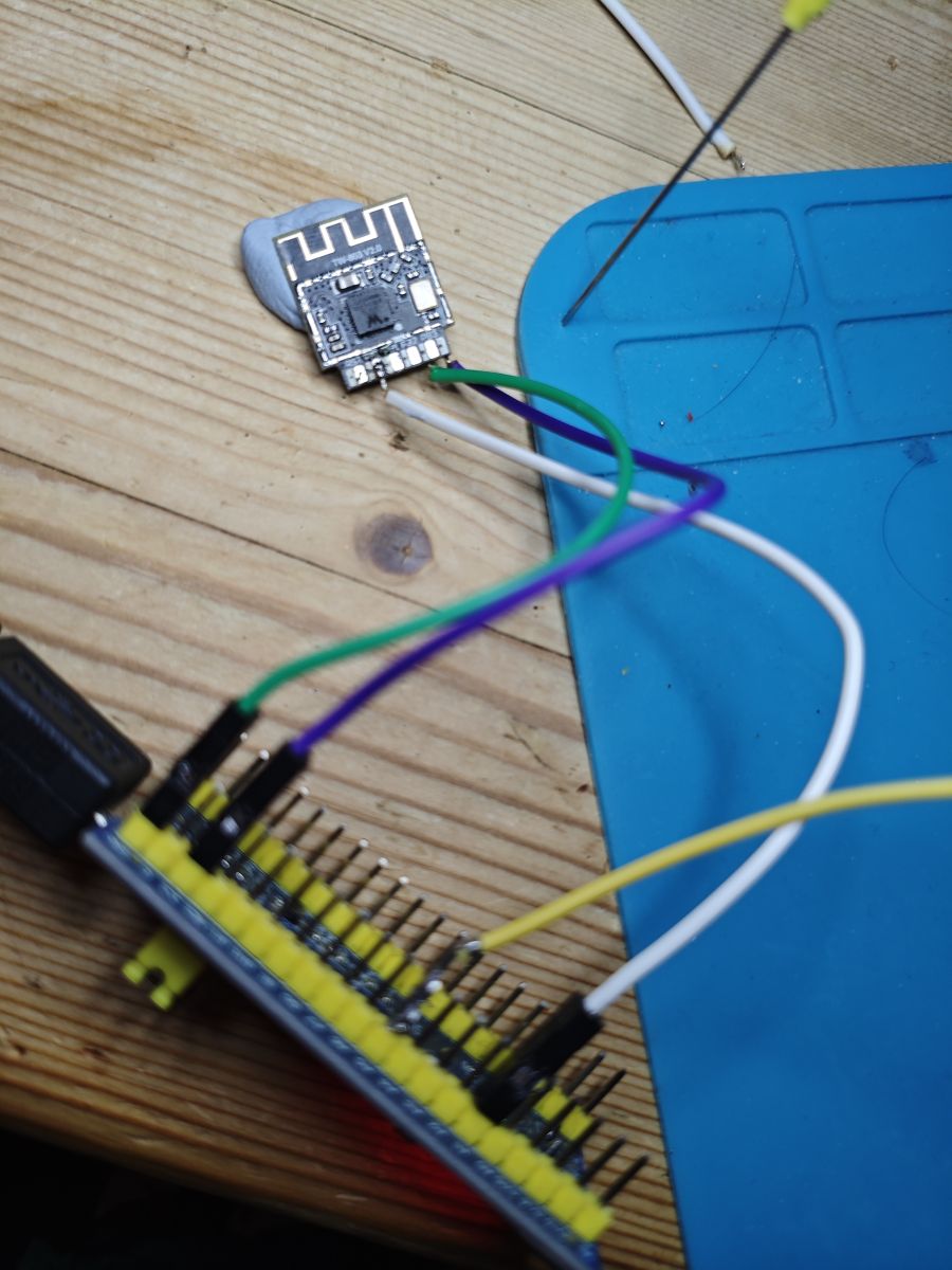

    With an STM32 running CK-Link Lite firmware and cabled as:
    Table comparing the pinout of STM32F103 microcontroller with XT-E804 module.
    PA4 pin connected using sewing needle held in place.
    Module with PCB antenna wired to STM32 board, needle touching one pin
    TW-803 V2.0 module with W800 chip and partial pinout schematic visible
    We get this info from the XuanTie Debug Server

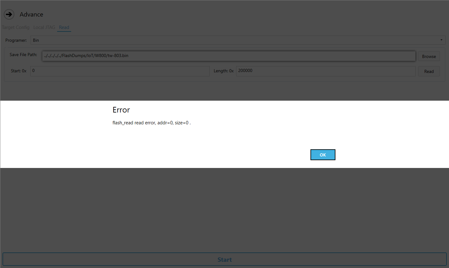

    CSKY Flash Programmer read attempt is giving this at the moment with the W800 flash algorithm file. Maybe I need to find W803 one. Lower ICE Clk has not helped.
    Flash read error message – address 0, size 0, in programming tool window
