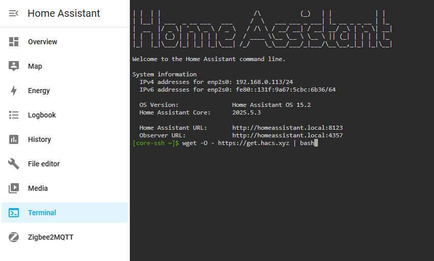

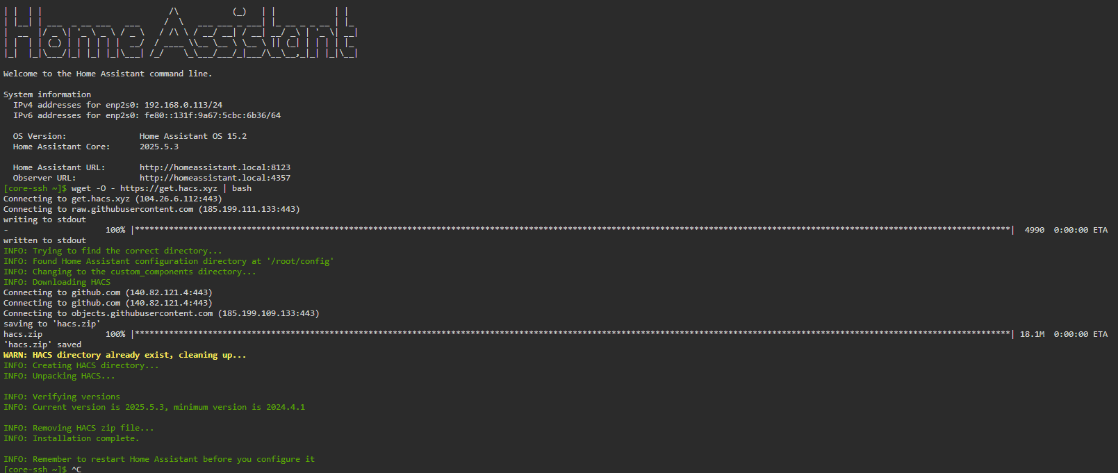

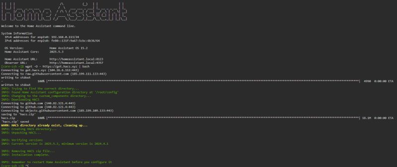

    Open a terminal and run the following command:
    wget -O - https://get.hacs.xyz | bash -
    This will download and run the HACS installation script.

    Wait for the installation to complete.
    Home Assistant Community Store and Button-Card tutorial – custom buttons on the HA dashboard

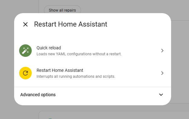

    Then restart Home Assistant – I recommend a full restart.

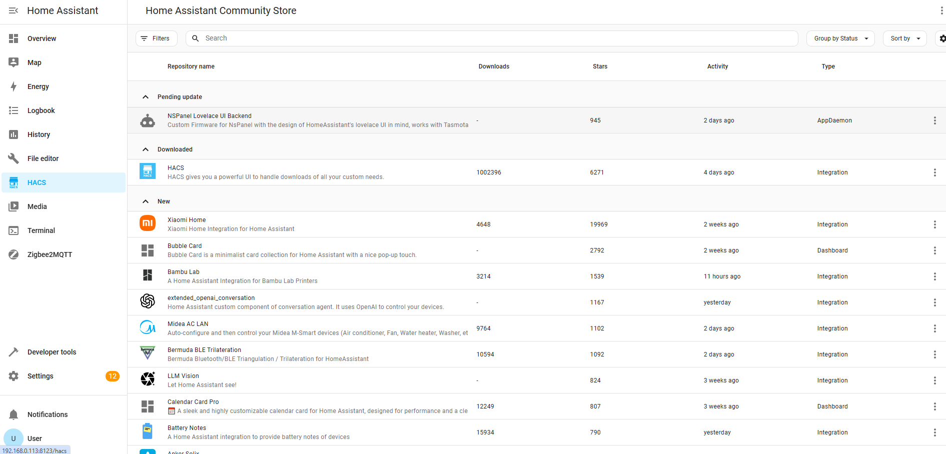

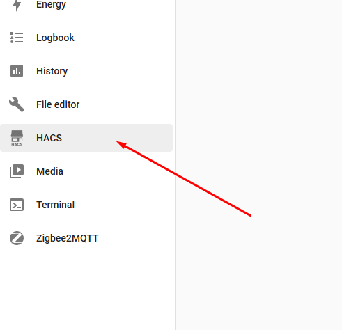

    From now on, you’ll have a new tab in the menu on the left-hand side.

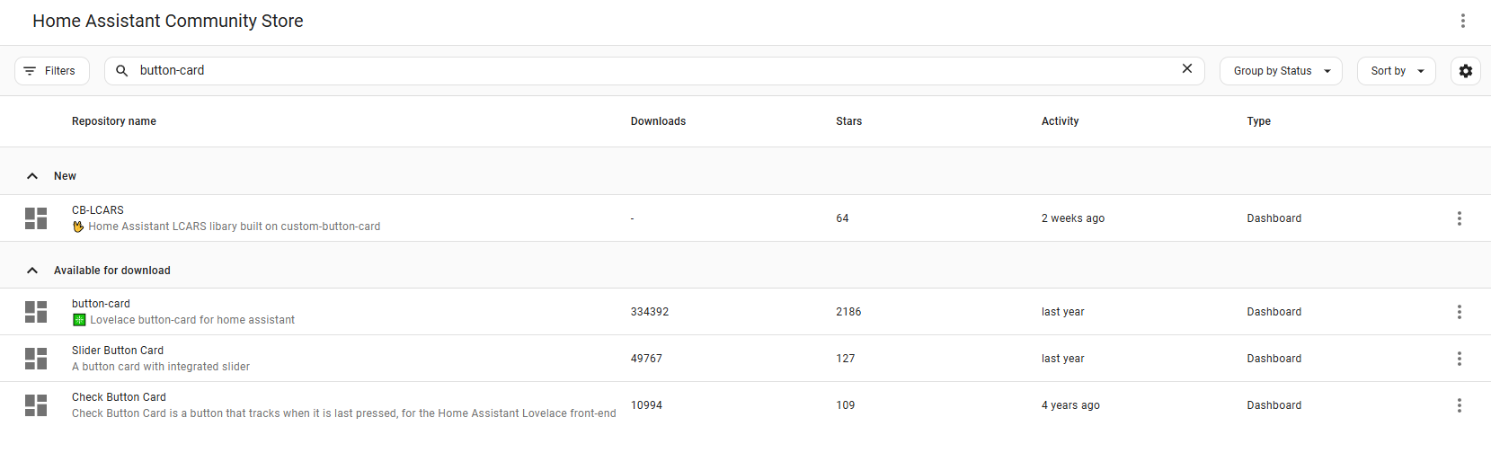

    Installing the button card

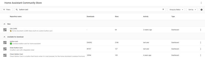

    We already have the community shop, so it’s time to install the add-on we want. Search for ‘button-card’:

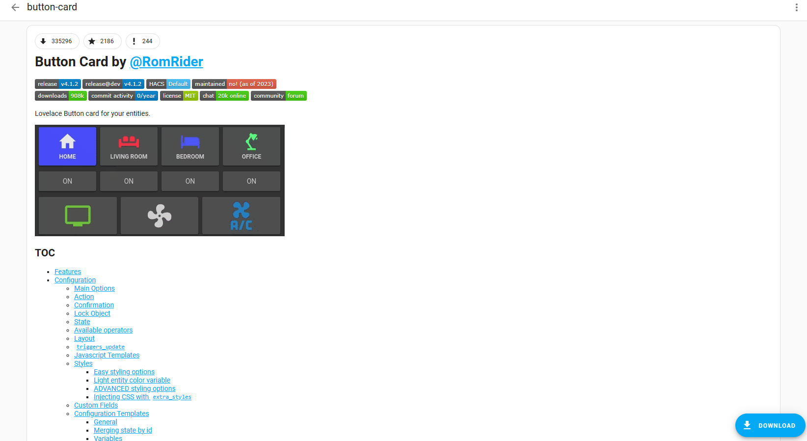

    Open the add-on’s page:

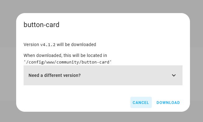

    Download and install:

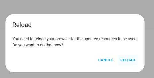

    Finally, you’ll need to refresh the page:

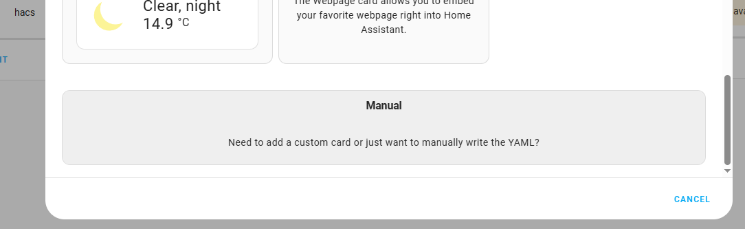

    You can select the ‘manual’ type and paste the YAML code:

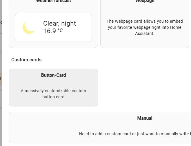

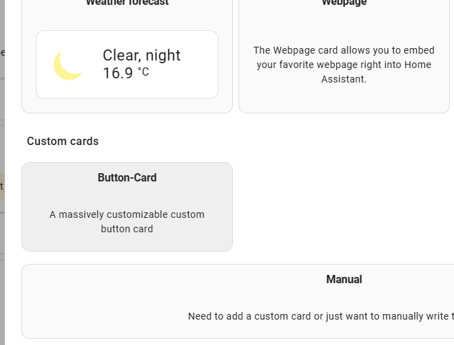

    However, if you have installed button-card correctly, there will probably also be a button for the add-on you’re looking for next to the ‘manual’ option:

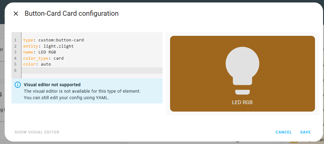

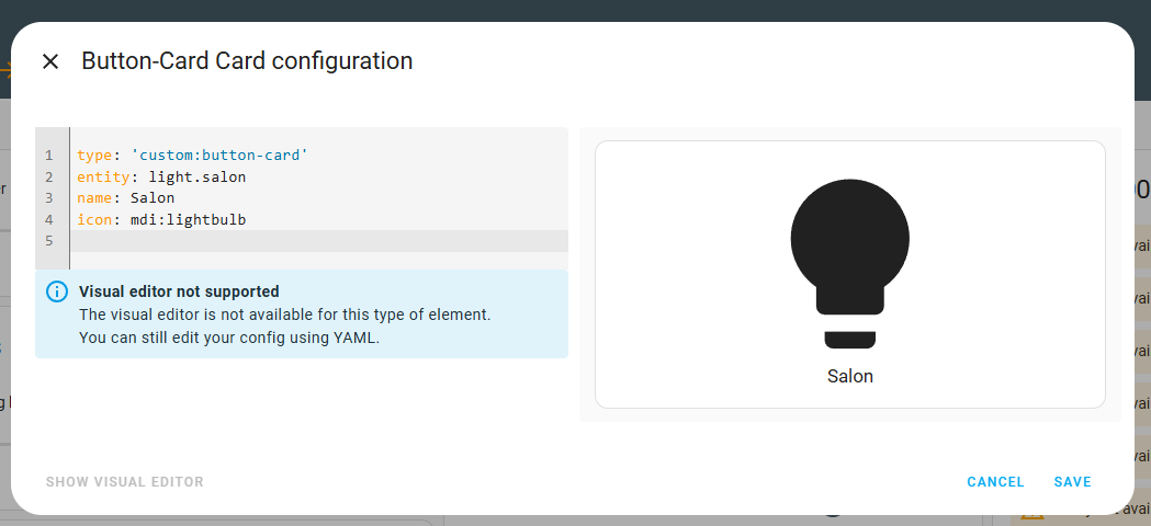

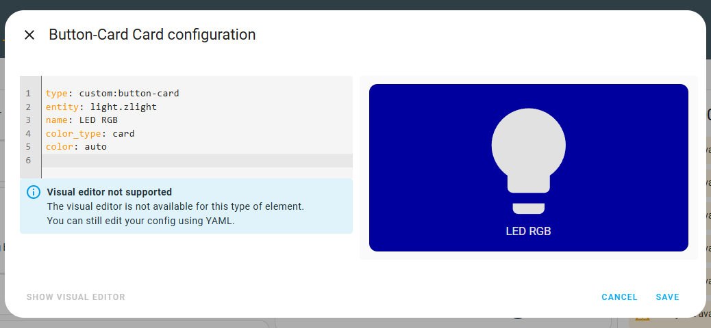

    From this point on, we can create our card in the field on the left and preview how it works on the right-hand side of the screen.

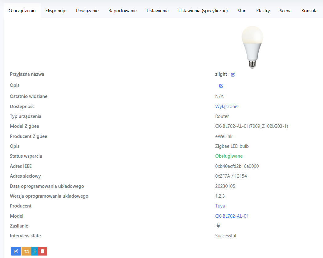

    Device used for the demonstration
    For the demonstration, I used an RGBCW LED light controlled via Zigbee. It is capable of emitting coloured light according to the RGB colour model, or emitting light at various white temperatures – from warm to cool.

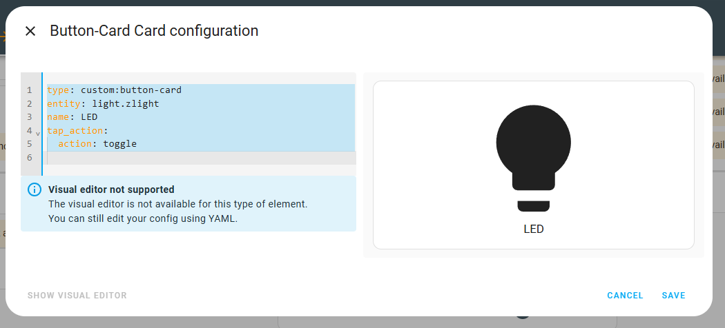

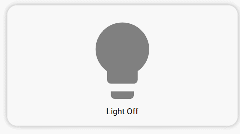

    Let’s start with a simple example. Let’s add a control for my LED lamp to the panel. Its entity name is ‘zlight’. The code below creates a button linked to this entity and adds a tap action, which is to toggle the lamp’s state.
    Code: YAML
    Result:

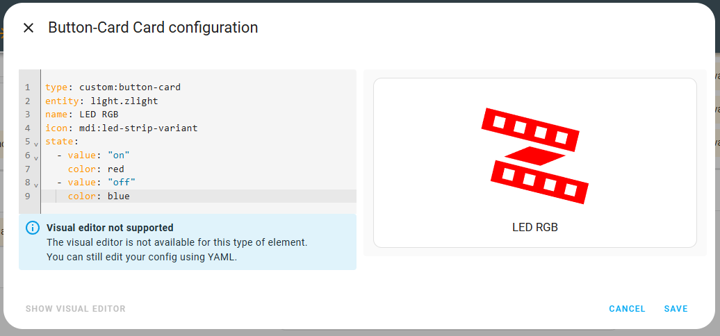

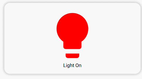

    You can add a ‘state’ to the code – this specifies the button’s state. This allows you to change its colour depending on the device’s state.
    Code: YAML

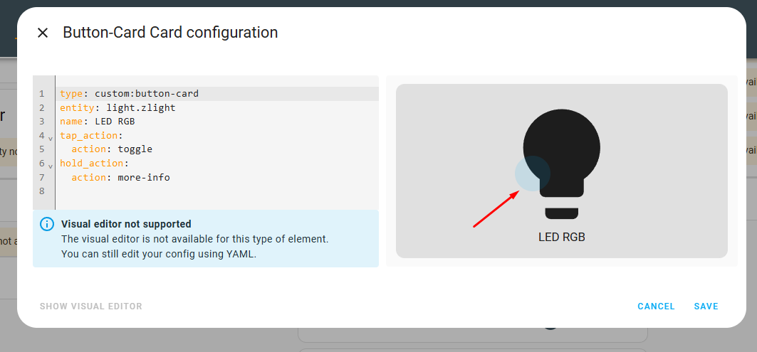

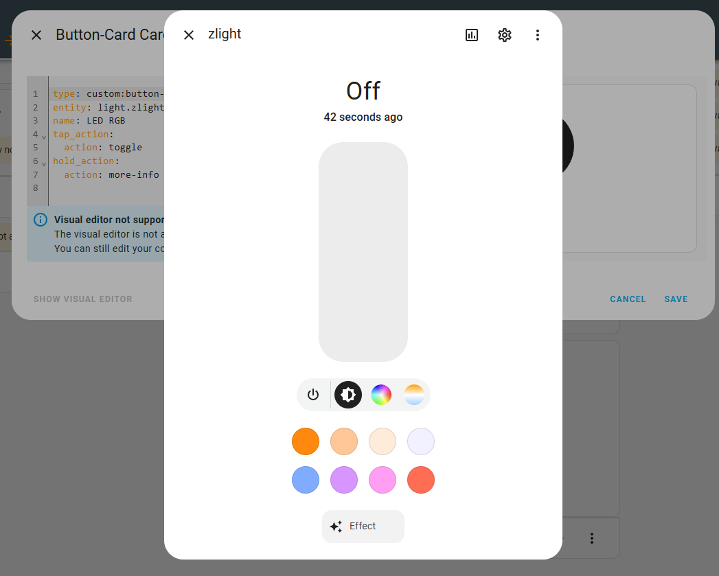

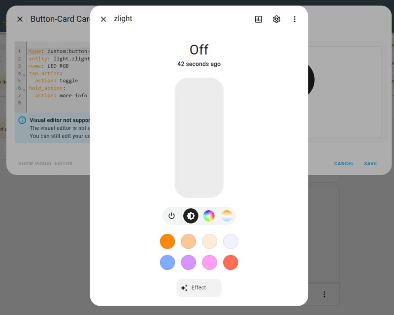

    You can specify different actions for the button individually. The most common is a tap – this even toggles the device’s state by default. However, you can also script a longer press, for example. The code below then displays the device’s detailed configuration.
    Code: YAML
    If required, there is also a ‘double_tap_action’.

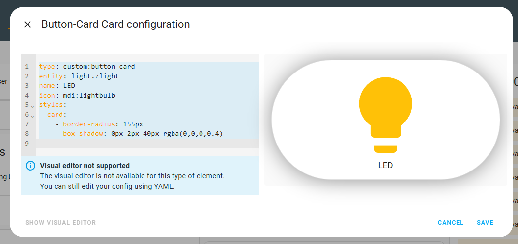

    The card can be styled using CSS, just like other HTML elements in a browser. In the example below, I’ve rounded the corners of the card and added a shadow.
    Code: YAML

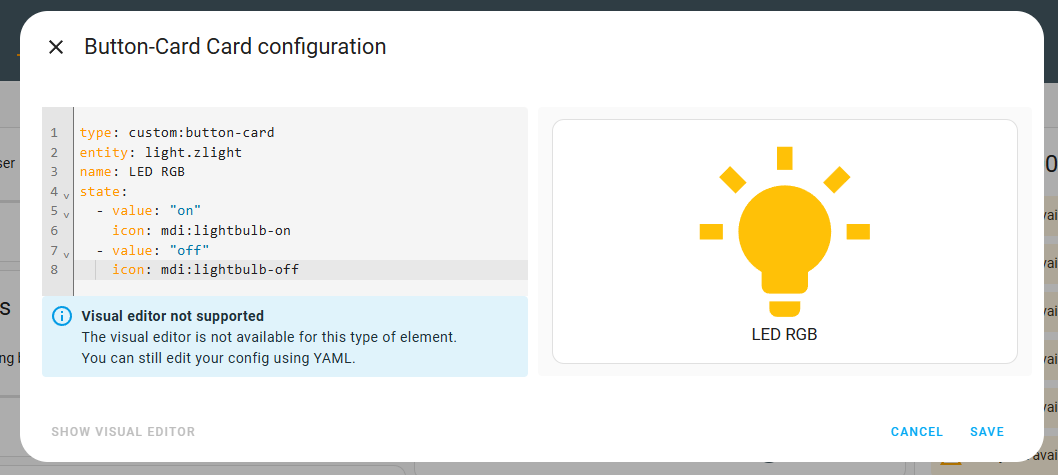

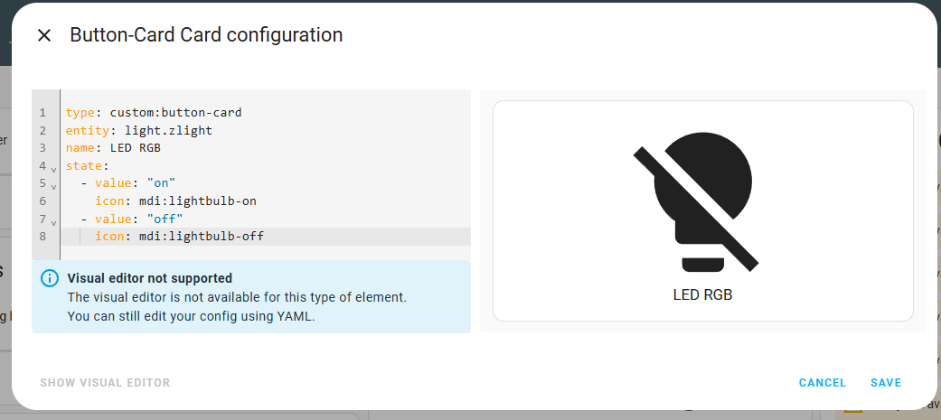

    Just as I showed earlier how to change the colour depending on the state, you can also change other parameters – for example, the icon.
    Code: YAML

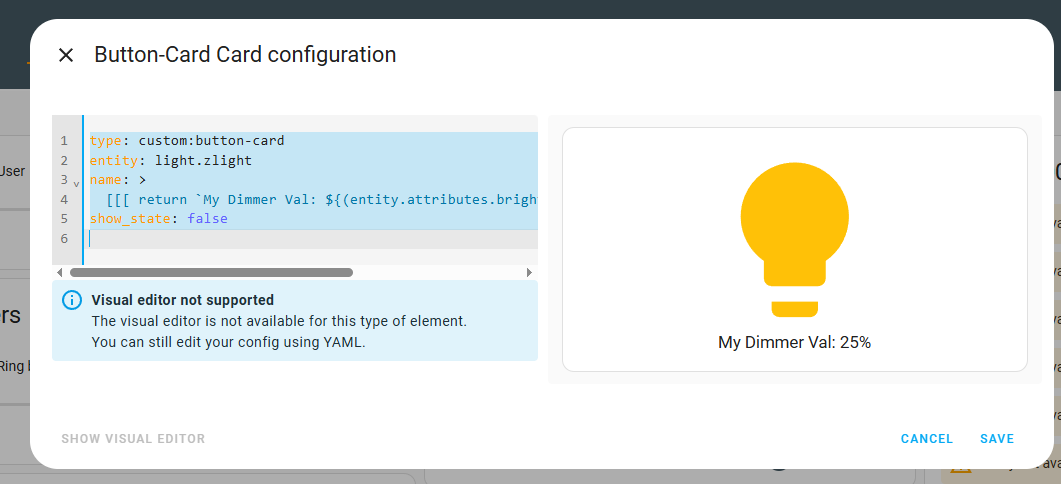

    You can also use JavaScript code within a button. Below is a button displaying the current value of an attribute from an entity – specifically, the brightness level. Additionally, this value is scaled, as in HA it ranges from 0 to 255, but I want to display it as a percentage...
    Code: YAML

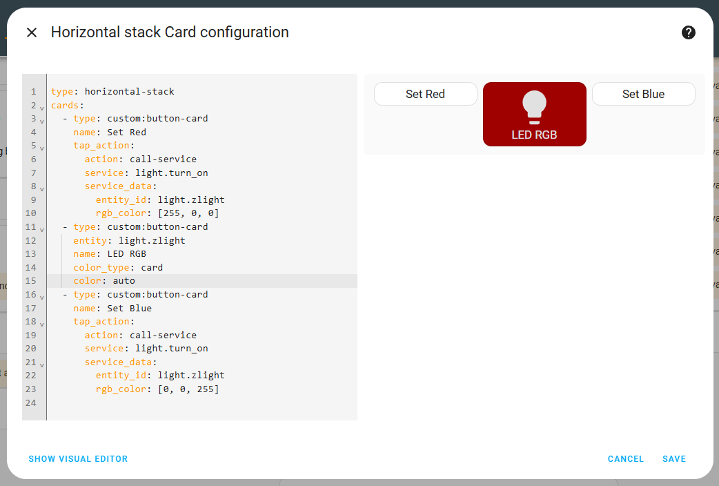

    I’ve already shown how you can ‘combine’ different values depending on the states to determine the final appearance of a button. In a similar way, you can also ‘combine’ different buttons into a single composition. We have suitable templates for this: horizontal, vertical and grid. Below is an example of a horizontal template in which I have placed three buttons. Two of them set a fixed colour, whilst the third represents the device’s state, as before.
    Code: YAML

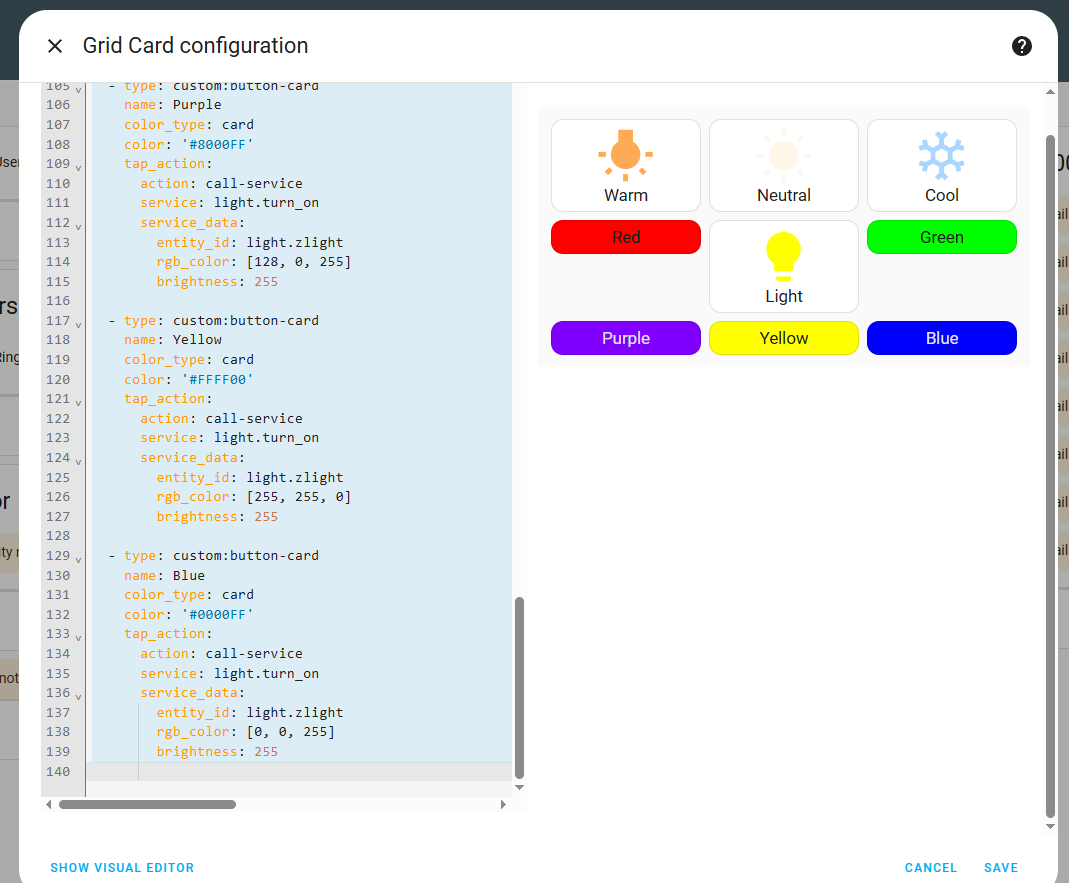

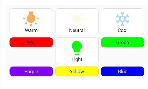

    Now for the grid template. You also need to specify the number of columns. I’ve packed a few options into the centre; these include colour settings and displaying the device status.
    Code: YAML
    Results:

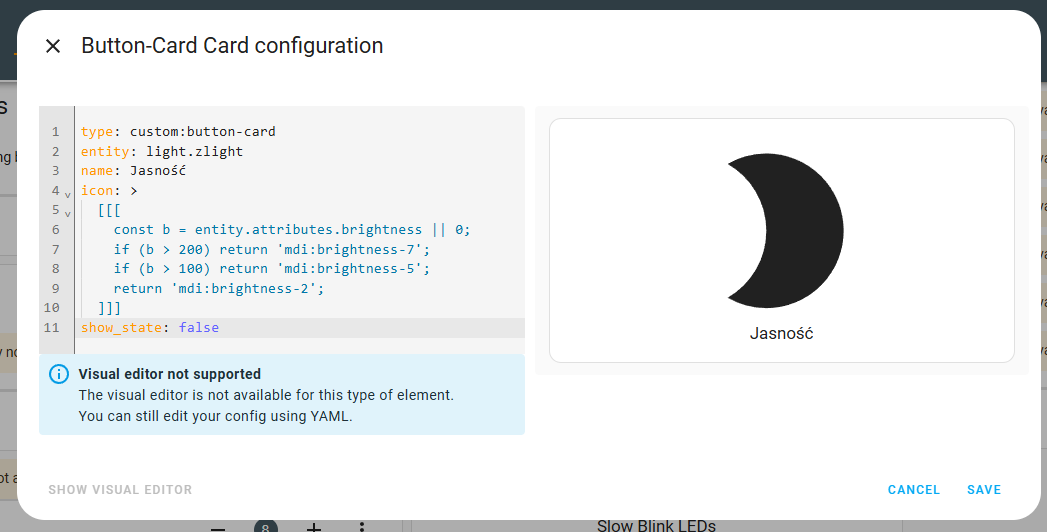

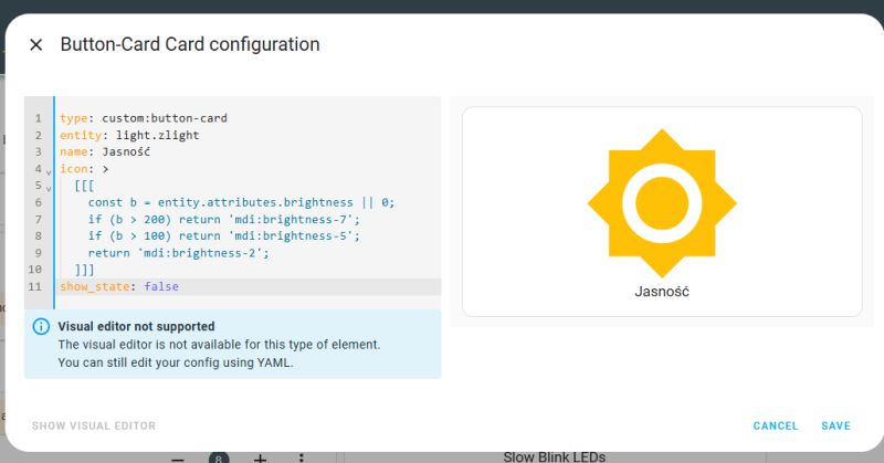

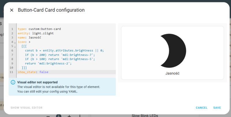

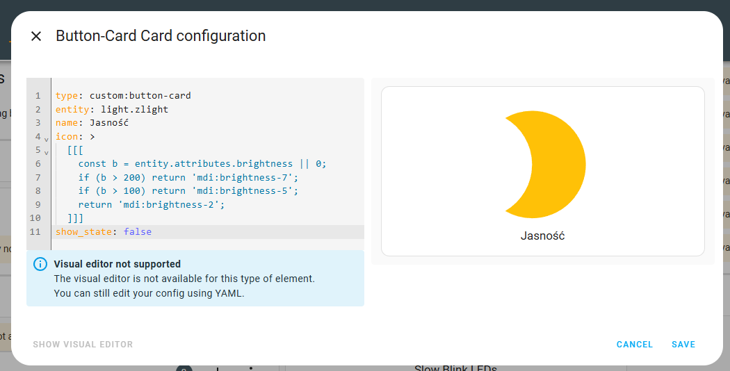

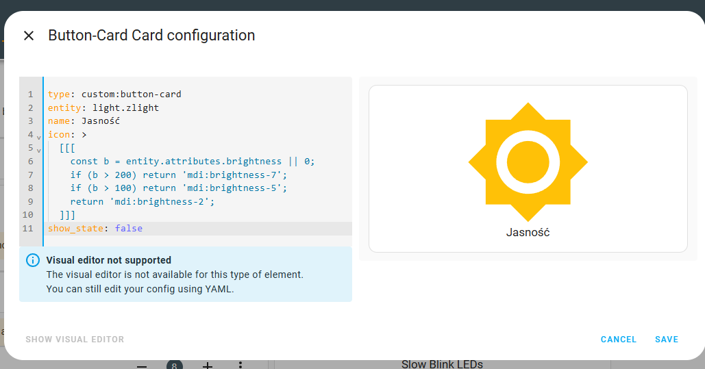

    Finally, let’s return to some shorter examples. I’ve already shown how to select an icon based on the device’s status, but the selection can also be made in JS – for example, by comparing the brightness level.
    Code: YAML
    The icon now changes depending on this:

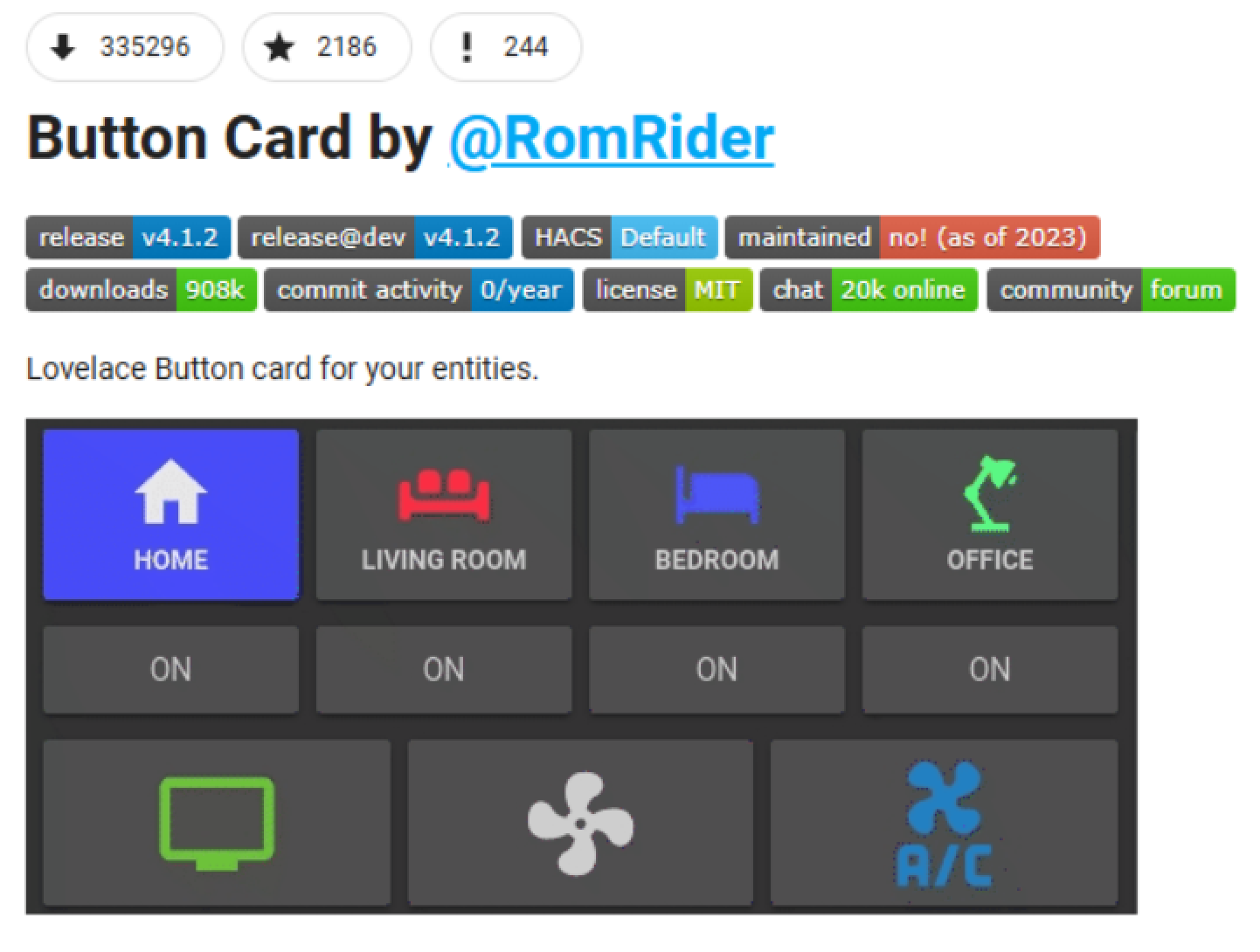

    To sum up, these were the basics of the Button-Card for Home Assistant. However, I haven’t covered everything here; amongst other things, you can also create complex Toast messages, animations and secure actions with a PIN, so I recommend consulting the add-on’s official documentation:
    https://github.com/custom-cards/button-card
    https://custom-cards.github.io/button-card/stable/#some-features
