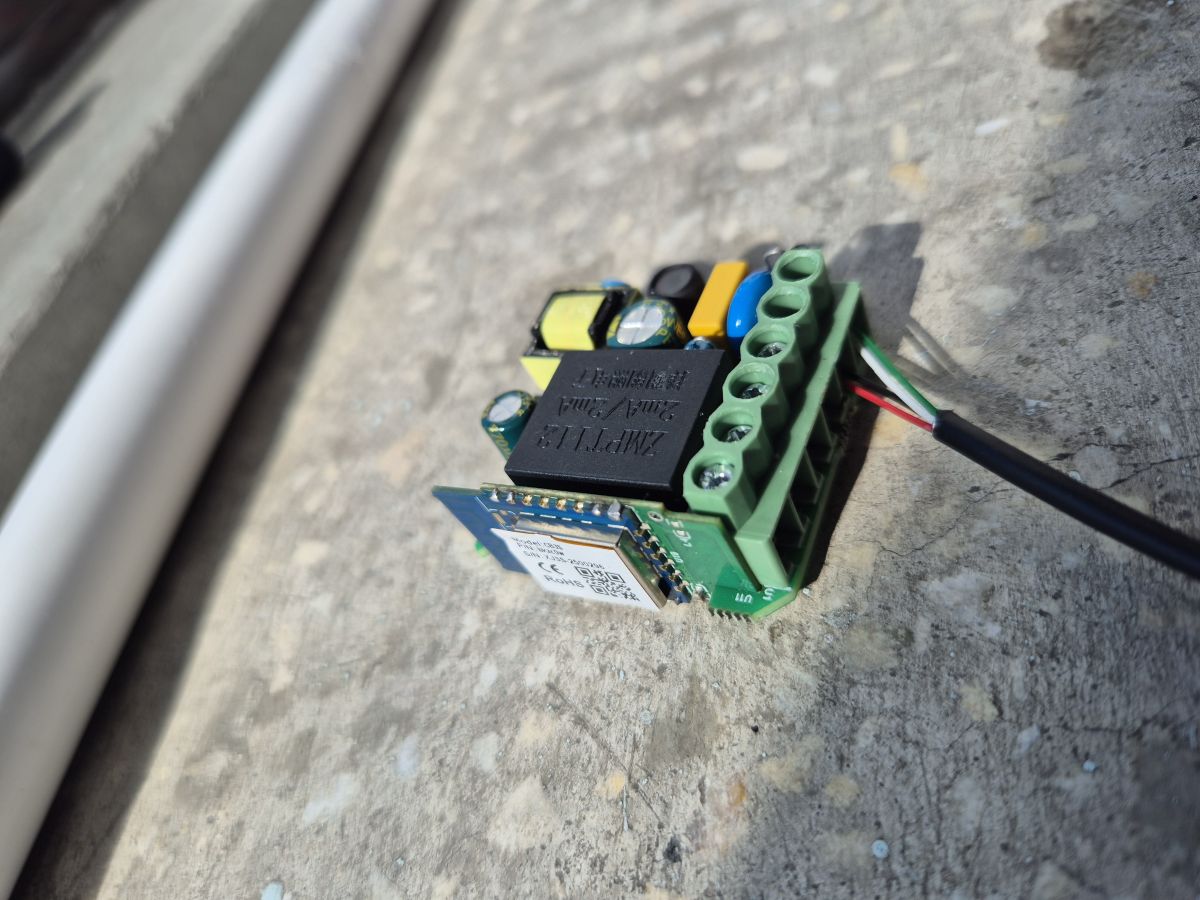

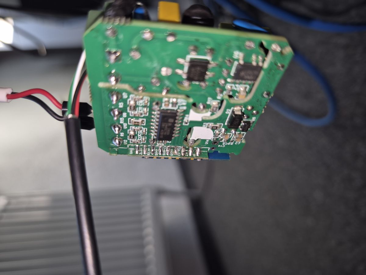

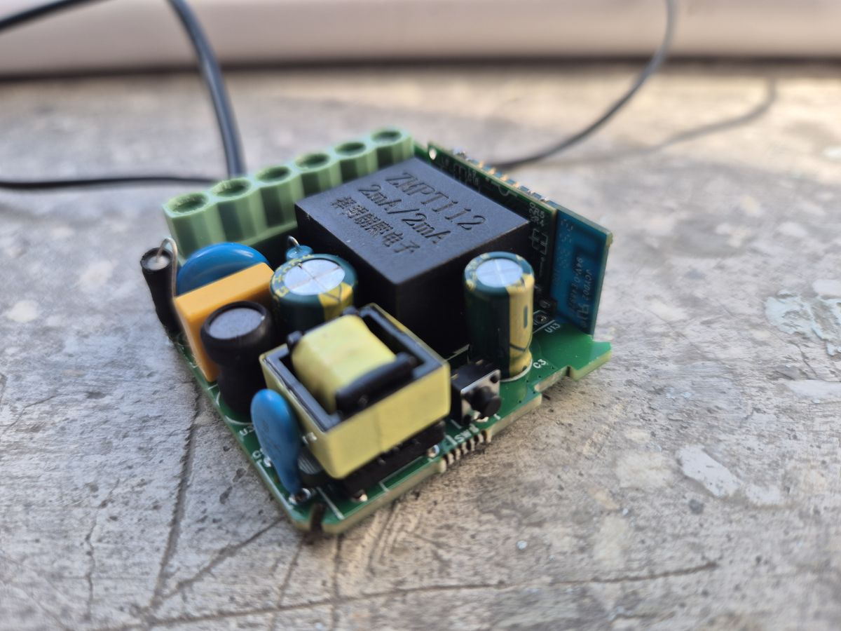

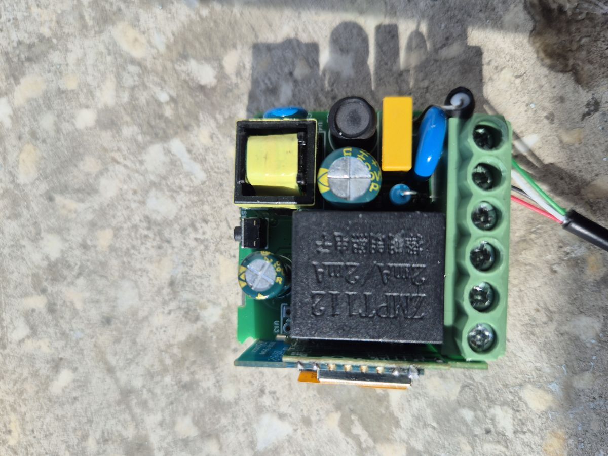

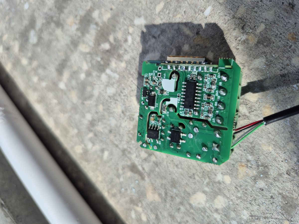

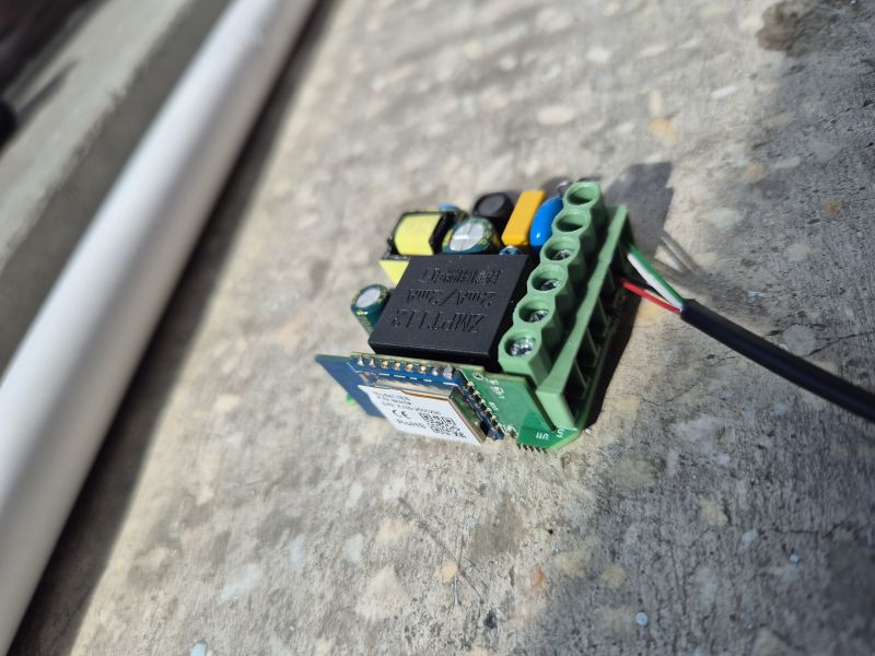

    Hello, I am looking to get OpenBeken working on a Smart Power Meter Clamp (Dual Channel CT). It is a Tuya-based device with the FCC ID: 2BL6A-WMDL. Inside, the Wi-Fi module is a CB3S (BK7231N). Power monitoring is handled by the BL0939 chip, but instead of the usual UART connection, it is wired via the SPI interface.
    I have reverse-engineered the board tracks and identified the complete pinout configuration:
    SPI Pins connected to BL0939:
    SDO (MISO): P6
    SDI (MOSI): P24
    SCLK (Clock): P26
    Other Function Pins:
    CF (Power Pulse): P14
    ZX (Zero Crossing): P23
    Relay/Control (RL): P8
    Button/LED (1K): P7
    Since this device uses two current clamps (CT1 and CT2) via the BL0939 SPI interface, I would greatly appreciate it if support for this specific configuration could be added to the driver list (similar to the existing BL0942SPI driver). I have high-resolution photos of the PCB and I am ready to flash any test binary builds to help debug and calibrate the measurements.

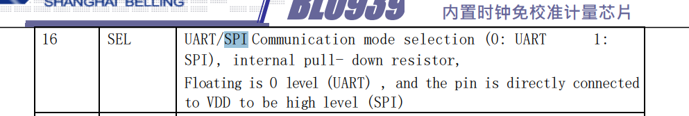

    If it's SPI, then it should be very simple to implement. SPI is using dedicated clock line, it doesn't need precise timings like WS2812. There is nothing wrong with software SPI in OBK.
    We could try to support it, but first, just to be 100% sure, how is this pin connected for you?>
    Datasheet table snippet: pin 16 SEL and UART/SPI communication mode selection
    Pin 16 SEL, is it on ground, or pulled high? Or floating?
  • Clarifies BL0939 import and export as signed values
    #8 21924322
    geoagache
    Posts: 9

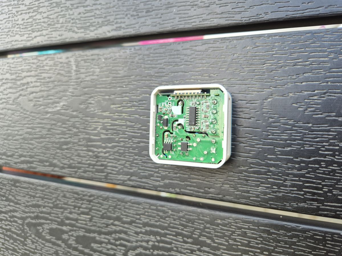

    It's a SOP16 BL0939, with SEL on the 3.3V side.
    Just to confirm I understand the BL0939 behavior in OpenBeken correctly: where Tuya uses separate states like work_p for import and work_n for export, OpenBeken simply represents this as positive and negative values, correct?
    Open casing with a green PCB mounted on black textured boards

    On this specific board, the SEL pin is directly connected to VDD (measuring 0 ohms between them).
  • #11 21924580
    Posts: 5220
    Help: 449
    Rate: 918
    confirming SPI. ok

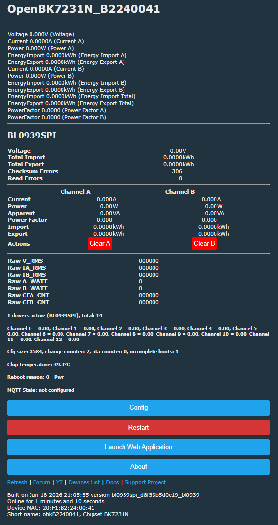

  • Missing calibration command for bl0939spi driver
    #12 21925040
    geoagache
    Posts: 9

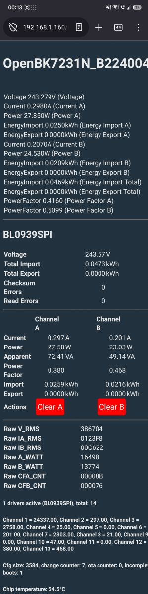

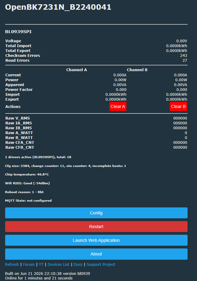

    Great news. Flashed it today and it works! Thank you so much for the custom firmware build, it got the BL0939SPI up and running on my BK7231N device perfectly.
    Since this is a stripped-down build, standard console commands like "VoltageSet" or "help" are missing. Could you please let me know how I should pass the calibration coefficients (Voltage, Current, Power) for this specific driver? Should they be added as arguments after "startdriver bl0939spi" in the startup command, or is there another way to calibrate it?
    Mobile browser screenshot of OpenBK7231N showing voltage, current, power and energy readings for channels A and B
    Thanks again for your awesome work!

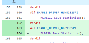

    @divadiow I want this cleared up and merged
    @insmod SetVoltage indeed seems renamed, but what about SetCurrent? It has SetCurrentA and SetCurrentB, we probably need to have some standard.... add second argument to CurrentSet? Channel A and then Channel B? Just wondering
  • #15 21925106
    insmod
    Posts: 1432
    Help: 168
    Rate: 455
    I think it should be in hlw variant, not in a separate one.
    And perhaps even merge hlw into power metering variant?
    The issue with flash vars is no longer present.

    Posts: 14770
    Rate: 12913
    How much of the code is common there? Could it be made DRY?

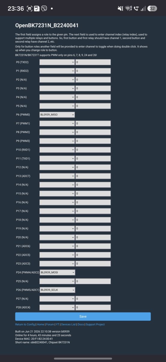

    BL0939 SPI support with assignable pin roles
    #20 21925656
    Posts: 5220
    Help: 449
    Rate: 918

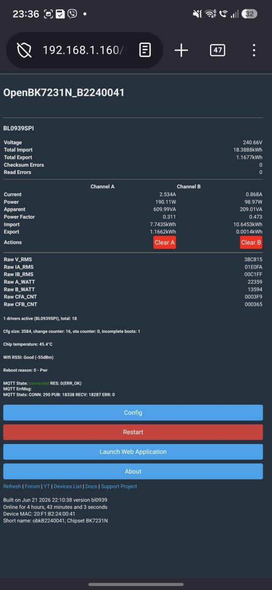

    @geoagache if you're up for more testing please flash the attached. you'll need to assign the IOs the new roles in the config page. driver autostarts on reboot
    Screenshot with three dropdowns: BL0939_MISO, BL0939_MOSI, and BL0939_SCLK
    supported commands
    that fixed channel list at the top of the older build will persist unless you reset obk to factory
    Screenshot of OpenBK7231N dashboard showing BL0939SPI readings and Config/Restart buttons
    • OpenBK7231T_App_bl0939-2_202376afc213_OpenBK7231N_powerMetering.zip (3.22 MB) You must be logged in to download this attachment.

    geoagache
    Posts: 9
    Flashed today. It's working normally.

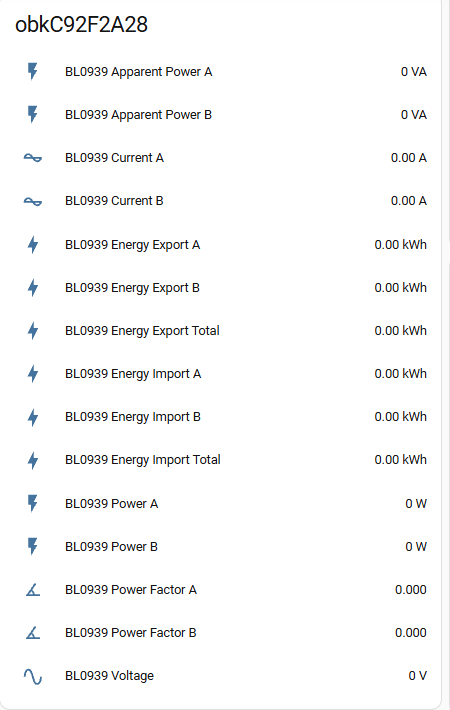

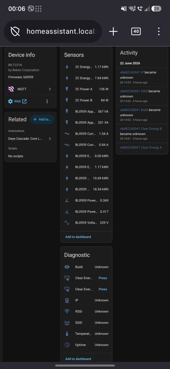

    ah that's good. Do you have Home Assistant? Has it appeared in there if you've configured it? readings OK? Have you used any commands? do the clear buttons work etc etc?
    my empty discovery
    Screenshot listing “BL0939” energy metrics with all values at 0 (power, current, energy, voltage)
  • MQTT readings work with calibration commands

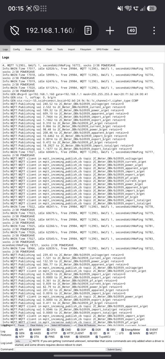

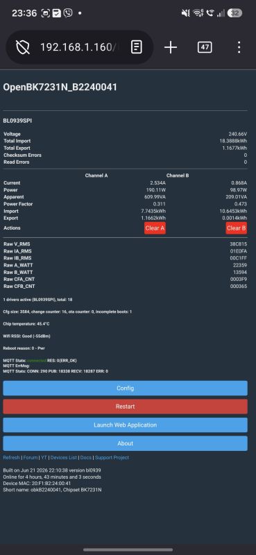

    #24 21926279
    geoagache
    Posts: 9
    Yes, of course, I have HA. MQTT works well. Readings are ok, not sure about power factor and apparent power, though.
    Have used commands for voltage calibration, current and power calibration for channel A and B.
    Clear buttons work! Pressed them straight from HA :).
    I use PowerSave 1 as a startup command.
    In diagnostic from mqtt HA I can't see device temperature, but not sure I need it.
    Phone screenshot of a web UI showing MQTT logs and the address bar with 192.168.1.160
    Phone screenshot of Home Assistant showing BK7231N device info and energy/power sensors list

    #29 21927082
    Posts: 14770
    Rate: 12913
    That went well, @divadiow , good job.
    My only little concern is here - but i think we could ignore it for now:
    [BK7231N] How to add BL0939 SPI support for Tuya 2x CT Smart Power Meter Clamp?
    Can it be more DRY? When we introduce third power meter, we will add third separate function? Is the implementation of data save really that individual?
