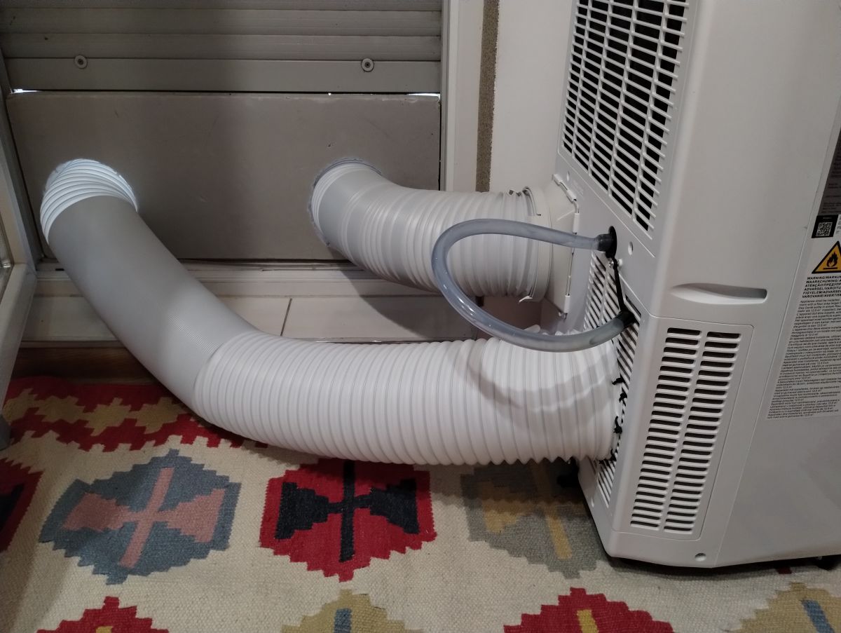

  • Added a second intake pipe to portable AC

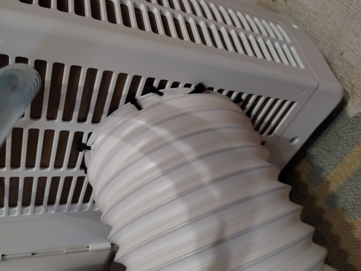

    Inspired by this topic and the temperatures we’ve had over the last few days, I’ve added a second air intake pipe. It took an hour’s work. The pipe is secured to the grille with cable ties, and the unused holes have been sealed from the inside with adhesive tape. There’s a Styrodur panel in the door (it doesn’t leave any beads of dirt). I’ll be testing it out soon.
    I agree with the previous speakers that this type of air conditioning isn’t an ideal solution, as drawing in warm air from outside ‘heats up’ the rooms where the vents are located (in my case, the kitchen and bathroom). But a cooled room is a godsend, both physically and mentally – you don’t have to stress about feeling helpless, at the mercy of the weather. All in all, it’s worth it despite everything.
    Portable air conditioner with two white corrugated hoses running to a panel in a door opening. White flexible duct hose fastened with zip ties to a device ventilation grille

    Frog_Qmak wrote:
    Inspired by this topic and the temperatures over the last few days, I’ve added a second air intake pipe
    Doesn’t it draw air through the upper grilles?

  • #41 21931186
    Frog_Qmak
    Level 25  
    Posts: 1324
    Help: 7
    Rate: 298
    >>21931153
    To be honest, I haven’t checked – even if there were a slight drag, it wouldn’t be much, because by definition the top and bottom must be separated from each other to prevent a thermal short circuit.
