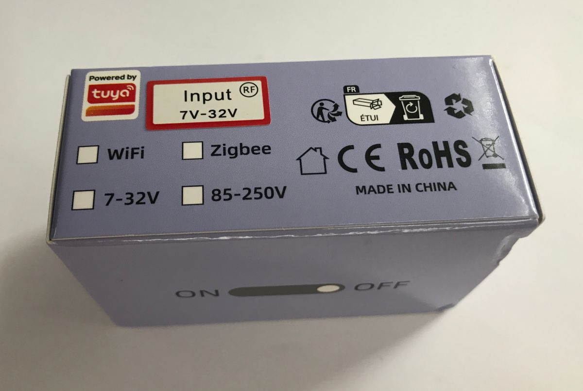

    The packaging states that the device operates at a voltage of up to 32 V. The information that the operating voltage starts at 7 V refers to the screw terminal; there is also a USB option, which is the standard 5 V. Additionally, it’s clear that the same product is also available in a Zigbee version, which I won’t be covering here.

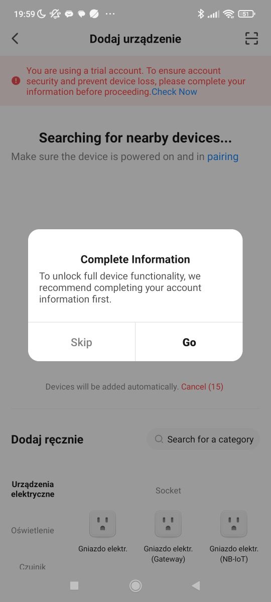

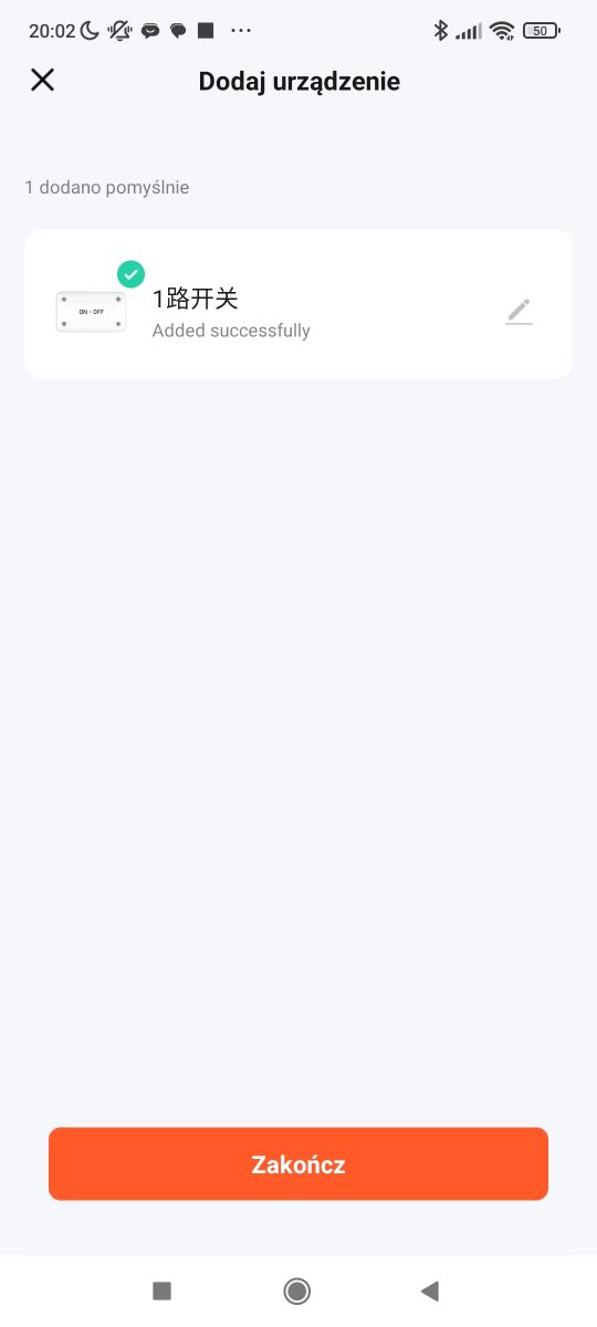

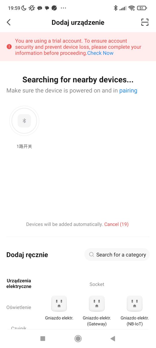

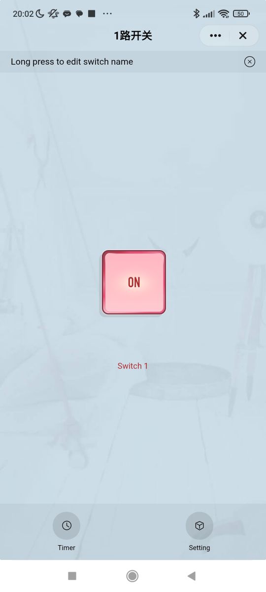

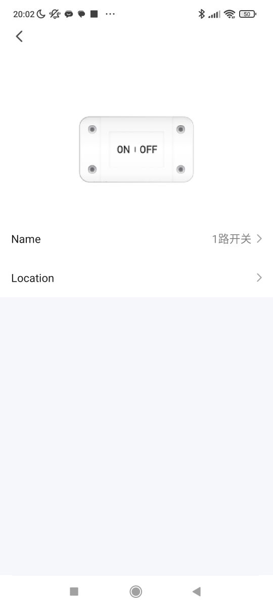

    I started by pairing it with Tuya. I often skip this step, but for a change, it’s worth showing it sometimes. You’ll need the free app, and you’ll also need to grant it access to your location and Bluetooth. Interestingly, you don’t need to create an account – you can test it without one:
    433 MHz radio-controlled and Wi-Fi-controlled relay module – how do I pair the remote control? Firmw 433 MHz radio-controlled and Wi-Fi-controlled relay module – how do I pair the remote control? Firmw 433 MHz radio-controlled and Wi-Fi-controlled relay module – how do I pair the remote control? Firmw

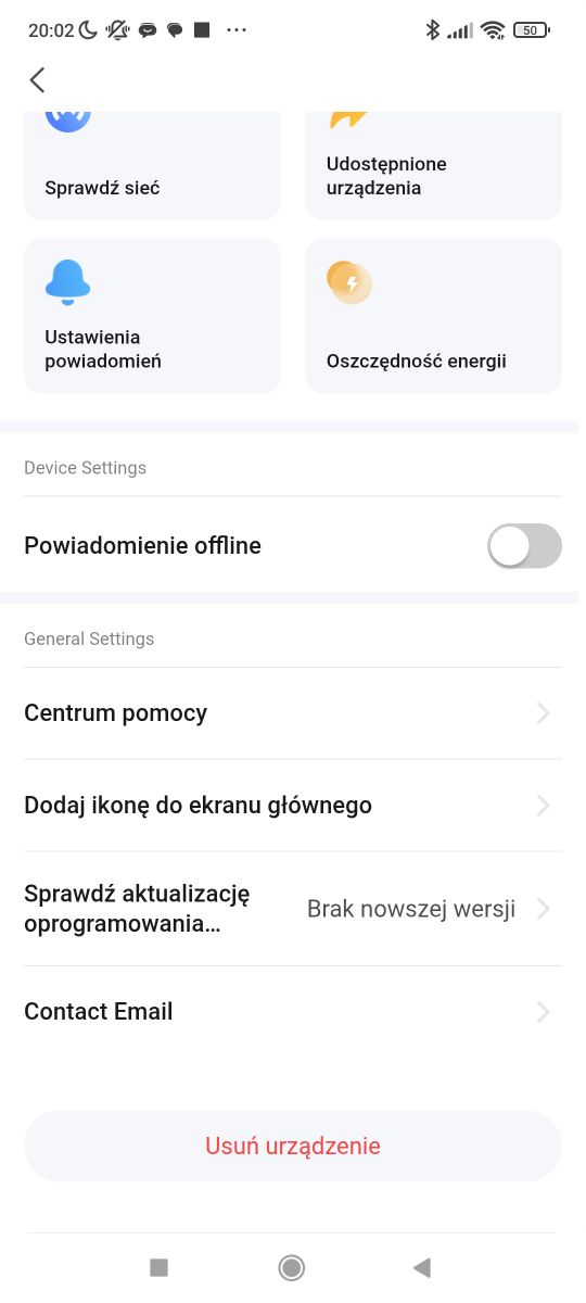

    There aren’t really any major surprises. Remote control, on/off mode, timer, schedule. Notifications when the device is offline.

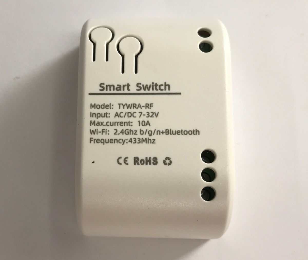

    However, not everyone wants to rely on the manufacturer’s cloud service; for this reason, at the owner’s request, I uploaded OpenBeken . This also allows for flexible development and scripting, and even, for example, connecting additional sensors such as the DHT11 or DS18B20. Let’s start by removing the casing:

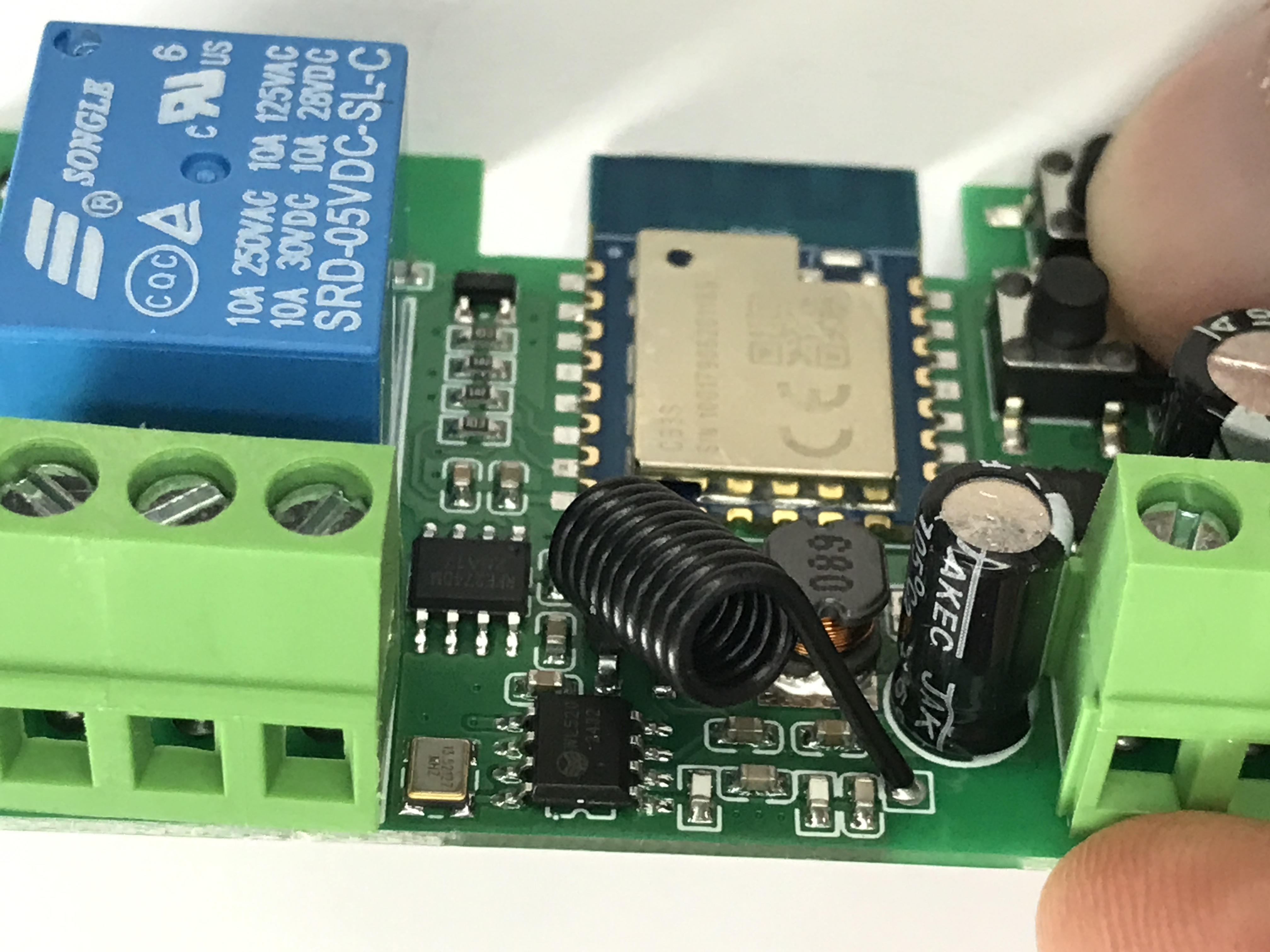

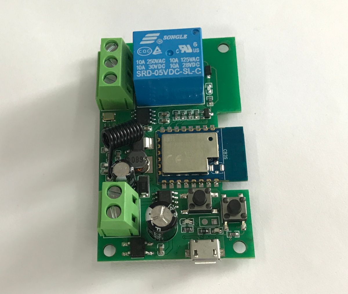

    The first thing we might be interested in is the relay – what its actual specifications are. I have no way of checking the actual specifications directly, but according to the casing, this is an SRD-05VDC-SL-C, designed to operate at 10A at up to 250VAC.

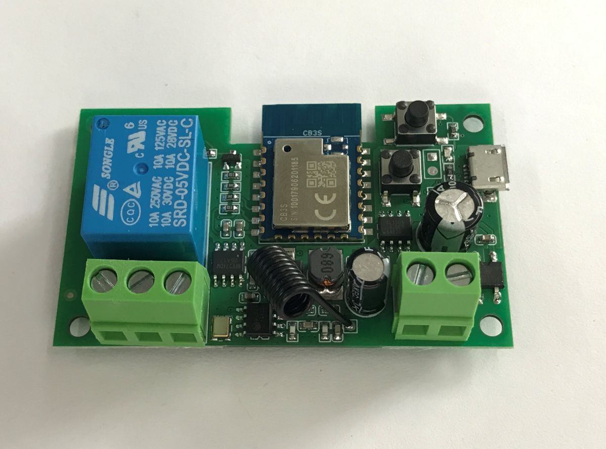

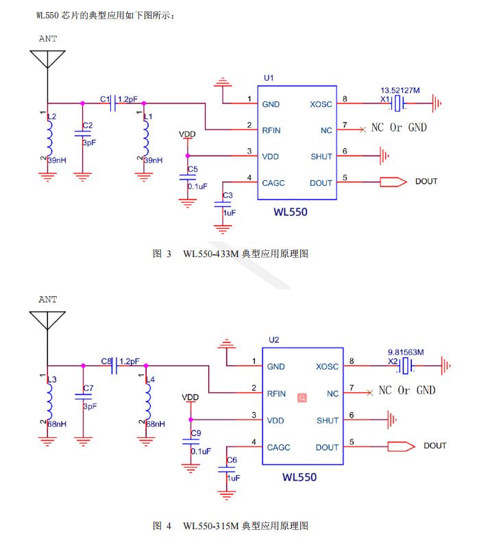

    What’s more, it’s quite densely packed in here. As many as two integrated circuits? The antenna and oscillator suggest that this is the RF section.

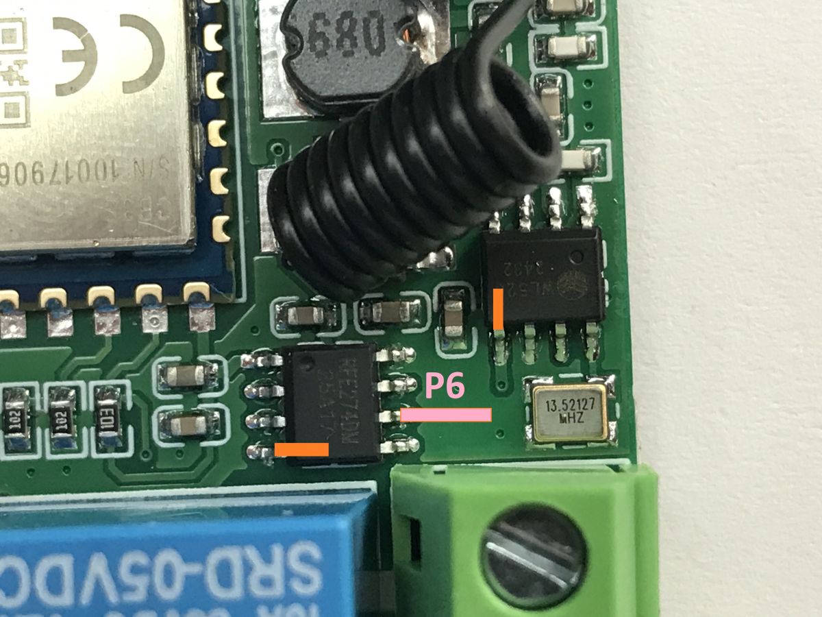

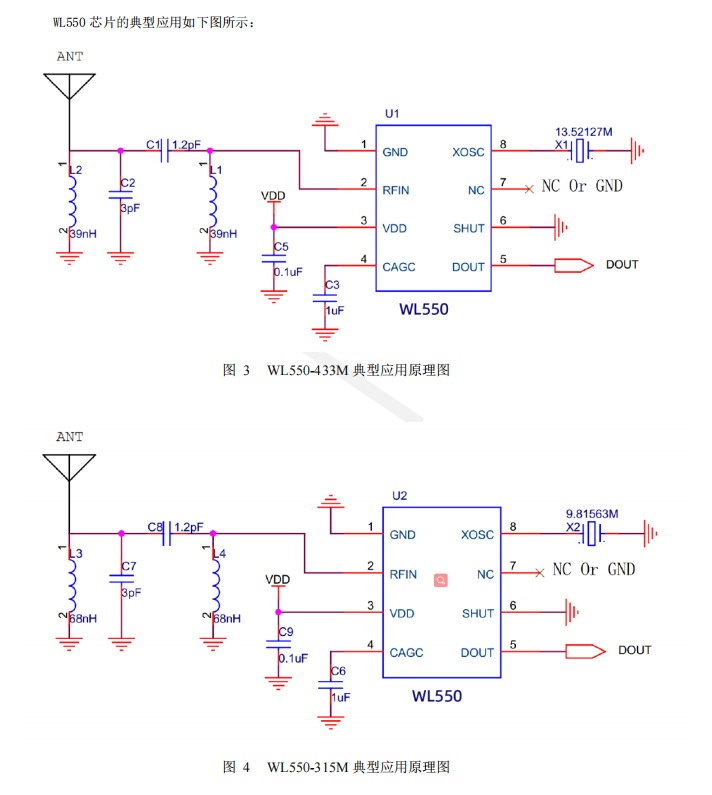

    An analysis of the circuit traces shows that the chip next to the antenna is an RF receiver, the WL520, similar to the SYN480R; the second chip appears to be a microcontroller, the RFE274DW. It is connected to the same pins on the Wi-Fi module as the buttons...
    That’s all This suggests a mechanism I’m already quite familiar with, where the Wi-Fi module ‘is unaware’ of the RF receiver – this additional microcontroller stores and decodes the remote control codes, and when it receives a matching code, it simply ‘presses the button’, or, to be more precise, it shorts the GPIO pin on the Wi-Fi module where the button is located to ground. Thanks to this, the Wi-Fi module does not need to handle RF in any way, and the RF will still work after the firmware update . It’s the perfect candidate for modification!

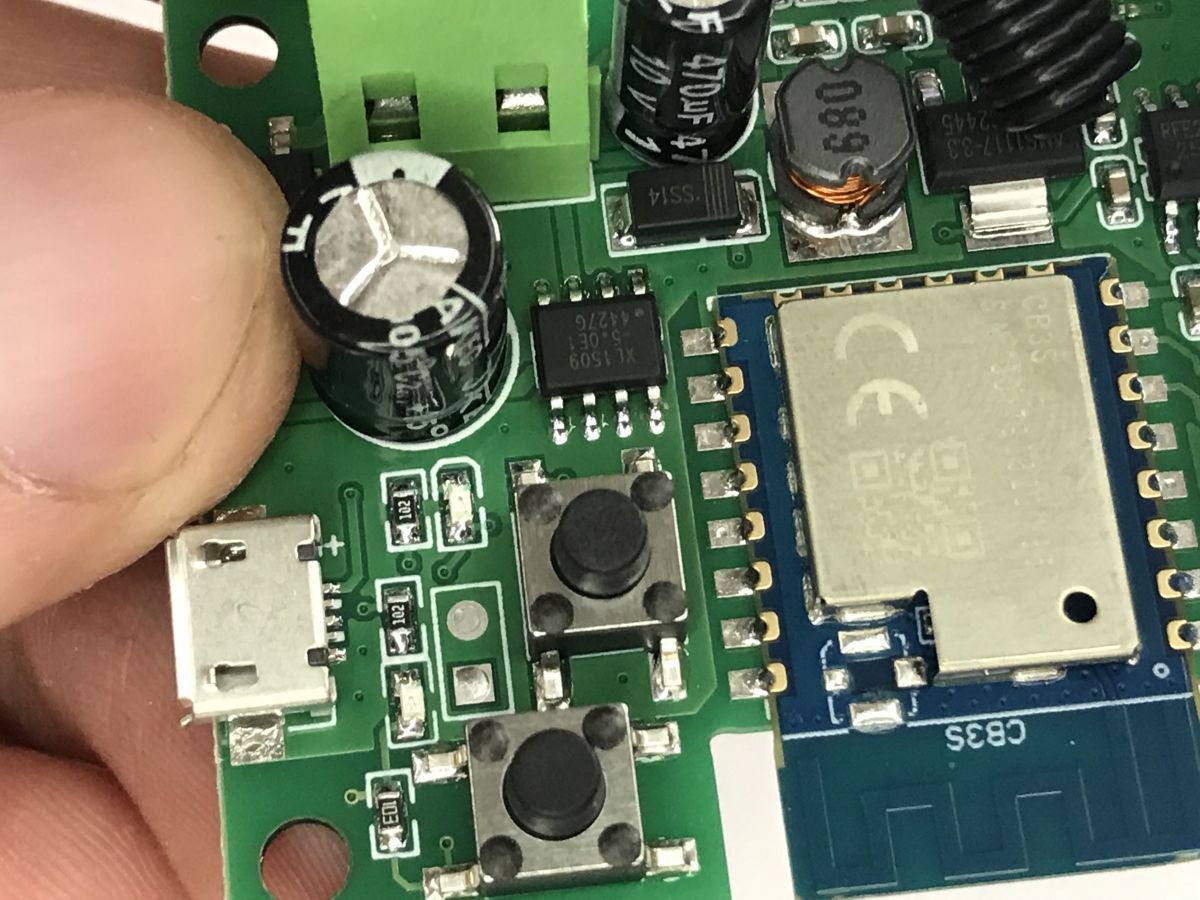

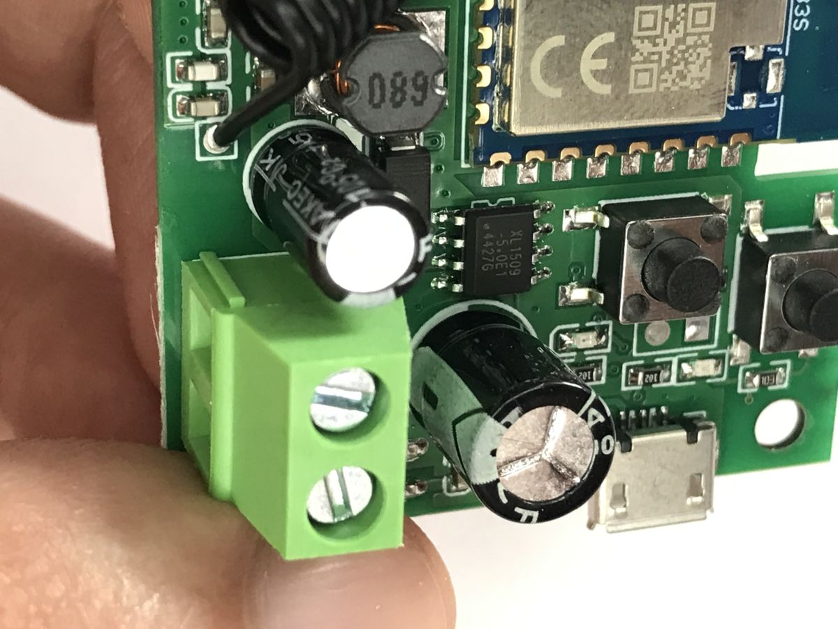

    There’s still the power supply section left – there’s a third chip in an SOIC8 or similar package, a step-down converter controller. A standard AMS1117-3.3 LDO or similar wouldn’t be able to cope with such high input voltages as the seller claims.

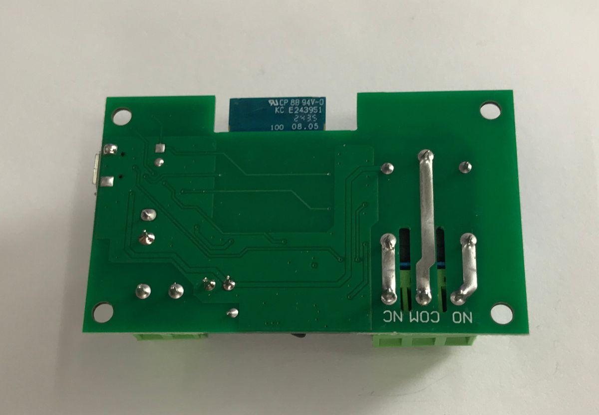

    There are no components on the underside of the board. The current paths are thickened. The distance between them and the low-voltage ground is acceptable, but could be greater – I can’t see any reason why not; it’s odd that they didn’t increase it.
    We flash the firmware via UART. First, we make a copy of the batch, then we flash the OBK. We recommend using this tool:
    The flasher detects the Tuya configuration:
    Verbal interpretation:
    Device seems to be using CB3S module, which is BK7231N chip.
    - Relay (channel 1) on P24
    - WiFi LED on P8
    - LED (channel 1) on P9
    - TglChannelToggle (channel 1) on P14
    - Pair/Toggle All Pin on P6
    The lack of RF information in the Tuya configuration confirms my suspicion regarding how the device operates.
