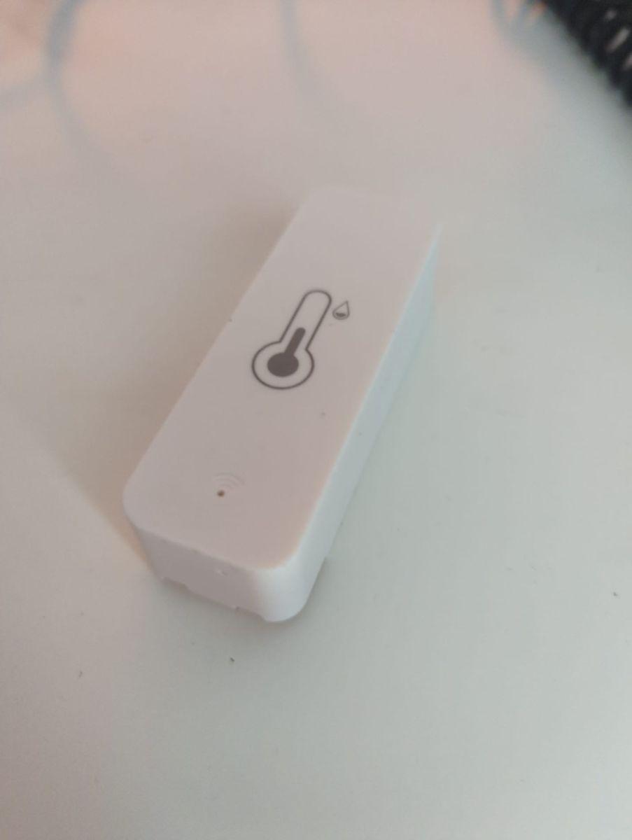

    [BK7238] [T1-S3] [CHT8310] TH01 WiFi Temperature & Humidity Sensor
    Hi,
    i sucessfully flashed openBeken onto these TH01 temperature sensors which uses a T1-S3 Module.

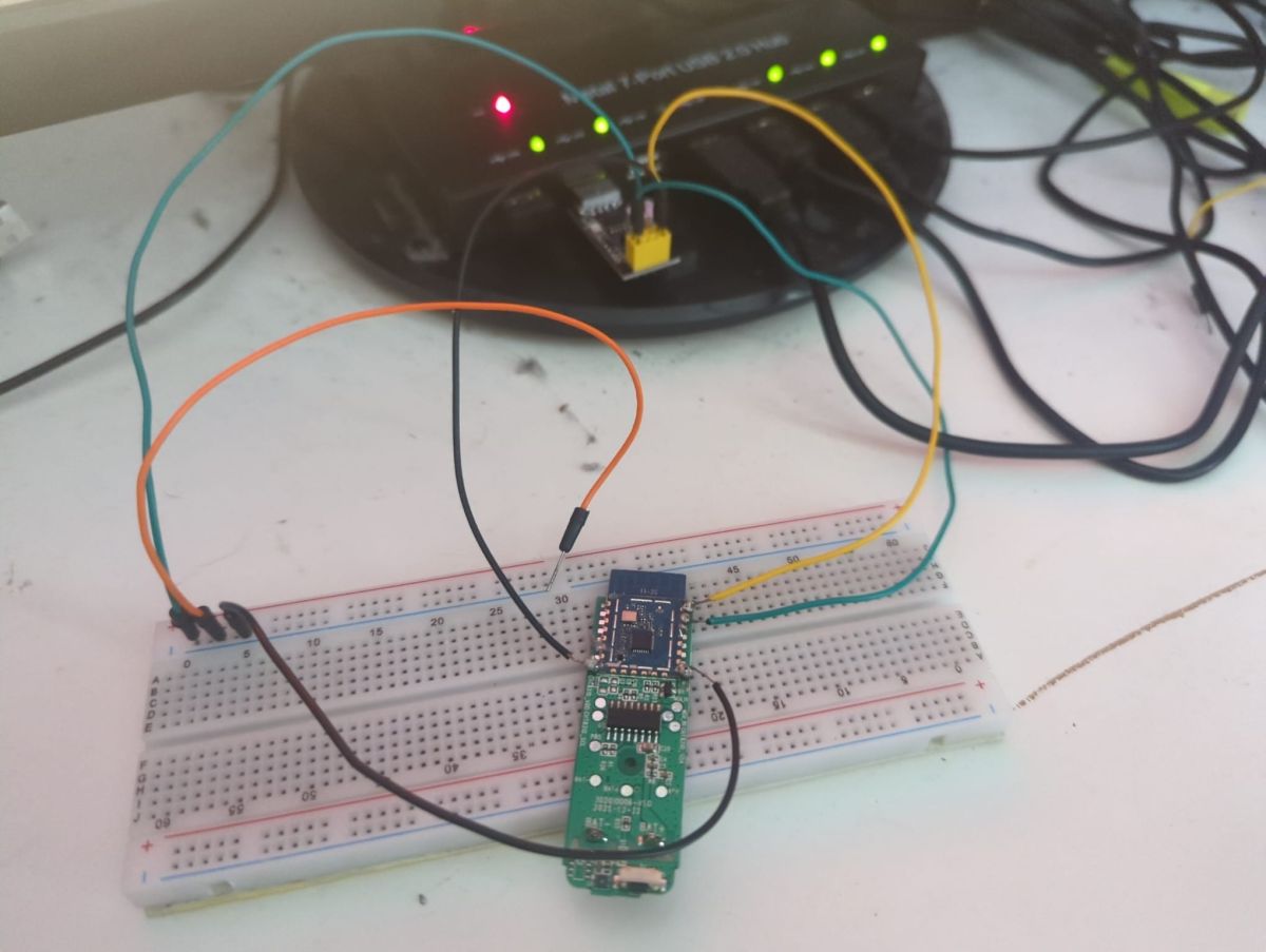

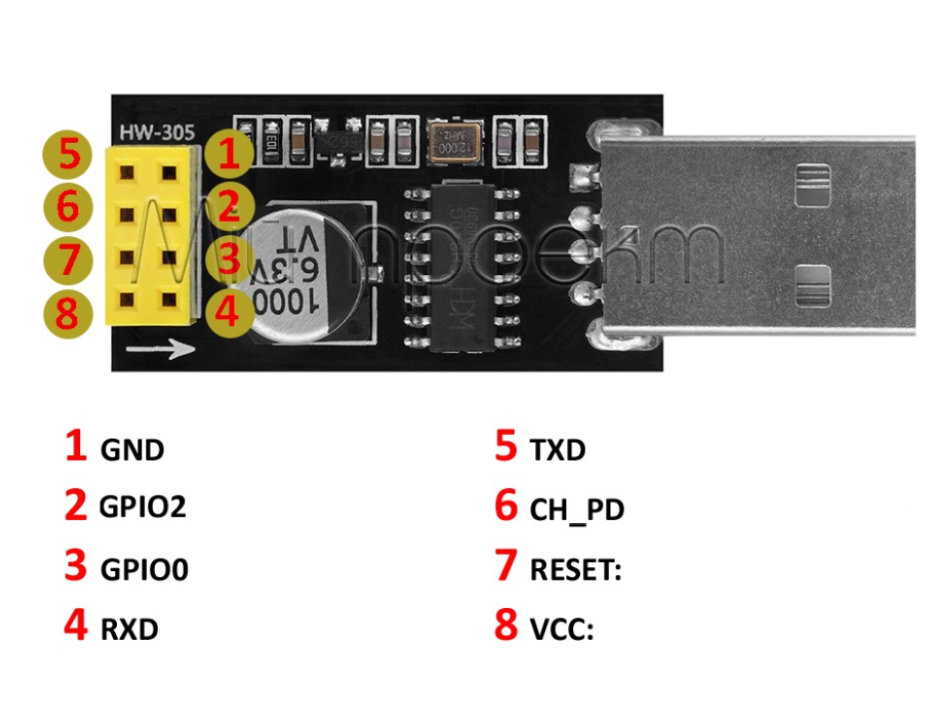

    It is a battery powered device and the flashing steps were rather difficult because it goes back to its sleep mode quickly and terminats it's connections.
    [BK7238] [T1-S3] [CHT8310] How to configure pins on TH01 T & H sensor after OpenBeken flash?
    I found out that the button on this device keeps the chip from falling "asleep".
    So I had to set the baudrate up (9600 -> 1500000) so the transfer got done faster and during the flashing process (read or write) keep clicking the physical button every secound or so to keep the device from falling asleep.
    The connection was setup with my USB2TTL - CH340 adapter and i put 3.3VCC, GND, TX1 and RX1 according to the pinlayout.
    I had to switch RX, TX vice versa, so to say i switched it a couple of times so it matches correctly to give me a correct output signal.
    Then i reset it while powered on with everything connected with the CEN/RST pin with GND to bring it into "download/flashing mode"
    BK7231GUIFlashTool-build-378 - BK73123Flasher for Windows was used for that which worked fine for chiptype BK7238 (T1).
    Breadboard with a small circuit board and jumper wires on a desk; device with LED lights in the background.
    This way it sucessfully flashed the openBK firmware on the device and it opened its Hotspot.

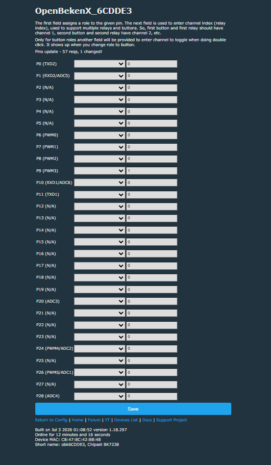

    Now i face the issue that i have no clue about the pin configuration on the webinterface.
    I made a firmware dump of the device before and tried to extract the Config from it but it only says:
    Sorry, no meaningful pins data found. This device may be TuyaMCU or a custom one with no Tuya config data.
    Baud keyword found, this device may be TuyaMCU or BL0942. Baud value is 9600
    No module information found.
    Device internal platform - T1, equals BK7238.
    And the Tuya section starts at 2052096 (0x1F5000), which is a default T1/XR806 and some T34/BK7231N offset.

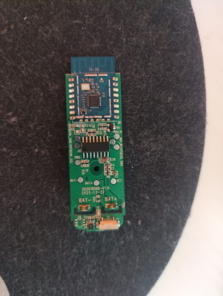

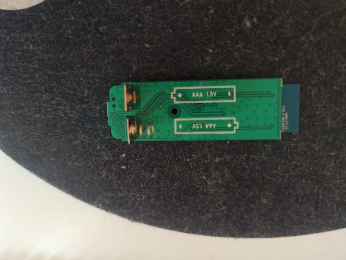

    It is printed CH8310_SCL and CHT8310_SDA on the PCB of the board so i assume its using the CHT83XX driver.
    I want the device to display the Temperature, Humidity, Battery Level readings and maybe have the Button as well as the LED of the device working.
    Can someone with more knowledge help me figure out the Pin configuration for these devices?

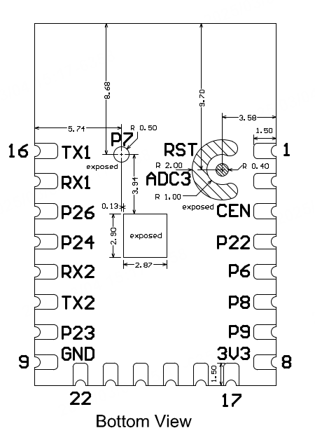

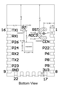

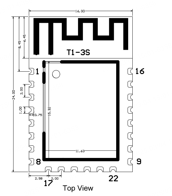

    Datasheet T1-S3:
    https://developer.tuya.com/en/docs/iot/T1-3S-Module-Datasheet?id=Keesax53r0r2d

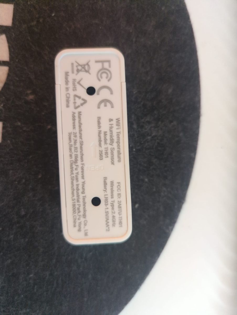

    Can you upload clear photos of both sides of the PCB, especially the traces/labels from CHT8310_SCL, CHT8310_SDA, the button, LED and battery measurement circuit to the T1-S3 module pins?
    I've attached photos of both sides of the PCB.

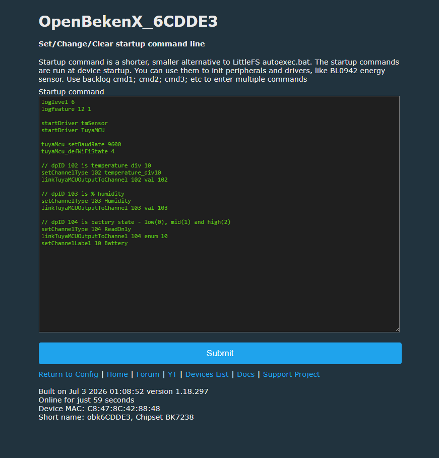

    Okay, since the T1-S3 is a tuyaMCU the pin configuration is not needed i guess? I left them all blank for now.
    I tried with the startup commands that i found in the comments and matched them against the dpID's and baud rate i got from the config extract of the firmware dump.
    loglevel 6
    logfeature 12 1
    startDriver tmSensor
    startDriver TuyaMCU
    tuyaMcu_setBaudRate 9600
    tuyaMcu_defWiFiState 4
    // dpID 102 is temperature div 10
    setChannelType 102 temperature_div10
    linkTuyaMCUOutputToChannel 102 val 102
    // dpID 103 is % humidity
    setChannelType 103 Humidity
    linkTuyaMCUOutputToChannel 103 val 103
    // dpID 104 is battery state - low(0), mid(1) and high(2)
    setChannelType 104 ReadOnly
    linkTuyaMCUOutputToChannel 104 enum 10
    setChannelLabel 10 Battery
    But no values show up.

    Added after 2 [hours] 56 [minutes]:
    yeah, for anyone reading this i found i way to do the last mile.
    First i set these commands up:
    //Verbose logging
    loglevel 6
    //Logging Features
    logfeature 12 1
    //starting the tuyaMCU driver
    startDriver TuyaMCU
    //setting the device so it assumes its cloud connected
    Then i mapped the dpID's I have extracted from the firware to this:
    //Temperature type Channel 1 with divider by 10
    setChannelType 1 Temperature_div10
    //since there are 64 channels the dpID is mapped to val 1
    //apply a label to the channel
    setChannelLabel 1 Temperature
    //Humidity type Channel 2
    setChannelType 2 Humidity
    //since there are 64 channels the dpID is mapped to val 2
    linkTuyaMCUOutputToChannel 103 val 2
    setChannelLabel 2 Humidity
    //Battery type Channel 3
    setChannelType 3 ReadOnly
    //since there are 64 channels the dpID is enumerated to 3
    linkTuyaMCUOutputToChannel 104 enum 3
    setChannelLabel 3 Battery
    (dont use the // comments in your config)
    loglevel 6
    logfeature 12 1
    startDriver TuyaMCU

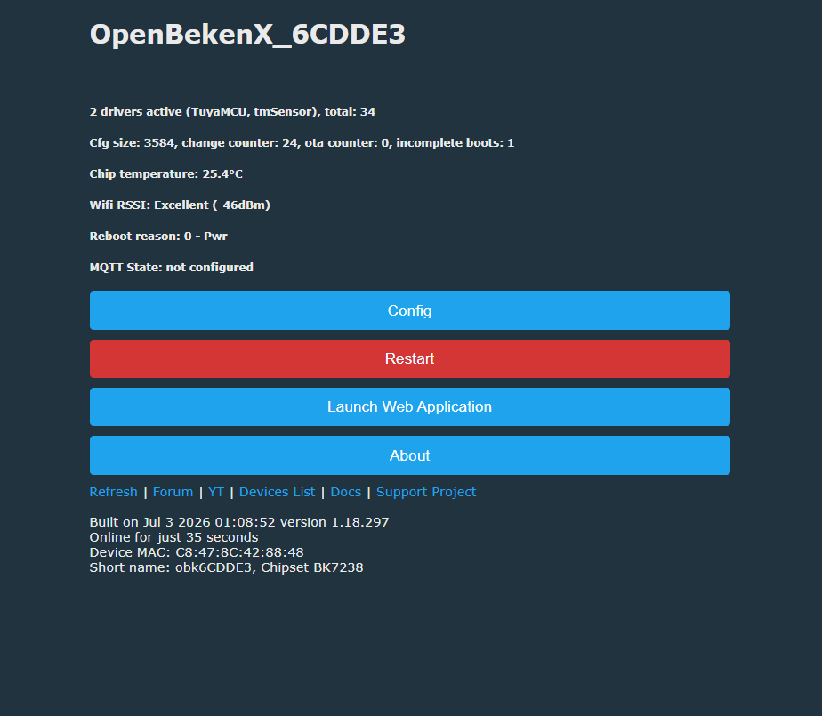

    Next i did launch the Web Application and reviewed the logs tab.
    I first started seening this:
    Info:TuyaMCU:Received: 55 AA 03 01 00 37 7B 22 70 22 3A 22 78 65 61 67 69 6D 61 6E 74 62 37 64 37 61 70 62 22 2C 22 76 22 3A 22 31 2E 30 2E 30 22 2C 22 6D 22 3A 30 2C 22 6E 22 3A 31 2C 22 73 6D 22 3A 30 7D 24
    Info:TuyaMCU:ProcessIncoming[v=3]: cmd 1 (QueryProductInformation) len 62
    Info:TuyaMCU:ParseQueryProductInformation: received {"p":"xeagimantb7d7apb","v":"1.0.0","m":0,"n":1,"sm":0}
    This made made me assure that tuyaMCU driver was running and serial was connected between openBK and tuyaMCU, which means things are going in the right direction.
    I've had to press the physical button to make this message apprear, if i did not set the baud rate explicitly (tuyaMCU_setBaudRate 9600 OR tuyaMCU_setBaudRate 115200)
    It does show this TODO message from time to time.
    Info:TuyaMCU:Received: 55 AA 03 02 00 00 04
    Info:TuyaMCU:ProcessIncoming[v=3]: cmd 2 (MCUconf) len 7
    Info:TuyaMCU:ProcessIncoming: TUYA_CMD_MCU_CONF, TODO!
    but after i applied the correct config to the startup commands, i got
    ExtraDebug:TuyaMCU:TuyaMCU heartbeat_valid = 1, product_information_valid=1, self_processing_mode = 1, wifi_state_valid = 0, wifi_state_timer=0
    ExtraDebug:TuyaMCU:Will send TUYA_CMD_QUERY_STATE (state_updated==false, try 0).
    Info:MAIN:Time 32, idle 405516/s, free 114832, MQTT 0(2), bWifi 1, secondsWithNoPing -1, socks 2/24
    Info:MAIN:Time 33, idle 392900/s, free 114920, MQTT 0(2), bWifi 1, secondsWithNoPing -1, socks 2/24
    Info:TuyaMCU:Received: 55 AA 03 00 00 01 01 04
    Info:TuyaMCU:ProcessIncoming[v=3]: cmd 0 (Hearbeat) len 8
    ExtraDebug:TuyaMCU:Will send TUYA_CMD_QUERY_STATE (state_updated==false, try 1).
    Info:MAIN:Time 34, idle 405465/s, free 114712, MQTT 0(2), bWifi 1, secondsWithNoPing -1, socks 3/24
    ExtraDebug:TuyaMCU:Will send SetWiFiState 4.
    Info:MAIN:Time 35, idle 397966/s, free 114920, MQTT 0(2), bWifi 1, secondsWithNoPing -1, socks 2/24
    Info:TuyaMCU:Received: 55 AA 03 03 00 00 05
    Info:TuyaMCU:ProcessIncoming[v=3]: cmd 3 (WiFiState) len 7
    Info:TuyaMCU:Received: 55 AA 03 22 00 08 66 02 00 04 00 00 01 25 BE
    Info:TuyaMCU:ProcessIncoming[v=3]: cmd 34 (Unknown) len 15
    Info:TuyaMCU:ParseState: id 102 type 2-val len 4
    Info:TuyaMCU:ParseState: int32 293
    Info:GEN:CHANNEL_Set channel 1 has changed to 293 (flags 0)
    Info:MQTT:Channel has changed! Publishing 293 to channel 1
    Info:TuyaMCU:ProcessIncoming: 0x22 replying
    Info:TuyaMCU:Received: 55 AA 03 22 00 08 67 02 00 04 00 00 00 21 BA
    Info:TuyaMCU:ParseState: id 103 type 2-val len 4
    Info:TuyaMCU:ParseState: int32 33
    Info:GEN:CHANNEL_Set channel 2 has changed to 33 (flags 0)
    Info:MQTT:Channel has changed! Publishing 33 to channel 2
    Info:TuyaMCU:Received: 55 AA 03 22 00 05 68 04 00 01 02 98
    Info:TuyaMCU:ProcessIncoming[v=3]: cmd 34 (Unknown) len 12
    Info:TuyaMCU:ParseState: id 104 type 4-enum len 1
    Info:TuyaMCU:ParseState: byte 2
    Info:GEN:CHANNEL_Set channel 3 has changed to 2 (flags 0)
    Info:MQTT:Channel has changed! Publishing 2 to channel 3
    After that, the values appeard on the webinterface.
    So thankfully i did not have to set any pin configuration after all.
    idk, silly me!
