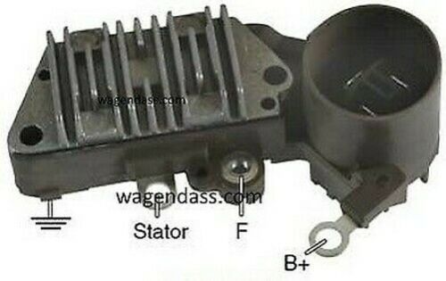

  • Need pinout for Denso 100211-3181 bench test
    #35 19608143
    tacim
    Posts: 174
    Rate: 83
    Hello to you. Patient over 30 years old. I fired the car, the charging caught fire, after a while it went out while driving above 2500 revs, it started to burn back. No charging. Picked out the Denso 100211-3181 alternator. I replaced the voltage regulator with the IC. I put on the car and nothing. I checked the beam is ok. I want to test it on the table, the plug is 3-pin there are no markings where to connect the bulb to the signal.
    How to test an alternator on the bench after removing it from the car?
    Maybe someone knows what I can use to replace Denso 100211-3181 if I give up.
  • #36 19608638
    carrot
    Moderator of Cars
    Posts: 8495
    Help: 1315
    Rate: 3603
    This regulator has 3 terminals: IG + after the ignition switch, L charging lamp (this is only information, excitation is provided by IG), S (sense) to + battery
