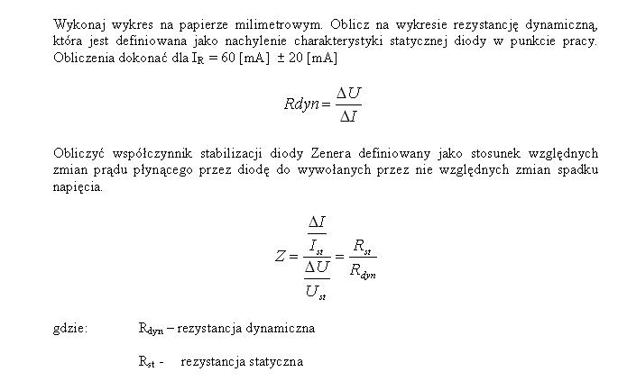

    Hello, How to calculate the dynamic resistance and stabilization factor of a zener diode given its characteristics. Calculations should be made for Ir = 60 +/- 20 [mA]
    should it look something like this:
    reads from the graph the values of U for I=40 (60-20) and for I=80 (60+20) and subtracts the larger from the smaller and thus I get ΔU ?
    and ΔI = 40 mA ? (80-40)
    hence Rdyn=ΔU/ΔI
    what about stat? is it U for Ir = 60 divided by Ir ? ) (Ir from command content)
    therefore Z = Rst/Rdyn ?
    please reply. Regards

    hmm, I'm posting a snippet of the manual..
    how to relate to it?
     Calculating Dynamic Resistance & Stabilization Factor for Zener Diode (Ir = 60 ± 20mA)
    Well, paper will bear everything ... but who and what do you need this parameter for when designing a parametric voltage stabilizer (from which the load current is usually taken) using a Zener diode?
    For me, this is "contrived", because for calculations of the basic stabilization factor, i.e. changes in the output voltage to changes in the input voltage, only the dynamic resistance and other parameters of the circuit are enough (as a necessary parameter).
    Regards

    hmm, that's right, but this exercise was about testing the zener diode as one of the diodes (there were also germanium ones, etc.). This is not about the stabilization factor of the system in relation only to the input and output voltage, so these calculations at the beginning and is this Ir = 60 +/- 20 is the load current? :/ now the question is whether this dynamic resistance can be calculated as in the first post.
    Added after 3 [minutes]:
    except that in another manual found somewhere on the internet it was:
    The zener diode stabilization factor is the ratio of the relative change in voltage to the relative change in current. It can also be defined as the ratio of the dynamic resistance rz to the static resistance Rz of the zener diode.
    heh that's the opposite of what is in my manual :)
