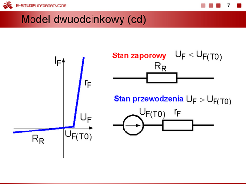

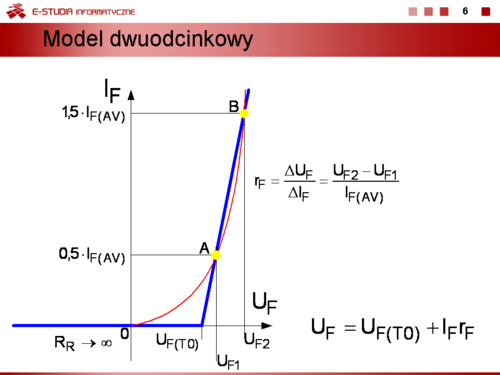

    Found something like this, but still can't figure out the task.
    Calculating dynamic resistance using voltage and current values (U1, I1; U2, I2; U3, I3)
    Since the resistance of the blocking region is very high, about 107 times higher than the breakdown and conduction resistance, a two-segment approximation of the diode characteristic is often used, e.g. to determine the conduction power losses.
    For this model in the conduction state, one can write:
    Uf = Uf (To) + Ifrf
    where:
    Uf - voltage of the diode switch-on threshold,
    rf - dynamic resistance of the diode,
    Diode dynamic resistance definition:
    In the reverse state, the diode is represented by a linear resistor Rr, and in conduction by a series circuit consisting of a voltage source modeling the voltage of the diode turn-on threshold and a dynamic resistance rf. Thus, for voltages and the conduction state, the voltage is described by the formula for the two-segment model.

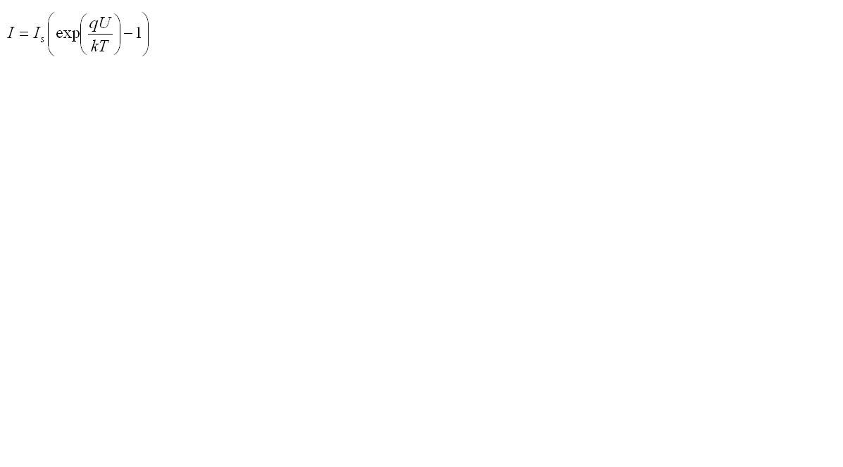

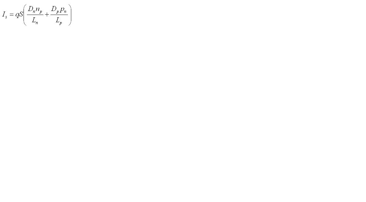

    The changes in the intensity of the ideal pn junction as a function of the bias voltage are described by Shockley's formula:
    where: Is - junction saturation current,
    U - bias voltage,
    T - temperature [K], S- joint surface,
    Dp, Dn - hole and electron diffusion constants, Ln, Lp - electron and hole diffusion paths

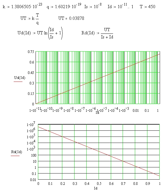

    You have the formula for the diode current as a function of the voltage on it:
    $$Id=Is*(e^{\frac{Ud}{U_T}}-1)$$
    From this you find the formula Ud = f (Id) that is
    $$Ud=U_T*ln(\frac{Id}{Is}+1)$$
    where
    $$U_T=\frac{kT}{q}\approx 86\mu V*T$$
    T - temperature in degrees Kelvin
    from the formula for Ud you calculate the derivative
    $$\frac{dU_d}{dI_d}$$
    you substitute the values of UT (from the formula for UT that is 42.14mV) and Id and you get the value of Rd

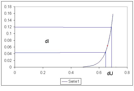

    First you need to draw a graph based on the formulas you got from Paweł ES.
    Later, you select the point from the graph where you want to test the dynamic resistance
    Then you draw some interval near that point on the X axis and corresponding one on the Y axis
    On the X axis you count the increment (you subtract the smaller value from the greater value) and you already have dU similarly on the Y axis
    And then Rd = dU / dI
    • Calculating dynamic resistance using voltage and current values (U1, I1; U2, I2; U3, I3) bez tytułu.jpg (20 KB) You must be logged in to download this attachment.
  • #22 4288288
    Quarz
    Posts: 14357
    Help: 1646
    Rate: 629
    this is a very inaccurate description. It is necessary, first of all, to build tr rectangular triangle on tangent to the curve at a given point and from the length of the triangle's legs, calculate the quotient: ?U / ?I = Rd .
    This is an approximate calculation derivative value at point based on derivative geometric interpretation .
    The dependence of the current AND from voltage ( Shockley's formula ) AT or also inverse function , i.e. the dependence of voltage on current is given in the manner analytical , so there is nothing to prevent this derivative from being counted (exactly) in this way.
    Then substitute the value of the current to obtain the value of this dynamic resistance for the given value of the current.

    Again from the beginning, because I am asking a few people and the results are amazing:
    Task - Calculate the dynamic resistance of the diode:
    Data:
    T = 450K
    Is = 10to-8
    Ud = 10uV
    Wanted:
    Rd =?
    According to @Paul_ Es., We have:
    I transform it as follows to extract Ud:
    we also have data:
    now we count Rd:
    but I still lack data, ie what about this Id?
  • #24 4301521
    Quarz
    Posts: 14357
    Help: 1646
    Rate: 629
    Data:
    T = 450K
    Is = 10to-8
    Ud = 10uV
    Wanted:
    Rd =?
    now we count Rd:
    only that you computed this derivative wrong (or I don't understand this - simplify it) ... check.
    On the other hand, to get the number, i.e. the value of the derivative for a given current value Id , you just have to substitute the forward current of the diode Id , and you already know the other quantities in this derivative.
    greetings

  • #30 4303302
    Quarz
    Posts: 14357
    Help: 1646
    Rate: 629
    maybe these charts will "lighten" this issue for you:
    Notice that the charts are made of semi-log scale (one of the axes has a linear scale, and the other has a logarithmic scale), and this is due to the spread of size changes and with a linear scale, a significant part of the graph (due to the resolution of the drawing) would not be properly shown.
    Don't forget that derivative of a function of a given independent variable is also function (only another one) this variable .
    To obtain the value of a function for a given value of the argument (independent variable), then this value of the argument should be known, and if the value of the argument is not known, only the dependence graph prepared on the basis of the analytical record of this function remains.
    Of course occurring here physical quantities have their units (which I have not written here in order not to obscure the record), and which are legal and basic units of the binding System of Units SI .
    greetings
