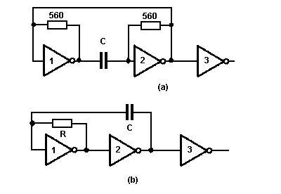

    I would rather suggest a generator on TTL bones, or TTL-LS, then you have NEARLY 5V! Check this out:
    How to build a 3MHz BF200 LC generator – 0–5V output for ATmega? .
    Instead of C you can put in a quartz, or a WIDE LC circuit, also works nicely ....

    Buddy George from what I read in Prodig's post he needs a sine wave not a rectangle and this generator will output a pure rectangle as for the stabilisation of this generator hmm I have read a bit about it and some people are not happy with it...Kudos to you

    If the signal input is on an Atmega, the best accepted waveform is rectangular, with TTL levels.

    Thank you for your answers. Indeed, a circuit with gates is rather out. The Atmega can handle a sine wave - it is important that the sine wave has values varying from 0 to 5V.
