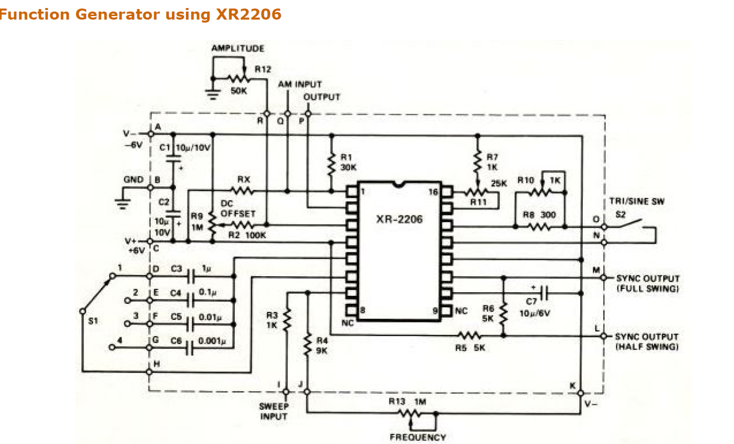

    I have the same. With this amplitude potentiometer, it is a matter of cutting one track and soldering another pot with a wire.
    The device generates a DC component at the output, probably 1/2 of the supply voltage (I do not know what it is like in professional generators?).
    Besides, it is a fake of a real XR2206 which from what I remember can be powered up to 24V and the one above 12V gives unstable waveforms.
    There is a video on YouTube of how the guest improves this equipment (sine wave shape, some harmonics, I think, and the output voltage changed to lower).

    This kit on the XR2206 is nice, sine waveform better than from kits on the ICL8038. I have investigated all those available as DYI n Ali....
    It is a pity that at least a capacitive negative voltage converter was not added to the circuit, then there would be a generator with adjustable DC component. Such a patent is in one of the kits on the ICL8038.
    The circuit is recommended to be supplied with a voltage of 9 - 12V, but then at a setting close to the max amplitude it limits the vertices of the sine wave. Since the catalogue max supply voltage of the XR2206 is 26V, you can give a higher voltage without problems. Already at 15V it does not cut off the vertices at maximum amplitude. I fed 24V and then the results were best.
    You would need to add a power inverter to reflect the supply voltage to the negative side, then we will have a +/-12V supply and it will make a nice generator. The current consumption is about 25mA. Maybe someone knows of a simple tried and tested circuit?
    I found such a full generator circuit from an XR2206 powered by a symmetrical voltage, using probably all the functions of the IC.
    Circuit diagram of a function generator using XR2206 .
