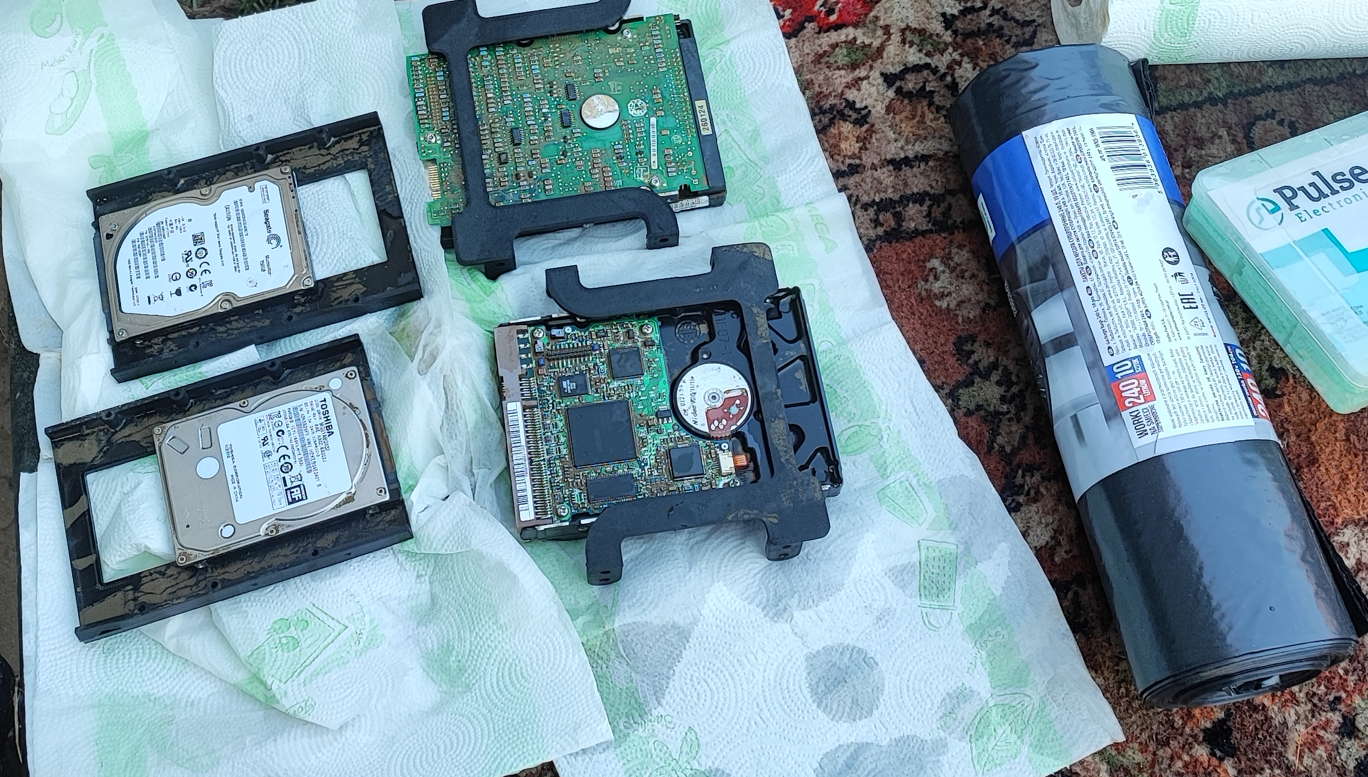

    After 3 days of flooding I extracted the disks from the room and gave them to the balcony, into the sun, to dry:
    Damaged hard drives lying on a surface covered with paper towels. .
    After 11 days of flooding I decided there was no point (no space, all the rooms downstairs empty but waiting to be dried/disinfected), so I took photos and scrapped the disks. A mass of other equipment too.
    It's a pity I didn't come up with the idea of sealing them, each individually, in ziplock bags before flooding them, maybe then they would have survived.

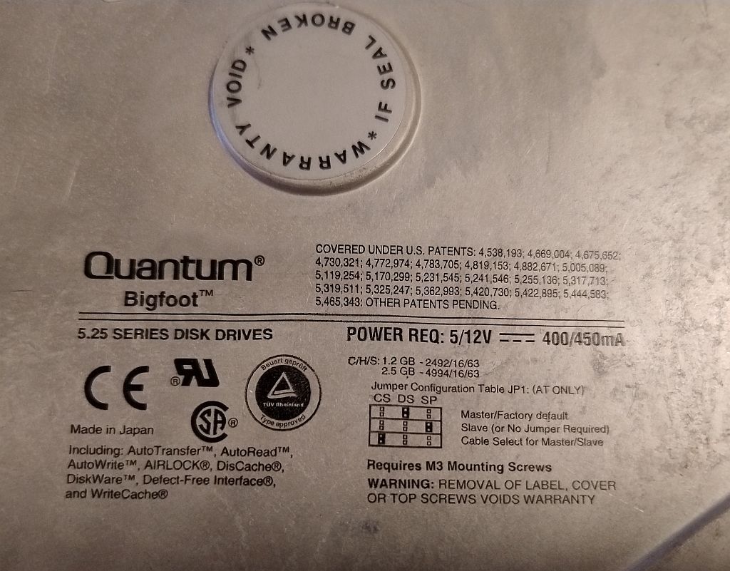

    The first is a 5 1/4 inch Quantum disk from the Bigfoot series (next to it, for comparison, a conventional Quantum 3.5 inch):
    Two Quantum hard drives on a wooden table; a larger 5.25-inch Bigfoot model next to a standard 3.5-inch drive. .
    I don't know why they made it that way - in those days, that capacity could already fit on 3.5 inch platters. Perhaps for some customers bigger meant better. Indeed, the drive was not only large in size, but also heavy - a piece of aluminium. The label of this "invention":
    Label of a Quantum Bigfoot 5.25-inch hard drive showing technical specifications. .

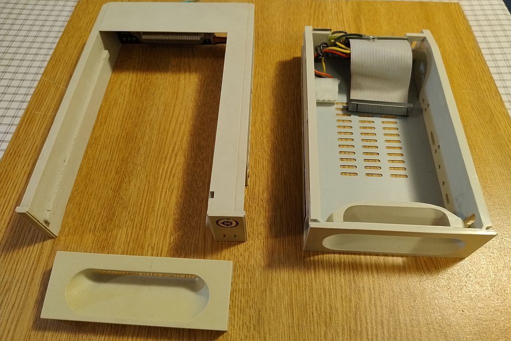

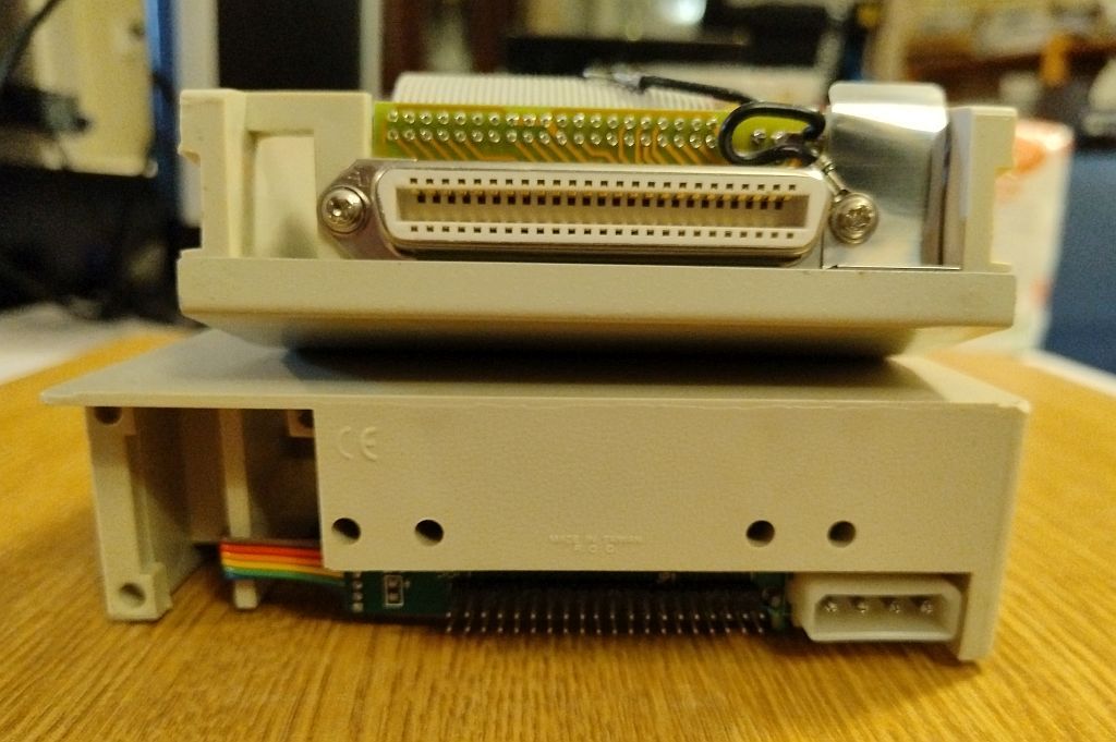

    The second curiosity is a hard drive pocket that was very popular in the second half of the 1990s. It was sort of the equivalent of a memory stick - at a time when USB had not yet been heard of and the size of a floppy disk - even a 3.5 inch HD - 1.44 MB was already far too small. The HDD was placed in a removable drawer - the rest was mounted in a free 5 1/4 bay of the computer (such as for a CD-ROM drive). To remove the drive you didn't have to dismantle the computer - just slide the drawer out:
    Hard drive bay with an open drawer, visible IDE ribbon cable. .
    A cap was placed in place of the drawer. Now with the drawer with the disk you could go to another computer with the same pocket and "pirate" to your heart's content :-) (Not only USB was not there, but also the Internet did not work too much yet).
    Of course, removing/connecting the drive could only be done with the computer switched off!
    The drive tray itself was connected like a normal drive with an IDE ribbon and a 5/12V plug. The same for the drive in the drawer. However, the connection drawer <-> pocket had a special interface:
    Close-up of a removable hard drive bay with an interface from the late '90s. .

    Oh, I have just such a Quantum 5 1/4" somewhere. There should be a window on the underside through which you can see the working head arm.
    As for the drawers - everyone had a different one, so you had to open the drawer anyway and change the drive in it. I currently even have one in the computer in the studio. Maybe not so much a drawer as a slot for a SATA drive like in servers, where you slide in the 3.5" drive itself.
  • Drawer standards varied, but hard drives were still easier than floppies

    prosiak_wej wrote:
    What about the drawers - everyone had a different one, so you had to open the drawer and replace the drive in it anyway.
    There were only two standards on the market Adax and Optimus. But in a given environment, one tended to "apply" - everyone tried to be compatible. And even if one had to take a disk out of a drawer, it was less of a hassle than with floppy disks. Especially if one had only a 5 1/4 inch drive and the other only a 3.5 ;-) And in the first half of the 90s it was a nightmare - on top of that DD/HD....

    I remember a Quantum advertisement for the Bigfoot series . Bigger meant higher transmission speed (angular and linear speed). Quantum advertised that there was a higher read speed on larger diameter drives because of the higher linear speed. And anyone remember the 7200 rpm SCSI server drives?

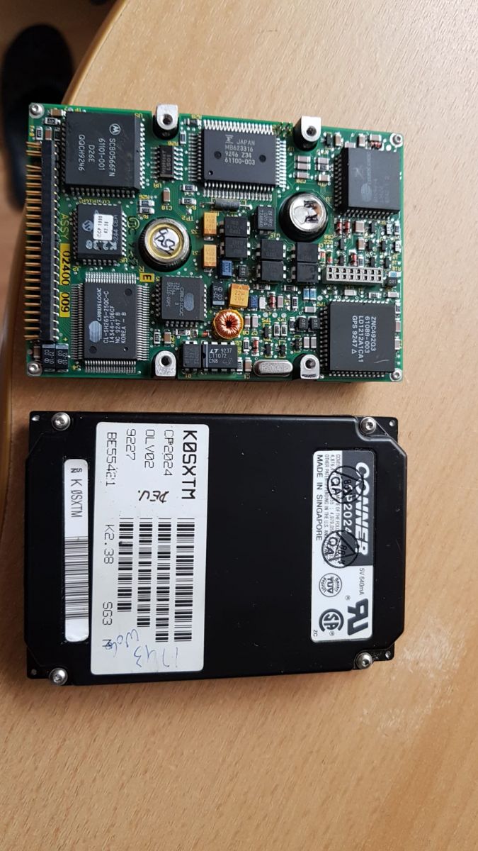

    T Old Conner hard drive and its circuit board lying on a wooden table. o and I will add my monument: Open old hard disk with visible platter and head.

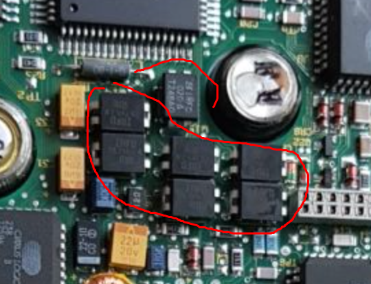

    A chip in a DIP08 housing in an HDD, not bad (LT1072 if I see it right).
    And what are these components? I can't make out from the photo:
    Close-up of an electronic circuit in a hard disk with components marked with a red line. .

    If my sclerosis doesn't deceive me, these are prehistoric field-effect transistors IRFDxxx or some such current 3A .

    It's faintly visible in the photo, probably IRFD.... I'd have to look for a corpse and take a closer look. The one singularly marked: IRFD 020-? T248AO
