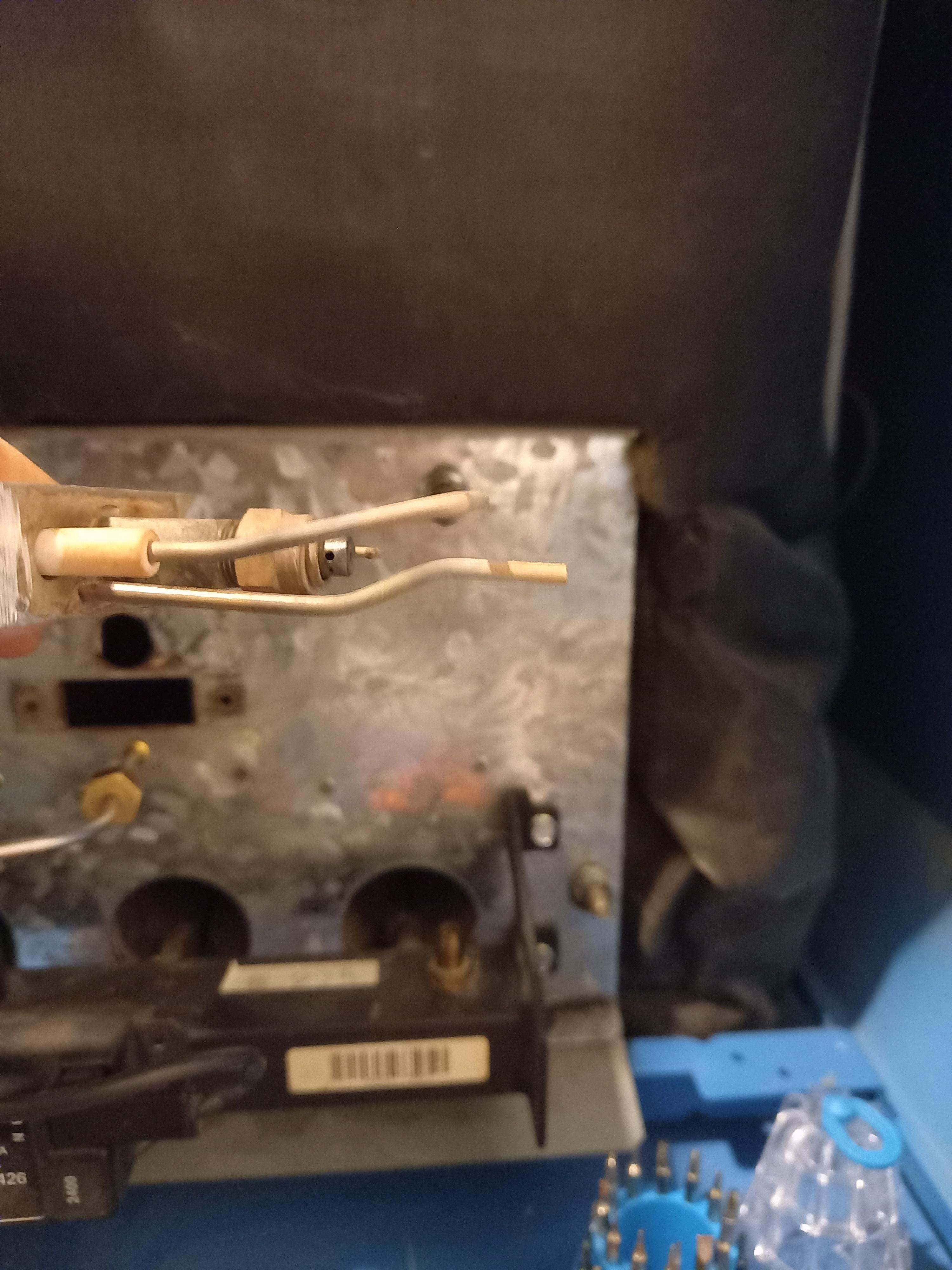

  • #39 15259295
    luk99elektroda
    It ended with replacement of the burner's automaton with a new one. So far it has been working for a week.

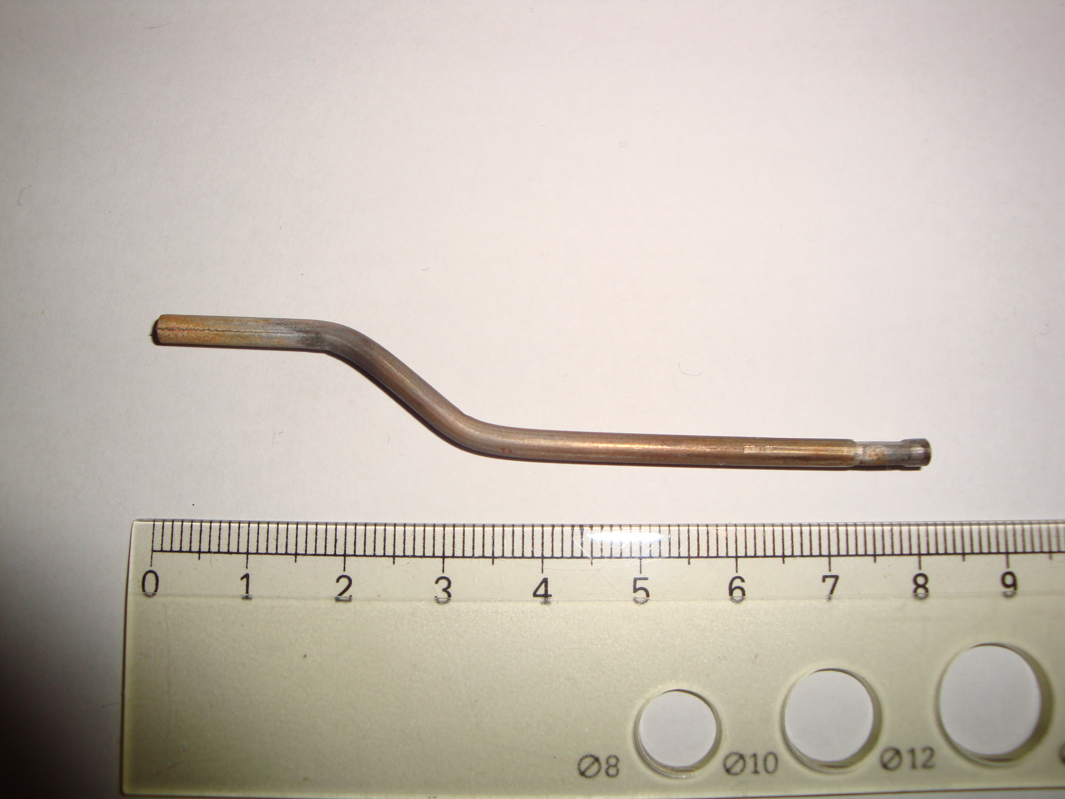

    At home I had to replace the whole Stronic ...
  • #47 18194426
    piracik
    Posts: 4060
    Help: 557
    Rate: 1977
    # 36 is a photograph of a ground electrode that often falls out of this torch.
    It's like in the middle. If it is loose or has fallen out, the machine will not see the flame every time.
    It also often goes out when the main burner starts.

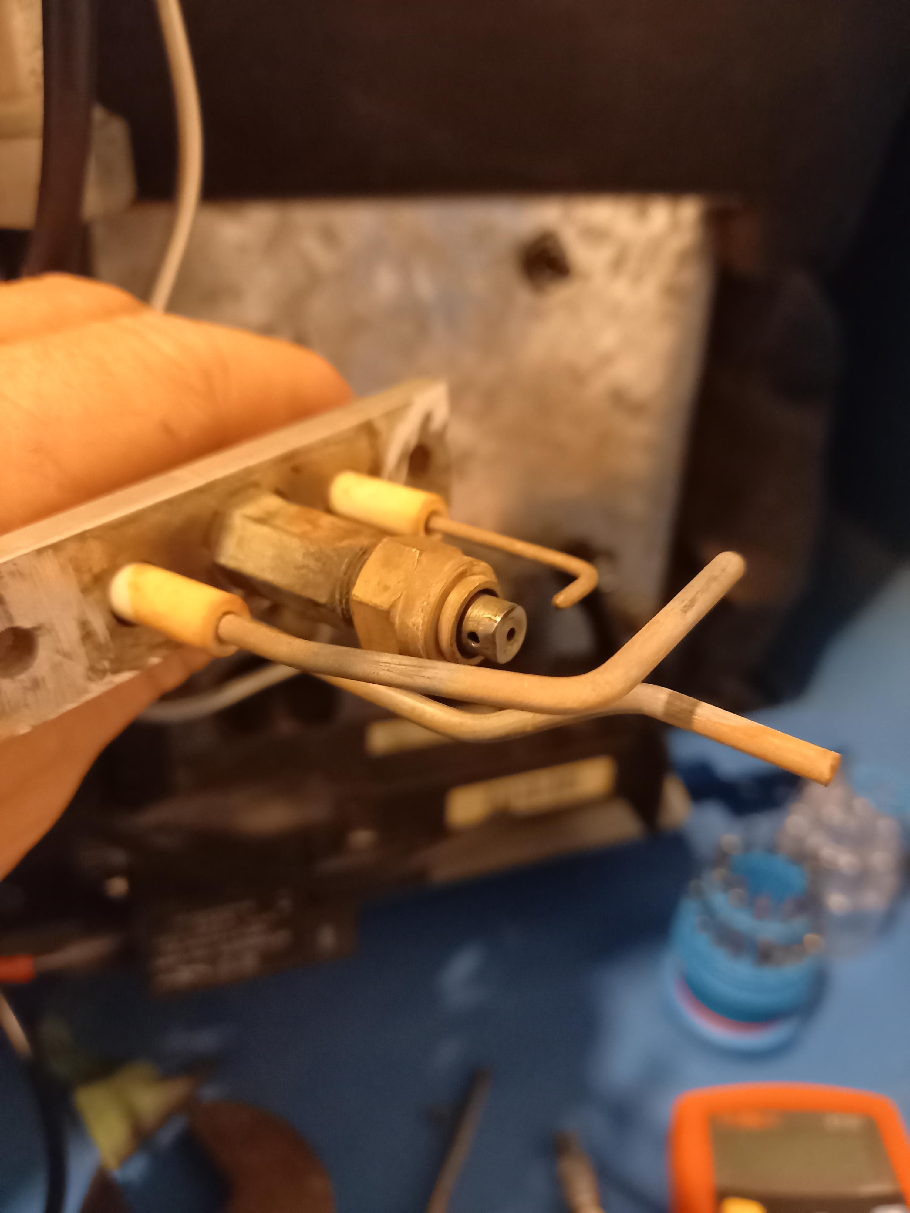

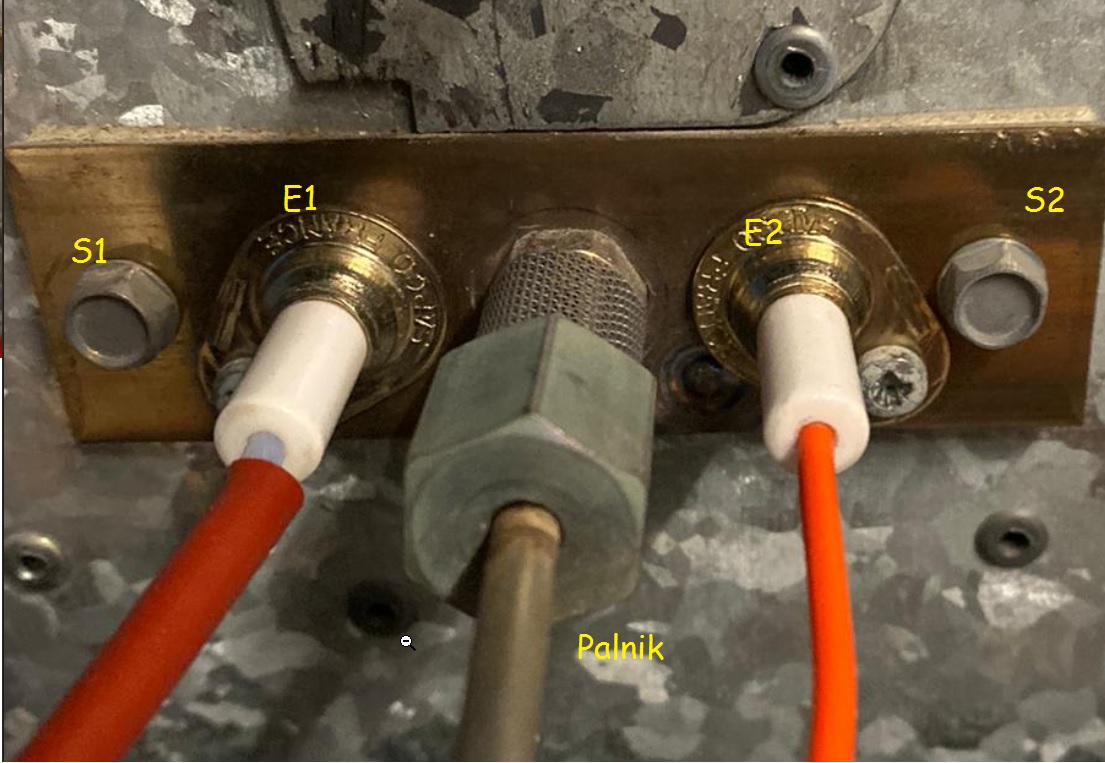

  • #52 18202906
    Piorun2002
    Posts: 269
    Rate: 25
    Thank you for the substantive description, I would just like to clarify if I understand correctly.
    > Unscrew the starter torch being careful not to tighten the screw
    So first remove the wires from both electrodes (E1 and E2), then unscrew the metal wire (Torch - taking care not to tighten the screw) and disassemble the whole by unscrewing the screws S1 and S2
    > Check the condition of the electrodes, check that the massage electrode is not loose.
    Which electrode is it?
    Earlier I took out E1 and E2 - I cleaned it but it did not help much.
    > replace the damaged starter burner gasket
    > clean the burner nozzles and the mesh in front of the nozzle.
    I understand that these elements are visible after unscrewing the burner nut.
    Did I interpret your description correctly? (I prefer to ask twice just in case)

  • #53 18203020
    piracik
    Posts: 4060
    Help: 557
    Rate: 1977
    Buderus Logano G124 Ignition: Switching Off Every Few Days - Replaced Ionization Electrode & More
    Unscrew the entire burner. The ground electrode is clamped in the torch housing.
    Under this tube is a nozzle that needs to be cleaned.

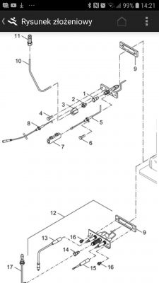

  • #54 18386259
    Piorun2002
    Posts: 269
    Rate: 25
    My experience:
    - cleaning helped :)
    - I did not listen to my friend and instead of explaining the whole burner, I only dismantled the handle with electrode mounting to make it faster, but:
    one from fixing the screw broke (they are terribly corroded)
    the gasket (in Figure 9) was probably already cracked and spilled after being removed
    To sum up: it is better to disassemble the entire burner (I wanted to avoid it because I don't have a gas sensor to check the gas supply connector after assembly)

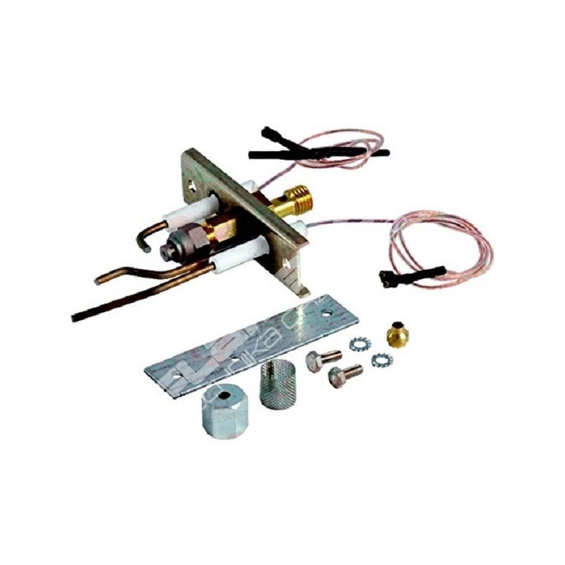

    gipsatura
    Posts: 74
    Rate: 9
    I have just assembled everything, I want to see how it will be until morning, I'll take a picture tomorrow. The nozzle at the end of the candle / burner has it seen as it is seen standing in front of the stove
    one horizontal opening facing the inside of the furnace
    three small holes directed to the sides
    one larger opening pointing to the side
    two small invisible holes after screwing the entire torch
    I just found a pictorial photo of the set
    • Buderus Logano G124 Ignition: Switching Off Every Few Days - Replaced Ionization Electrode & More de-dietrich-do-dtg-palnik-zapalajacy.jpg (45.77 KB) You must be logged in to download this attachment.

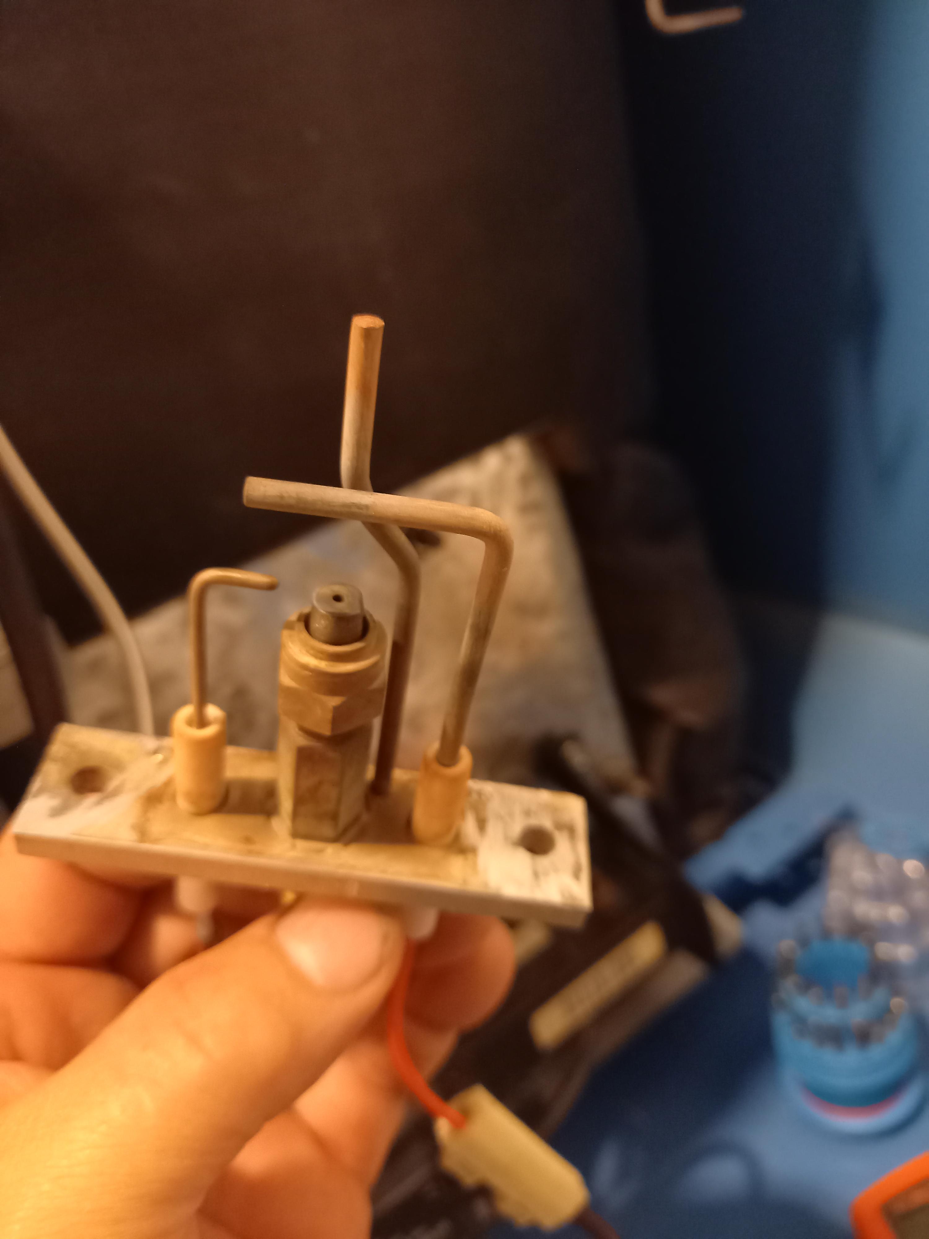

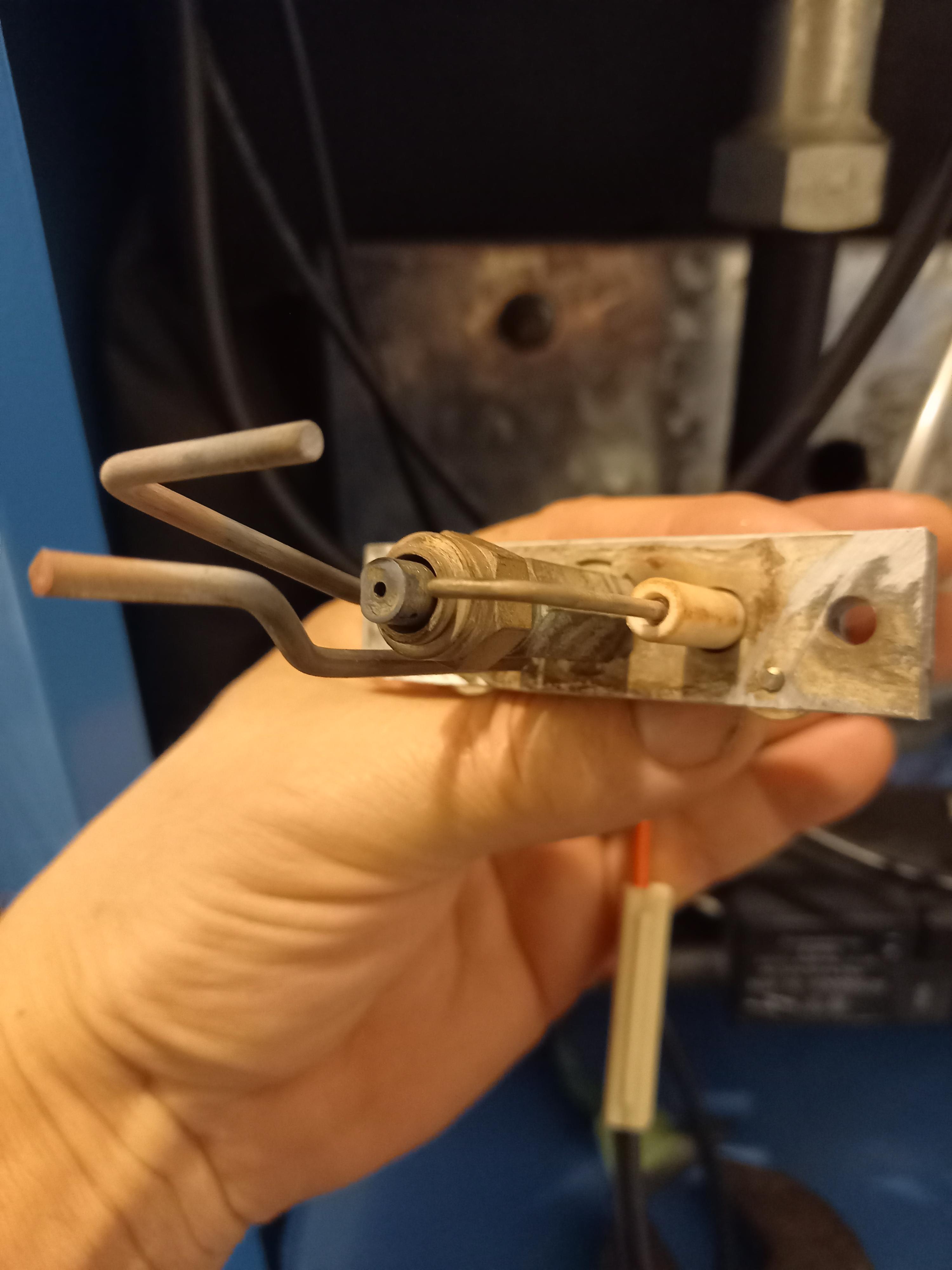

  • #59 18988965
    piracik
    Posts: 4060
    Help: 557
    Rate: 1977
    I know what the burner should look like.
    I meant a photo of your burner.
    The biggest hole for ionization.

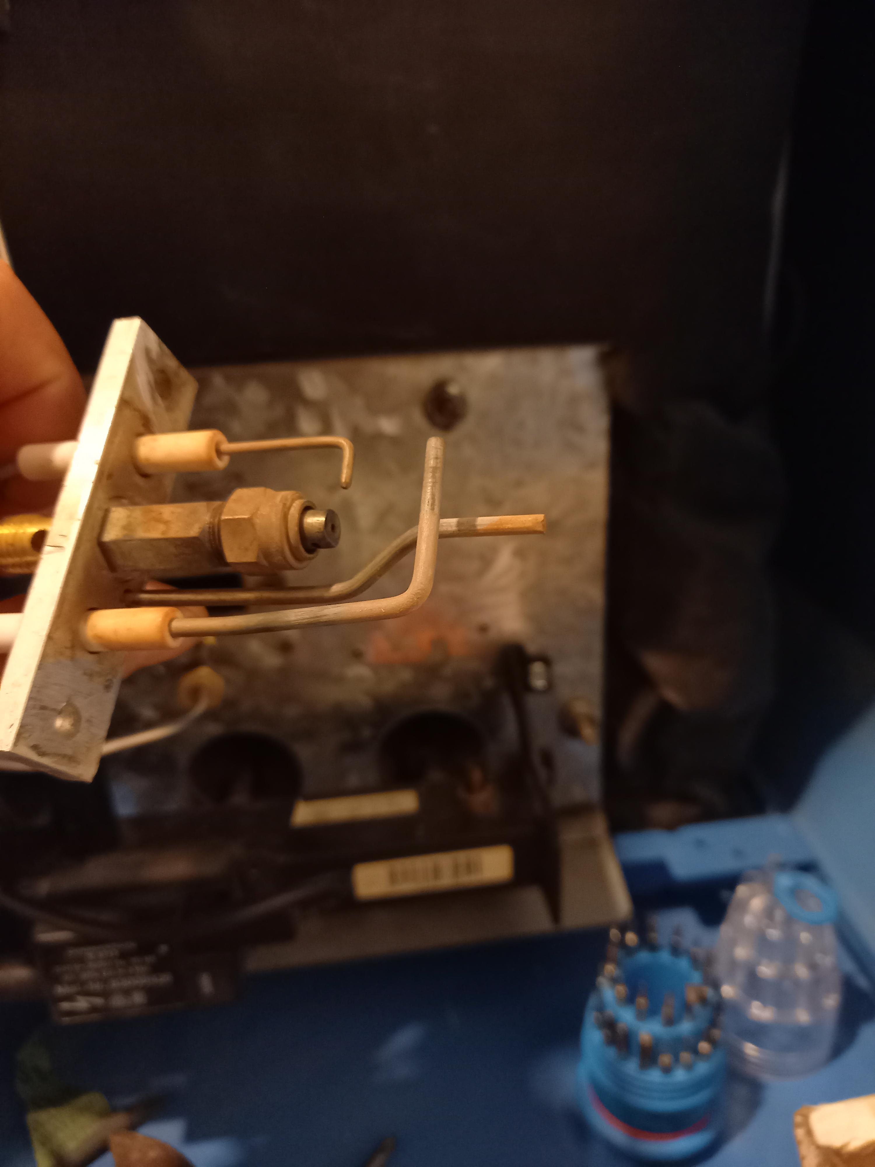

  • #60 18989835
    gipsatura
    Posts: 74
    Rate: 9
    Here you are,
