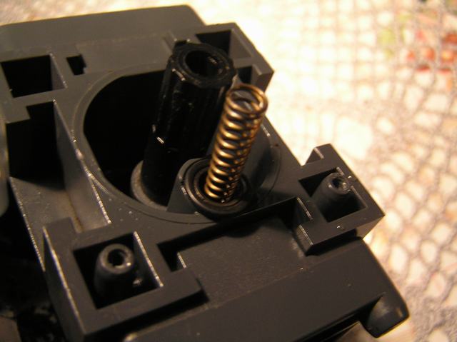

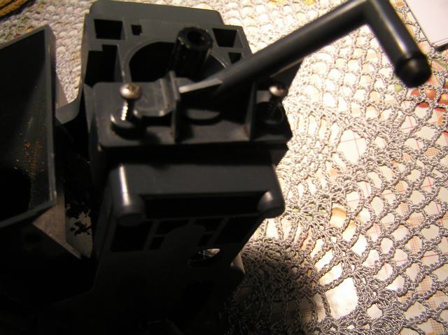

    Royal Professional Saeco SUPO16E Not Powering On - No Screen Reaction
    Under this tube there is a spring and the ball is a ball - as a valve.
    I gave the ball to the "mountain" and WALKING THE MACHINE !!!!!
    Tell me if it should be this ball that closes the hole in the tube that leads the boar - in the springs - looking at the photo or - under the spring?
    I suspect that the "specialist" on the site -was done, "babola."
    Am I right?
    Thanks for your patience. :D

    Zenon407
    Posts: 785
    Help: 5
    Rate: 94
    Is this how you are in the machine?
    After all, as water "goes from above", the ball blocks access to ground coffee!
    Greetings

    Zenon407
    Posts: 785
    Help: 5
    Rate: 94
    Ok.
    I gave the ball down and it only worked, I had to "cram" this tube
    to water. I exchanged o-rings.
    The pump is - "left" and "right" - as the piston - when brewing coffee - also for a moment raises the ball and the water under its own weight falls on the coffee - flies to the cup. Uffffffff
    :D
    Greetings
