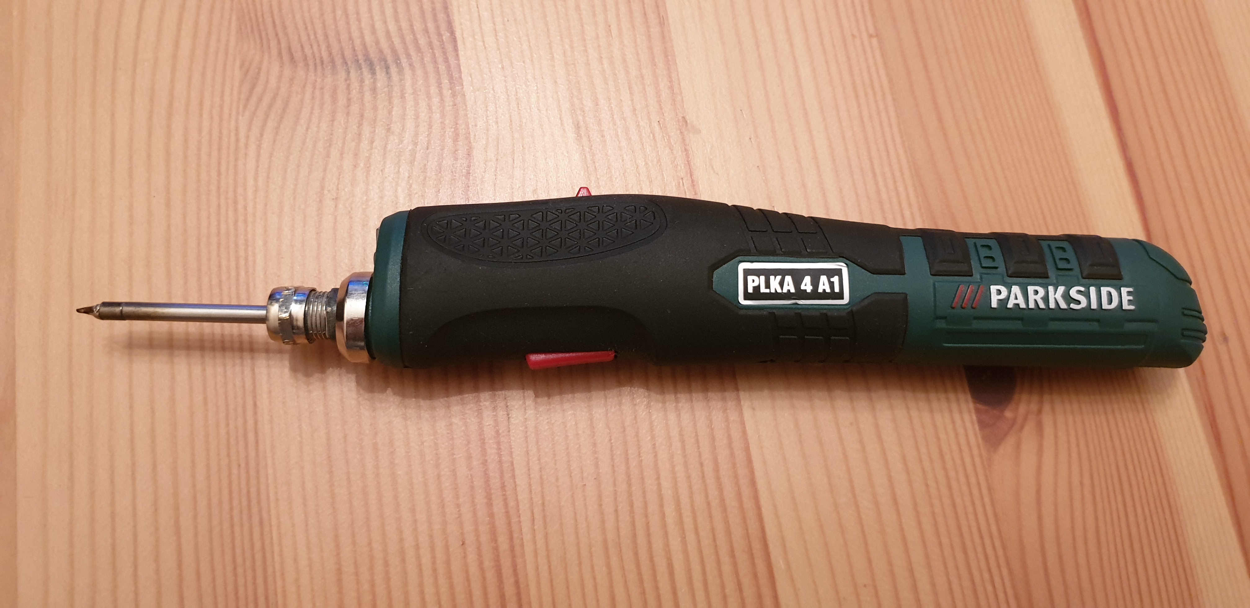

  • The Parkside PLKA 4A1 cordless soldering iron’s original pressed E10-shaft tip failed after a few uses, so it was rebuilt around a cheap replaceable tip.
  • A USB soldering iron tip was mounted in a custom handle made from a bicycle light bulb and trimmed F plug barrel connector, with washers, metal glue, and heat-shrunk wiring.
  • The parts cost about PLN 6 for the USB tip, and the whole repair stayed under PLN 10.
  • The modified iron heats in a few seconds, works like the original, and lets the tip be swapped quickly instead of replacing the whole expensive assembly.
Last year I bought a parkside plka 4A1 cordless soldering iron in lidl. The device is quite handy, although only thin wires could be soldered. After a few uses, the tip stopped heating up, unfortunately it is pressed with the E10 shaft. The wire inside is damaged because after time the "construction" breaks into two parts. I wanted to buy a new tip, but I found out that this is the Achilles' heel of this soldering iron. The tip is available in the German manufacturer's store, for half the price of a soldering iron, and after some time the problem will probably return. Original tip:
I came up with the idea of using a tip from a usb soldering iron (price about PLN 6) and building a replaceable handle with the option of replacing the tip when it gets damaged. I used a bicycle light bulb for my construction - I dug out the whole center with a dremel so that only the "thread" remained. The next element was the F plug connector (barrel). I trimmed it so that the tip wasn't too long, additionally I removed the plastic center. Unfortunately, at this stage, the tip went through the center of the barrel. In order to eliminate this problem, I added two washers. I screwed the barrel into the light bulb, and glued it with metal glue. I pulled a thin wire through the middle, soldered it to the thread of the light bulb and on the other side I put a heat shrink to the usb + tip. I twisted the whole thing with a nut from the F plug. It takes a few seconds to heat up. I didn't feel any difference compared to the original tip.
Now tip replacement is quick and, most importantly, cheap. The whole structure did not exceed PLN 10.

So it turns out that it's better to buy a soldering iron with T-12 tips and power them from a converter giving 12-24V output, depending on the performance of the batteries you have... Because the... [Read more]
noel200 08 Jan 2021 10:25
I had a soldering iron. waste of time. Now I have one on the T12, but shorter. I power it from a power bank with QC3.0 and I have 18W, not 4. And if you power it from a powerbank with Qc4.0, you get even... [Read more]

I'm afraid such a large arrowhead as in the post #6 is unrealistic with a heater of such low power (too much heat capacity). As for the tips themselves, it is worth looking for them on AliExpress... [Read more]
phanick 20 Jan 2022 22:12
I can't imagine soldering anything with such a tip - after all, the heat capacity of this tip is so small that when you touch anything it will immediately stick to the soldered field. Not to mention... [Read more]
