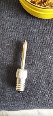

  • The Parkside PLKA 4A1 cordless soldering iron’s original pressed E10-shaft tip failed after a few uses, so it was rebuilt around a cheap replaceable tip.
  • A USB soldering iron tip was mounted in a custom handle made from a bicycle light bulb and trimmed F plug barrel connector, with washers, metal glue, and heat-shrunk wiring.
  • The parts cost about PLN 6 for the USB tip, and the whole repair stayed under PLN 10.
  • The modified iron heats in a few seconds, works like the original, and lets the tip be swapped quickly instead of replacing the whole expensive assembly.
  • Parkside plka battery soldering iron tip repair
    Last year I bought a parkside plka 4A1 cordless soldering iron in lidl. The device is quite handy, although only thin wires could be soldered. After a few uses, the tip stopped heating up, unfortunately it is pressed with the E10 shaft. The wire inside is damaged because after time the "construction" breaks into two parts. I wanted to buy a new tip, but I found out that this is the Achilles' heel of this soldering iron. The tip is available in the German manufacturer's store, for half the price of a soldering iron, and after some time the problem will probably return. Original tip:
    I came up with the idea of using a tip from a usb soldering iron (price about PLN 6) and building a replaceable handle with the option of replacing the tip when it gets damaged. I used a bicycle light bulb for my construction - I dug out the whole center with a dremel so that only the "thread" remained. The next element was the F plug connector (barrel). I trimmed it so that the tip wasn't too long, additionally I removed the plastic center. Unfortunately, at this stage, the tip went through the center of the barrel. In order to eliminate this problem, I added two washers. I screwed the barrel into the light bulb, and glued it with metal glue. I pulled a thin wire through the middle, soldered it to the thread of the light bulb and on the other side I put a heat shrink to the usb + tip. I twisted the whole thing with a nut from the F plug. It takes a few seconds to heat up. I didn't feel any difference compared to the original tip.
    Parkside plka battery soldering iron tip repair Parkside plka battery soldering iron tip repair
    Now tip replacement is quick and, most importantly, cheap. The whole structure did not exceed PLN 10.

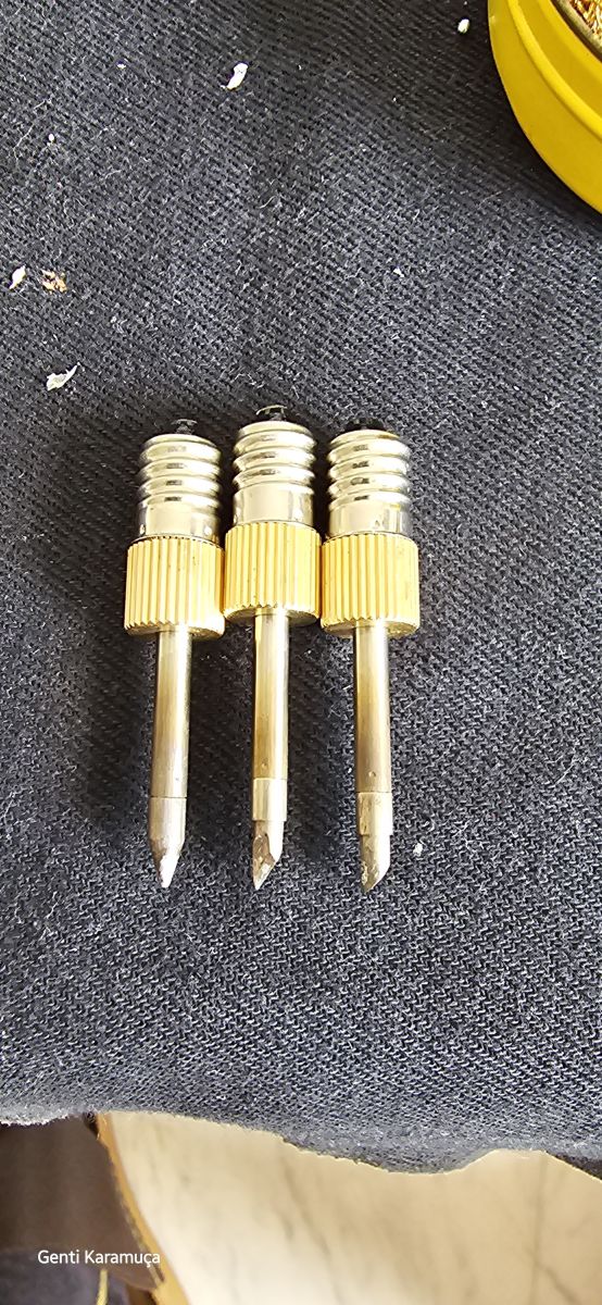

    Throw out this arrowhead due to eating and make yourself, for example, like me:
    For soldering drones and SMD extra case!
    I'll do it more, I'll send a few pieces to the testers :)

    Generally, tips dedicated to this soldering iron can be found on a well-known auction site under the name:
    PARKSIDE LIDL BATTERY SOLDERING IRON,
    but I really like the ones presented by user wesmar.
    Are these grottoes available for purchase anywhere?

    I'm afraid such a large arrowhead as in the post #6 is unrealistic with a heater of such low power (too much heat capacity). As for the tips themselves, it is worth looking for them on AliExpress because I once saw there matching ones with an E10 thread and a different shape of the tip tip.

    I can't imagine soldering anything with such a tip - after all, the heat capacity of this tip is so small that when you touch anything it will immediately stick to the soldered field. Not to mention that the tin will immediately flow from it.
    The ideal tip is a truncated cone-shaped tip with a small recess where the surface tension will hold a drop of tin, which will increase the contact surface with the soldered element and accelerate heat exchange, and ideal for soldering multi-leg ICs.
    And with this arrowhead from the photo, you can probably only stick a fly on it, or gouge out your eye (inadvertently)

    I put a bit longer and cheaper in the atlogika.pl store (practically at the cost with free shipping by Polish mail - priority):
    link
    The problem is that the customer pays VAT twice and the so-called VAT white hole - ergo the state gains double. Once the state collects VAT systemically and it cannot be settled either by aliexpress or the made-in-china.com portal (except for the EORI + honest Chinese from alibaba path). Two, I have to pay VAT a second time or sell privately up to 30 items a year.
    The tip costs me about PLN 15, but with shipping and taxes PLN 43 for 2 pcs is the limit of profitability and a maneuver to save forum users. Of course, you can order individually from China and this is the best way, although often longer and uncertain if you find e.g. swiatprzesylek.pl.
    PS my tips of my own production are not suitable for the built-in 18650 cells in the SI-B161-T or PLKA 4 A2 soldering iron. They have a graphite core and realistically, despite the fact that they are better, a 3C cell is needed, and preferably 5C, so I did not decide on serial production. The replacements I brought are quite OK. Classic 4W power - you can play with small connections, the advantages are more durable and longer than the originals.
