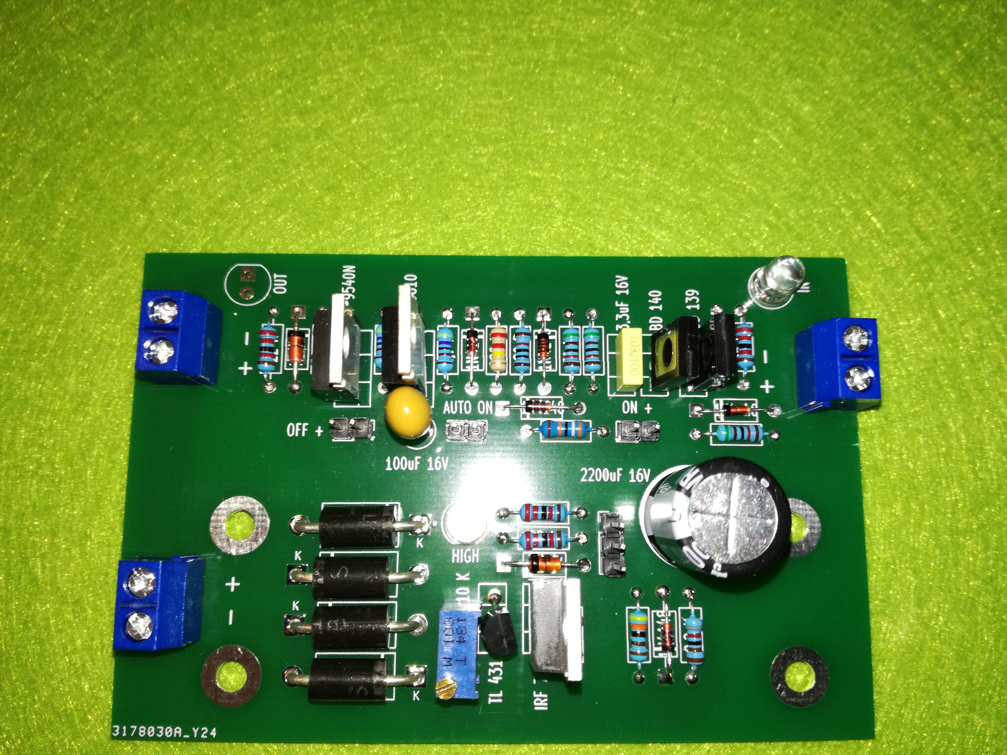

Good day. This year I have completed a project that I have been thinking about for a long time.
It is an electronic protection of the lithium-ion battery (3s 12 V) against excessive discharge and, consequently, against permanent damage. The whole is in the form of a printed circuit board with a multi-turn potentiometer to adjust the operating voltage. The exact diagram and principle of operation are presented in this episode.

LightOfWinter 27 Dec 2021 09:36
Hello What immediately catches the eye - the use of through-hole components instead of SMD. It is a pity, the board could be smaller and much simpler. There are also a lot of tall elements, which also... [Read more]
RAF96 27 Dec 2021 10:10
Of course, the circuit could be on SMD elements, but for now I'm at the design level on THT elements. The thermistor could be added by adding one more TL431 chip with a few resistors to the project.... [Read more]
krzysiek_krm 27 Dec 2021 13:55
With all due respect, building such a system is actually pointless in my opinion. There are ready-made "hardware secondary protection" circuits, which are tiny, quite cheap, with a handful of small elements... [Read more]

Sareph 28 Dec 2021 16:26
On the other hand, you can build a protection system from a handful of small elements (6-7), where the largest is the mosfet that cuts off the power supply. Somewhere after this forum there is a protection... [Read more]
Anonymous 28 Dec 2021 18:33
Without a balancer? The cells in the package will be consumed quickly. [Read more]

RAF96 29 Dec 2021 10:48
Active balancer will be added, it came yesterday, no problem to apply it. @krzysiekkrm If we give up the light that lights up when the protection is connected to the battery, this current will drop even... [Read more]

seoptso 18 Feb 2022 10:35
The main purpose of the protection circuit is not to protect the battery from under-voltage (UV) conditions. Li-ion battery protection is mainly used for over-voltage (OV) protection during charge and... [Read more]
RAF96 20 Feb 2022 18:04
The fuse, located right next to the basket with cells, protects against short-circuit and the flow of too much current. [Read more]
