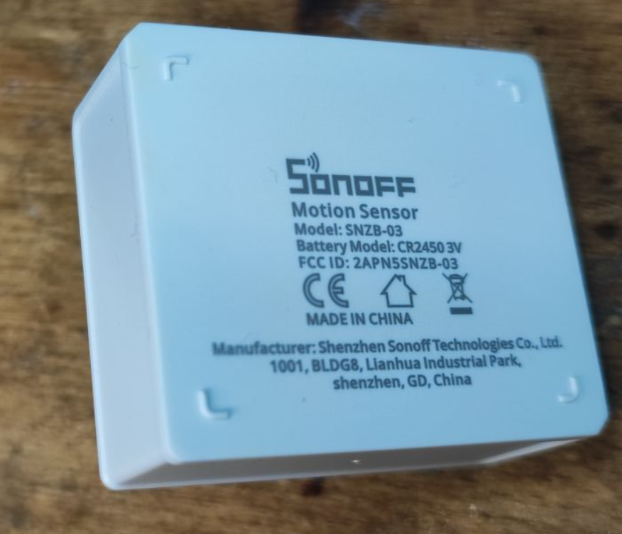

Back of Sonoff SNZB-03 motion sensor with manufacturer information. .

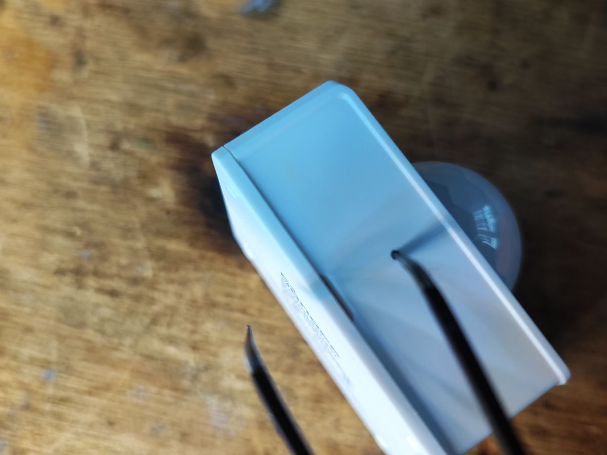

If you need to, reset the device as instructed, at HA make sure pairing is enabled.
Close-up of the Sonoff SNZB-03 sensor with a tool for opening the case. .

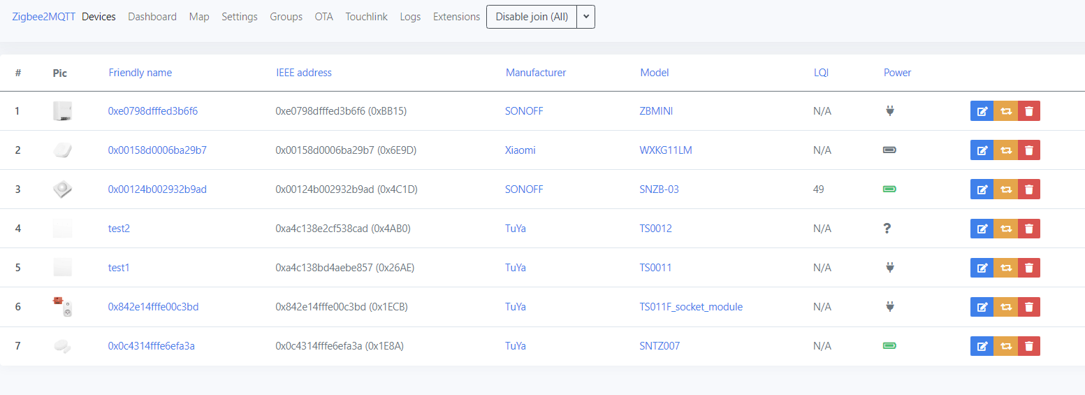

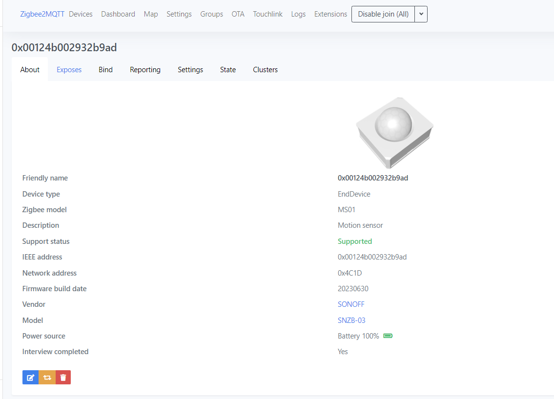

The sensor should appear in our panel:
Zigbee2MQTT user interface displaying a list of connected devices. Zigbee2MQTT interface displaying details of the Sonoff SNZB-03 motion sensor. Screenshot of Zigbee2MQTT configuration panel showing the Sonoff SNZB-03 sensor status. Screenshot of the Zigbee2MQTT panel displaying sensor states. .
The sensor provides an 'occupancy' status, i.e. detection of movement, which is cleared after 60 seconds. In addition to this, we have the battery status (by percentage, there is a separate low battery warning), tamper and connection quality. The tamper, in turn, determines whether someone has taken down the sensor and its implementation depends on the device.

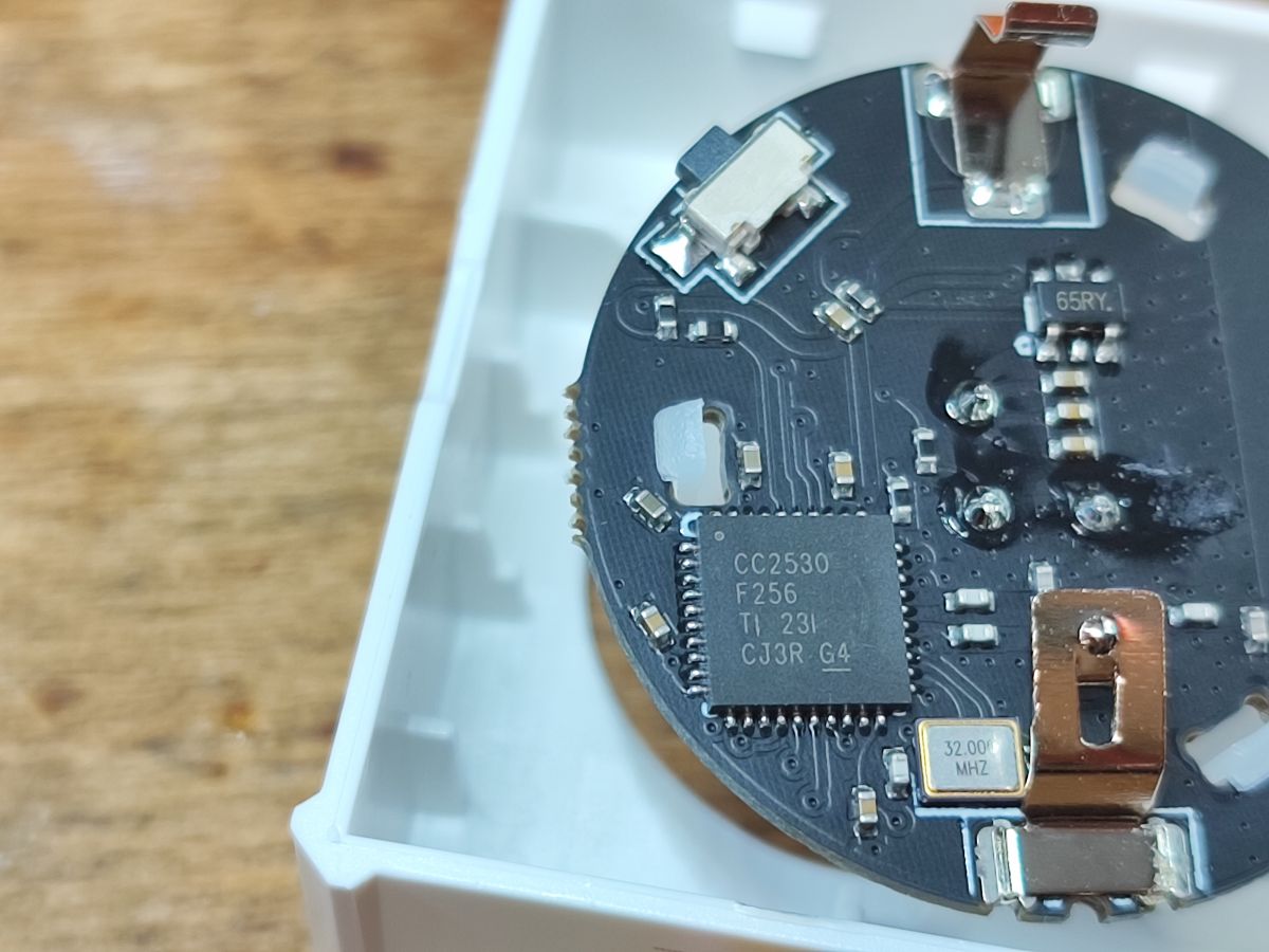

For educational purposes only. We take a look inside:
Interior of Sonoff SNZB-03 sensor with visible circuit board and CC2530 chip. Interior of the Sonoff SNZB-03 sensor showing the circuit board and electronic components. Interior of Sonoff SNZB-03 sensor showing the CC2530 chip on a circuit board. Interior of the Sonoff SNZB-03 sensor showing the CC2530 chip. Inside of the Sonoff SNZB-03 sensor showing the PCB and electronic components. .
The sensor is based on the CC2530, as are brother products including the SNZB-04 (door/window opening sensor).
Technical specification of the CC2530 chip from Texas Instruments. .
The CC2530 is a Zigbee 2.6 compliant SoC solution offering 256kB of Flash memory, 8kB of RAM and 21 GPIOs, including a 12-bit, 8-channel ADC, 2 SPI/UART and 4 timers.
