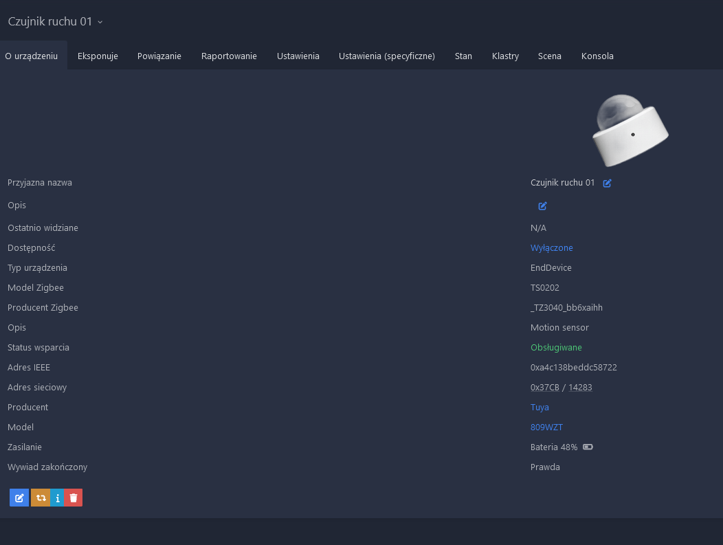

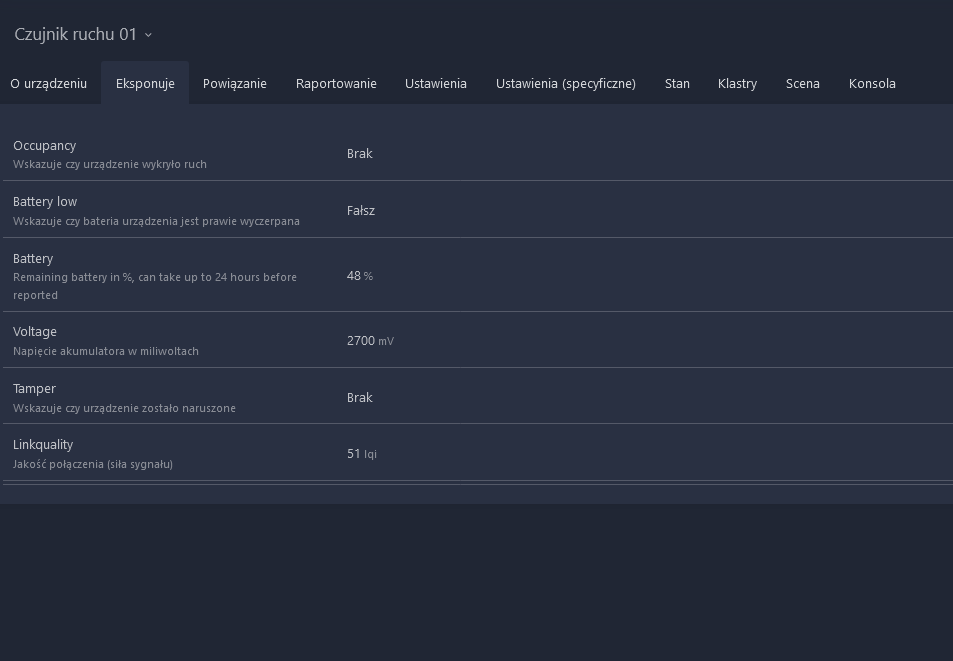

    The sensor should appear in our panel:
    Zigbee2MQTT user interface displaying a list of connected devices. Zigbee2MQTT interface displaying details of the Sonoff SNZB-03 motion sensor. Screenshot of Zigbee2MQTT configuration panel showing the Sonoff SNZB-03 sensor status. Screenshot of the Zigbee2MQTT panel displaying sensor states. .
    The sensor provides an 'occupancy' status, i.e. detection of movement, which is cleared after 60 seconds. In addition to this, we have the battery status (by percentage, there is a separate low battery warning), tamper and connection quality. The tamper, in turn, determines whether someone has taken down the sensor and its implementation depends on the device.

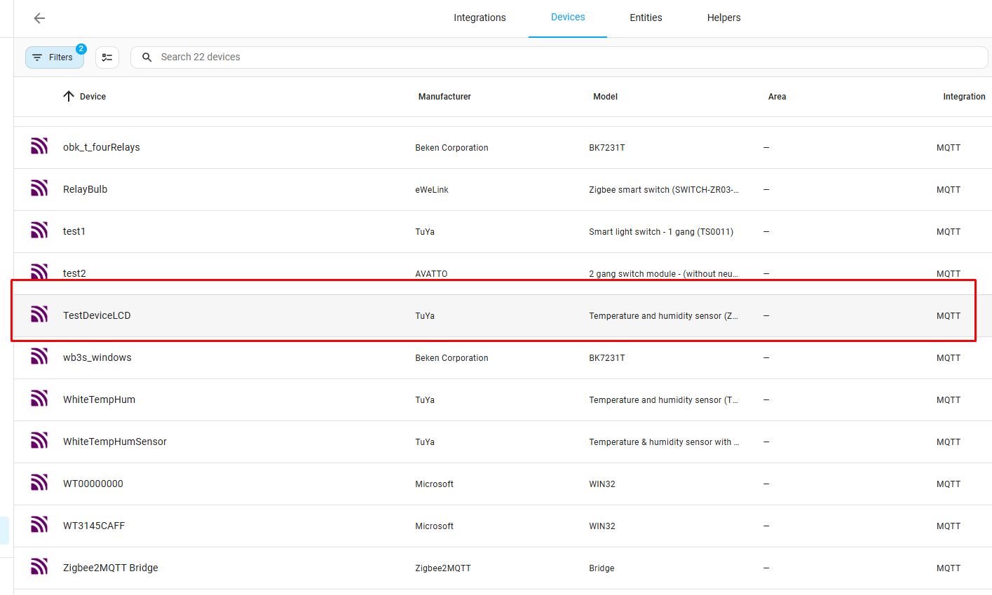

  • Fixing unfriendly MQTT device names in Z2M and HA
    #4 21406377
    krzbor
    Posts: 1783
    Help: 42
    Rate: 1072
    In the screenshot I see that the "Friendly names" are not particularly friendly. This happens when a new device is connected. If HA is running at the moment, it unfortunately takes on these bizarre meanings. To change this you need to:
    1. set the "Friendly name" correctly in Z2M
    2. in HA remove this device (it is as a device in MQTT).
    3. reboot the Z2M (the reboot option is available from the browser).
    After the restart, Z2M will register our device again with the name we set.

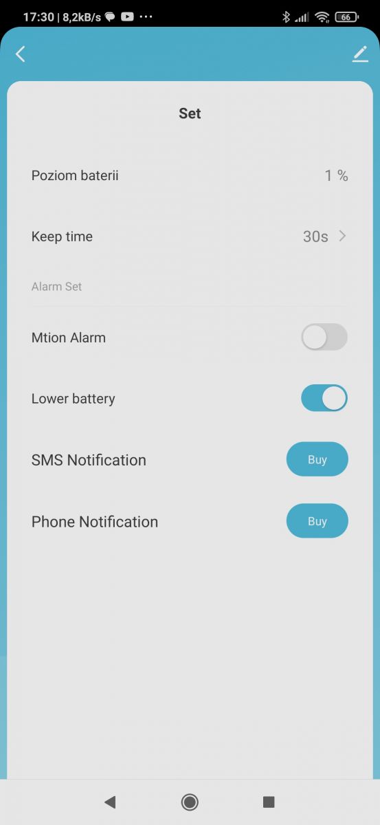

  • CR2450 PIR sensor still running since 2022
    #5 21406493
    CMS
    Posts: 8468
    Help: 258
    Rate: 2602
    Quite large and expensive. I prefer such 33x27mm https://pl.aliexpress.com/item/10050081588407..._id=202501230824352596395740709020006331535_4
    Powered by a Cr2450 battery, the Chinese one claims a life of 1.5 years with 10 triggers per day. At my place it has been working in the kitchen since November 2022. It is active from dusk to dawn, and making a dozen triggers a day. At the moment, the battery has 1%
    Screenshot of an app showing battery alarm settings. .

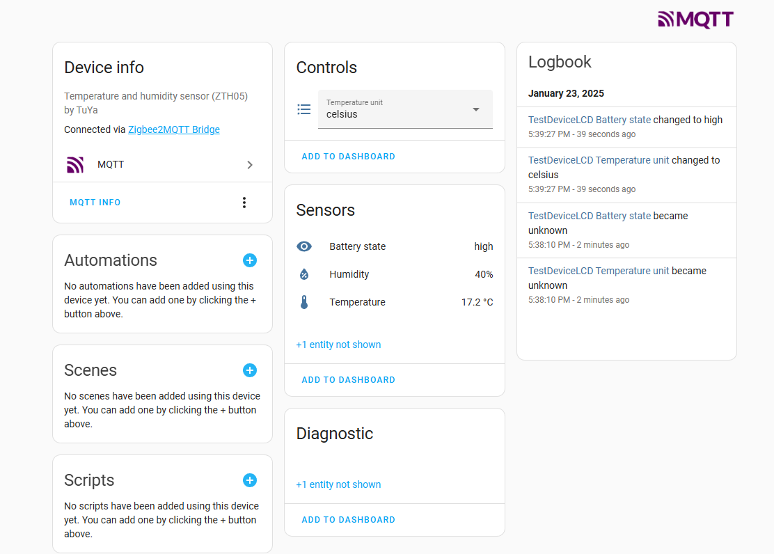

    #6 21406527
    Posts: 14781
    Rate: 12920

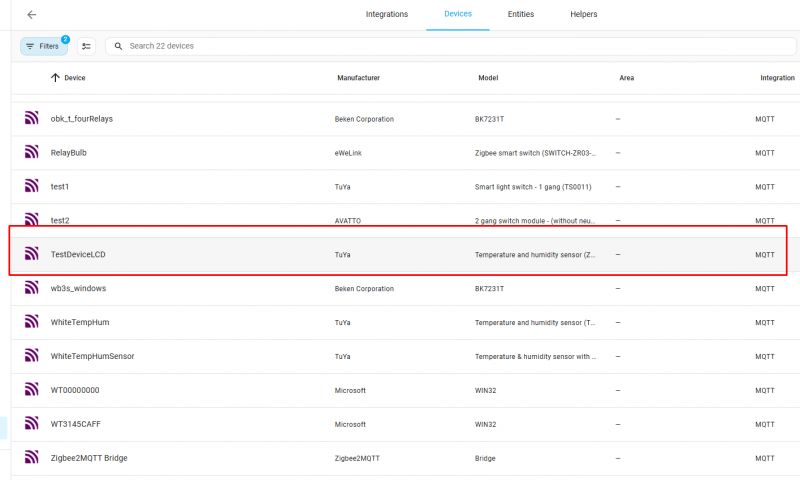

    @krzbor I don't know if we are talking about the same thing, but isn't it enough in Zigbee2MQTT in HA to click rename?
    I have had a device with an unchanged name for a few days now. I now follow these steps:
    Immediately afterwards I have:
    User interface showing a list of devices connected to the Zigbee2MQTT system. .
    Screenshot of Zigbee2MQTT interface in Home Assistant showing device information and logbook. .
    I have not rebooted anything.
  • Fixing Home Assistant entity names via Z2M re-registration
    #8 21406978
    @GUTEK@
    Posts: 1563
    Help: 163
    Rate: 399
    krzbor wrote:
    In the screenshot I can see that the "Friendly names" are not particularly friendly. This happens when connecting a new device. If HA is running at the moment, it unfortunately takes on these bizarre meanings. To change this you need to:
    After the restart, Z2M will re-register our device with the name we set.
    At the bottom you click on the icon to change the device name. In addition, you tick "Update Home Assistants entity ID" and that's it. You don't have to do anything extra, you don't have to restart anything. The name changes in both Z2M and HA.

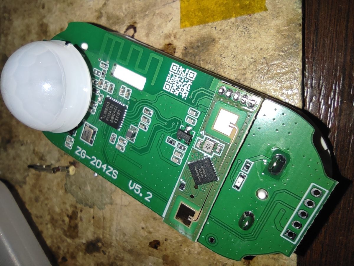

    gsm_42 wrote:
    Ikea has also recently added a PIR sensor on Zigbee. In my opinion, with 2x AAA power supply, they will definitely last longer than the Chinese Sonoff fakes.
    https://www.ikea.com/us/en/p/vallhorn-wireless-motion-sensor-smart-white-40504348/
    These sensors are plentiful. I have now bought one with a radar function out of curiosity. I will just be testing it out.
    Motion sensor ZG-2042S with radar function on green PCB. .
