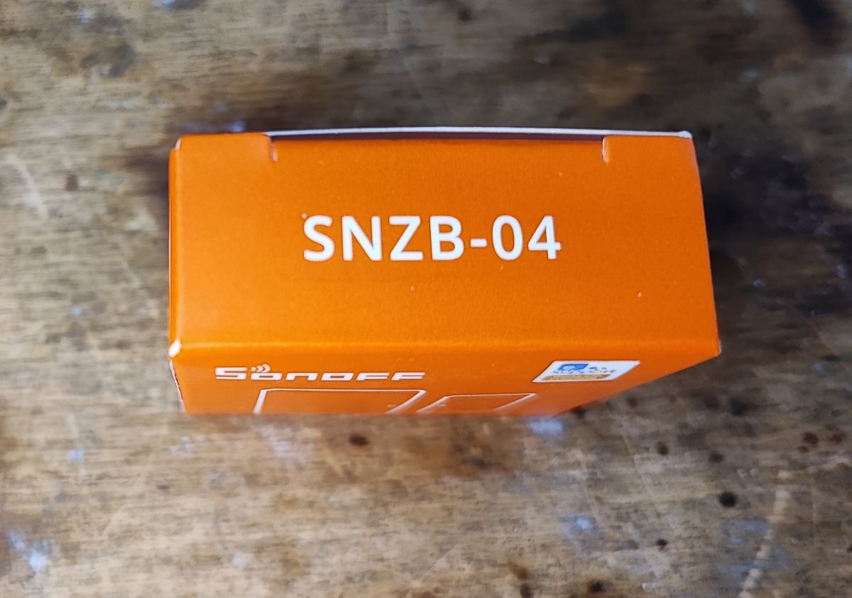

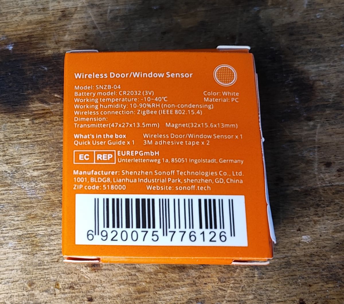

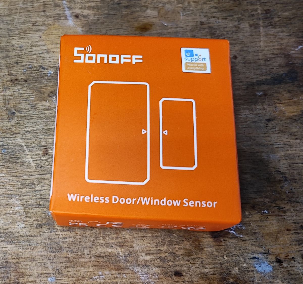

    So let's start with the purchase. It is said that products on Zigbee are a bit more expensive, but I only paid PLN35 for the Sonoff SNZB-04. Is there a catch somewhere?
    An orange box of the Sonoff SNZB-04 wireless door/window sensor rests on a wooden surface. Orange box with white SNZB-04 text on the top edge. Back of Sonoff SNZB-04 door/window sensor box with technical specifications. .

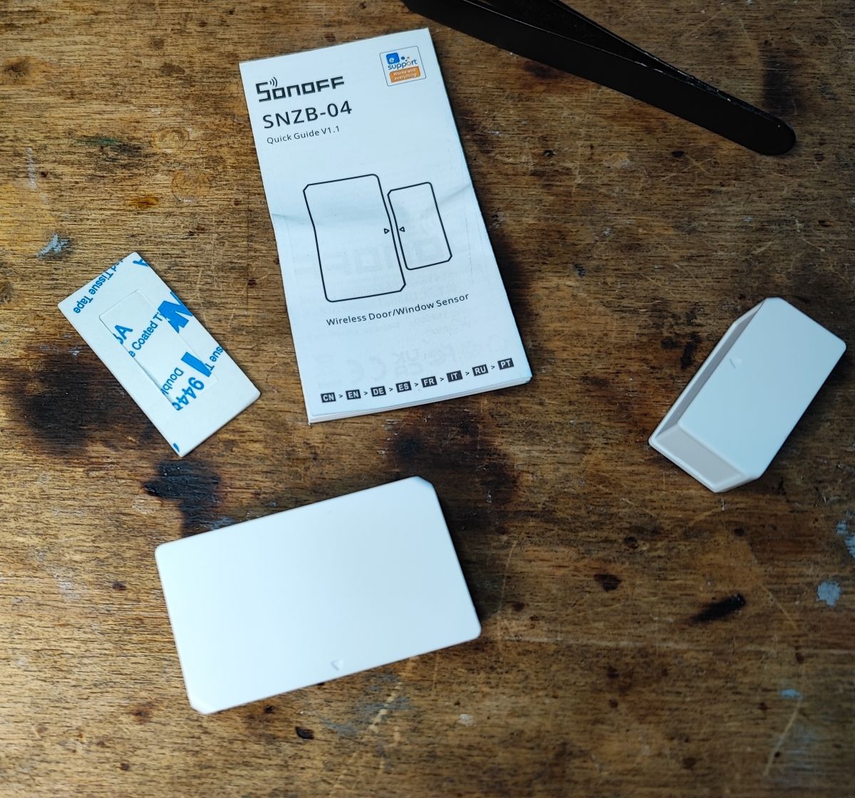

    Sonoff SNZB-04 door/window sensor kit with manual and mounting tape on a wooden surface. .
    The sensor is very small indeed. The transmitter measures 47x27x13.5mm and the magnet 32x15.6x13mm. The whole thing is powered by a CR2032 (3V) battery. Normally this sensor works with the manufacturer's gateway, so I'll post its instructions here, but I'll pair it myself with HA via Zigbee2MQTT:
    An open user manual showing steps for adding a sensor to an app and removing the battery insulation sheet. Open user manual of Sonoff SNZB-04 sensor with visible QR code and link to the product manual website. .

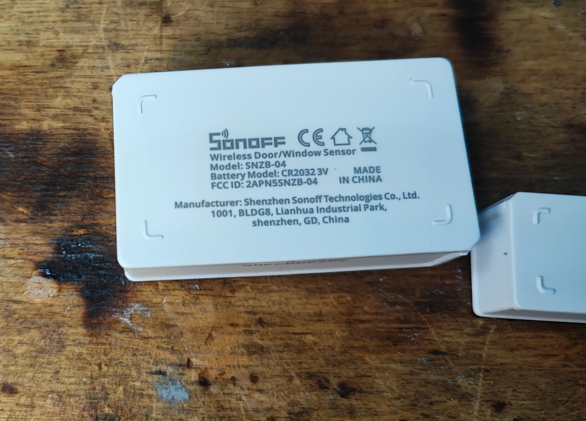

    Markings:
    White Sonoff SNZB-04 door/window sensor shown from the back with technical markings, lying on a wooden surface. .

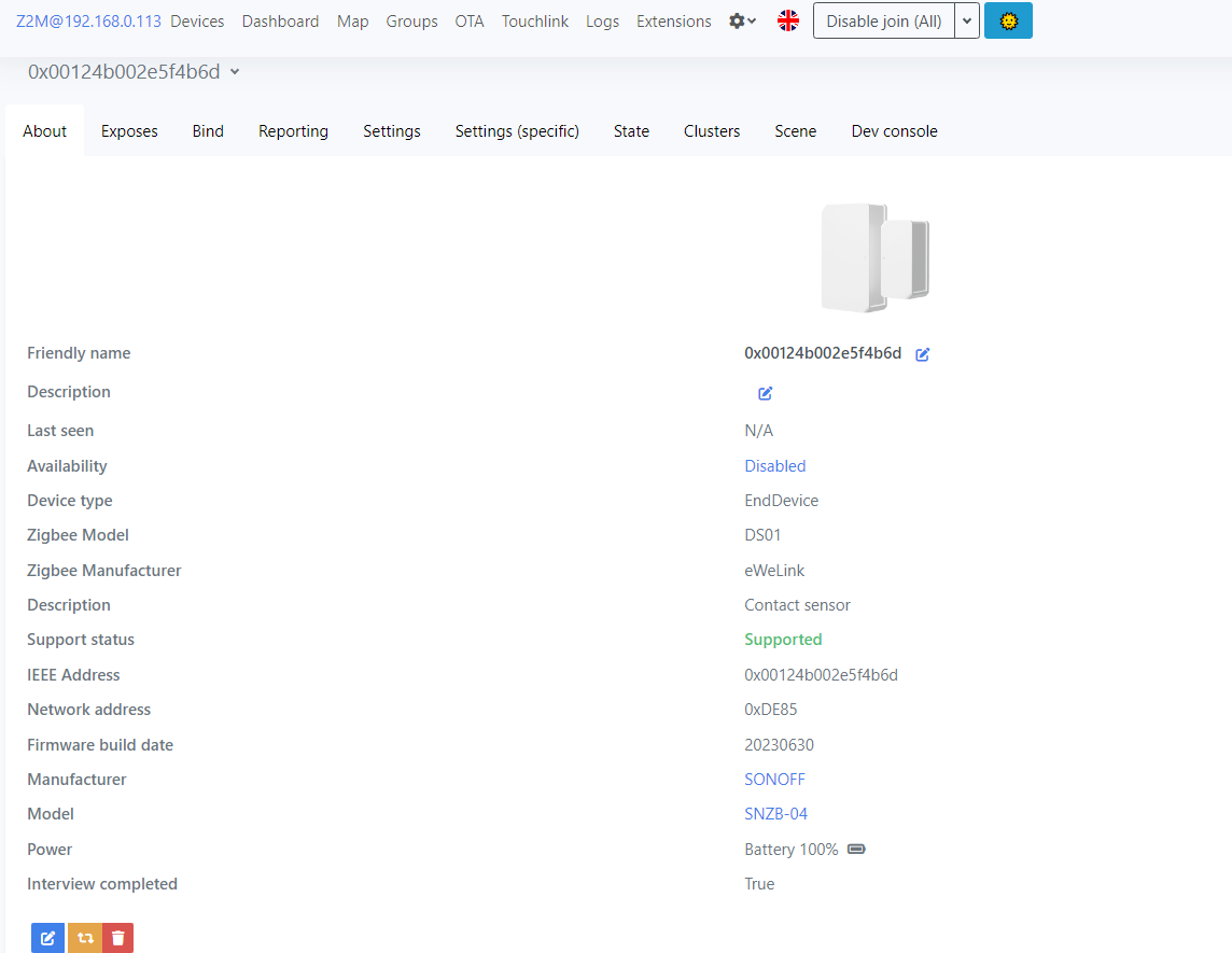

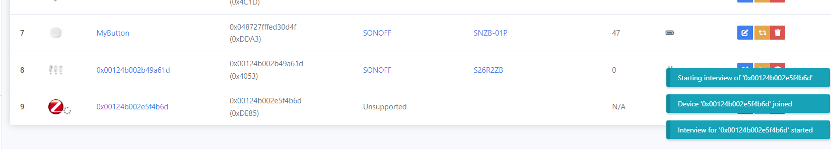

    If we need to, we reset the device according to the instructions, at HA we make sure that pairing is enabled. The sensor should appear in our panel:
    Zigbee2MQTT panel showing device list, including a newly added device labeled as “Unsupported.” .

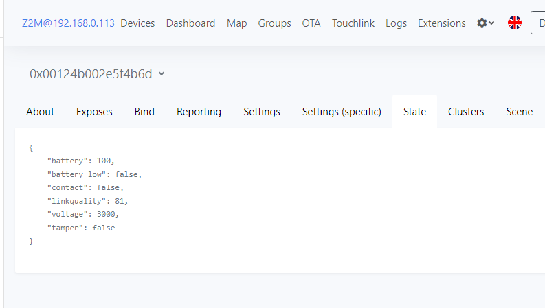

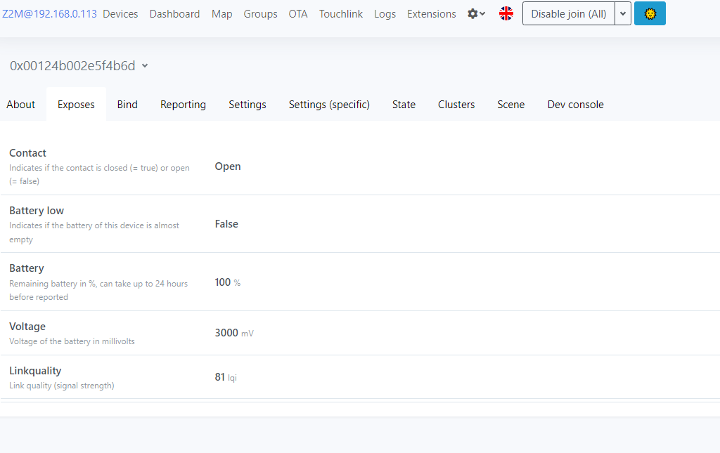

    The sensor provides its status (open or closed door), battery status (separately true/false determination if low and numerical voltage) and signal quality:
    Configuration panel for the Sonoff SNZB-04 door/window sensor in Zigbee2MQTT. Zigbee2MQTT information panel displaying Sonoff SNZB-04 door sensor status: door open, battery full, voltage 3000 mV, signal quality 81 lqi. Screenshot of the Zigbee2MQTT panel showing the state details of a Sonoff SNZB-04 door sensor, including battery, contact, and signal status. .
    And that's it, you can already do automation based on that.

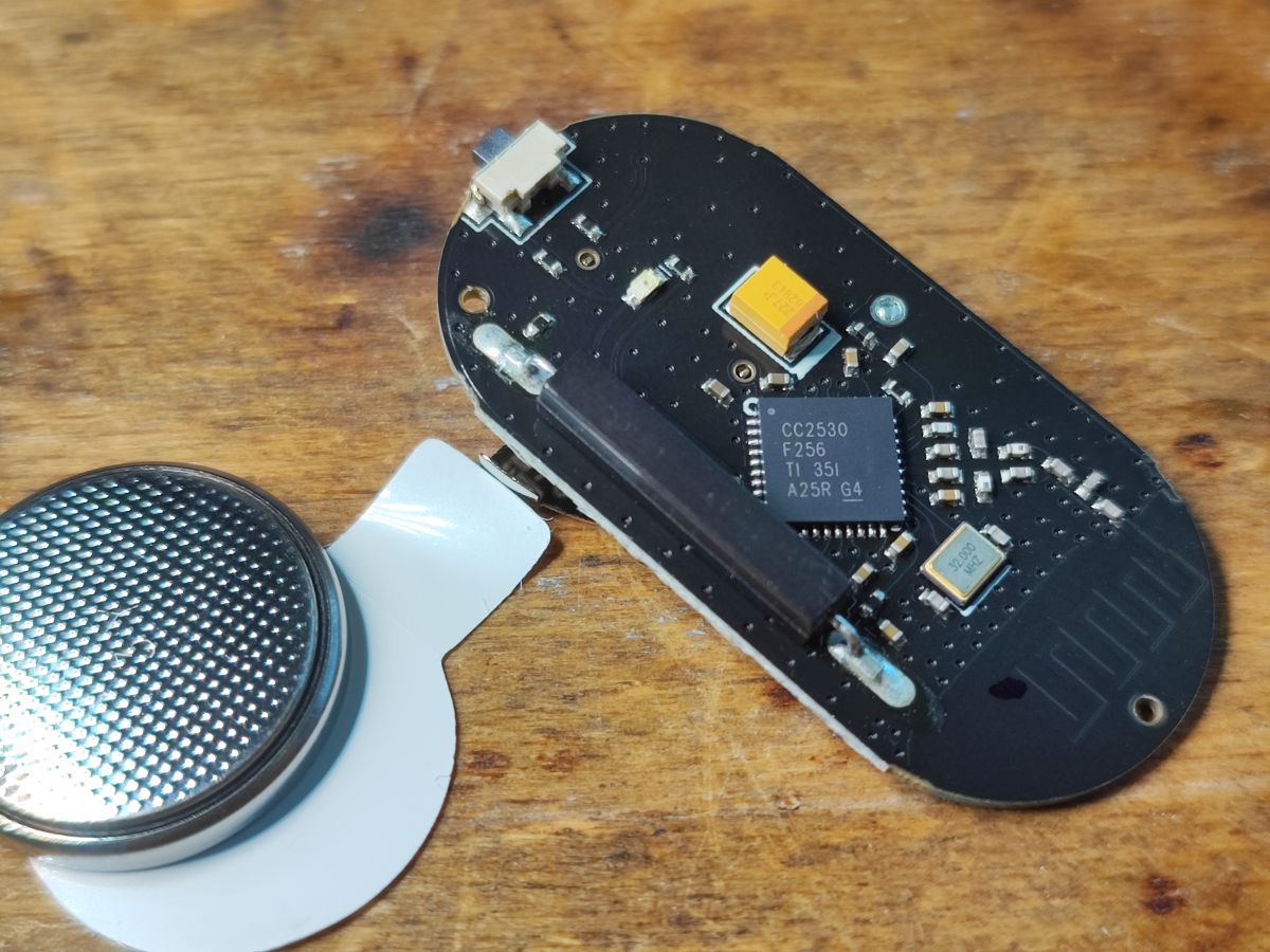

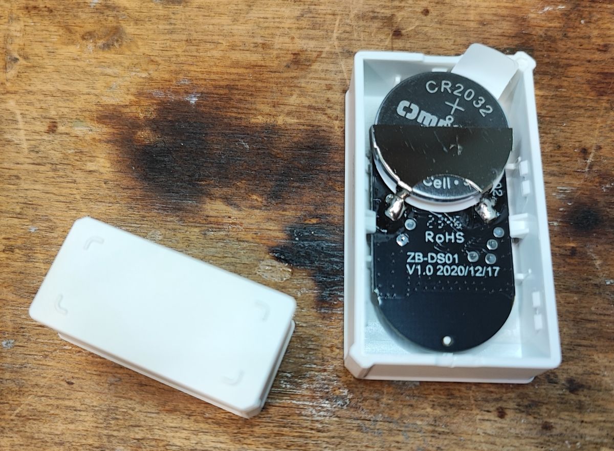

    Interior of the Sonoff SNZB-04 .
    Now we'll take a look inside, essentially just for educational purposes. We remove the lid:
    Opened Sonoff SNZB-04 door sensor with visible CR2032 battery and PCB on a wooden surface. .

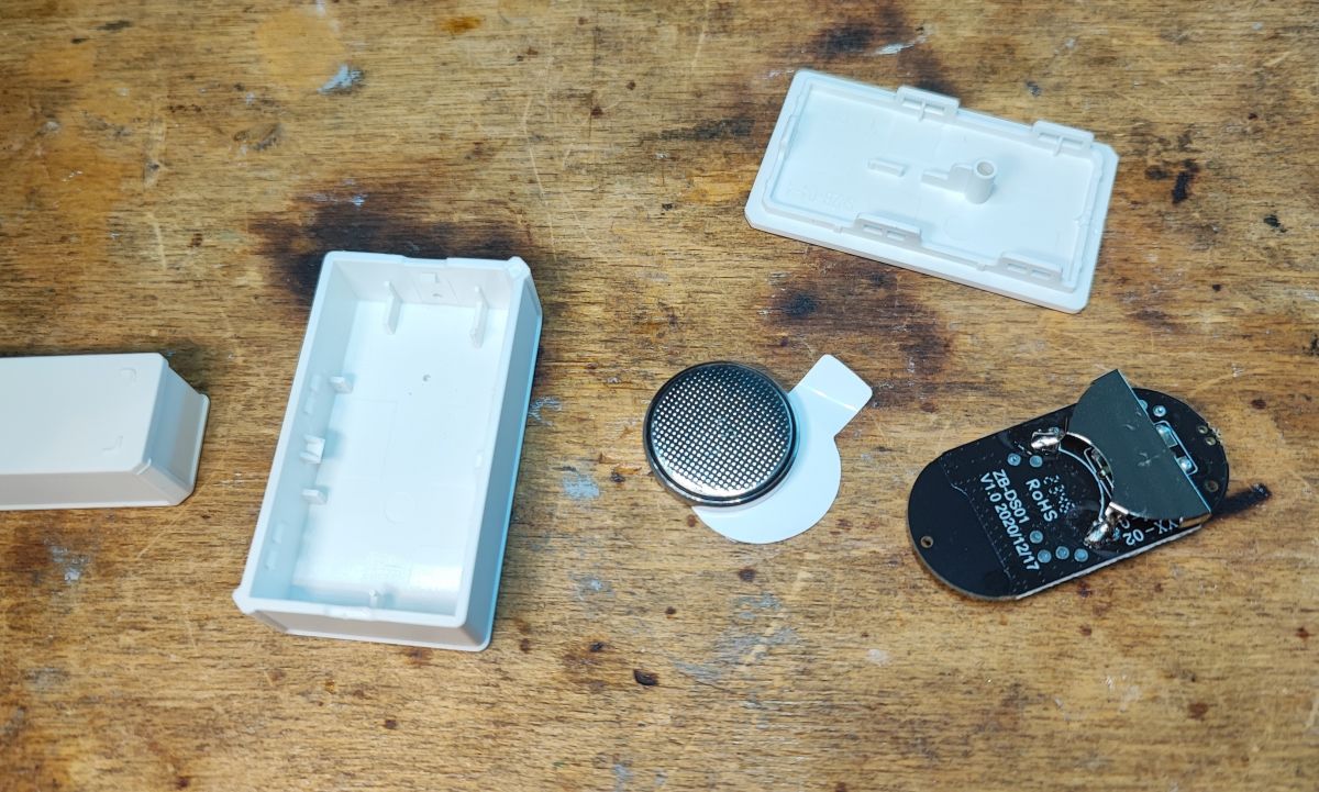

    The PCB can also be removed, it is only held on by the clips:
    Disassembled Sonoff SNZB-04 door sensor on a wooden surface: visible case parts, coin cell battery, and PCB. .

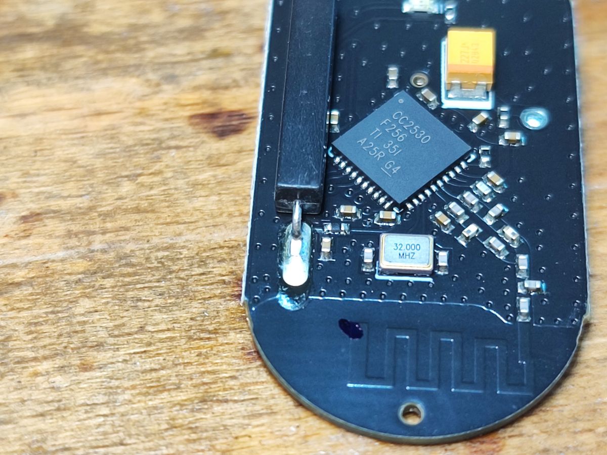

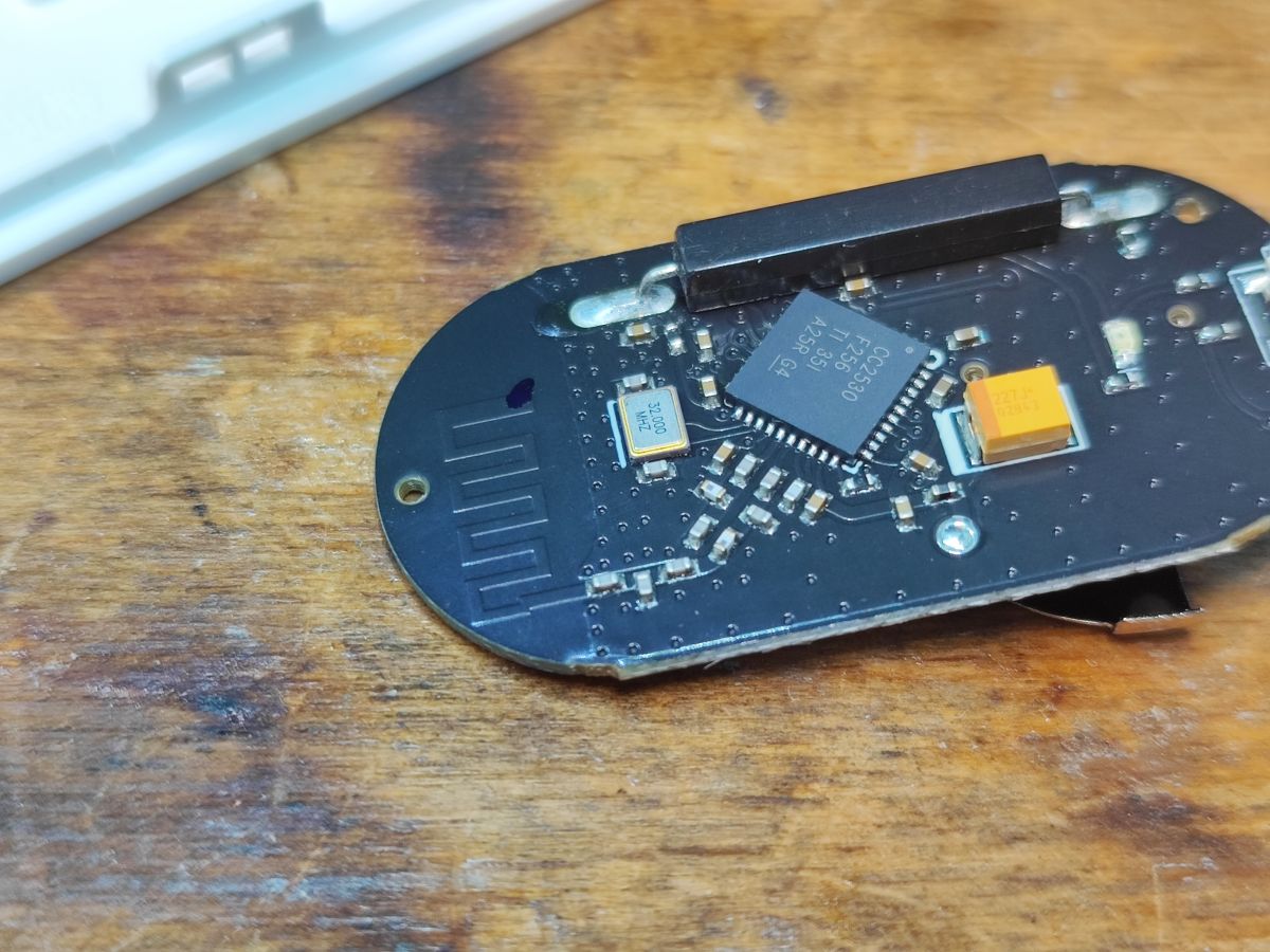

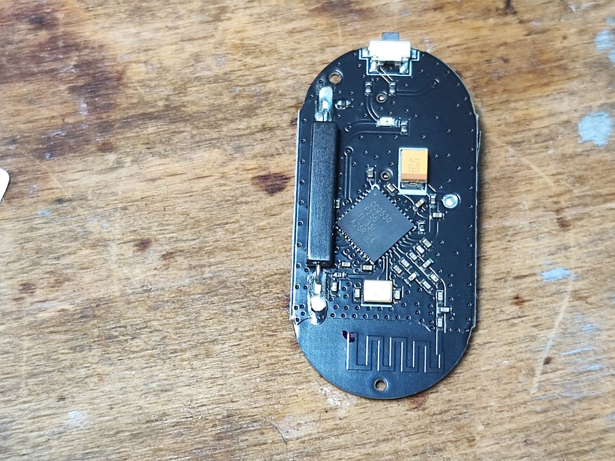

    PCB designation: RB-DS01 V1.0 2020/12/17
    Close-up of a PCB with a CC2530 chip inside a Sonoff SNZB-04 door sensor. Inside of Sonoff SNZB-04 door sensor with visible battery and PCB. Sonoff SNZB-04 sensor PCB with visible CC2530 chip on a wooden surface. Close-up of Sonoff SNZB-04 sensor PCB with prominent CC2530 chip and electronic components. .
    The whole is based on a CC2530, just like the relay shown in the past:
    Sonoff Basic ZBR3, which is the famous relay version on Zigbee. Interior, schematic .
    The whole thing runs directly from the battery, there's no inverter, so it's economical and efficient.

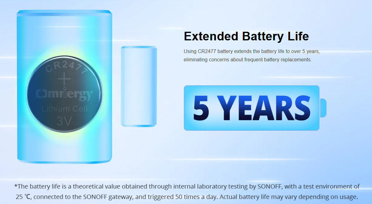

    What is the estimated battery life?
  • #3 21558503
    gulson
    System Administrator
    Posts: 29526
    Help: 150
    Rate: 6122
    PLN35 for a ZigBee sensor is really not much.
    If there is nothing wrong with the design, the battery will last for 2 years.
    I use Aqara, although the price is high.
  • #4 21558505
    Posts: 14781
    Rate: 12920
    It depends on how many times the door is opened, but more or less.
    The manufacturer's website about the SNZB-04P states that:
    The image shows a CR2477 battery and information stating it can last up to 5 years. .
    Overall, Zigbee solutions are great for battery-powered devices.

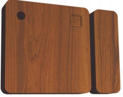

    I personally use Shelly BLU Door/Window .
    Shelly BLU Door/Window wireless sensor in wood-like finish, consisting of two rectangular components. .
    This is a bluetooth contractron connected to my HomeAssistant via an ESP32 Gateway. The manufacturer provides a battery life of up to 5 years.
    As a gateway I chose m5stack-atom-lite you can also substitute this on the most ordinary ESP32 as someone has in his resources.
    Communication: Contraktron <--- Bluetooth ---> Gateway <--- WiFi ---> HA.

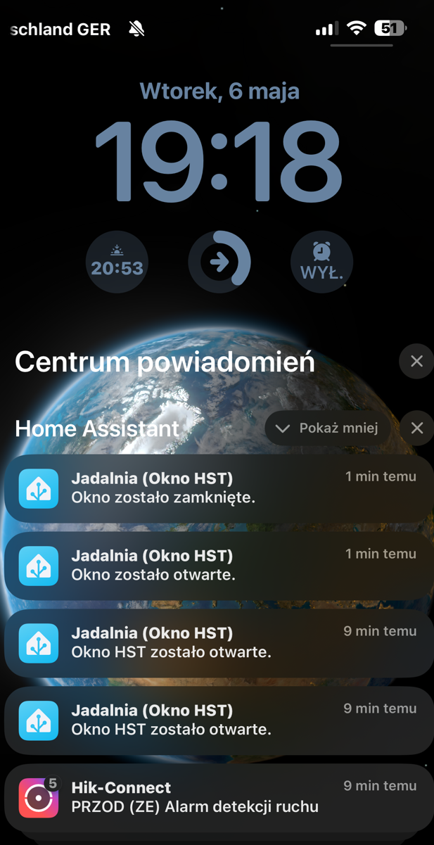

    Plus automation with notification to phone:
    Home Assistant notifications on a smartphone lock screen about opening and closing a dining room window. .

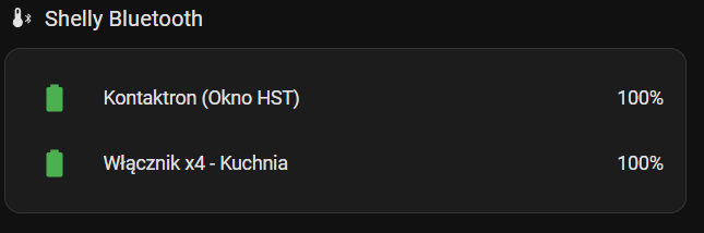

    Is there monitoring of battery status in addition to events?
  • #13 21560420
    łuki_mar44
    Posts: 372
    Rate: 215
    The reed switch has battery control as much as possible. In addition, window angle + light sensor.
    Shelly Bluetooth panel showing two devices with full battery: window sensor (HST) and kitchen switch. .
    Shelly contact sensor control panel showing battery level, window status, light intensity, and event log. .

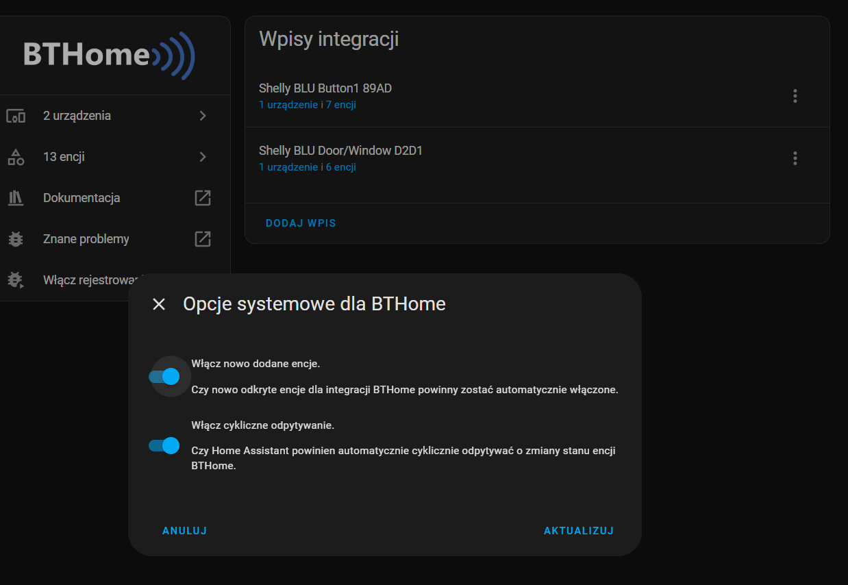

    Unfortunately, as far as I can see, this integration does not have a status entity for this device.
    There is only an option to tick regarding the cyclic querying of entities for the BTHome integration.
    Screenshot of BTHome integration settings in Home Assistant with the system options window open. .

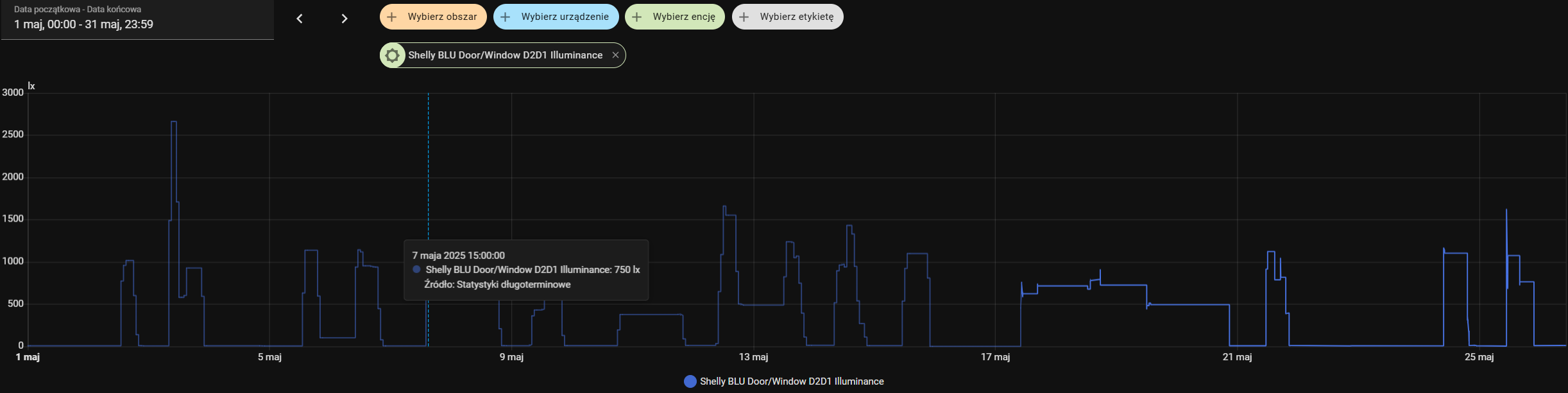

    As far as updating entities is concerned, this only happens when there is a physical change in the opening of a door
    or a change in lighting intensity.
    A graph showing light intensity (lux) readings from a Shelly BLU Door/Window D2D1 sensor for May 2025. .
