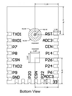

    I used this image to confirm I was reading the datasheet correctly. I know the pins are labelled but I wasn't sure if the GND label was to the bottom pin or the side.
    Diagram of module pins with labels TXD1, RXD1, P7, P8, CSN, P9, GND, RST, ADC3, CEN, P14, P26, P24, P20, P22, bottom view.

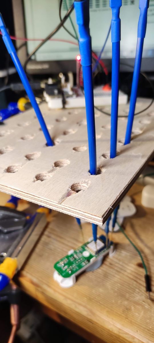

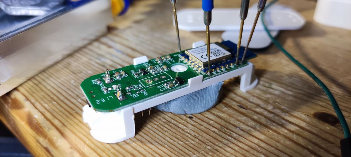

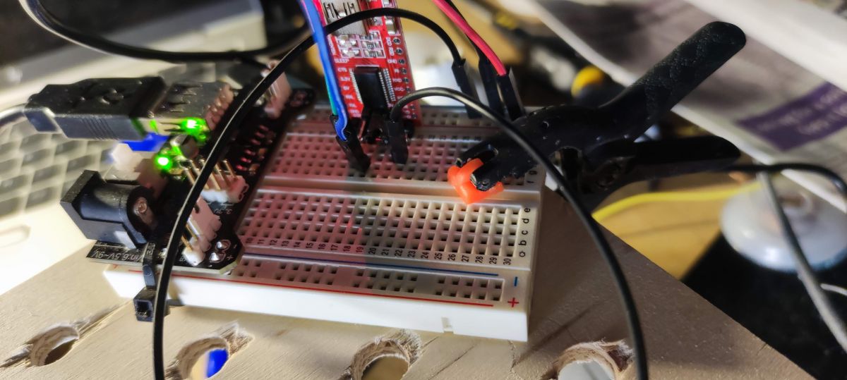

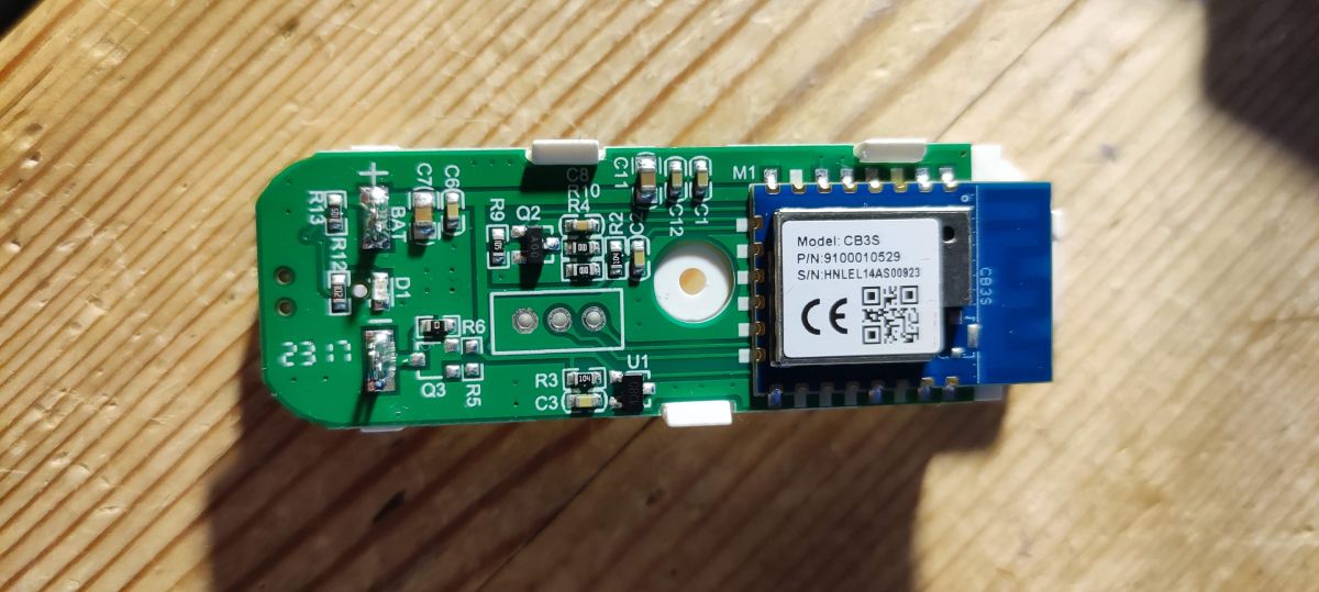

    Initially I connected only the TX2 to RX on my FTDI serial adaptor as well as GND and 3.3V to get the uart boot log, which I attach. I did not power the unit with two AAA batteries, but instead used my external 3.3v power source, which is a basic MB102 PSU board attached to a small breadboard. This came as part of a cheap Amazon kit.. Some of the resistors are also 10Kohms, so useful for some flashing scenarios.
    ELEGOO electronic kit with various components on a white background.
    My USB-serial adaptor/pogo probe pins/jumper wires, helping hands, are all cheapies from AliExpress. The plywood BDM platform with the holes is homemade.
    Prototype board with CB3S module on a wooden table Breadboard with electronic components and wires. DIY test platform with a PCB and probes.

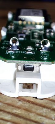

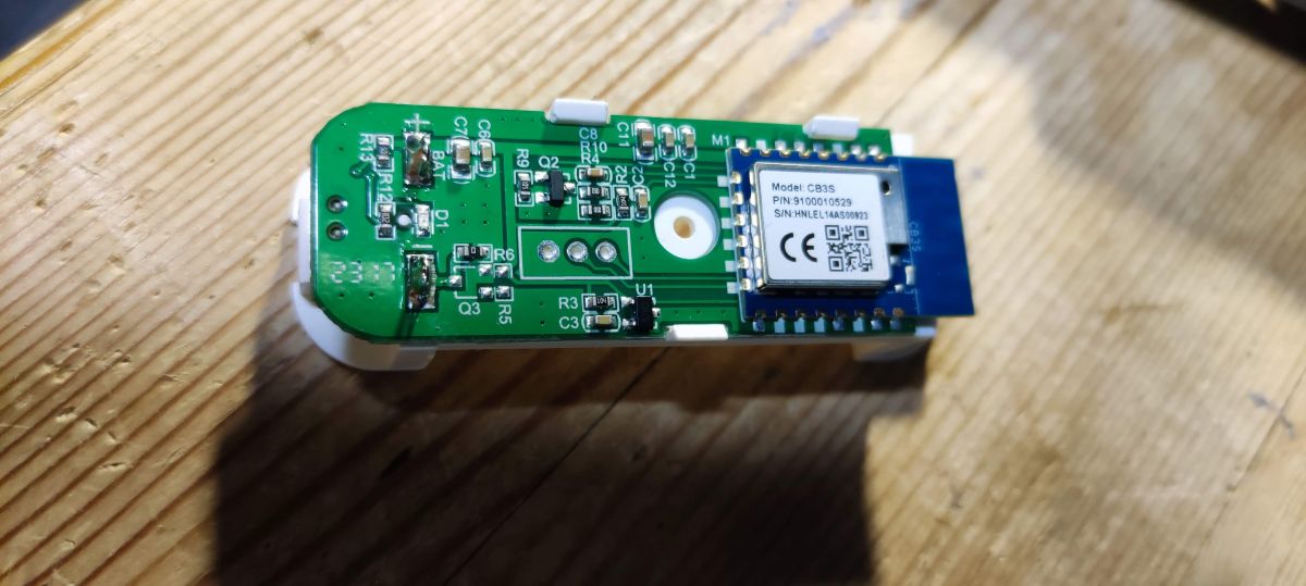

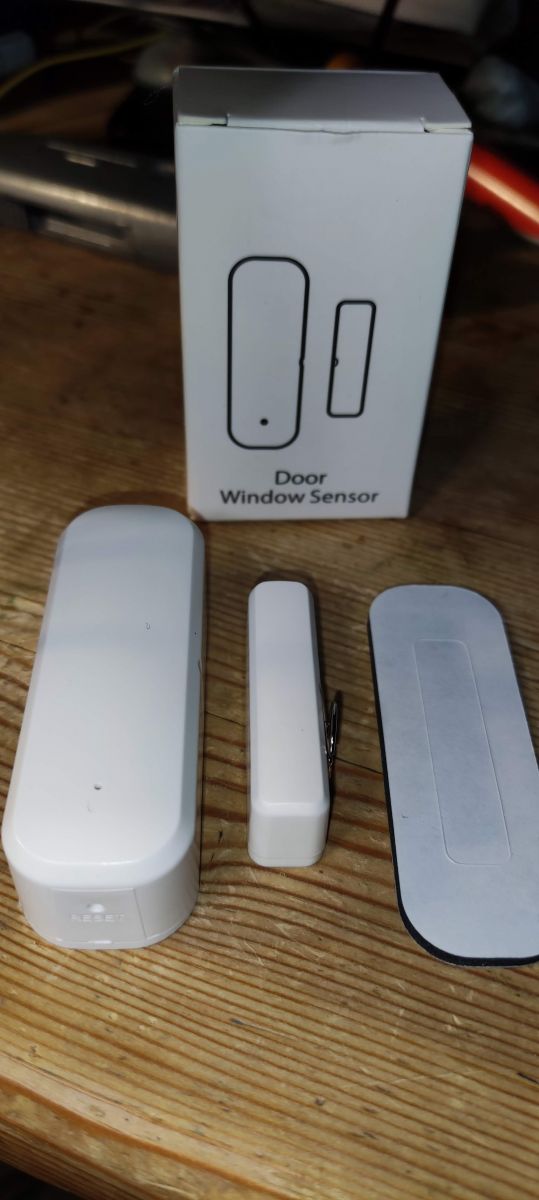

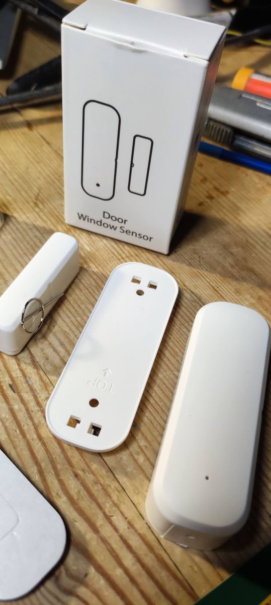

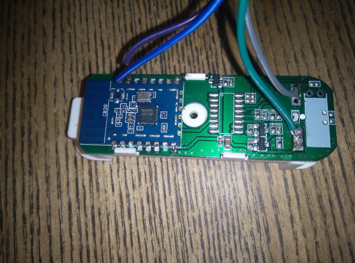

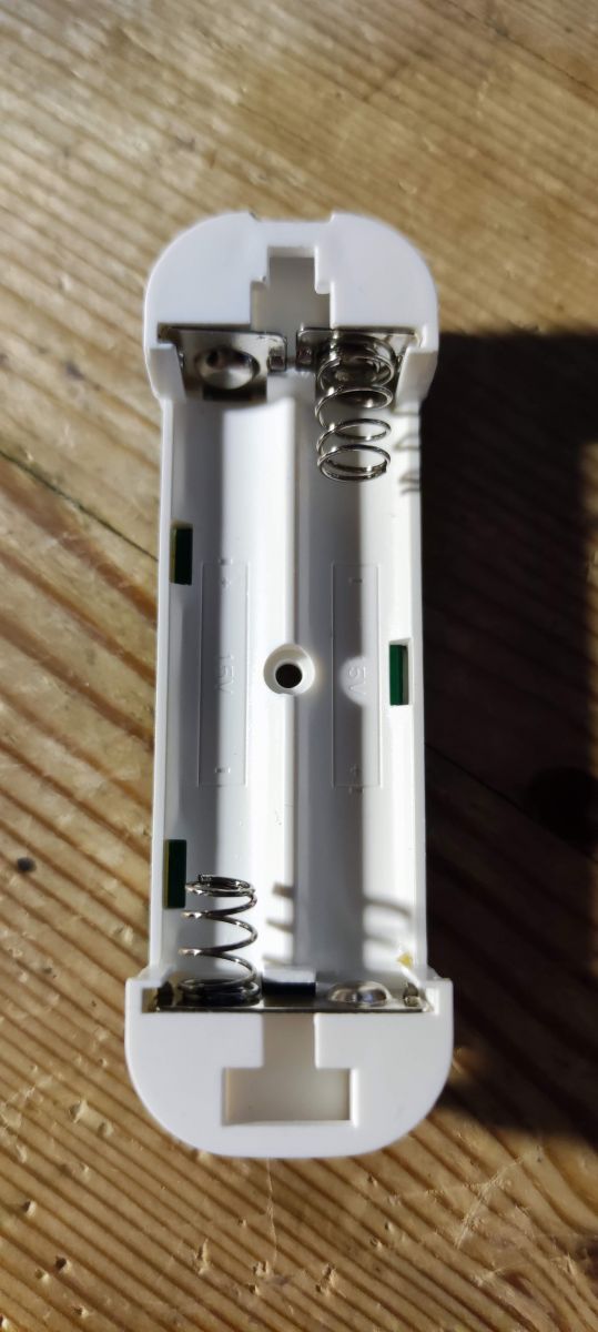

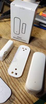

    Onto the product pictures:
    CB3S module on a green PCB with electronic components Electronic board with a CB3S module mounted on a wooden table. Battery compartment of an electronic device with visible spring contacts. Door/window sensor with packaging and casing on a wooden surface Door/window sensor packaging with informational sticker Close-up of a PCB with attached electronic components. CB3S module on a circuit board with connected test wires. View of the inside of a plastic casing with slots for AAA batteries. SZKOSTON door/window sensor set next to packaging.

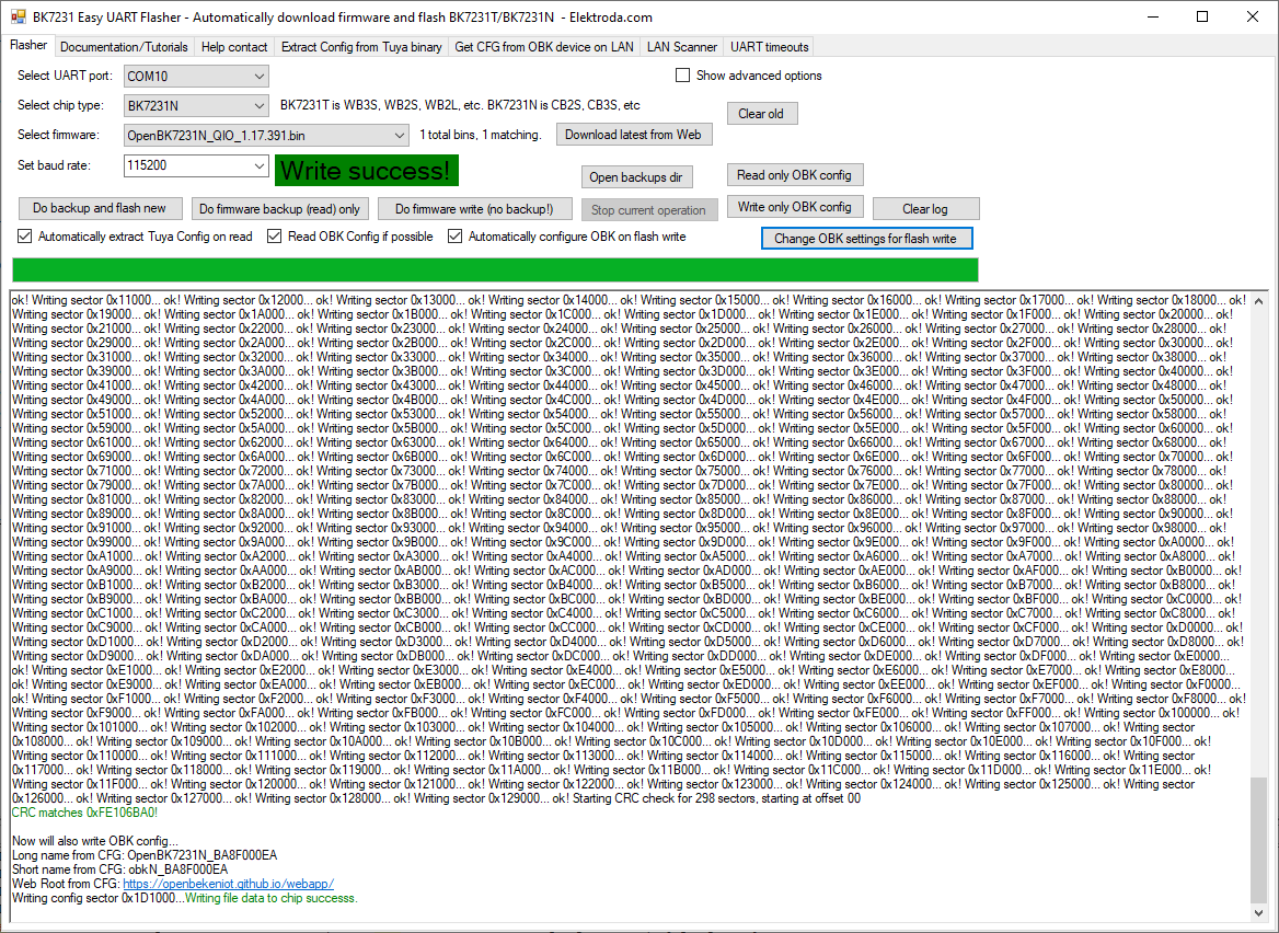

    As always I flashed with the BK7231 Easy UART Flasher, connecting RX1, TX1, GND to my breadboard/USB-serial adaptor. 3.3v provided by the MB102, not the USB-serial adaptor.
    Screenshot of BK7231 Easy UART Flasher software with a successful write message.
    I took a backup before, attached, and had the flasher write the config it found, which was
    - Button (channel 0) on P24
    - Status LED on P26
    - PIR sensor on P8
    - Battery Relay on P14
    - Battery Max Voltage: 3000
    - Battery Min Voltage: 2200
    - Battery ADC on P23
    Device seems to use Battery Driver. See more details here: https://www.elektroda.com/rtvforum/topic3959103.html
    Device seems to be using CB3S module, which is using BK7231N.

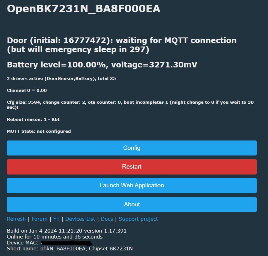

    I notice it detected P8 as a PIR sensor, so set "dInput" instead of "DoorSnsrWSleep", which is what I gather should be set for this type of device. I have use for this device yet, and don't even have a working MQTT/Home Assistant setup, so do not yet understand how the presence of the magnet (when door closed) translates into the value in the web gui or what means for HA.
    Device configuration panel with BK7231N module
    OBK Template
    Questions:
    Why is dInput/PIR detected? (what is "basic_pin_pin"? is it an undetectable generic input?)
    Why does the sleep timer count down from 300s but quickly reset itself back to 300s on battery and external 3.3v?
    Should there be another deep sleep setting I should enable?
    Many thanks

    I think that basic_pin_pin was found first in PIR sensor and we were not aware that the same syntax is used also in door sensors, that's why template extractor detects it as PIR.
    Regarding 300 seconds countdown - well, the driver is created with assumption that it's supposed to work with MQTT. I don't think this sensor can be much useful without that. I think you'd need to setup MQTT first for it to work correctly. Still, if you want to try using it without MQTT (I don't know, maybe script device to send HTTP GET on trigger), I can also try to figure out something for you. It's just it's not the expected use case.
    Keep in mind that you can as well ignore the door sensor driver and write your own custom behaviour in the script.
    Using this device without any server like Home Assistant is especially tricky because it is in deep sleep most of the time so you can't just query it to see if the doors are open. The WiFi module does not run when in deep sleep, so it will appear offline for you. This is why we usually use such devices along with Home Assistant.

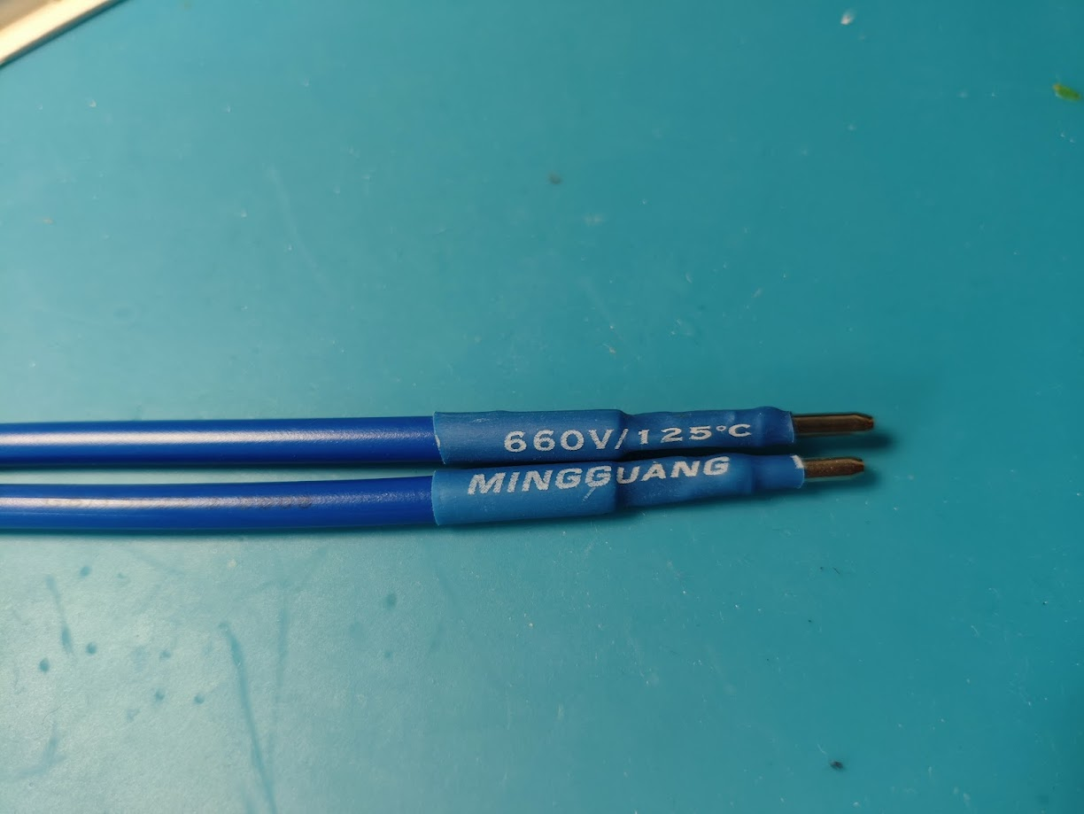

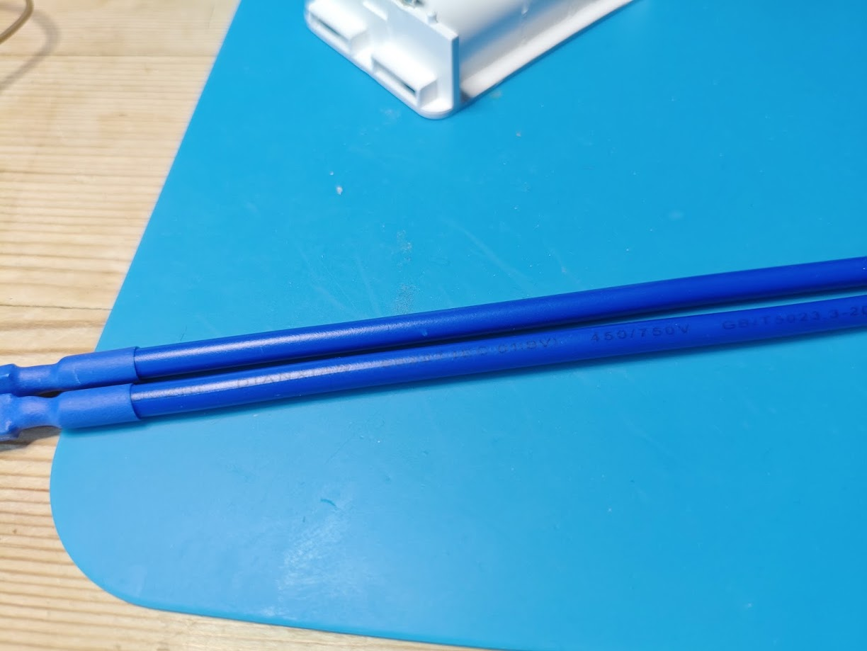

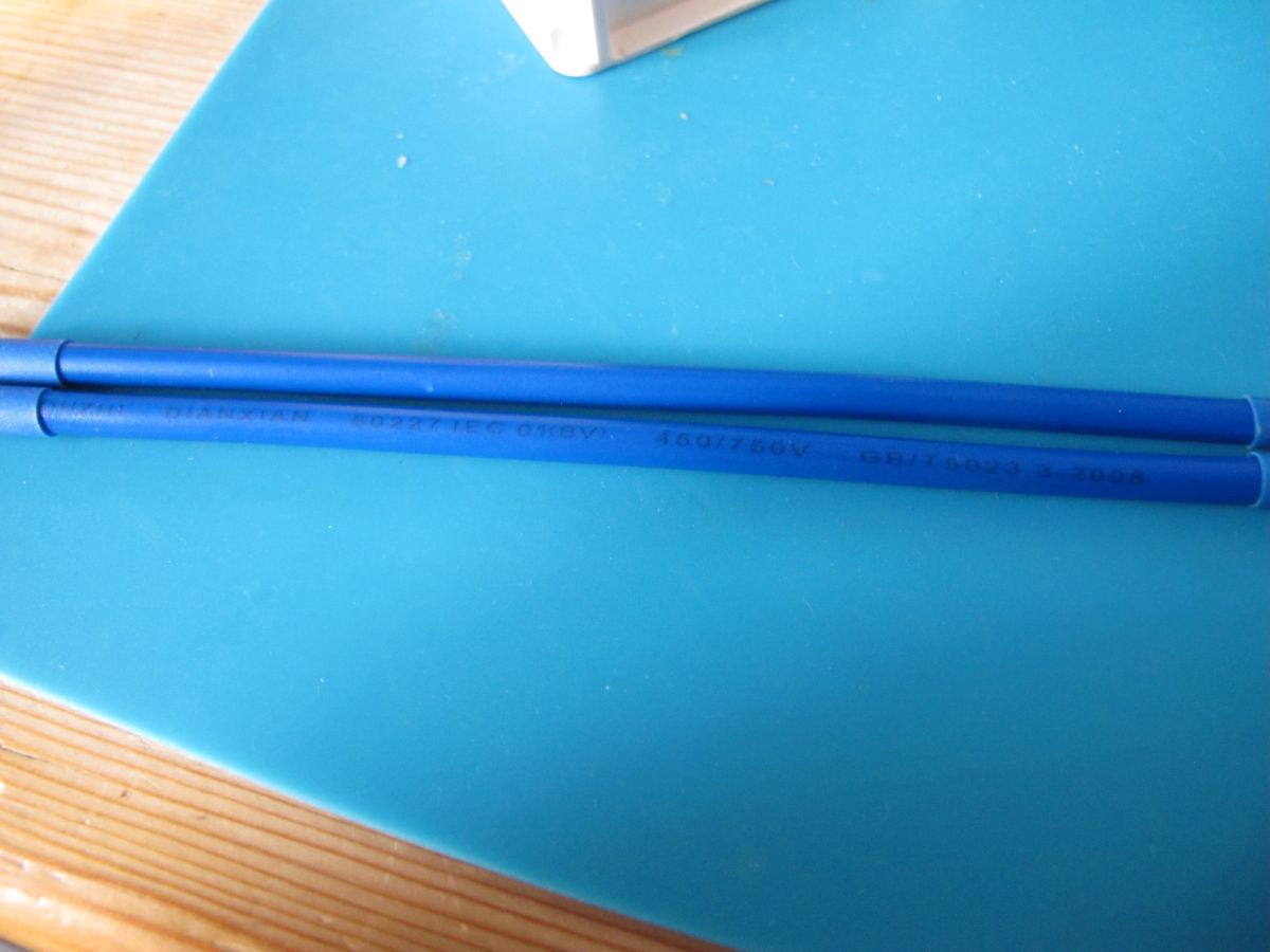

    what long blue sample pin holders are these?
    Blue pin holders attached to a wooden board with holes.
  • #8 21122867
    Posts: 5206
    Help: 446
    Rate: 914
    looks pretty much the same. the ones Ali sent didn't have black ends though.
    Two blue wires on a blue surface, marked as 450/750V.
    Close-up of blue electrical wires on a light blue surface. Two blue electrical wires with black ends and markings 660V/125°C MINGGUANG.
    I must admit I use them less and less now in favour of soldering
  • #9 21122989

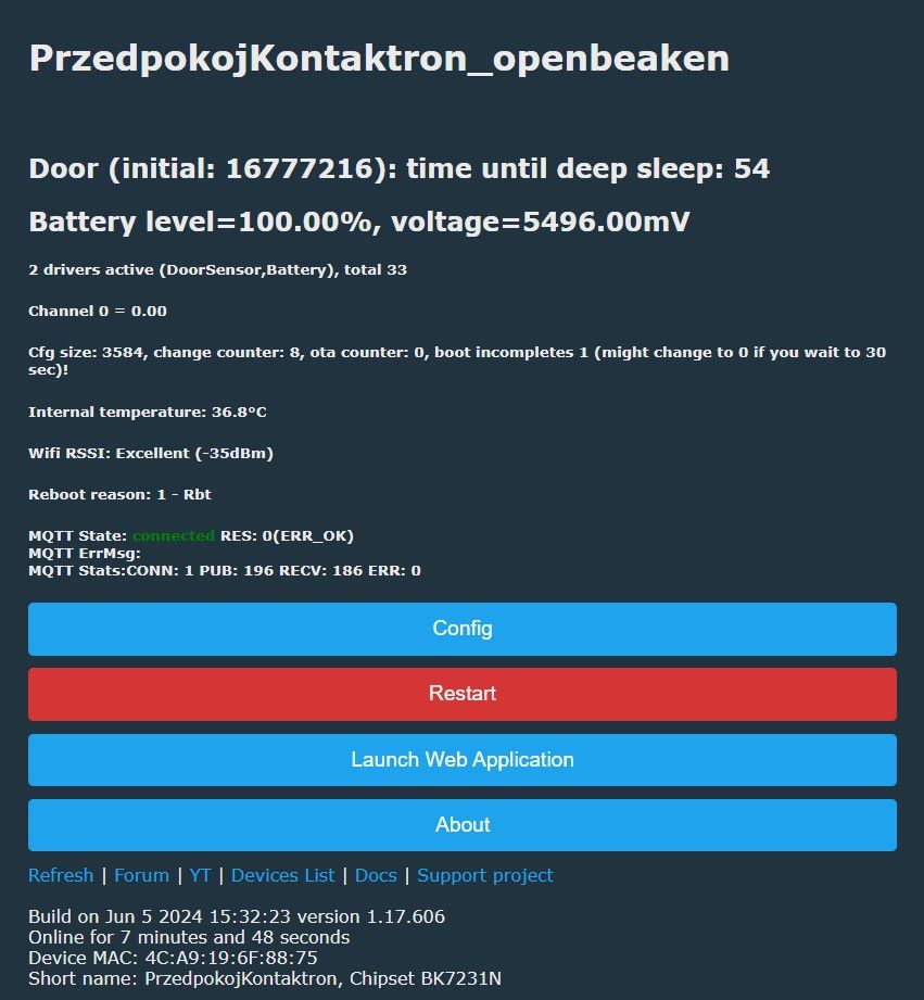

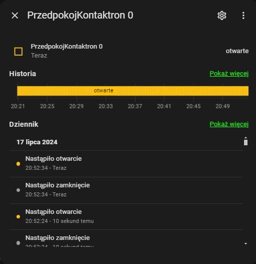

    He digs it out. I bought this module and managed to upload OBK to it. I have configured WiFi and MQTT. My home page looks like this:
    Screenshot of a Tuya device interface displaying battery level, temperature, and WiFi status data.
    The batteries are new, so the indication is probably correct. Unfortunately, I have a problem with the opening sensor. In home assistant I see it like this:
    User interface of door contact monitoring system.
    Even though the magnetic probe is touched to its side, the sensor still informs about its opening.
    What is also strange for me is the fact that every time the module communicates with my mqtt server, a shutdown is also sent.
    Please help me find the problem.

  • #12 21158501
    Posts: 14754
    Rate: 12875
    On Elektroda.com, we speak English. elektroda.pl is for polish posts.
    I see you've set DoorSnsrWSleep IO role. Have you tried to use DoorSnsrWSleep_nPup or DoorSnsrWSleep_pullDown, whatever it was called? There are at least 3 similiar roles to choose from.

    So, did you try the other roles? Find the one that can read both states (closed and open) correctly.
  • #15 21158623
    Jacekmiel1
    Posts: 14
    >>21158520 I tried options: DoorSnsWSleep_nPup, DoorSnsWSleep_pd and classic DoorSnsWSleep work the same. I am receiving short open/close message

The discussion centers on the SZKOSTON Door/Window Sensor featuring the BK7231N chip and CB3S module, powered by AAA batteries without TuyaMCU. The original poster verified pinouts using the CB3S datasheet and images, powering the device via an external 3.3V supply and interfacing through UART with an FTDI serial adapter. Challenges include interpreting the sensor's sleep timer behavior, MQTT integration necessity, and configuring correct IO roles (e.g., DoorSnsrWSleep variants) for accurate door state detection in Home Assistant. Users highlight the difficulty of using the sensor without MQTT due to deep sleep mode disabling WiFi, causing offline status. Wiring details emphasize direct connections to module pads with pogo pins, noting variability in factory soldering quality, especially for the GND pin, which can affect flashing and communication. Suggestions include separating channels for door sensor and battery relay to avoid signal conflicts. Additional hardware accessories like pogo pins from AliExpress and Amazon are discussed, with reliability concerns favoring soldering over probe contacts. Network configuration issues arise when setting dual SSIDs, with the device failing to connect to the secondary SSID if the primary is unavailable. Overall, the thread provides practical insights into hardware interfacing, firmware flashing, MQTT setup, and troubleshooting for this specific door/window sensor module.
TL;DR: This FAQ helps OpenBeken users flash and configure the SZKOSTON CB3S door sensor. It uses 2×AAA power, and one expert note says "template extractor detects it as PIR" because Tuya reuses the same config field across sensor types. It also explains the 300-second sleep countdown reset, BAT_Relay behavior, reed-switch roles, and safe Tuya-firmware restore steps. [#20911982]
Why it matters: Battery BK7231N door sensors can look misconfigured even when the hardware is fine, so correct pin roles, channel separation, and backup handling matter more than raw flashing success.
Option Best use Known result in thread
DoorSnsrWSleep Basic reed-switch setup Worked, but some users saw wrong open state or brief toggles
DoorSnsrWSleep_nPup / pull-down variant Inverted or biased reed wiring Suggested when the door always reads open
Pogo pins Fast temporary contact Worked, but contact was described as less reliable than soldering
Soldered wires Repeated flashing or unstable pads Reported as more reliable for CB3S work
Key insight: The biggest practical fix is to treat this as a sleeping MQTT sensor, not a constantly queryable Wi-Fi contact sensor. Separate the door, button, and battery functions onto different channels, or battery sampling can disturb the reported door state.
  • The extracted Tuya config mapped P8 to the basic sensor input, P14 to battery relay control, P23 to battery ADC, P24 to the button, and P26 to the status LED on a CB3S / BK7231N board. [#20904497]
  • The battery settings found in flash were 3000 mV max and 2200 mV min, and the device was powered either from 2×AAA cells or an external 3.3 V supply during testing. [#20904497]
  • The OpenBeken sleep timer behavior discussed here starts at 300 s and can jump back to 300 s when battery-handling logic is not configured as expected. [#20961348]
  • A later restore note says a Tuya backup should be cut to 1224 KB so the original MAC, calibration data, and Tuya keys remain intact. [#21596683]
