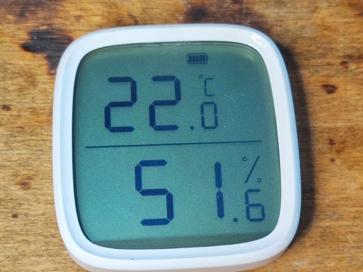

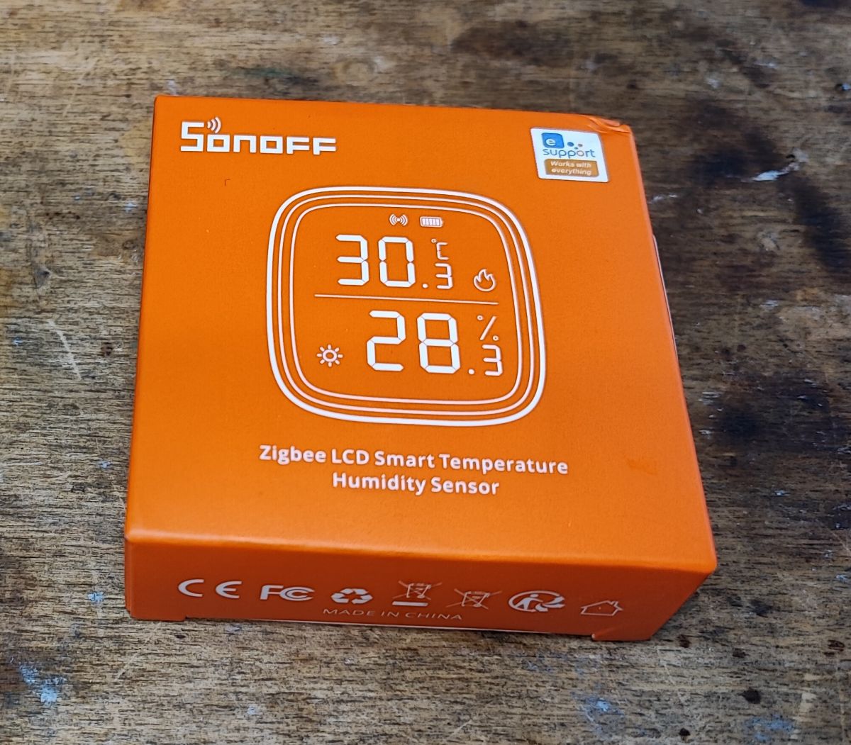

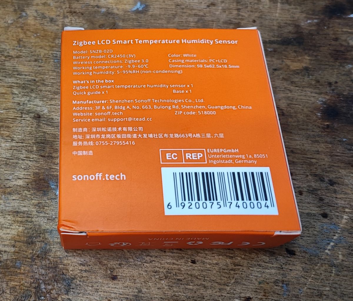

    Today I am going to present a useful gadget for every desk - the Sonoff SNZB-02D, which is a tiny temperature and humidity meter with a 2.5" display. Dimensions: 62.5x59.5mm. All battery-powered (CR2450 3V) and additionally connectable to Home Assistant via Zigbee2MQTT. In our country, it can be purchased for around PLN60, from abroad it can be imported for almost half as much.
    Sonoff SNZB-02D packaging on a wooden surface. Packaging of Sonoff SNZB-02D temperature and humidity sensor on a desk. .

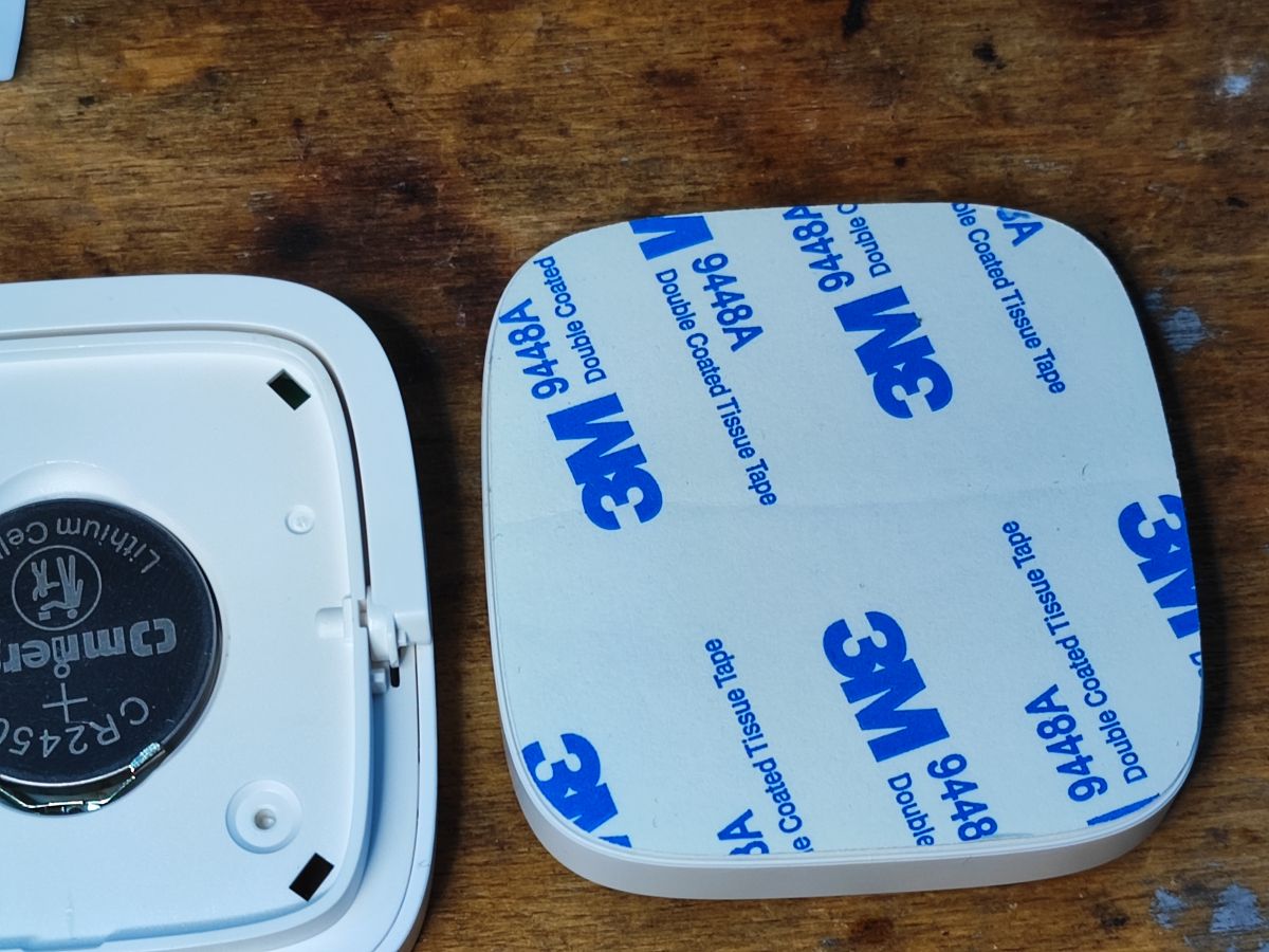

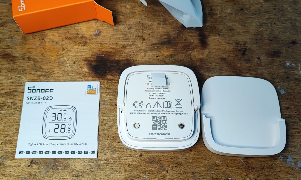

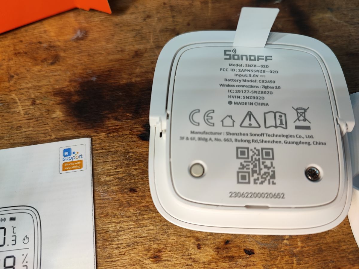

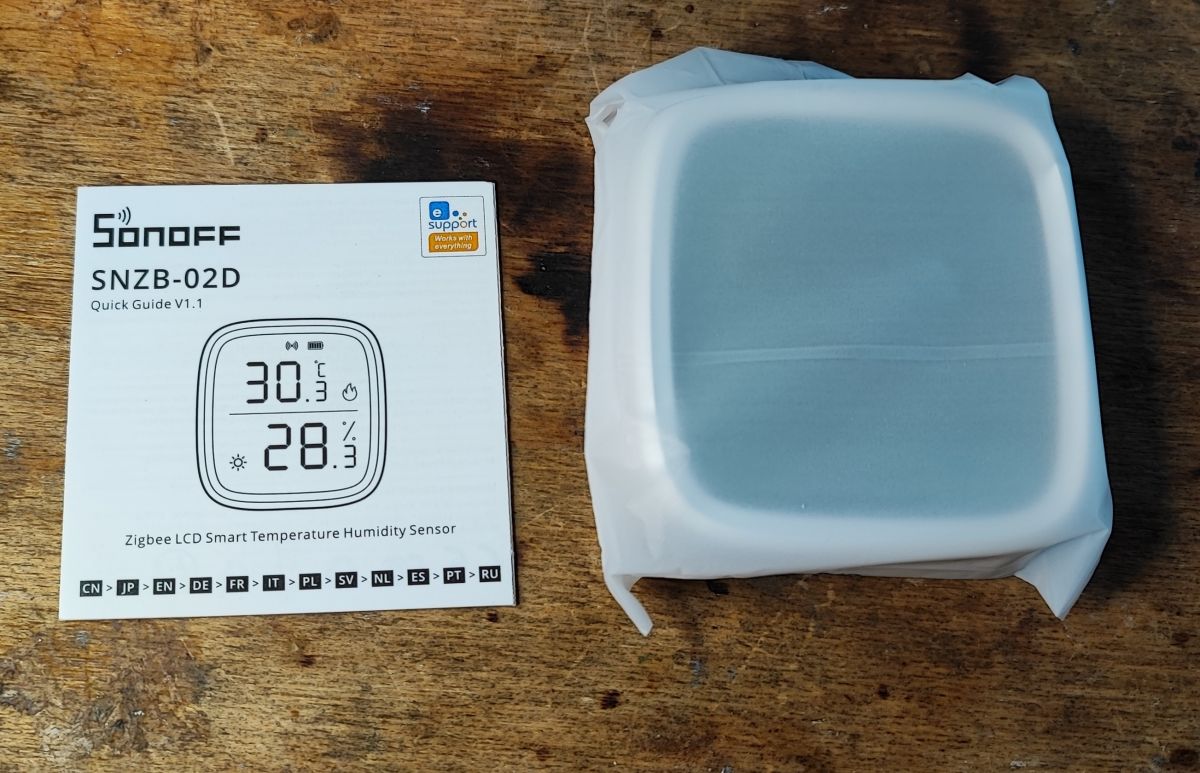

    The kit also includes instructions and a strip of 3M tape to stick the product in a convenient location if necessary:
    Sonoff SNZB-02D with user manual on a wooden surface. Back panel and instruction manual of Sonoff SNZB-02D sensor. Back of the Sonoff SNZB-02D temperature and humidity sensor on a wooden desk with visible specifications and an accompanying manual. .
    FCC ID: 2APN55NZB-02D
    Here are the instructions, maybe someone will find them useful, although I myself will pair this product straight away with Home Assistant, I don't even have the manufacturer's gateway.
    Sonoff SNZB-02D user manual spread out on a desk. User manual for Sonoff SNZB-02D with device illustration and instructions in multiple languages. User manual for Sonoff SNZB-02D temperature and humidity sensor on a desk. Sonoff SNZB-02D user manual spread out on a wooden surface. .

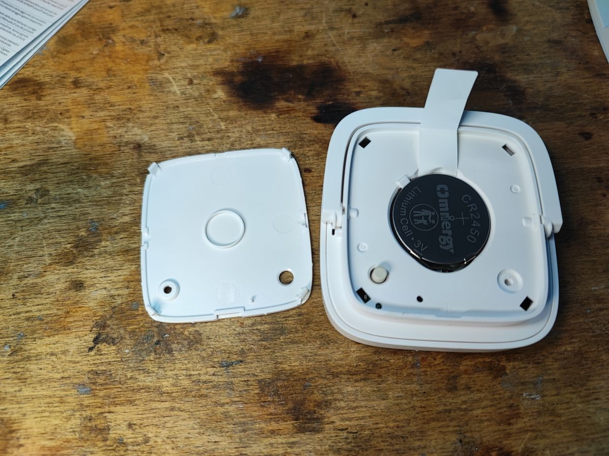

    Before commissioning, you must, of course, remove the strip insulating the battery so that it does not discharge in storage and transport.
    Image of the open Sonoff SNZB-02D device with the CR2450 battery cover removed. .

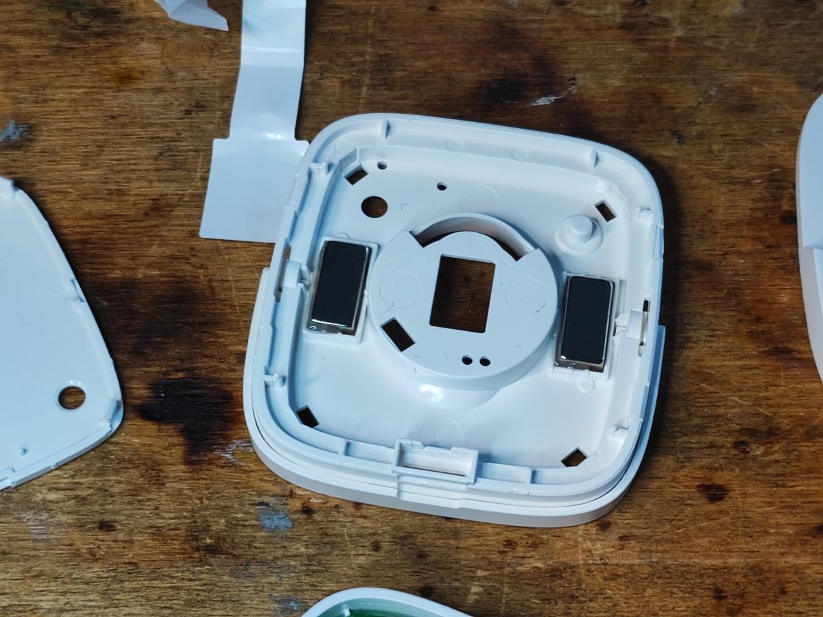

    The rear cover is held on by magnets:
    Interior casing of Sonoff SNZB-02D sensor with magnets. Image of the interior of the Sonoff SNZB-02D meter with exposed CR2450 battery compartment and 3M mounting tape. .

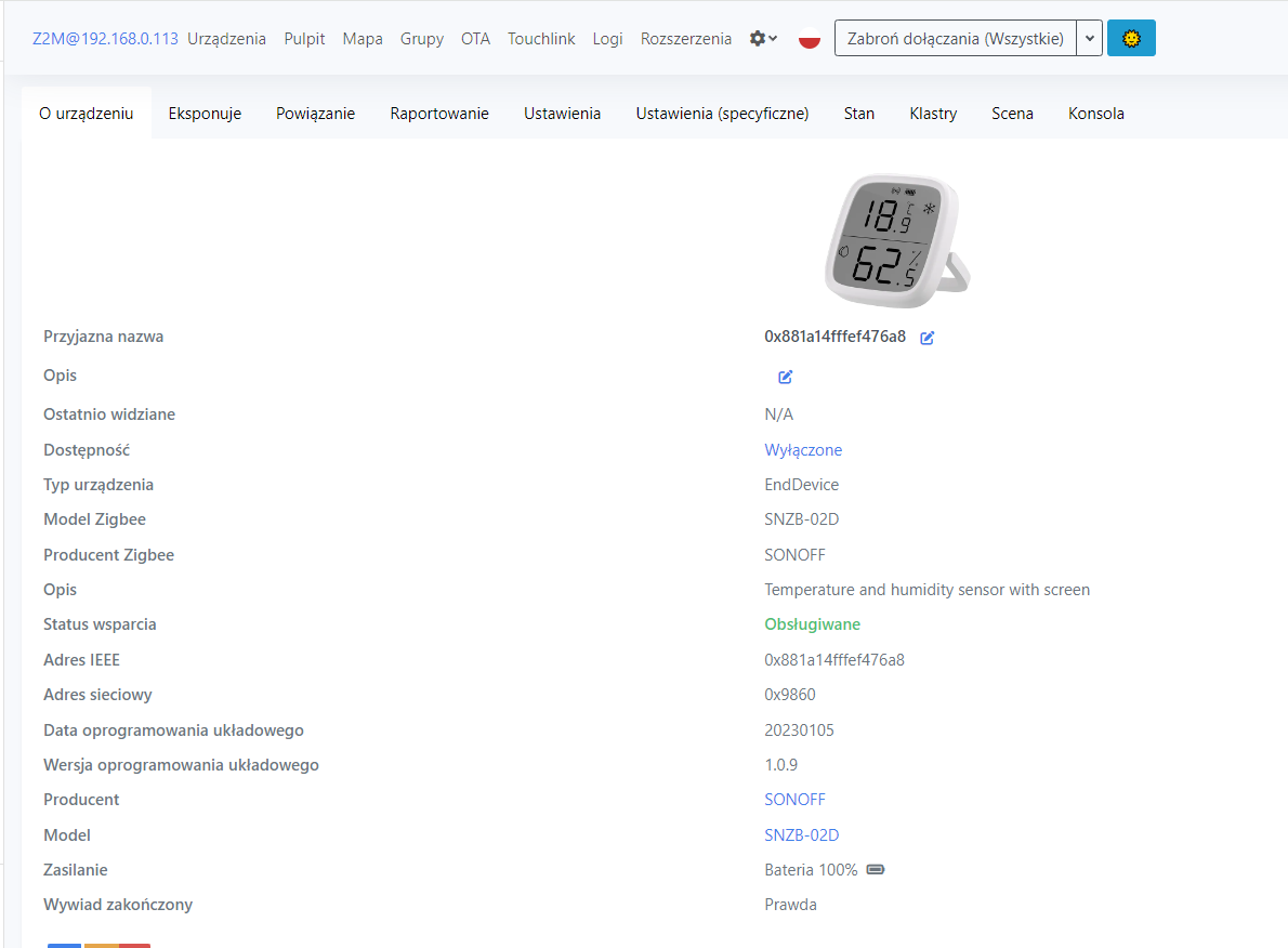

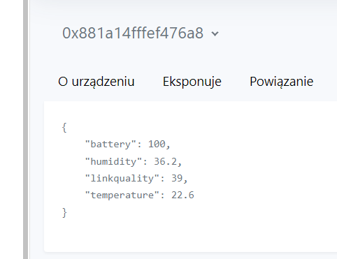

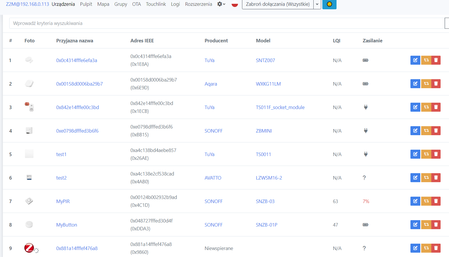

    If you need to, reset the device as instructed, at HA make sure pairing is enabled.
    List of Zigbee devices in the user interface. .

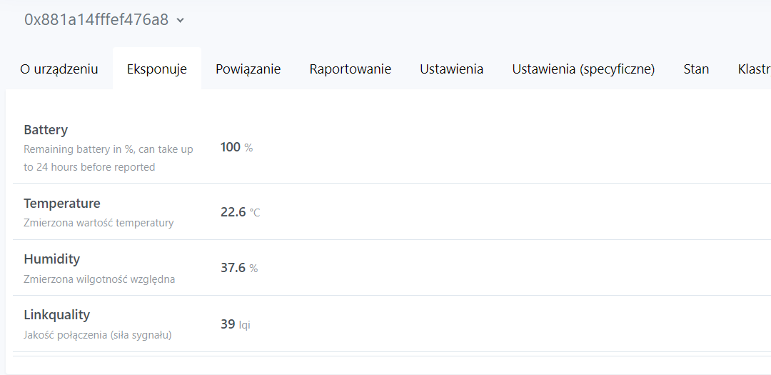

    The sensor provides four entities - temperature, humidity, battery level (from 0 to 100) and connection quality:
    Application screen showing data for Sonoff SNZB-02D temperature and humidity sensor User interface displaying data from the Sonoff SNZB-02D temperature and humidity sensor. Temperature and humidity calibration and precision settings screen. Screenshot of SNZB-02D sensor data in Home Assistant. .
    Based on these measurements, automation can be carried out in the Home Assistant and the history of measurements accumulates itself in clear graphs.

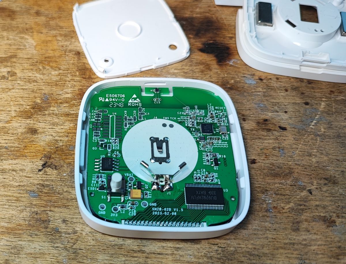

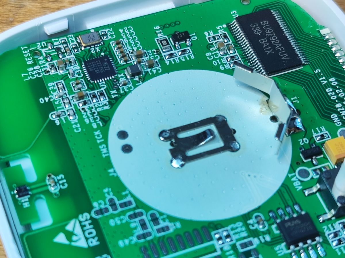

    Interior of SNZB-02D .
    Just out of curiosity - it's not a WiFi based sensor that you have to change the firmware.
    Inside view of the Sonoff SNZB-02D device showing the electronic circuit board.

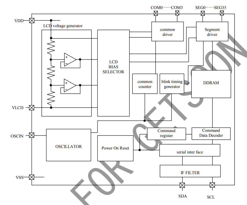

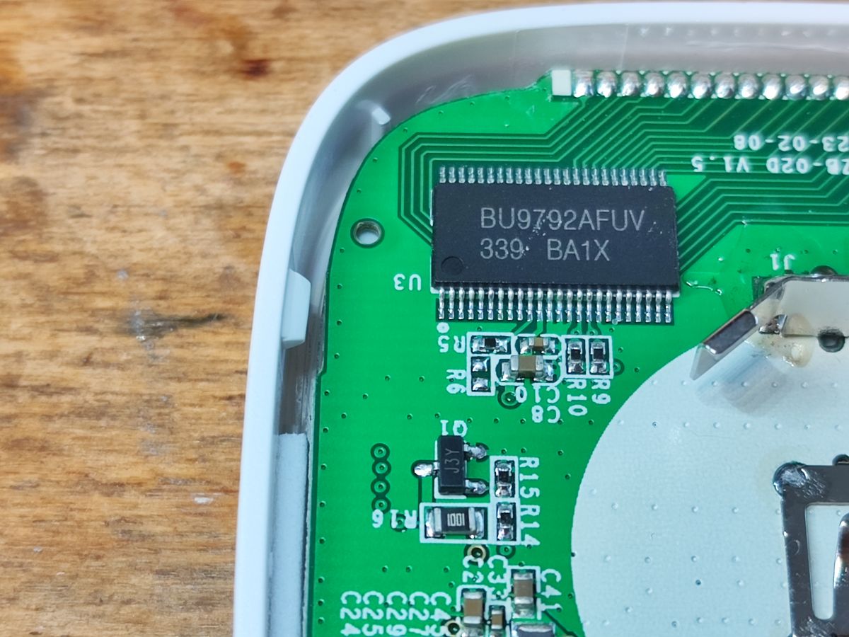

    BU9792FUV is an LCD controller.
    View of the inside of the Sonoff SNZB-02D temperature and humidity sensor with BU9792AFUV chip. View of the interior of the Sonoff SNZB-02D temperature and humidity meter with visible electronic components. .
    36 segments and 4 common signals. I2C interface.
    Block diagram of an LCD system with component labels. .

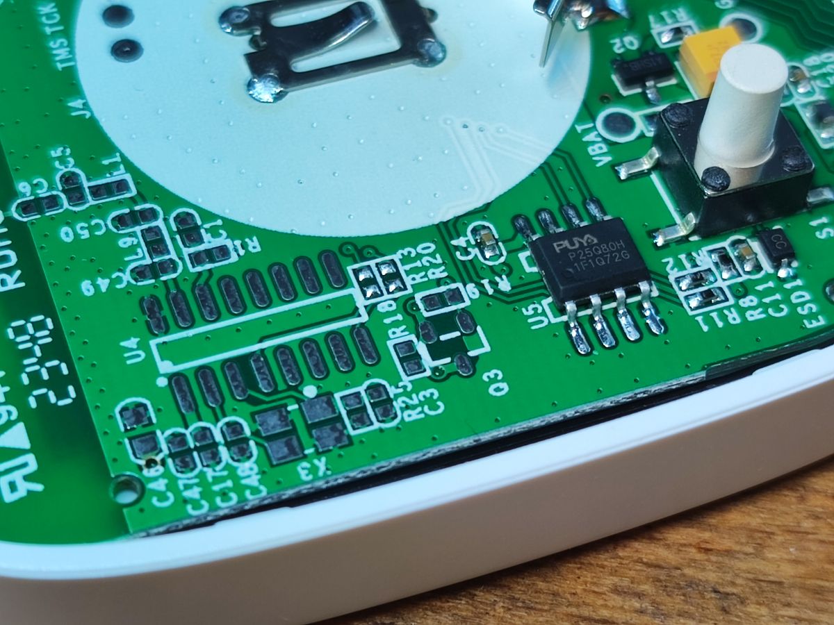

    Puya P25Q80H is a Flash memory - I was a bit surprised what they keep in there, I thought there would be a Zigbee SOC inside with no external memory?
    Inside view of the Sonoff SNZB-02D circuit board with visible Flash memory and button. .

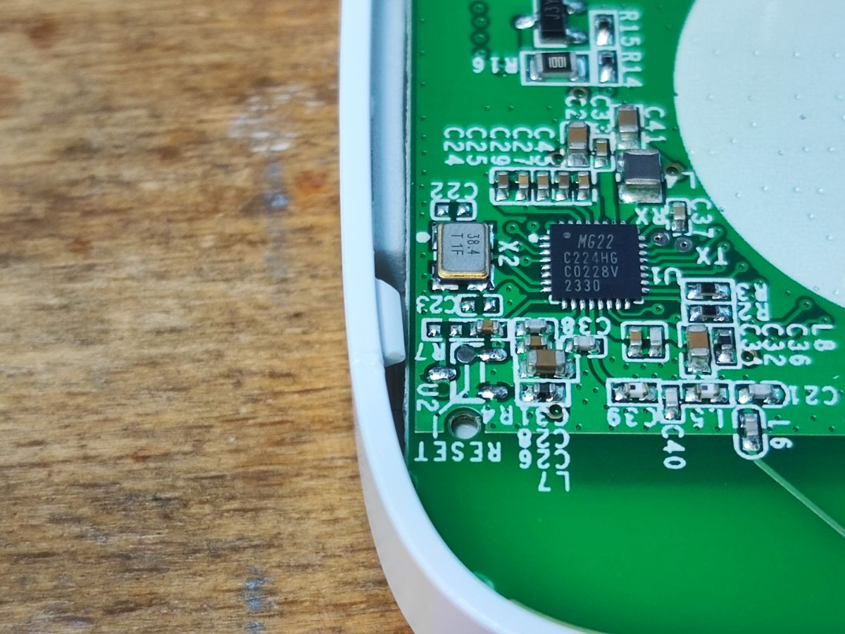

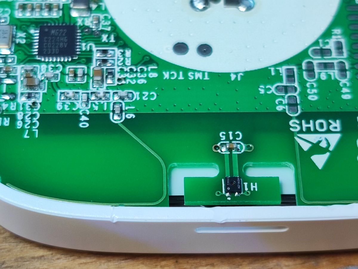

    Well, and the heart of the chip - the C224HG (looks like it's the EFR32MG22) - but an SOC with up to 512KB of Flash on board. So basically, I don't know what the Flash bone is there for....
    Close-up of the PCB inside the Sonoff SNZB-02D device. .

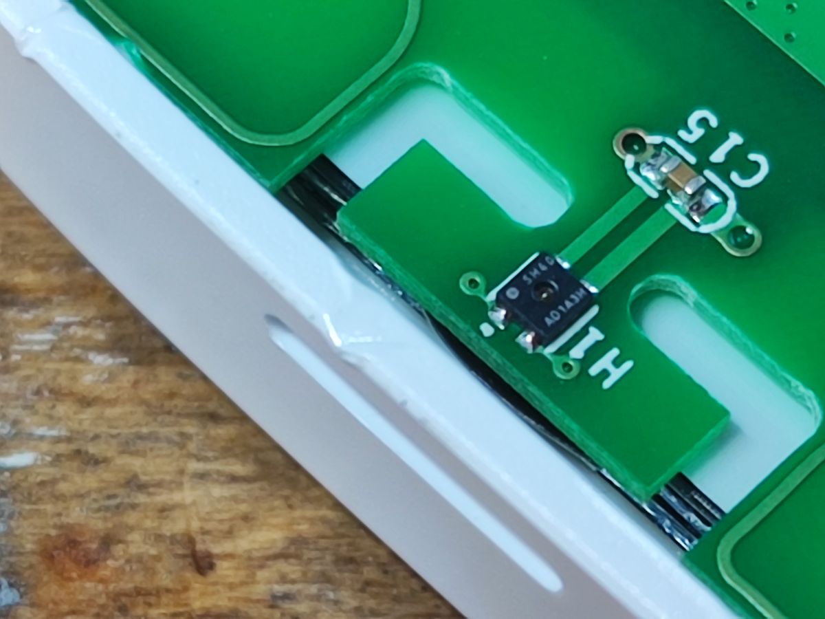

    Well, and a humidity/temperature sensor - could it be something from the AHT/SHT30 series?
    Close-up of the Sonoff SNZB-02D circuit board interior with electronic components. Interior of the Sonoff SNZB-02D sensor circuit board with visible components. .

    The microcontroller is an EFR32MG22, external flash memory probably for OTA image storage.
  • #3 21393855
    Posts: 14756
    Rate: 12883
    Indeed, I now recall seeing the same thing in the Zigbee button too Sonoff SNZB-01P .

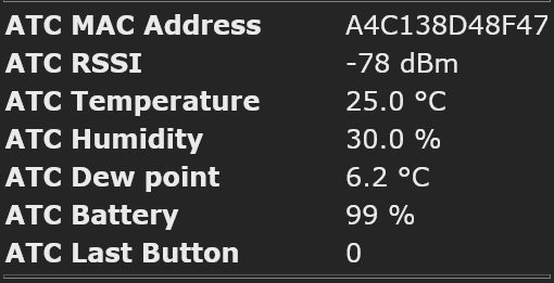

    Xioami Mi2. price about 25zł
    Factory sends telegrams over Bleutooth including temperature, humidity, battery status and more
    All you need is some device on esp32 with tasmot32-bluetooth and send data after mqtt to broker
    Screenshot of measurement data from ATC device. .
    Here the software has been changed to ATC
    The data is sent via Rule in the tasmot.
    Example rule with sending data to Domoticz
    ON ATCe5d91c#temperature DO Var1 %value% ENDON ON ATCe5d91c#humidity DO Var2 %value% ENDON ON ATCe5d91c#battery DO publish domoticz/in {"idx":176, "svalue":"%Var1%;%Var2%;1", "Battery":%value%} ENDON
    In addition, the tasmota sends all data to the tele/name/sensor topicle
    tele/Mi_Termo/SENSOR = {"Time":"2025-01-15T14:30:40","ATCca8ed0":{"mac":"a4c138ca8ed0","Temperature":20.1,"Humidity":30.3,"DewPoint":2.1,"Btn":0,"Battery":94,"RSSI":-82},"TempUnit":"C"}

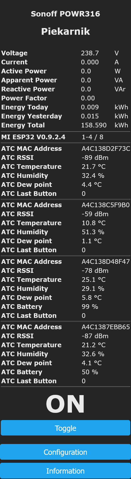

    Yes, I don't know how many max, but I have two esp32(ground floor and ground floor) and both support me these 11 thermometers. In each esp I have 11 rules entered for each thermometer because I don't know which esp will just receive the bluetooth data.
    One esp can probably handle up to 10 thermometers(9 for sure)
    Here is a snapshot of what the Sonoff POWR316 is catching with esp32. In addition to what it is supposed to do, it also handles thermometers
    Screenshot of a Sonoff POWR316 panel with ESP32 data displaying energy consumption and temperature and humidity sensors. .

    POWR316 , I tested it. Lots of those sensors, how about range?

    how about the range?
    ok, quite considerable for BT.
    I have one BT downstairs in the garage and the other upstairs on the opposite side.
    Each one catches the signal from 9 thermometers(I think that's the max the tasmot can process) spread around the house(11 units). My house is quite large.
    One catches thermometers with rssi from -89 to -75dBm and the other from -56 to -88dBm. Along the way several walls, ceiling etc.

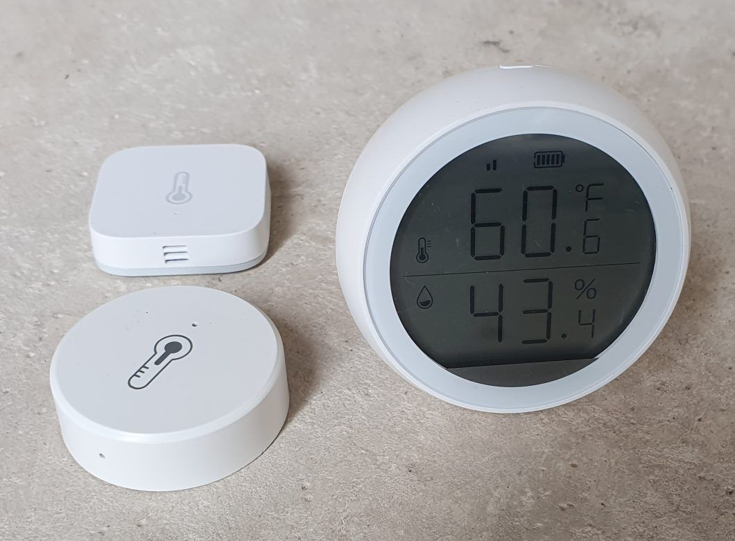

    It's nice that a topic about ZigBee and not just WiFi has come up. I decided to use thermometers on ZigBee to control the floor actuators. I bought different ones to do tests on what works best in a domestic environment. Here is my set up:
    Three different ZigBee temperature sensors on a grey surface. .
    Here we have an AQARA sensor, an RTX (identified as TS0201) and a sensor with a display (TY0201). As the sensor is to work as a thermostat with a relatively small temperature range (15-28 deg) the absolute temperature value is not important to me. Differences in the range of 0.3-0.4 deg are negligible, as what will really matter is the placement of the sensor itself (e.g. height above the floor). So what is important? I have found that stability of operation, speed of reporting and of course range are key.
    The range test I conducted is not entirely conclusive, but some conclusions can be drawn. The AQARA performed best, similar (slightly worse) results were obtained by the other sensors, with the one with the display being the worst at the range test.
    In terms of reporting resolutions, the one with the display reports values with a resolution of 0.1st, the others 0.01st.
    The key is the speed of reporting - i.e. how long after a temperature change you get new readings. My condition was that the value should not exceed 0.2st. This is important with underfloor heating - it has a lot of inertia and even when the heating is turned off the temperature will continue to rise. The thermometer with the display usually reported 0.1st at each change (i.e. with its resolution). Occasionally, however, it was 0.2 degrees - probably when the temperature was rising faster. However, it was never more than that. RTX reported every 0.13st or so. AQARA also reported well, but there were times when the spikes were unacceptable to me (0.4st). AQARA measures temperature, humidity and pressure. Changing any of the parameters causes reporting. However, I have the impression that if the humidity and pressure do not change the temperature reporting is at 0.4st. It should be noted that the reporting is not extremely frequent even with large temperature changes. Usually this period is about 5minutes. In the absence of significant changes it can be 30 minutes or more.
    Another test - how do the sensors cope with loss of connectivity? I took the sensors away for 2 days and then they were returned to their place. The thermometer with display was already giving new data after 25 minutes. RTX after about 4 hours (although in other tests it was much shorter). AQARA after ... 32 hours! Overall when it comes to the very highly regarded AQARA, there is some drama.
    Despite the battery power, all the sensors were able to switch to a better/other router.
    The RTX thermometer has been running for over a year (I bought it for my first ZigBee tests) and reports 100% battery. The AQARA, which has been running for a few months reports 63%.
    At the moment my favourite is the RTX. However, I would love to read your comments on ZigBee thermometers.

    I checked. Xiaomi Mi2
    11 side by side as close together as possible, so that they do not touch each other and at the same time you can read the result on the display.
    After more than 2 hours of lying like this
    Temperature difference +- 0.2stC
    Difference in humidity +- 1%.
    I would like to mention that after uploading alternative software it is possible to calibrate/correct the above indications.
    I also have a similar Hama thermometer, much larger without communication and here there was already a difference. temperature about 0.5stC and humidity a good few % but less than 8%.
    I did not check after reading via BT.

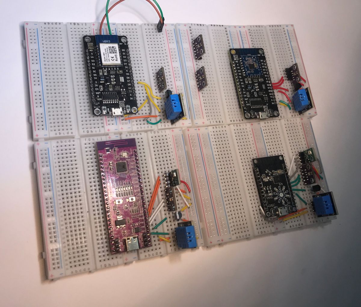

    jarekgol wrote:
    Have you had occasion to compare the humidity readings with other units? Or have colleagues who have several pieces put them side by side and checked what the scatter of readings is?
    I'm working on a similar comparison for different measured quantities, but I'm operating on sensors alone, I have DS18B20, DHT11, BMP280 and AHT20 hooked up, on four boards at the moment, so there will be at least 4*4 = 16 sensors:
    Four prototype boards with various modules and sensors, including DS18B20, DHT11, BMP280, and AHT20. .
    Results of the comparison soon on the forum.
