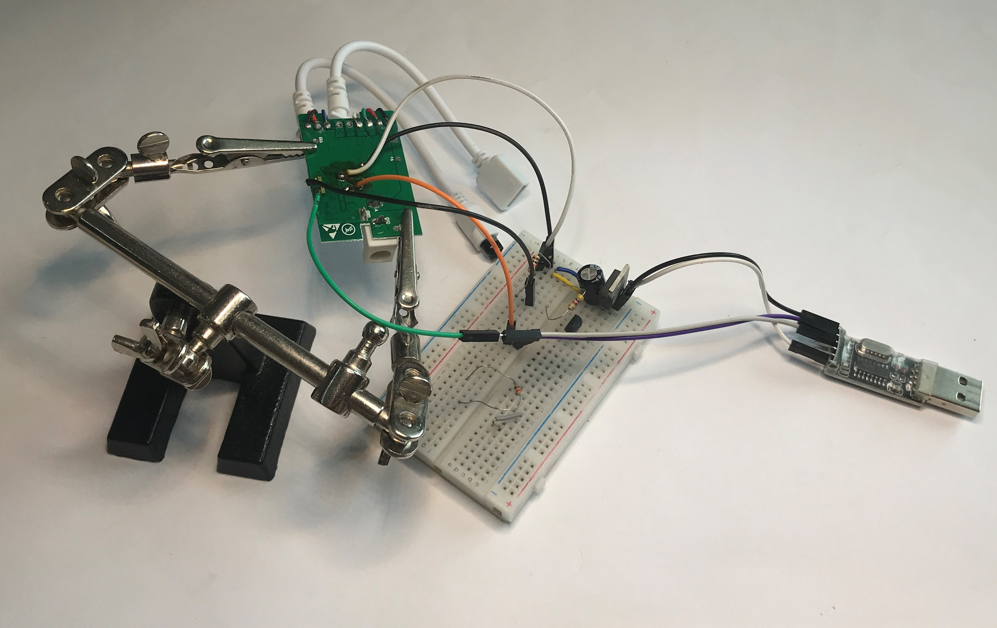

EC79900 board connected to USB-UART adapter and breadboard with power supply
It has been a long time since I presented a device realised on the BL602. It is time to change that. The BL602 is a microcontroller offering 2.4 GHz Wi-Fi and Bluetooth LE 5.0 connectivity based on a 32-bit RISC-V core clocked at up to 192 MHz. It also has on-board Flash memory, generally 2 MB. It can sometimes be found in IoT devices, such as the Magic Home brand. This is where I will present one such one. The importer has repainted it EC79900 ecolight. It's worth noting that there is no Tuya support here, it's a different app.

The rest as in the indicated material - USB to UART converter and 3.3 V LDO:
Flashing EC79900 board with BL602 via USB-UART adapter
