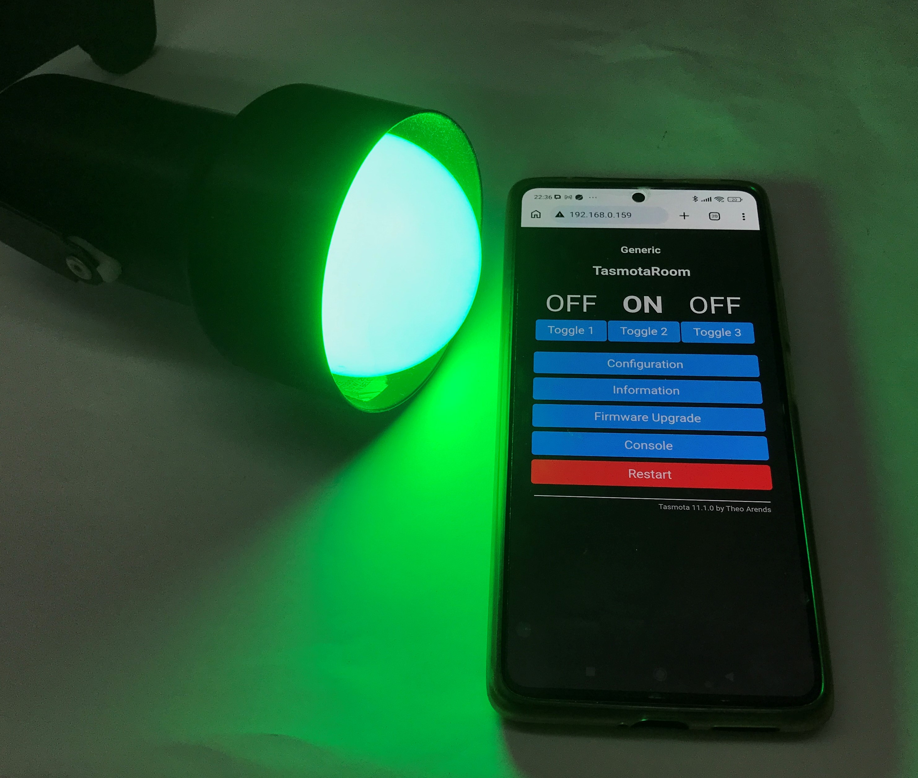

Green glowing lamp next to a smartphone showing the TasmotaRoom control interface with toggle buttons
As a rule of thumb, it has been accepted that the MQTT broker must be a high-performance server, a cloud service, or at least a Raspberry Pi-style microcomputer. The question, however, is - are you sure? Wouldn't it be possible to realise a simple MQTT server on a chip like the ESP32 or BK7231, with a limited RAM size of, say, a dozen or so kilobytes? In this topic, I will try to show that it is possible and that MQTT is not at all as resource-intensive a protocol as it may seem. I will present here my implementation considerations, the problems I encountered and the treatments I used to reduce memory usage, and then I will present the results of my work.
I will develop the server in my OBK environment, which means it will run on 32 platforms (including BK7231, ESP32 and Windows):

Practical presentation
We compile ( possible online ) OBK with the MQTTServer driver enabled in obk_config.h:
#define ENABLE_DRIVER_MQTTSERVER				1
I also recommend compiling with Berry, as Berry in OBK already has integrations of this server.
The driver to be started - startDriver MQTTServer. Preferably in autoexec.bat:
It can also be configured:
- ms_publish Topic Value
- ms_user UserName
- ms_pass Pass
- ms_port 123
Only one user is supported. We enter the set data on other devices - I've tested with OBK and Tasmota - it should appear on the panel with us, although this list of them is here for testing and debugging only:
Screenshot of an MQTT Server dashboard listing 3 connected devices and blue test buttons like “Send Toggle” and color sends.
The list includes buttons that send Tasmota commands (also OBK-compatible), but this too is only for testing.
