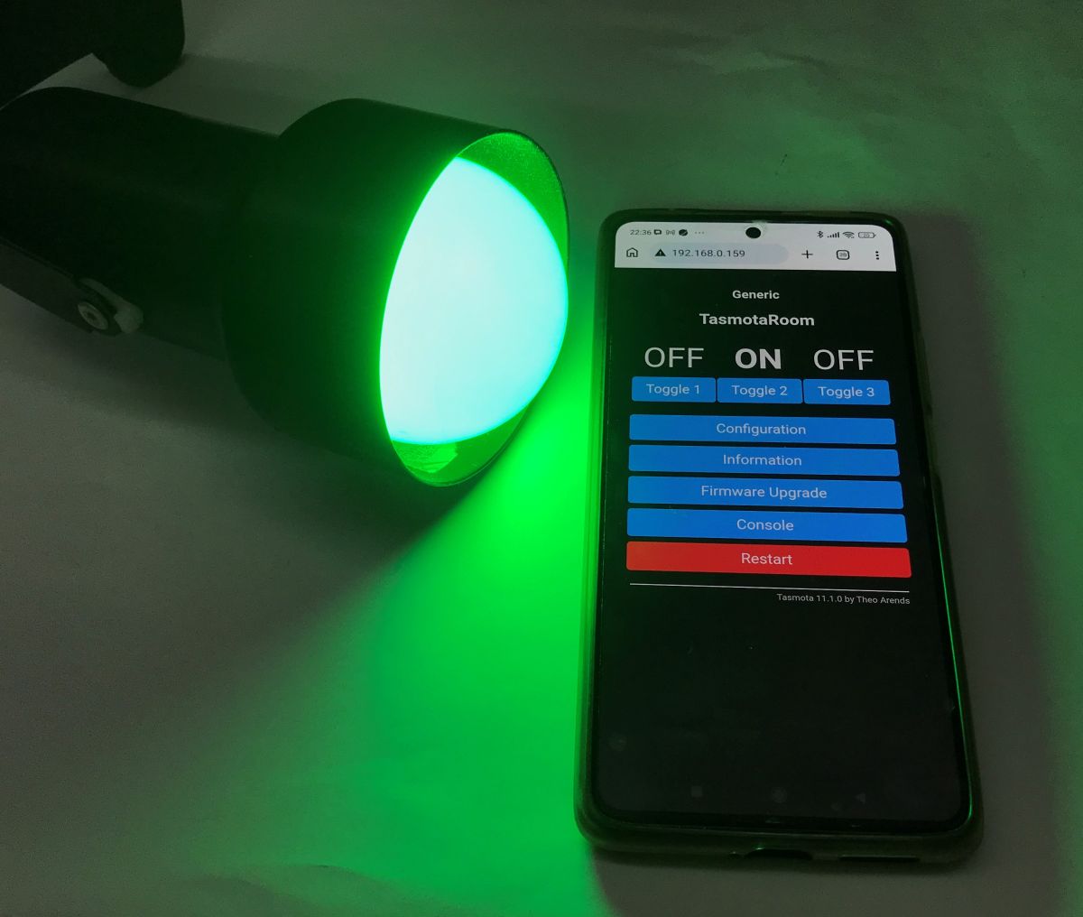

  • Green glowing lamp next to a smartphone showing the TasmotaRoom control interface with toggle buttons
    As a rule of thumb, it has been accepted that the MQTT broker must be a high-performance server, a cloud service, or at least a Raspberry Pi-style microcomputer. The question, however, is - are you sure? Wouldn't it be possible to realise a simple MQTT server on a chip like the ESP32 or BK7231, with a limited RAM size of, say, a dozen or so kilobytes? In this topic, I will try to show that it is possible and that MQTT is not at all as resource-intensive a protocol as it may seem. I will present here my implementation considerations, the problems I encountered and the treatments I used to reduce memory usage, and then I will present the results of my work.
    I will develop the server in my OBK environment, which means it will run on 32 platforms (including BK7231, ESP32 and Windows):

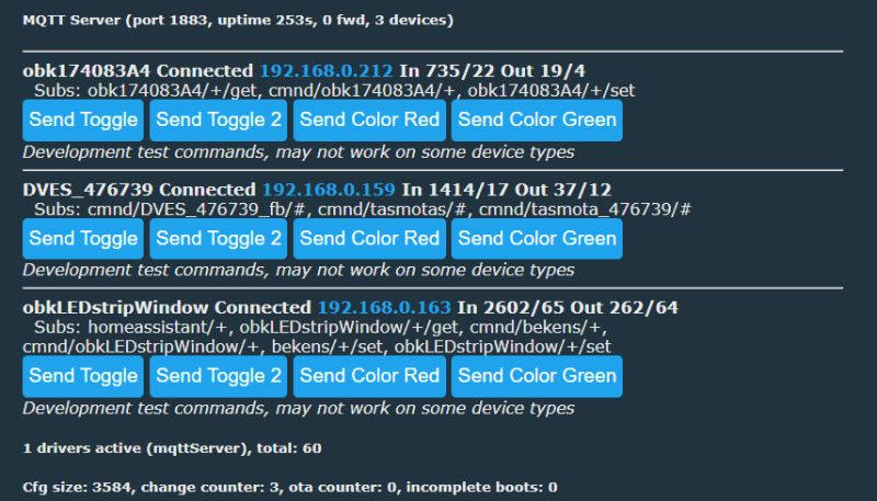

    Only one user is supported. We enter the set data on other devices - I've tested with OBK and Tasmota - it should appear on the panel with us, although this list of them is here for testing and debugging only:
    Screenshot of an MQTT Server dashboard listing 3 connected devices and blue test buttons like “Send Toggle” and color sends.
    The list includes buttons that send Tasmota commands (also OBK-compatible), but this too is only for testing.

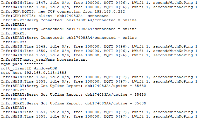

    Results:
    Screenshot of logs showing MQTT TCP connection, BERRY messages, and uptime reports for device obk174083A4
    Console log screenshot showing “Info:BERRY:Berry POWER STATE” entries and MQTT topics.

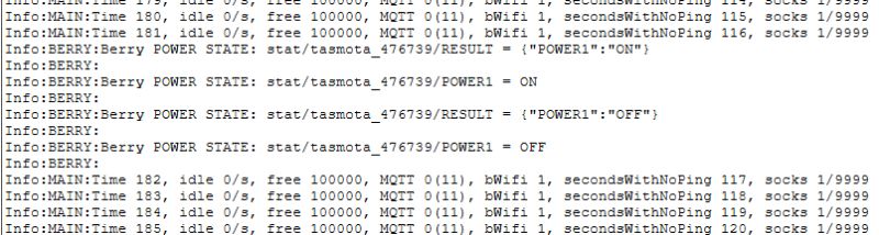

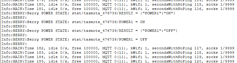

    Berry is not just about listening, however. We can also publish data (command ms_publish ). Various automations can be done in this way. For example, the script below transmits the state of the second relay on the light switch to the LED light. It's worth mentioning here that this switch, I have mounted in a box with wires to one lamp, and yet it has as many as three buttons - one of them controls the lamp, the other two are for automation.
    autoexec = module('autoexec')
    autoexec.init = def()
    	autoexec.power_state_sub = ms_subscribe("stat/tasmota_476739/POWER2", def (topic, payload)
    		ms_publish("cmnd/obk174083A4/POWER",payload);
    		print("Berry POWER STATE: " + topic + " = " + payload)
    	end)
    end
    return autoexec
