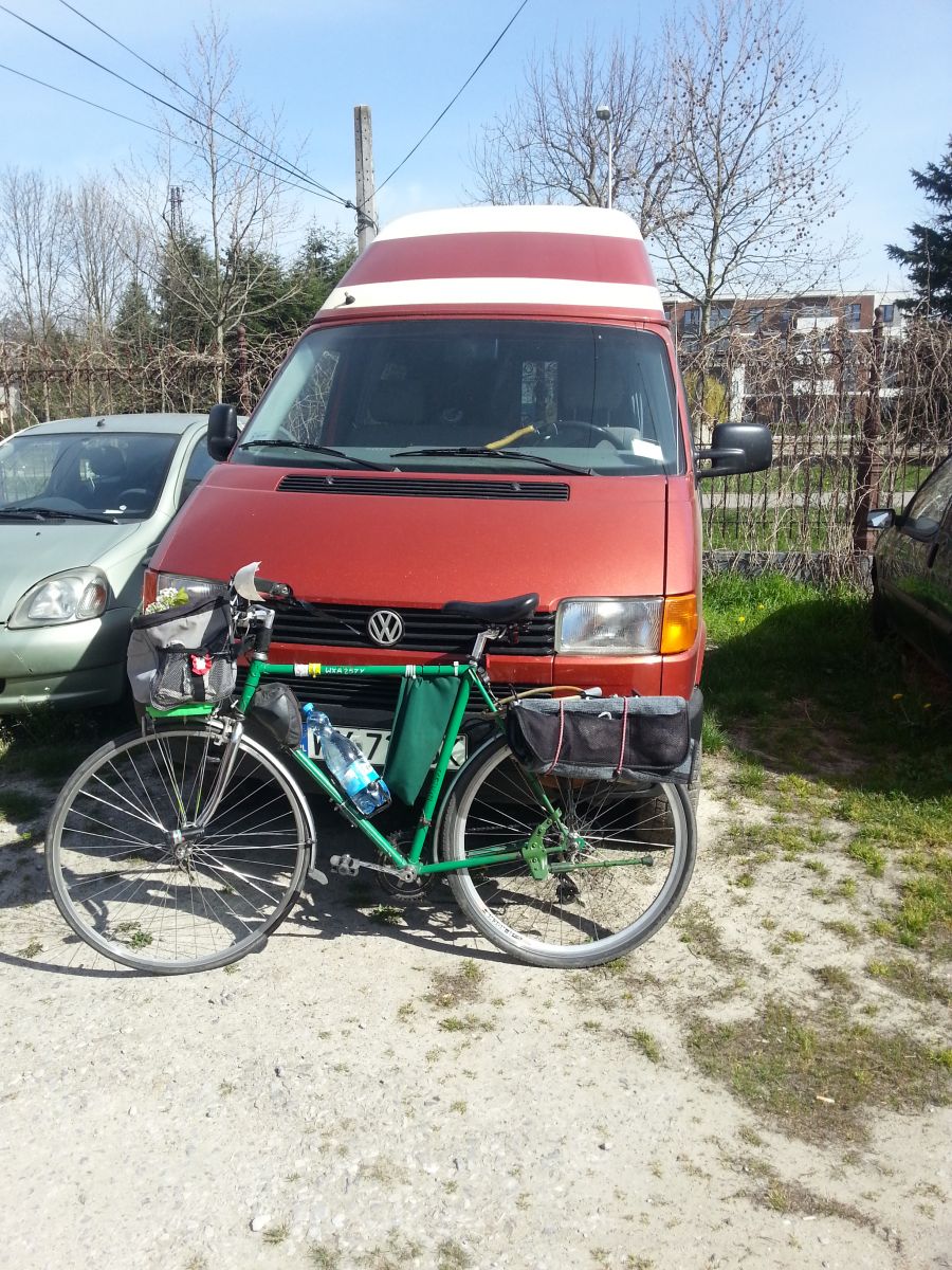

    And I followed the advice of the wiser. I bought a T4 with a 1.9 engine without supercharging. The engine is like new, and its power is 50 kW.
    And I'm nowhere, in no rush. The transporter's task will be to carry two people's belongings and haul 800 kg. boats with a trailer. Choosing an Engine for VW T4 Transporter for Electrician Work: 1.9D, 1.9TDI, or 2.4D?
