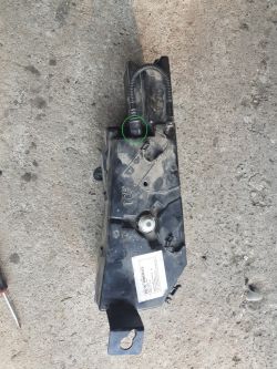

  • Removing and refilling the Eolys tank under the car
    #39 17421607
    djalex99
    Posts: 30
    Rate: 38
    Below photos and a small comment on what to do :P
    First of all, I recommend using the channel, it can be done without, but it is much more convenient.
    NO, it's in turn :)
    1. View under the car in Red, I marked the places where we have plastic hooks for removal (two sizes - I recommend buying a few pieces in advance, they like to break), I marked with green the places where we have thread nuts (size 10) I recommend using a ratchet with an extension
    How to add Eolys fluid to Citroen C4 1.6 HDi 110 FAP (2005) – where?
    2. After removing the casing, we can see the tank, I decided to refill it to remove it, you can also do it without it, but you just need to unscrew one screw and take out the container. In my opinion, this is a more practical solution.
    And again in green I marked the point where the unscrewing nut is (probably size 13) is quite deep. Yellow and blue have marked the two wires to be connected, yellow is the pump power supply, blue is the liquid, of course we remove the wires. We squeeze the fluid from the sides with our fingers and pull it back, while the one feeding from the top has a blockade, I lifted it with a small flat screwdriver.
    3.After unscrewing the screw, slightly bend the tank fastening element so that it comes off the thread (if we do not do it, we will not remove the tank), and then by slightly moving the tank towards the front of the car, at the same time to the outer edge of the vehicle, the tank will come off the two plastic fasteners and we have it in our hands .
    4. This is what it looks like after taking it out
    Detach the cable marked in green, similar to the one at the pump, squeezing at the sides.
    5. We start filling it, you can't really spoil it. Together with the liquid, we get two hoses, the long one with a cap and a valve for the liquid bottle, the other end is equipped with a connector for connecting as in the photo, and the short one is intended for the overflow vessel (I used the bottle, Detailed instructions for refilling are attached to the liquid
    That's it :) now we do the rest in reverse order. If there are any questions, I am at your disposal.
