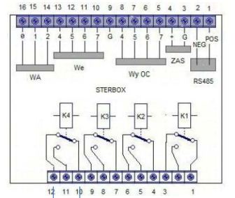

    I received the Sterbox I’d bought a few days ago.
    And so far, I’m very dissatisfied. This is because of the timers that can be set on this device. There are eight timers, but in my case, it’s more like having one timer with eight settings. Because each timer can only be set to switch on and off once a day. Of course, I could have checked its capabilities before buying it, but I didn’t, and now I’m left holding the baby, because it was precisely these timers I cared about most. I don’t know what the developers of this marvel were thinking to limit its functionality in this way. Because if we connect, say, a boiler to it, we can forget about other timer-controlled functions. In my opinion, every timer should have at least 4 or 5 on/off cycles.
    Further shortcomings of this Sterbox.
    We’re programming the control of relay k4, yet we have to use the name ww3 in the programme. Do we always have to make life difficult for ourselves? Wouldn’t it be better to label the relays as k0 to k3, so that we’d have k3=ww3
    No option to manually set the current time. There is information stating that entering a time in the „zg8” field will automatically set the clock in the Sterbox. But there is no such „zg8”8221; in the settings.
    To test the Sterbox, I used the configuration diagram titled „Example of connecting and programming the Sterbox for
    resetting a router, modem, etc. in the event of a loss of
    Internet (WAN)”
    I set up the Sterbox exactly as described, and what do you know, nothing happened I disconnected the telephone cable from the router, waited, and there was no reaction from the Sterbox. It was only when I disconnected the RJ45 from the Sterbox that the router restart procedure began. So the Sterbox doesn’t control Internet access, as the manufacturer claims, but only whether it has access to any network at all. In my case, the Sterbox was content with just the home network without the Internet.
    Whilst testing the Sterbox, I noticed that a proper manual describing its internal functions would be useful.
    For example, to reset the router in the ‘macrocell’ settings tab, we enter commands and an image appears – or, if you prefer, a diagram of the macrocell. How many and what sort of built-in diagrams are there in this Sterbox? And as if that weren’t enough, when setting up the Sterbox, there are various options to configure, including input and output points for a given gateway or macrocell – and everything would be fine, except that when testing the macrocell settings, we don’t enter anything in the output fields, so how are we supposed to know where the signals from that macrocell are going?
    After a few hours of playing around with this Sterbox, I could go on complaining, but it’s a waste of space.
    There’s certainly plenty of potential in the Sterbox, but it lacks a proper user manual.
    So if anyone’s planning to buy a Sterbox, they should think it through carefully and have a go on a virtual Sterbox to see if it’ll meet their requirements.

    Polikon wrote:
    A few days ago I received the Sterbox I’d bought.
    And so far I’m very dissatisfied. This is because of the timers that can be set on this device. We have eight timers, but in my case it’s more like having one timer with eight settings. Because each of the timers can only be set to switch on and off once a day. Of course, I could have checked its capabilities before buying it, but I didn’t, and now I’m left holding the baby, because it was precisely these timers I cared about most. I don’t know what the developers of this marvel were thinking to limit its functionality in this way. Because if we connect, say, a boiler to it, we can forget about other timer-controlled functions. In my opinion, every timer should have at least 4 or 5 on/off cycles.
    We’re programming the control of relay k4, yet we have to use the name ww3 in the programme. Do we always have to make life difficult for ourselves? Wouldn’t it be better to label the relays as k0 to k3, so that we have k3=ww3
    No option to manually set the current time. There is information stating that entering a time in the „zg8” field will automatically set the clock in the Sterbox. But there is no such „zg8” field8221; in the settings.
    Internet (WAN)”
    For example, to reset the router in the ‘macrocell’ settings tab, we enter commands and an image appears – or, if you prefer, a diagram of the macrocell. How many and what sort of built-in diagrams are there in this Sterbox? And as if that weren’t enough, when setting up the Sterbox, there are various options to configure, including input and output points for a given gateway or macrocell – and everything would be fine, except that when testing the macrocell settings, we don’t enter anything in the output fields, so how are we supposed to know where the signals from that macrocell go?
    So if anyone’s planning to buy a Sterbox, they should think it through carefully and have a go on a virtual Sterbox to see if it’ll meet their needs.
    I have two questions for the esteemed forum members.
    Does anyone know of any user forums dedicated to the Sterbox?
    And as I mentioned earlier, I am disappointed with the functionality of the timers in Sterbox and am looking for a timer similar to Sterbox, but one where a single timer can perform several on/off functions throughout the day. Naturally, controlled via LAN.
    The relays are designated as ww0 to ww3, so k3 is ww3 :)
    As for controlling the heating, Sterbox isn’t suitable. The timers have got me down too :( As for the ZG8, first set the time in the general settings and then the real time will update automatically.
    My router restarts without any issues :)
    I’ve used the Starbox to control lighting, gates and sockets, and it works well for that. As for heating, the seller himself said it isn’t suitable for that. It only performs simple on/off functions

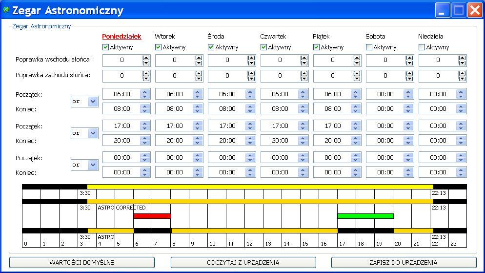

    I’m also thinking about buying one, but I’ve been put off by those timers.
    Is it possible to set it so that one relay operates as follows:
    6:00 ON
    8:00 OFF
    17:00 ON
    20:00 OFF
    from Monday to Friday
    One more question: is it possible to send readings from the connected temperature sensors, e.g. every 10 minutes, to an FTP server?

    Dinkss wrote:
    I’m also thinking about buying one and these timers have put me off.
    Is it possible to set it so that one relay operates:
    6:00 ON
    8:00 OFF
    17:00 ON
    20:00 OFF
    One more question: is it possible to send data from connected temperature sensors, e.g. every 10 minutes, to an FTP server?
    You can even download data every second, or even write your own script for downloading and calculating. The software even supports LabVIEW; you can load the controller into LV and do whatever you want in LV..
    I’ve set it up for you as you wanted. You can retrieve data from any of these time lines, combine them logically, as you wish. Yours are the red and green ones marked as R and G
    Choosing a home automation system: Sterbox vs PLC2011A0 – reviews and experiences
    On top of that, there are 4 open-collector outputs, 2 +12V outputs, and you can connect 8 relays via 1-wire. At a pinch, with these 8 relays you can control gates, centralised roller shutters, sort out the lighting in the garage and outside the house – whether manually controlled or astronomically – and you have 4 thermostats, 32 DS18B20 thermometers and a fully-fledged alarm. 16 outputs in total.

    Dinkss
    On Sterbox, you can combine these eight timers into a single timer with eight on/off functions for the whole year and assign it to any output. You can simply connect them in series.

    That’s right, and it’s exactly as you say. But please show me where the K0 relay is on this diagram. Since all inputs and outputs start their numbering from zero, why are the relays on this diagram marked from one?
    And this leads to situations where I set the router reset (according to the manual) to output ww3, but relay k4 is operating.
    And just to be precise, ww3=k4
    I forgot to add that on the housing, the LEDs indicating relay operation are also numbered from 1 to 4, and the fourth LED indicates the operation of output ww3
    Such a small typo, yet it can cause quite a bit of confusion. All it takes is a moment’s inattention when typing.
    As for that zg8, it simply isn’t there. When I tried to enter something, in the general settings under ‘time’, nothing was accepted (maybe I was typing it wrong), because it only accepted the changes once it had set the time itself from the internet. Because the time wasn’t right for me.
