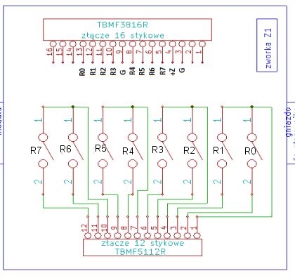

    And now I’m reading Pin No. 7, Name R5. And in the diagram, does pin 7 correspond to a name? None, because it’s a relay input. Pin No. 8, Name R4. And in the diagram, R3.
    Quote from the description of pin 5: “In a module with address 1 set to wwF port, address 2 set to wwN port”
    And how can one trust the manual when, in the diagram, all relay inputs are labelled as 1 and outputs as 2?.
    The user manual is essential, especially for devices like these. And I’m not surprised that Mr Piotr is inundated with emails. As he wrote to me himself.

    Choosing a home automation system: Sterbox vs PLC2011A0 – reviews and experiences
    And now I’m reading: Pin No. 7, Name R5. But in the diagram, does pin 7 correspond to a name? None, because it’s a relay input. Pin No. 8, Name R4. But in the diagram, it’s R3.
    Quote from the description of pin 5: “In a module with address 1 set to port wwF, address 2 set to port wwN”
    Somehow it didn’t bother me; everything is going according to plan and I check things for myself anyway.
    The user manual, especially for devices like this, is essential. And I’m not surprised that Mr Piotr is inundated with emails. As he wrote to me himself.

    And now I read Pin No. 7 Name R5. And in the diagram, does pin 7 correspond to a name? None, because it is a relay input. Pin No. 8 Name R4. And in the diagram, R3.
    The user manual, especially for such devices, is fundamental. And I’m not surprised that Mr Piotr is inundated with emails. As he wrote to me himself.
    I have looked into the alleged error and it appears to be yet another example of the manual not being read properly.
    The relays are on the 12-pin LOWER connector!
    The description quoted refers to the 16-pin OC input/output connector, i.e. the UPPER CONNECTOR.
    Just look: ground G is on pin 3, then we have +Z on pin 4, and so on, as can be seen both in the diagram provided and in the description.
    PS. The relay has no inputs or outputs, only normally open contacts.

    The relays are located on the lower 12-pin connector.
    Just look: ground G is on pin 3, then we have +Z on 4, etc., which can be seen both in the diagram provided and in the description.
    Yes, that’s correct; the manual describes the 16-pin socket (the top one).
    And there is no description at all for the 12-pin socket (the bottom one).
    But since the diagram shows every pin labelled, both the top and bottom ones. So, given that during programming we can assign only one function to a single input or output – either as an input or as an output.
    Logically speaking, if I want to assign the wwF port as an output, and in the manual it is described in the jumper-set module as R7 on the upper 16-pin socket. And the relay on the 12-pin socket is described in the same way (R7), so I assume that this is port wwF set as an output.
    But that is not the case, because it is actually the output of port ww8. And the actual output of port wwF corresponds to the pin described on the lower socket as R0.
