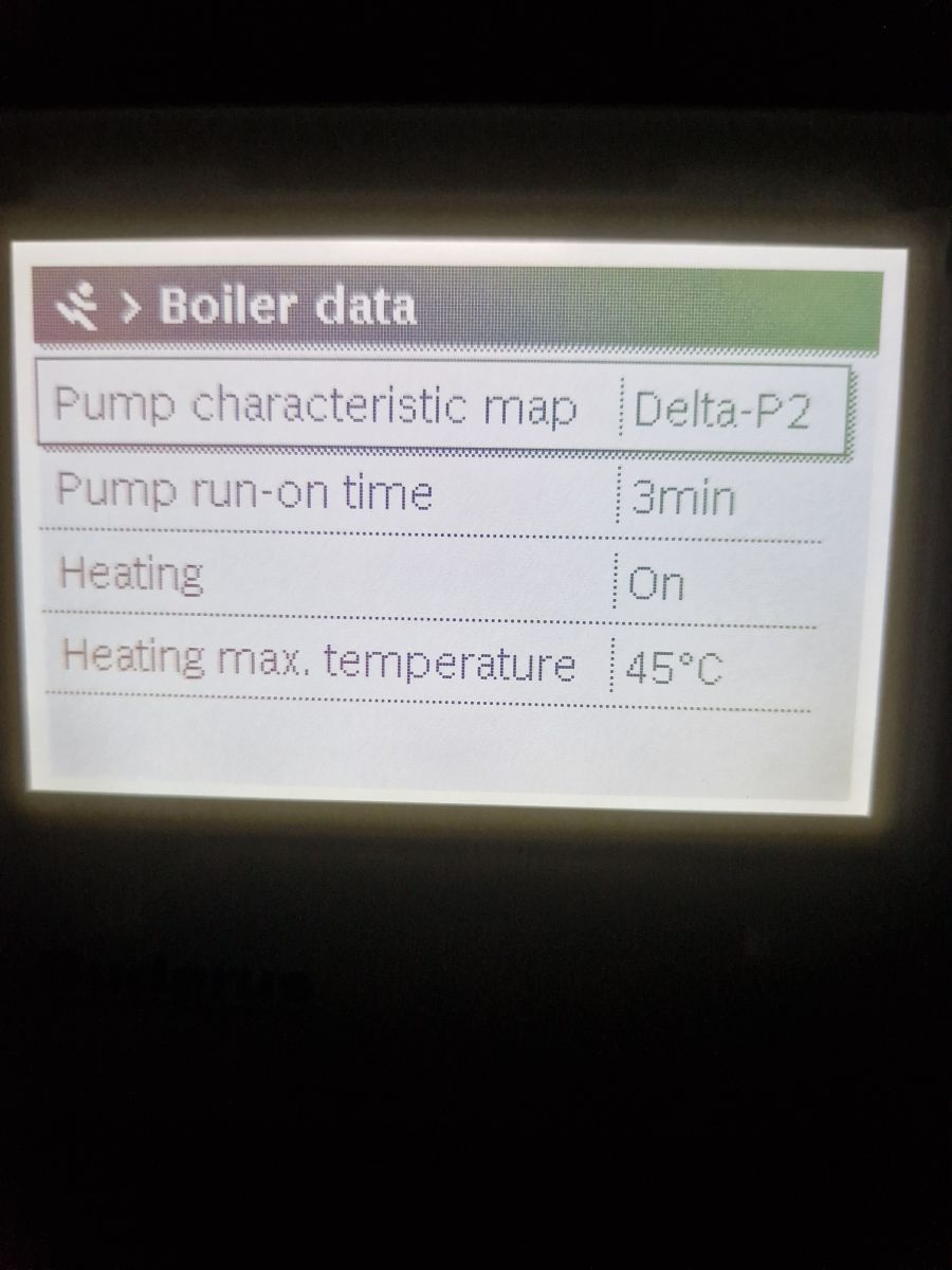

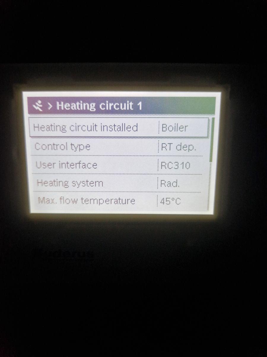

    polakm4a1 wrote:
    Maybe I`ll describe it like this. I live abroad and I`ve seen a lot, but I don`t know anything about it, so I`m certainly not surprised that it looks like the work of a crazy service technician. It`s probably true, but how to deal with it now.
    Ground floor apartment, neighbors overhead. A large living room and kitchen and 2 rooms in which the doors are open only at night and locked. There are 3 radiators in the living room + one small one in the open corridor, in 1st floor rooms.
    The rc310 controller menu looks like this: I changed both parameters to 45 and on the stove, to be sure, after pressing the radiator icon, also to 45.
    I don`t understand why one parameter is defined as the maximum heating temperature and the other as the maximum temperature for the radiators, because for me, a layman, they are the same thing.
    Boiler data display showing information on pump settings and maximum temperature. Heating system display showing configuration details.
    The weather at night was 6 degrees, from 3 p.m. to 7 a.m. approximately 7 m3 was consumed.
    As I wrote, the radiators are turned all the way up, because I treat the whole thing as one room.
    I forgot to write that my goal is to maintain a constant temperature for 24 hours. During the day 20.5-21 at night 19.5-20 month old baby at home and someone stays all day.
    This suggests that the installation contains elements that are not resistant to higher temperatures, so I suspected that in addition to radiators, you also have underfloor heating.
    This is a common combination, because the floor itself causes stagnation of air circulation in the apartment, and radiators do not allow this, forcing air circulation in the apartment.
    If you live on the ground floor, there is a high probability that due to poor insulation in the ceiling, you heat your neighbors upstairs.
    It`s the opposite for me, I live upstairs and my wife and I don`t like temperatures above 18 degrees Celsius, and our neighbors downstairs, Brazilians, like the warmth and not only warm us up, but overheat us so much that we sweat at night like in a sauna.
    If it`s your own apartment, you should consider the possibility of installing good insulation between floors, because heat always goes up, so the ceiling is always a few degrees warmer than the floor, and if the ceiling is weak or there is no insulation, most of the heat is he goes to the neighbors upstairs.
