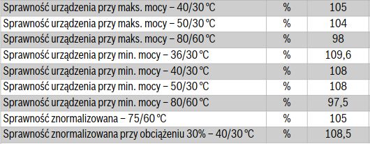

    miro.t wrote:
    According to him, I have to set the temperature to 55st. and the pump at its lowest speed, making the bottom of the radiators practically cold and the top hot.
    in principle, the return temperature is important for condensation.
    Analyze the efficiency of the boiler as specified by the manufacturers:
    eg Bosch 2200 has the following data:
    What is the optimal condensation temperature for a CO furnace?
    Taking into account the minimum power, the efficiency for 50/30 and 40/30 is the same and amounts to 108%. Only with 36/30 water we get 109.6%.
    Unfortunately, I do not know the efficiency chart, so it is difficult to estimate what the efficiency will be for e.g. 55/35 or 42/35.
    In terms of efficiency, 50/30 will be better than 55/35 but I do not know how many percent we gain.
    In terms of thermal comfort, it is better if the entire radiator should be as warm as possible, instead of top warm and cold bottom.
    Only to have fun, you would have to have valves from the so-called pre-regulation to adjust the flows through the radiators.
    If the older radiators heat less, they should be turned on more to compensate for the weaker pump efficiency.
    This requires a series of trials and tests and the regulatory possibilities already mentioned.
    Wojewoda82 wrote:
    The difference between the settings will be minimal, you are fighting for maybe 1% of the cost.
    It is difficult to estimate how much exactly, because it is not known what the current efficiency is.
    Assuming the maximum efficiency at the level of 108-109%, it is difficult to estimate the average efficiency in the entire heating season.
