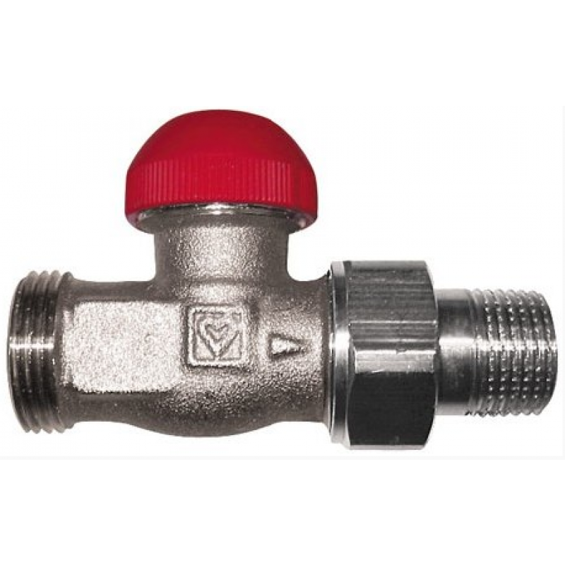

    During the day today, the radiator suddenly stopped heating. Checking what was happening, I turned the thermostatic head and it turned out that it was loosely screwed to the valve, it was possible to do a few more turns of the nut. After removing the head, I saw that the valve needle was pressed almost completely. Perhaps it is possible to press it down by half a millimeter. As a spite, the frosts come and the room cools down quickly. And here is my question, can I somehow unblock the valve on my own? I will be able to report failures only on Monday and knowing the slowness of my administration, they know when it will be warm again. Maybe someone knows these valves and knows how to handle them?

    unscrew the first brass nut, grab the needles with pliers, pull it out, grease it a little with wd40 and move this needle by pressing it inside so that it is lubricated and it will be good to screw the cap back on, screw the heads on and it will move.

    I understand that I can unscrew that first nut without draining the water from the riser?

    Man, I loosened it and the water is trickling under it ... is that normal? I am concerned that removing this element completely will not result in a hot fountain :(

    I took the advice of nighthawk89. I unscrewed the little choke and the needle came out. A bit of water will start to drip if the firing pin moves or twists. As I was screwing the choke back in, it pushed the firing pin in again. so after unscrewing the choke again, I cleaned the firing pin a bit with very fine sandpaper ( I think it was 800) and with a file and a needle file gently the hole in the choke. I checked to make sure it wasn't blocked by putting it on the firing pin the other way round, as in the normal position there is a rubber seal there first which shouldn't be removed too much with a file. I then lubricated the hole with copper grease and everything works after screwing it together. Of course, I don't screw the thermostat on because it will block the needle in the closed position again. If it gets too hot, you can open the window.... By the way, a "specialist" will always tell you that it is necessary to replace the component with a new one, because there is more money to be made from this than from unblocking the valve....

    It didn't bounce by itself because the installation is probably old and the oxidised valve material caused the needle to move with difficulty in the choke. It was necessary to remove a bit of oxide from the bore with a small round file, apply some grease and it would be OK. The valve would perhaps have bounced back after that.

    To block the flow of water you do not turn off the valve with the thermostat. A thermostatic head will never fully close the valve. Thermostats have an antifreeze function so they will never close the radiator completely and forcing the radiator to close can ruin it. A plumber once told me that you close the valve with a plastic lid that should go with the valve, but practically no one keeps this because plumbers usually throw it away when they screw the thermostats onto the valves. In the photo this thing is red but in normal valves it is white.
    Radiator valve with a red knob .

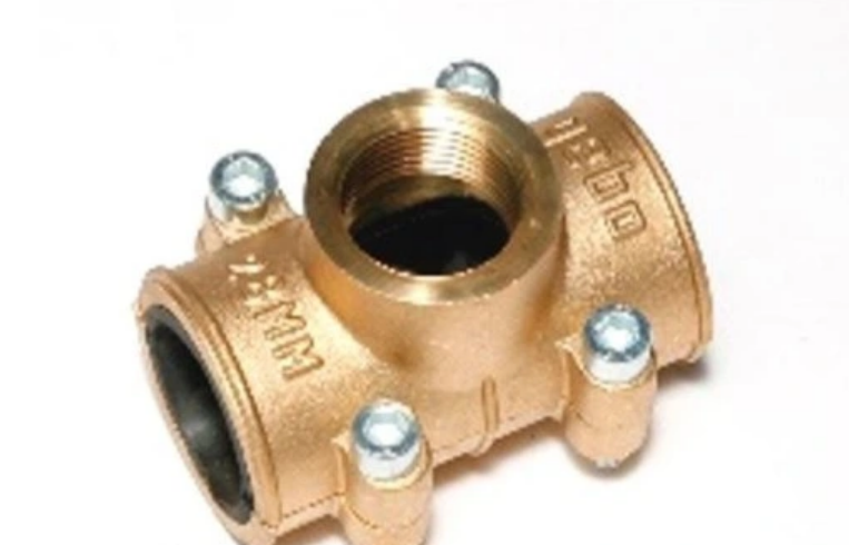

    This is what they wrote earlier with the valve there is a plug included, the red one, and so you won't have to buy a new valve.
    You can always use something like this for safety. A flooded cottage is worse than draining the system.
    There are even radiator valve clamps in specialist shops, or something like this with a plug measure the valve before you buy it, especially the valve to head part so it fits:
    Brass clamp with a threaded hole and screws. .
