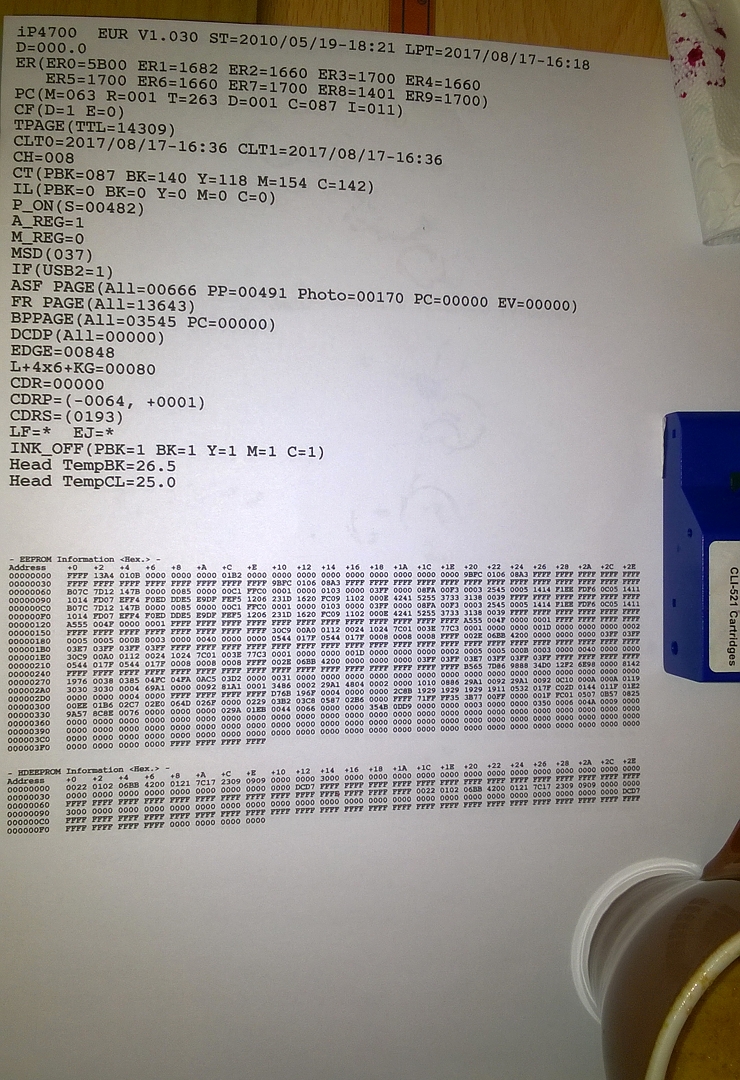

    The printer was fixed for a month. After fighting the self-resetting cans, I finally saw all the colors, phew.
    Now try to print and zong: 'Error number 5B00, An error has occurred etc ...'. It has already popped up for a few months but it could be erased.
    Now the message turns red and just cancel printing!
    What can I do with this? I can't find any codes for this model!

    7 times Ink absorber full [5B00,5B01]
    The ink absorber is supposed to be full.
    Error codes: 5B00: Main ink absorber is full (overseas).
    1) Ink absorber condition
    2) Part replacement: - Ink absorber kit
    3) Ink absorber counter value in the EEPROM; reset the ink absorber counter.
    Do wykasowania tego błędu jest potrzebny Service Tool.

    Thanks leeart. I fired on the eight ST V3.4.0.0. Unfortunately, I had to set the service mode on the disconnected printer, otherwise still Error code: 006.
    In service mode it went but most of the 'buttons' gave 002 but Test Print and EEPROM were printed. I used this website https://translate.google.pl/translate?hl=pl&s...ce_mode_47_tool00_for_print_tool_for_printers
    I also have a question, what does the last Ink Absorber Counter tab give (0-100 percent to be set)?
    By the way, I uncapped the head :) Deep Cleaning button - it was also active (I had problems with magenta all the time). After restarting on a working printer, a few more times quick cleaning and print test and the text came to normal and stopped smudging :) )
    Printed documents in the attachments - did not want to save to a file, maybe something else will come out.
    Thanks a lot and best regards.

How can I view hidden EEPROM data?
After entering service mode, press the EEPROM button. The printer prints a status sheet showing absorber counts, error history, and region code [Elektroda, Anonymous, post #11702307]
