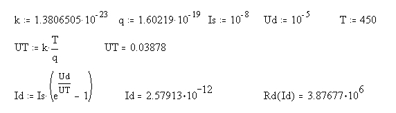

    19 Sep 2007 22:18 Re: Dynamic resistance
    Again from the beginning, because I am asking a few people and the results are amazing:
    Task - Calculate the dynamic resistance of the diode:
    Data:
    T = 450K
    Is = 10to-8
    Ud = 10uV
    Wanted:
    Rd =?
    in the above entry changed "name" to Ud.
    Let's wait what the author of the thread will say, because he is probably not entirely sure himself :D

    Hello, you are right, I don't know if Um or Ud is specifically in this task? in my notes I have written yes and yes, my friends have the same, so I have already lost my mind, but to be precise, at the beginning of the task I have Um - although I do not know what it is, now it suits me better for Ud - thanks to Quarz's hints, so let it remain Ud
    @Quarz
    how from this:
    Calculating dynamic resistance using voltage and current values (U1, I1; U2, I2; U3, I3)
    you got:
    Calculating dynamic resistance using voltage and current values (U1, I1; U2, I2; U3, I3) - what happened to?
    and as for the calculation
    Calculating dynamic resistance using voltage and current values (U1, I1; U2, I2; U3, I3) - I don't understand it anymore?

    Shel wrote:
    so let Ud be
    @Quarz
    how from this:
    you got:
    see there: 20 Sep 2007 15:40 Re: Dynamic resistance
    Here e it is the basis of natural logarithms; e = 2.71828 ...
    That is:
    Id = (10 ^ (- 8)) o (2.71828 ^ (0.00001 / 0.03878) -1) = 2.57897955311170E-0012, this I counted on my desktop calculator.
    The lower significant figures here differ from the previous calculations that I made with MathCAD, but there the value e it is taken probably with 15 significant places, and also a value UT here it has only four significant places.
    Below is the calculation of the values Rd for the previously calculated current value Id :
    Rd = 0.03878 / (10 ^ (- 8) + 2.57913 o 10 ^ (- 12)) = 3.87700007128062E + 0006, fits?
    Here, in my calculations with the calculator, the expression: E + 0006 = 10 ^ (+ 0006) = 1,000,000
    greetings

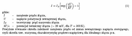

    @Quarz
    I looped again, can you still help me?
    So my point is that at the very beginning you wrote that the dynamic resistance of the diode:
    Rd = du (i) / di
    then after the transformations you wrote Rd = UT / (Is + Id)
    and now I have no idea how one relates to the other, I mean it from the mathematical point of view, because I have serious problems with integrals?
    @ Paul Es.
    Looking through my wise books, I also do not understand where this pattern came from:
    I found, but something like this:
  • #37 4324606

    Shel wrote:
    @Quarz
    Rd = du (i) / di
    the first relationship is the formula generic to the derivative of a function voltage u (i) , where independent variable is the diode current and and after calculating this derivative (for the function: u (i) = UT o ln (i / Is + 1) ) We get functions Rd (i) .
    However, the dependence:
    Rd = UT / (Is + Id) it's counted derivative value du (i) / di in point where for the independent variable and substituted Is that is, it has been counted dynamic resistance value for i = Is :
    Rd (i = Is) = UT / (Is + Id) that's it.
