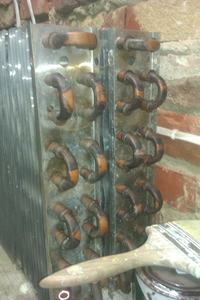

    bobek5001 wrote:
    Hello after a long break I was also thinking about a heater but they are very expensive and I would like to do it as cheaply as possible and I found two such coolers on 3/8 inch pipes in the attic and I wonder if at 45-50 degrees factor such a heater will heat my garage to those 10 degrees in plus.
    Installing Radiators in a 35m Garage: Insulation and Thermostatic Valve Considerations Installing Radiators in a 35m Garage: Insulation and Thermostatic Valve Considerations Installing Radiators in a 35m Garage: Insulation and Thermostatic Valve Considerations
    Greetings and look forward to your evaluation.
    If you slightly rework these coolers then you will not need to install a fan.
    In the middle photo you can see the upper tube connecting the right side with the left.
    Unfasten it and put there the Trojan connecting the right and left as they were, and the side connection of the Trojan connect to the CO supply. Do the same on the opposite side with the pipes feeding the cooler, connect them together with a T-piece and connect to the return of the central heating, it will double the surface of heat transfer from the same amount of flowing water and it will be easier to vent.

    Installing a fan to this radiator (functioning as a heater) will greatly accelerate the heating of the garage. Without a fan is better for permanent heating and if you need ad hoc - a fan is advisable. The same is true for electric heating - a kiosk that is cooled after a night will be heated the fastest by a thermo-blower. The car radiator is copper, so it gives off heat perfectly.
