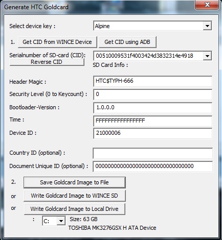

    Is it possible to somehow generate goldcard.img without revskills?

  • #9 12319073
    hacker_ice
    Posts: 871
    Help: 36
    Rate: 101
    I have a HTC goldcard generator from revskills so if you give me your CID, I could generate it for you. It works for me :)

    Please try. I obtained this CID number using Simply Gold. 00740095117000104247314453323441
  • #11 12320944
    hacker_ice
    Posts: 871
    Help: 36
    Rate: 101
    Please try the attached file if simplegoldcard fails then try HxD. I personally made a goldcard by inserting it into the navigation and thanks to this I created it because the program immediately saved it there, but only the 3rd card turned out to be good for creating a goldcard. Mine is 2Gb GoodRam

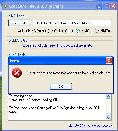

  • #16 12322136
    piotrex89
    Posts: 34
    HTC Wildfire S - if the website revskills does not work, how to calibrate the to
    and what now?
    so I tried simple and goldcard both programs do not accept your img, and my old ones (unfortunately with wrong cid number) accept, this is also something wrong.
  • #17 12322169
    hacker_ice
    Posts: 871
    Help: 36
    Rate: 101
    So you have to copy it via HxD. Because this progs makes a 484 byte image. A gold card tool wants 384 bytes
