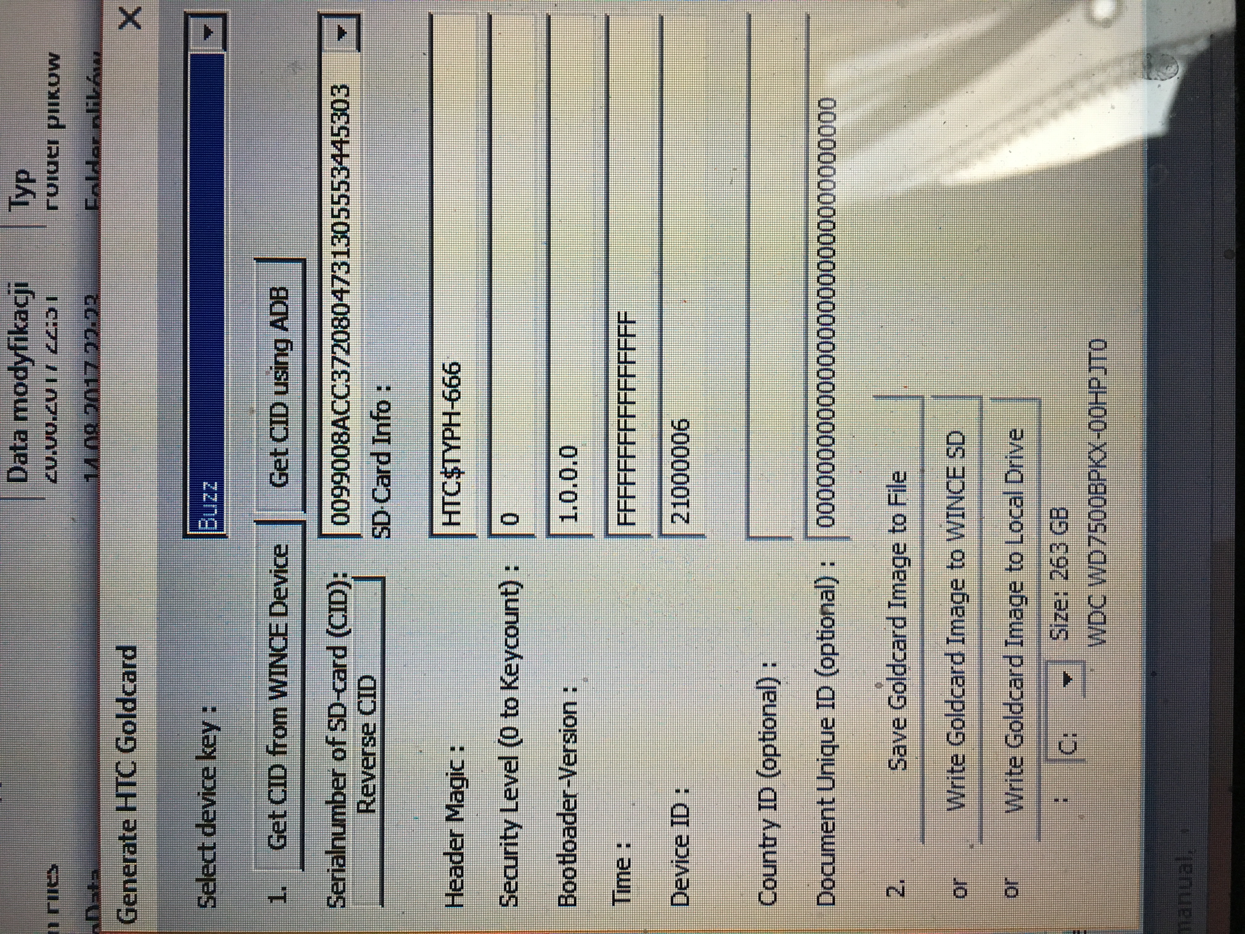

    I need to create a GOLD CARD.
    GetCID to 0099008ACC3720804731305553445303
    I have the RevSkills program, but there, when I throw GetCID, I will choose Device Key Buzz
    i write gold card image to local drive - whether I give a microsd card or a local disk writes that it is saved and the file is nowhere to be seen. Am I doing something wrong? I dug up the topic on many forums - everywhere there is a link to the revskills.de page, which has not been working for a long time, and the program itself downloaded from the forum from one of the threads as you can see either I do not understand or something is not working or it just does not work. I will be grateful for your help - because I have looked at all the threads and everything is nicely described to the place where you need to go to the page that does not work

  • #494 16647668
    fafrys
    Posts: 25
    HTC Wildfire S - if the website revskills does not work, how to calibrate the to
    This is how it looks from the program level. Perhaps I choose or do something wrong here ??
    CID copied from GoldCardTool. Read directly from HTC because I did not want to read the microSD card itself.

    I would try a different memory card, preferably 512mb or 1 GB
  • #496 16655497
    hacker_ice
    Posts: 871
    Help: 36
    Rate: 101
    What microSD card are you using? As I wrote, I had to have 1gb of goodram and it worked only on this.
