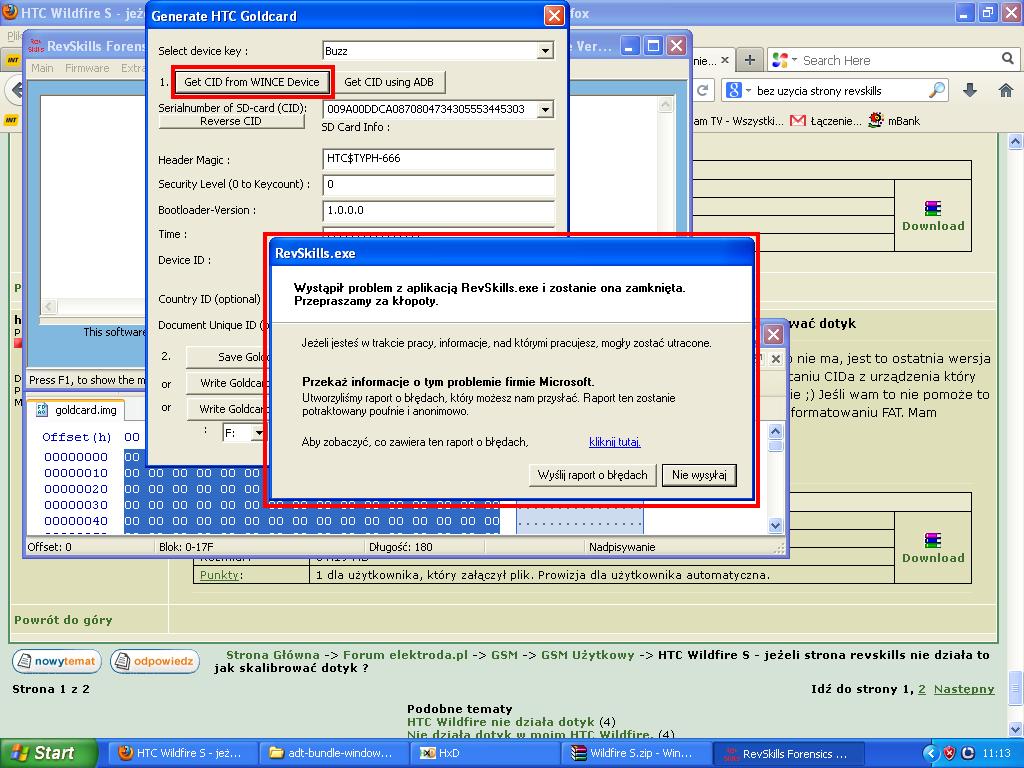

    I tried 100% of the ways
    1.with HxD, I did according to the guide, except that I did not install the sdk environment, I tried several times but I have problems with java and I cannot jump over it (I took the cid number from the gold card tool, be a simple gold card always the same on the same card memory)
    2.with the Revskills program, I tried in various ways by post, I tried to click as in the "get cid from wince device" instruction, I thought it would be done automatically, but an error pops up, so I pasted the cid number and a few "write gold card image to WINCE SD" also the same error
    3.with revkills, I tried first to the file and then HxD I did according to the instructions, everything is beautiful, now it's your gold card information and then security fail
    4.with revskills, I tried "write gold card image to local drive", I chose the letter assigning to my memory card and nothing, I tried the letter a (although it's stupid but I lacked ideas) and nothing
    I did all these maneuvers on the htc sync connection and the disk drive when it comes to the phone, I tried other programs as before in the topic and all the time security fail ... I really have no ideas what else I could "mix" when it comes to ideas, my hands fall because in fact, although initially I approached it very lazily, I am already tired of "dozens" of hours with it, in addition I have the debugging module turned on all the time, I tried to do it on two wildfire s phones, both the same effect, although one in the bootloader has red letters unlocked, but it doesn't help at all, for this I tried on 4 carats of 2x2gb 4gb and 8gb memory
    HELP
    PS. such an error pops up (see picture)
    HTC Wildfire S - if the website revskills does not work, how to calibrate the to
    in revskills, of course, I changed to buzz (although I also tried on others)
    • HTC Wildfire S - if the website revskills does not work, how to calibrate the to problem goldcard.JPG (161.21 KB) You must be logged in to download this attachment.

    You cannot have an SDHC card, so cards above 4GB will fall off immediately.
    If you click Get CID from WinCE device, what device do you have connected? Because this program only supports devices with WinCE !! No Android, iOS, Symbian etc ... WinCE system preferably version 5.0 or 6.0. I personally did the navigation with WinCE 5.0.
    1. You connect the card to the paw / PC and format it in FAT
    2. You connect the navigation to Windows. After you install it and the Windows Mobile Device Center appears, you click connect without configuration.
    3. Check in My Computer \ WinCE device \ Whether the memory card is visible.
    4. You run revskills. You choose HTC goldcard
    5. Click Get CID from WinCE device. You should see the CID.
    6. Select device key: Buzz from the list
    7. You click Write Goldcard Image to WinCE SD
    8. If it shows you that you have uploaded successfully, you have a goldcard.
    9. Upload 2 files via My Computer \ WinCE device \ SD \
    PG76DIAG.nbh
    HTC-ANDROID-GOLD_CARD
    10. This is a 100% correct gold card, if it doesn't work for you then you have to try with another card, but not with SDHC.

    maybe my navigation is on this system wince ... hmmm you don't know what larkfreebird is, I have 35.8, just don't have a cable, but I'll buy it.
    aha to this navigation ... no cable ... only connection to the computer via memory card ... and zonk; /

    You should be described as far as the system is. Most of the navigation where Automapa is used is on WinCE
