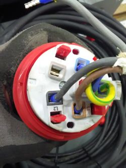

  • #37 17760528
    pitt82
    Posts: 119
    Rate: 78
    Hi
    Norms are norms - probably none of them regulates this, but those who are willing can look for it when they have access.
    Attached I have a photo of the plug with descriptive markings and colors. Earlier, my colleague kkaz12 gave examples of documentation from Ireland ...
    I would connect as in the picture of the plugs.
