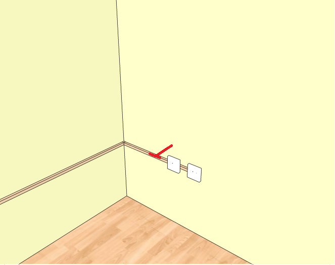

    zielonek89
    Posts: 7
    I've tried to get a little visualisation of exactly what I mean :)
    Can a compact wireless switch cut power to a normal wall socket?
    This is how it more or less looks like.
    In red I have marked the cable coming out of the wall and continuing on
    The cable strip is the 3-core electrical cable (as shown in the picture).
    The sockets are of course sockets.
    I would even be happy to dispense with one in order to fit this radio switch
    Let's assume that this so that I don't get confused about what is what.
    I would like to give it in place of the socket from the left, so that the remote controlled socket is only from the right, and the rest of the sockets that are on the cable going to the left work all the time.
    Is this possible? And, of course, with the aforementioned receiver?
    Let it be even this 1KW.
    A more detailed description of how to connect this would be welcome, and what if I wanted to connect e.g. 2KW there?
    Forgive me for bothering you so much ;)
  • #8 12871782
