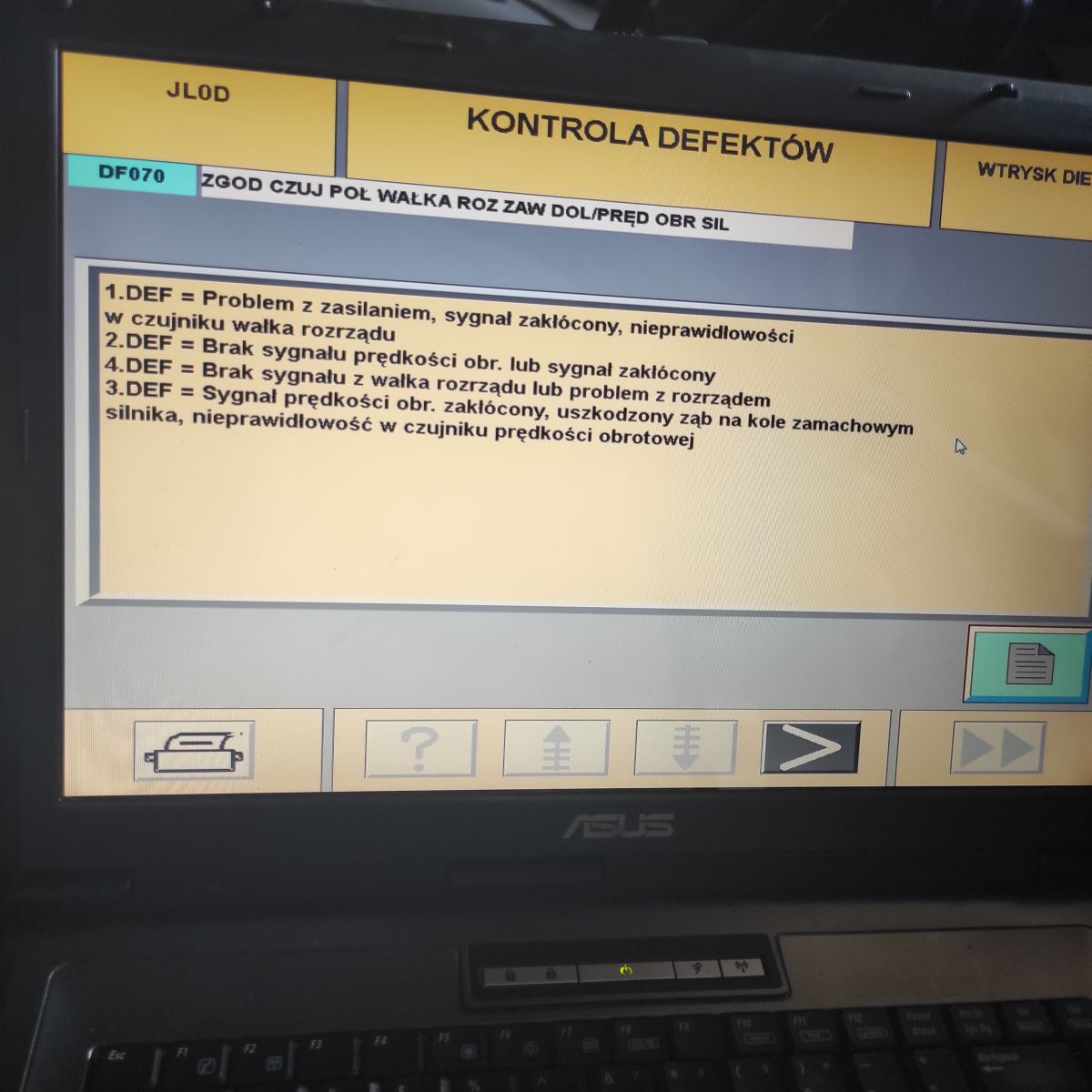

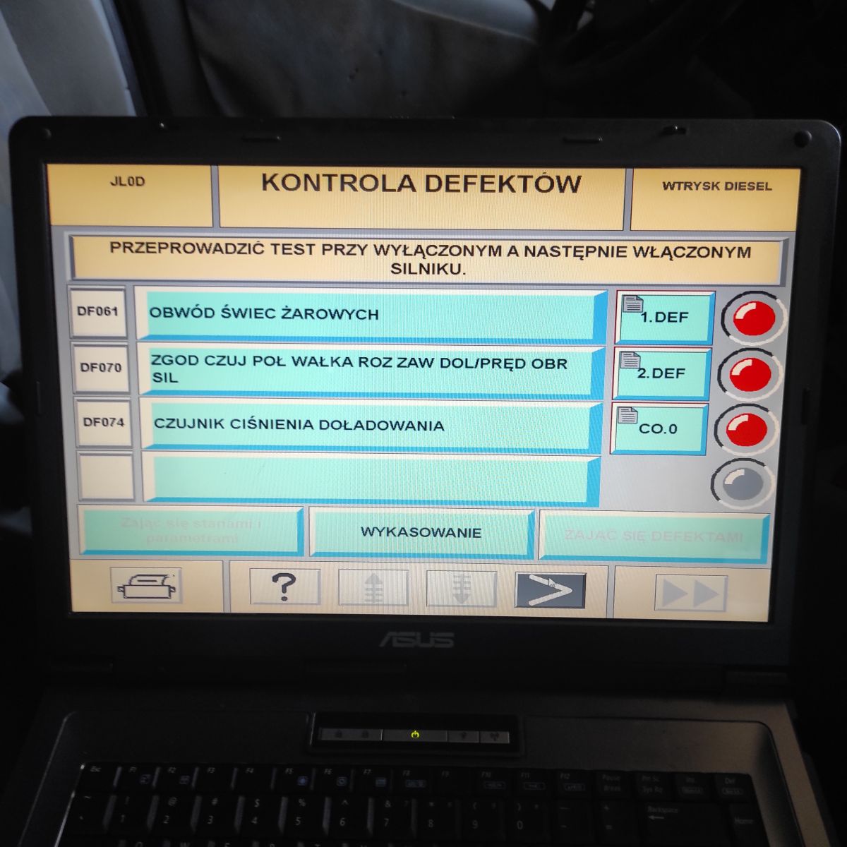

    I see the topic has already been covered so I'll write here, I won't be setting up a new one.
    I have a Renault Trafic 2.5DCI 135hp, I have had the head done and the car does not smoke.
    I have put everything together and it seems to me that I have put everything together well, as I had marked when disassembling.
    Shaft lock put in place, shafts in the head set wide side towards the injection pump (front of engine). Injection pump gear set with the small dash up, the big one at the bottom on the mark on the housing (I wasn't sure about this anymore as I started reading a lot on these topics, but the photo posted here of the wheel with the vibration damper lock screwed in made me realise that it was also screwed in at the top left on mine).
    I'm getting errors like this (I'm adding pictures)
    Laptop display showing diagnostic error messages for a car. Car diagnostic screen displaying error codes DF061, DF070, and DF074.
    I would like to add that 4 spark plugs put on new.
    Please advise.

    >>20961530 on a disconnected flow meter it did this to me too
