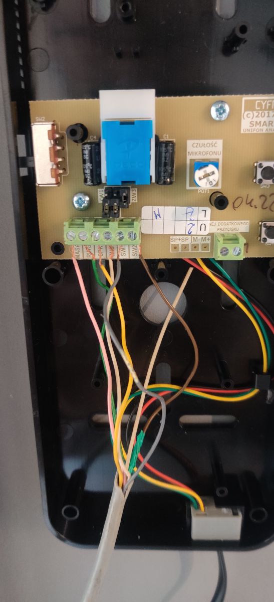

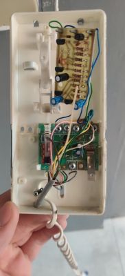

    Hello, another move in my life and another intercom.
    That is why I am asking you for help how to connect the cables from the photo to the intercom UNIPHONE INTERCOM 4,5,6-WIRES DIGITAL SMART 5P?

  • IKA Łódź uniphone uses DC call generator module
    #32 20000925
    zybex
    Helpful for users
    Posts: 15919
    Help: 2094
    Rate: 2939

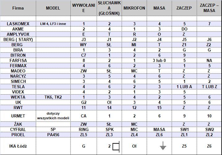

    The uniphone visible in the photo is IKA Łódź. In addition, it had a call generator module added. Apparently, the intercom system was triggered by a DC voltage (buzzer, noise-maker). If so, you will also have to translate this module into a new uniphone.
    In the lower part of the table, you have the designations of both uniphones, the old and the new one.

    I showed the questioner the table of substitutes, where everything is "as on the tray". The jumpers are mentioned in the instructions for the new uniphone. Another issue is calling, which will not work in the new one, and in the old one it did not work, only adding the generator plate (visible in the upper part of the old uniphone) caused the calling (heard in the uniphone receiver). It follows that a DC trigger is in the block and a buzzer is required. The generator just added is a better version of such a buzzer. In the new uniphone it should be connected as it was in the old one.
    I will only suggest that the generator has three cables. One is power, the second is ground and the third is the signal output. In a typical multi-wire intercom installation, a calling signal appears on one of the cores, which goes to the uniphone receiver. In this case, a DC voltage appears on this vein. To use them, you need to give this cable to the generator board, connect the mass of the generator board to the ground of the uniphone (i.e. two wires will be after the MASS terminal) and the "signal" cable coming from the generator board should be given to the RING terminal.

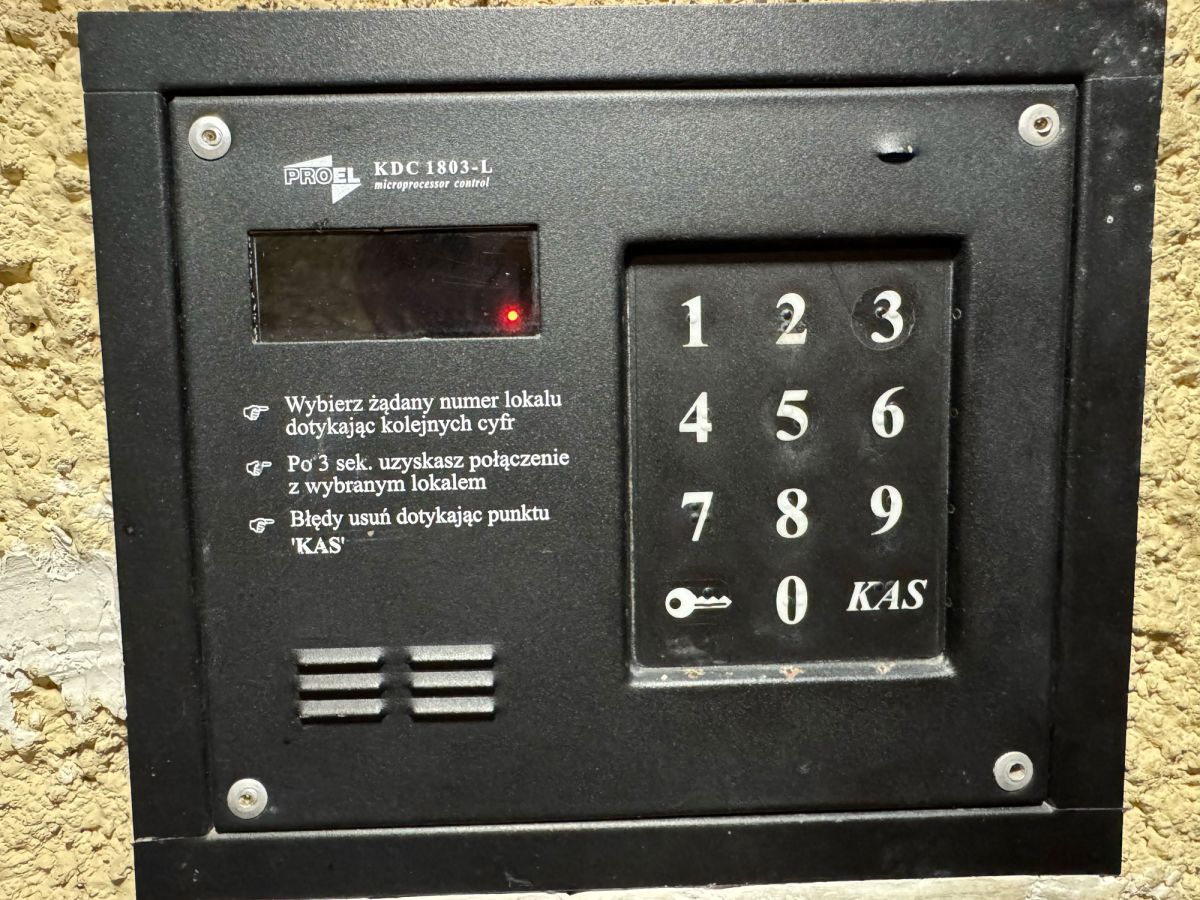

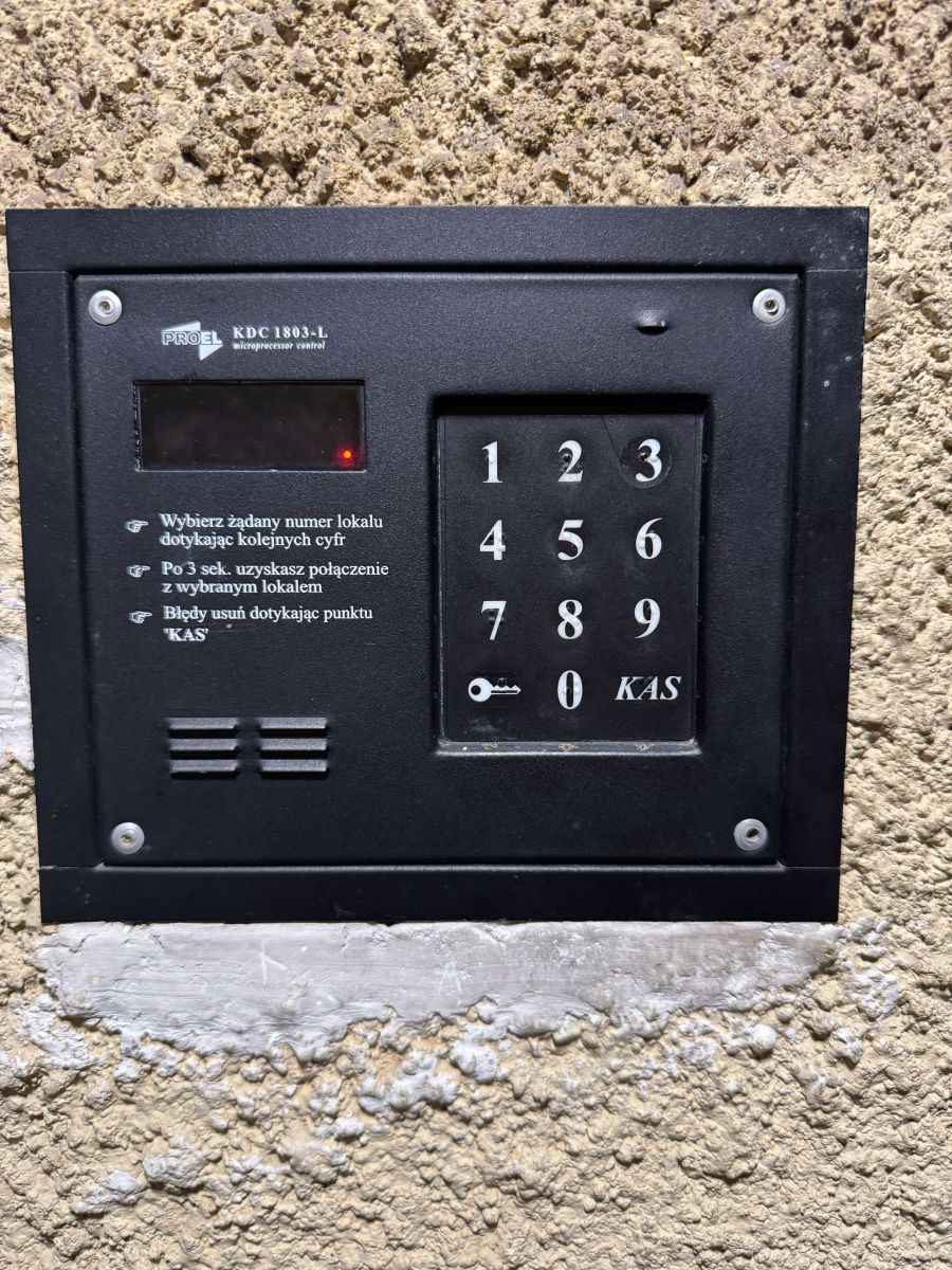

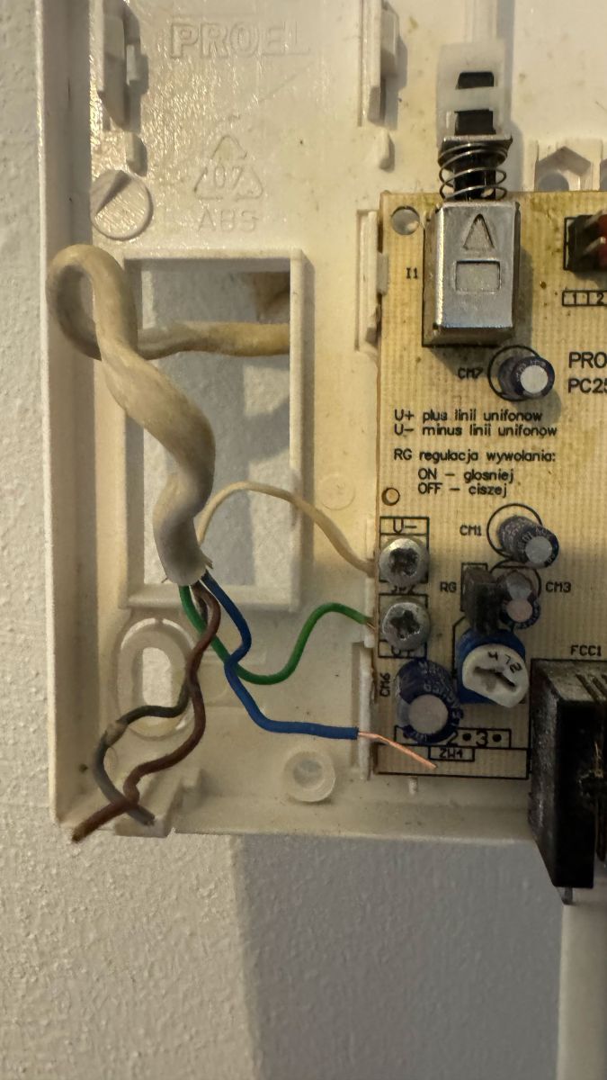

    #38 21694470
    macgoni
    Good morning.
    I have just moved into a flat where the previous tenant took the handset off the intercom and there are just wires sticking out of the wall.
    There are 6 of them, the white and green are without the cover so I assume they were connected, but the blue one also has it pulled off only less.
    I don't know which handset to buy and how to connect.
    The intercom downstairs looks like this:
    Proel KDC 1803-L intercom panel with numeric keypad and LED display .

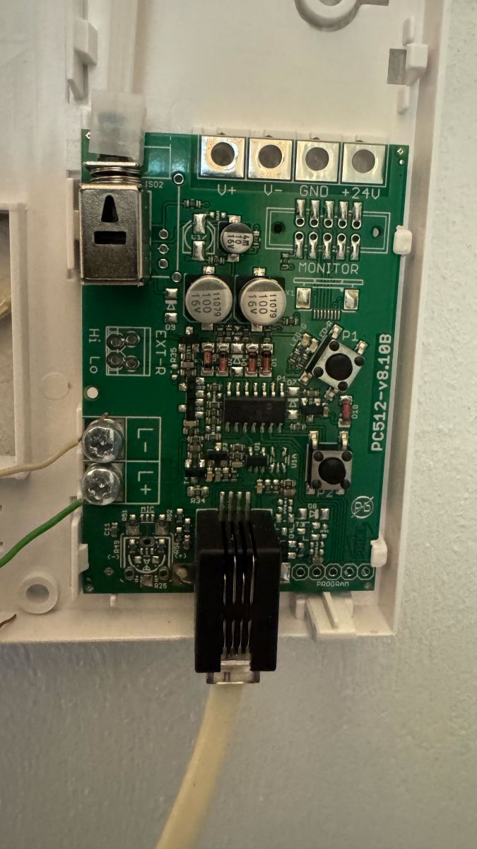

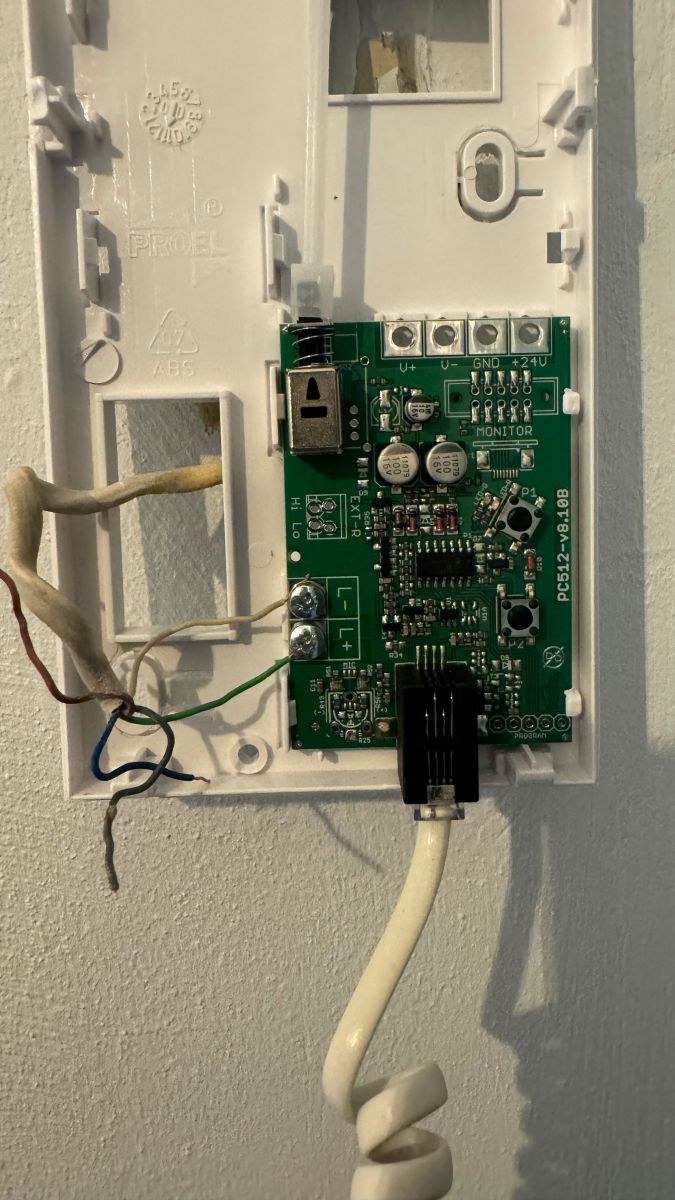

  • Proel PC 512 needs flat 10 jumper setup

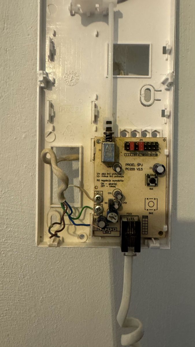

    #40 21709837
    macgoni
    Good afternoon,
    I have written before regarding the intercom handset.
    I found an old one and after plugging it in it occasionally works, i.e. if I click "open" 20-30 times it will eventually catch.
    I assumed there was a bad handset, so I bought a new one - recommended - Proel PC 512, but it doesn't work. I assume that somehow I need to mark the flat (number 10), but have no idea how.
    The old one had a system of such connectors, and here I don't know; I couldn't find instructions in the box either.
    Thank you for your reply.
    Proel SPJ PC255 V2.5 intercom interior with exposed circuit and wires .
    Proel PC512 intercom circuit board with visible wiring and connected cables .
    Proel KDC 1803-L intercom panel with numeric keypad and printed instructions. .
    Inside of Proel PC512 intercom handset with circuit board and connection terminals .
    Proel PC512 intercom circuit board with visible wiring and connectors. .
  • #42 21710535
    CYRUS2
    Posts: 18038
    Help: 1241
    Rate: 3535
    macgoni wrote:
    I did not find a manual in the box either.
    Programming instructions are also on the PROEL website.
  • #43 21720125
    macgoni
    >>21710028 .
    Thank you very much.
    I have one more problem with this programming: how to punch in the number 20 or 30 or 10?
    Because you have to punch in the first digit and, let's assume it's 2, and wait a moment and the second digit, and here it's zero. How do you do that?
    Thank you in advance for your answer.
  • #44 21720134
    Ircys
    Intercoms specialist
    Posts: 6971
    Help: 1342
    Rate: 2085
    macgoni wrote:
    I have another problem with this programming how to enter the number 20 or 30 or 10?
    Because you have to click the first number and let's say it is 2 and wait a while and then the second and here is zero. How do I do this?
    Zero is obtained by pressing the button longer.
