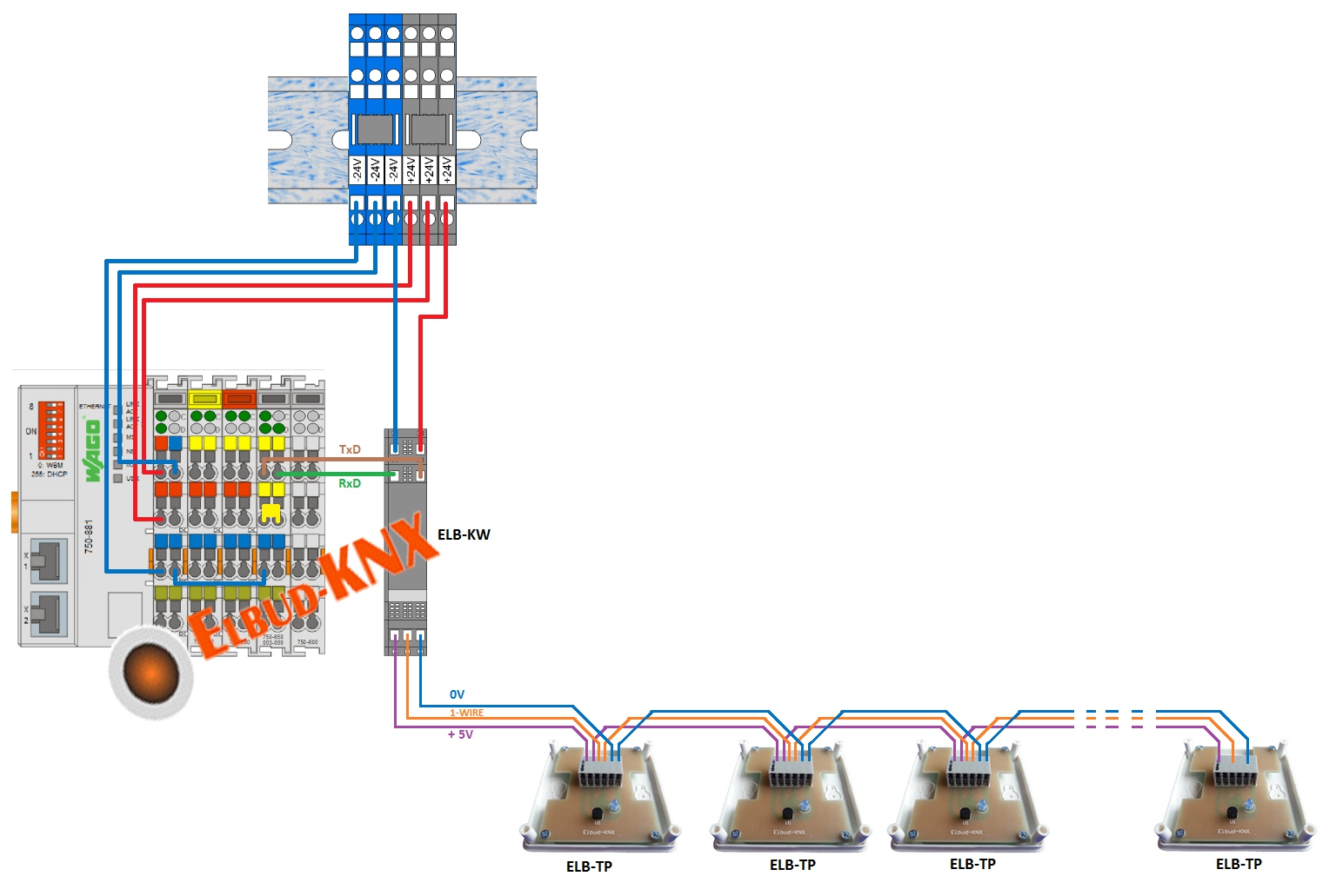

    Example applications:
    How to connect the 1-Wire to RS-232 converter ELB-KW to WAGO controllers? How to connect the 1-Wire to RS-232 converter ELB-KW to WAGO controllers?
    If you purchase the converter, we also give you a sample program written in the Codesys v2.3 environment for Wago controllers, supporting ELB-TP temperature sensors.

    In the first example there should probably be GND ( or 0V) at the blue wire connected to the RS, not -24V.... ?
  • #3 13786956
    Elbud-KNX
    Yes, the -24V designation is the circuit ground, the same as 0V for the 1-WIRE bus
